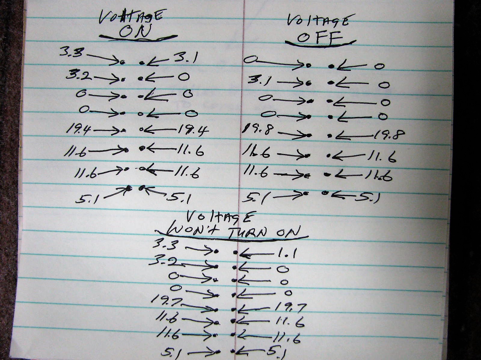

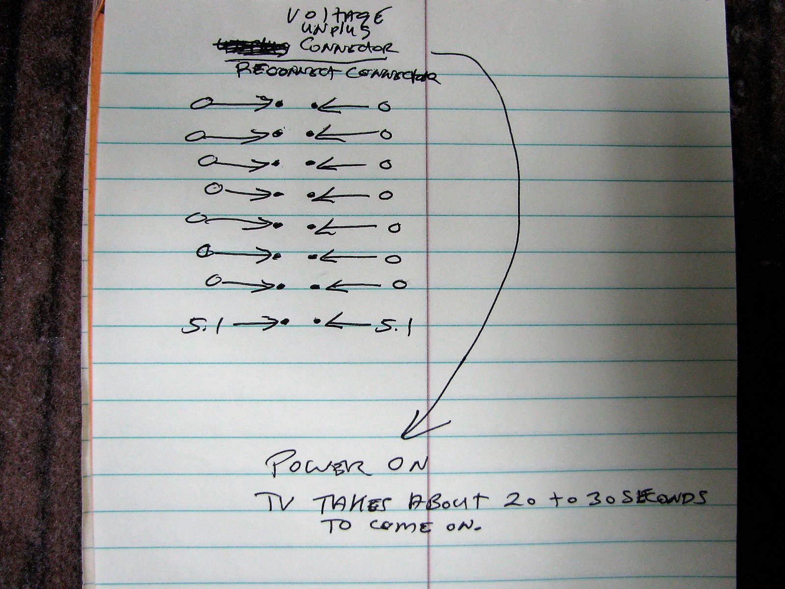

        Capleaker, here is my voltages. I hope you can read them ok.

            I think you didn't measure all pins on CN9101. It has 16 pins.what is the pin name on the 3.3V rail (the very first on top of the list)? 3.3V only measures 1.1V when the TV won't turn on.

                CapLeaker, the 1.1v reading appears to be on the on/off pin. And the 3.3v appears to be the dim pin.

                    So when that tv is in that weird state as you say, are the backlights on or off? 1.1v isn’t enough to turn them on. Next, the same on / off pin is on the other connector where the backlights plug in.

                                        Re: Vizio M502i-B1 Power Supply Issue
                                        Everything hooked up, plugged in, power off....on/off-3.24v, ps_on-1.14v
                                        Hit power but nothing happen and voltages stayed the same.
                                        I unplugged the connector from the mainboard and plugged it back in and then I had 0v on on/off and .10v on ps_on.
                                        I hit the power button and then I had 3.24v on on/off and .06v on ps_on.
                                        The tv powered on after about 20 to 30 seconds and then I had 3.13v on on/off and 3.20v on ps_on.
