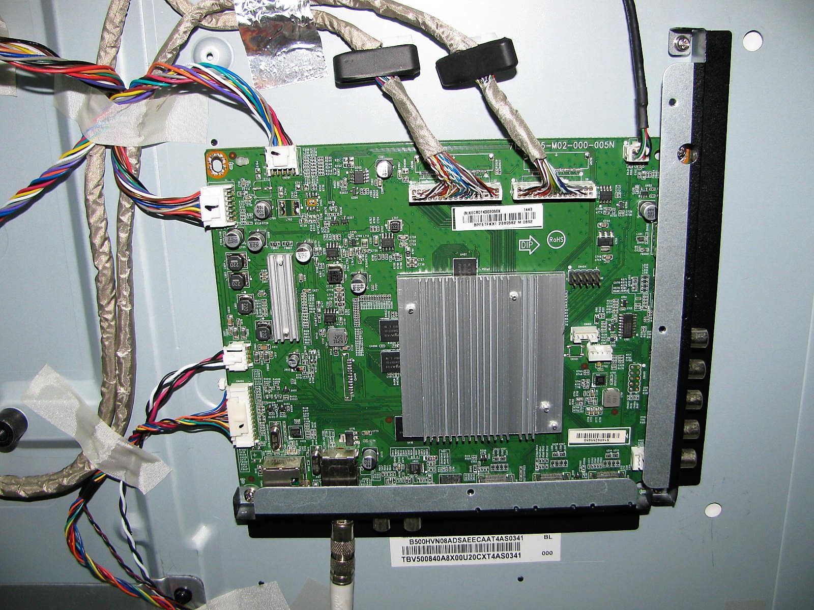

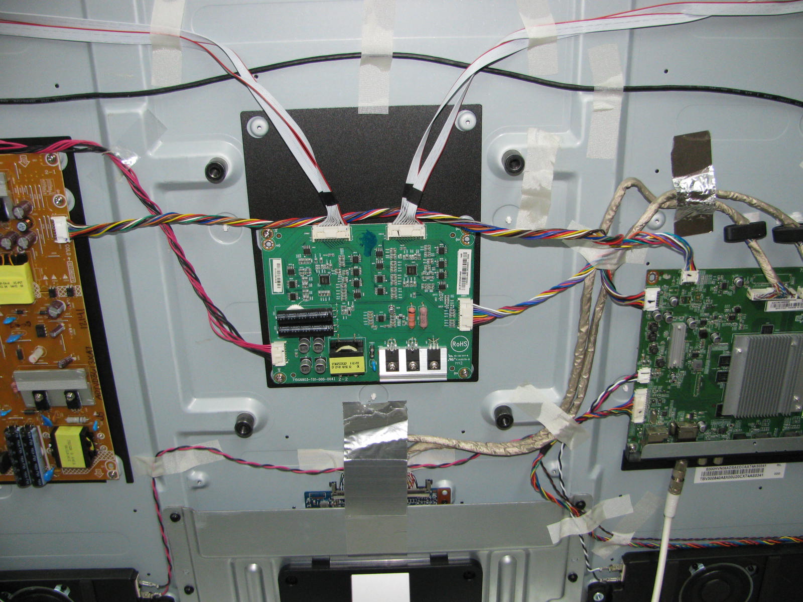

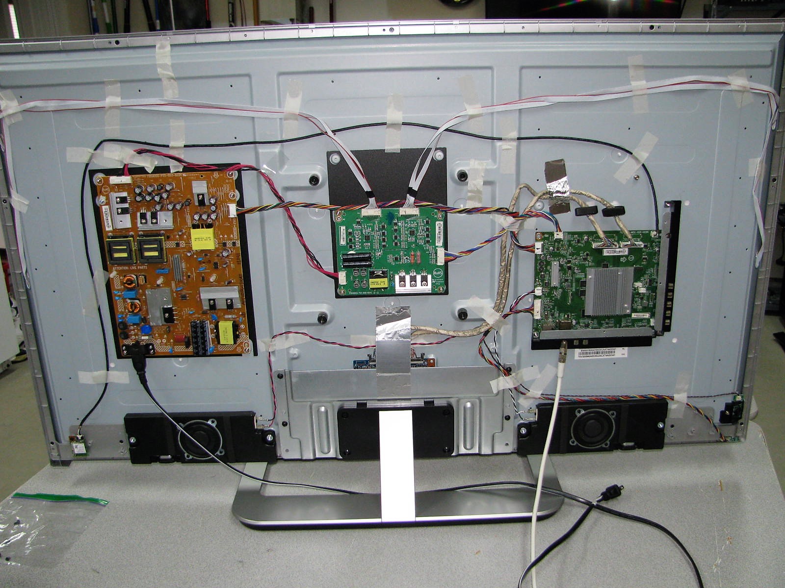

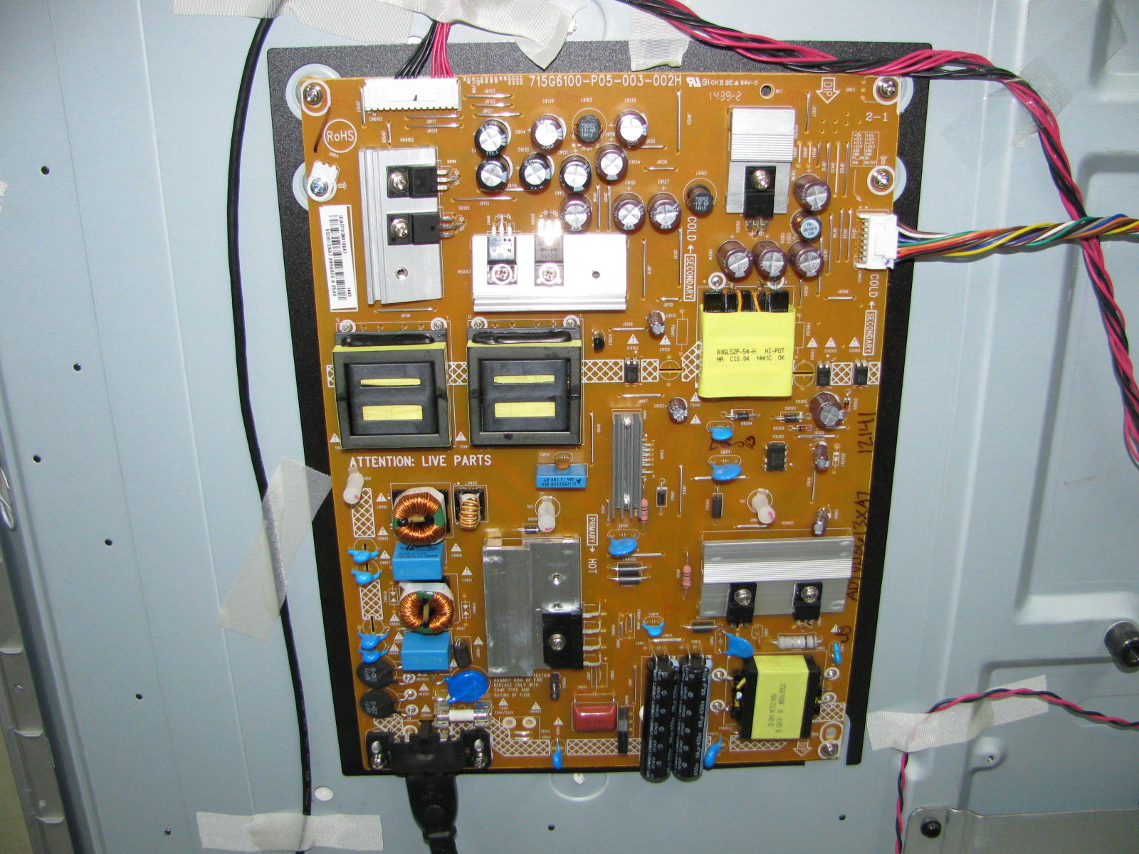

                        Here's some pictures of the boards. I just discovered something else strange. When I drain the power holding in the power button in for about 30 seconds with the power cord disconnected, and then plug it back in, I have no power at all. I stated that earlier in this thread. But, if I quickly plug and unplug the power cord about 4 or 5 times, the standby light will come on. Then when I push power on the remote, the standby light will flash twice and then after about 20 seconds the TV will turn on. Quickly plugging and unplugging the power cord is something new that restores power. I tried different power cords and I unplugged the LED cables like you suggested but neither worked. Any ideas? None of this makes any sense whatsoever.

                          Looks like you changed pretty much everything but the led driver board?? some there for about 10 bucks, make sure you get a match if you get one: https://www.ebay.com/sch/i.html?_fro...acat=0&_sop=15
