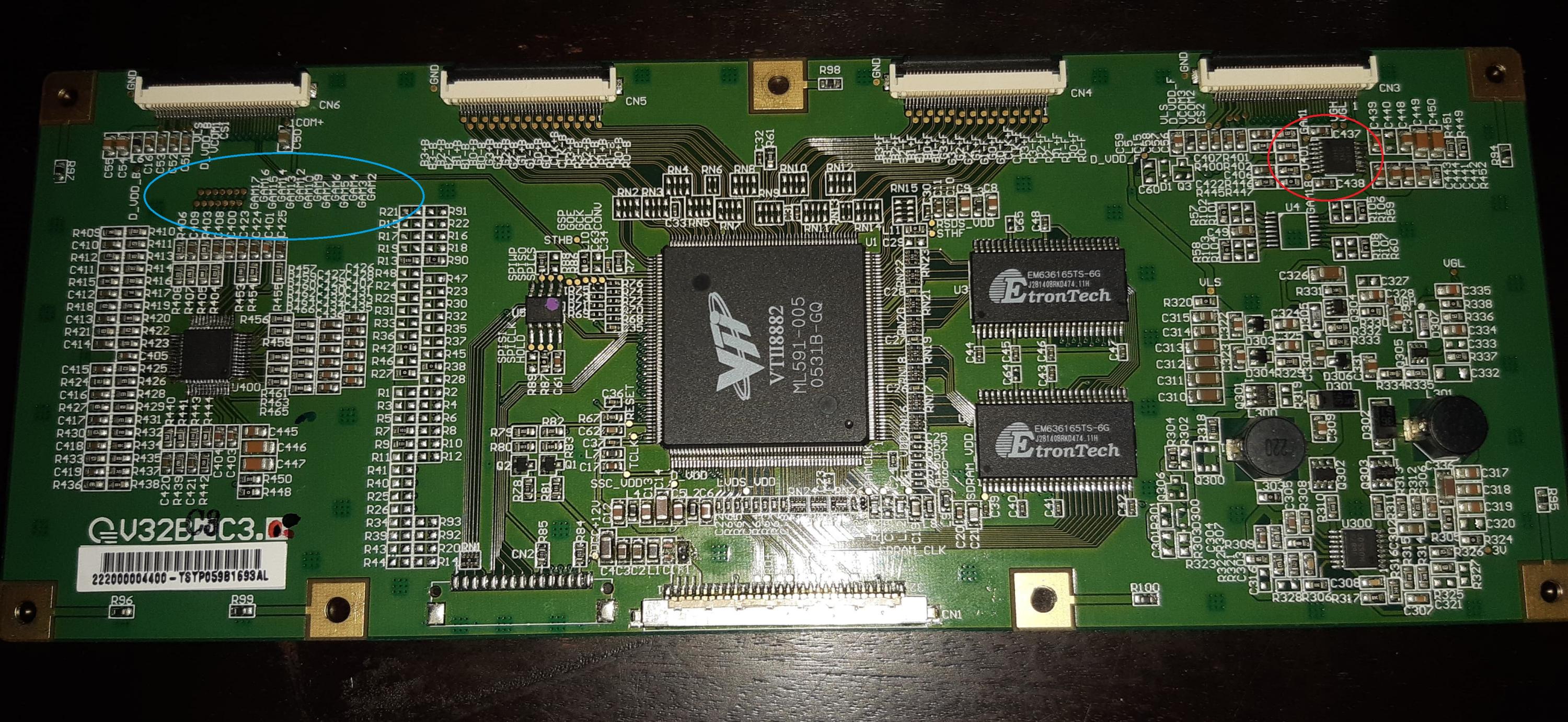

    After I took it apart, I noticed, that everything seems okay, so I got to the T-con board. The model is: V32BC3 (the big chip version).
    The F1 fuse was blown, but I didn't find any shorts on the board, so I just replaced it with a cable for testing purposes. (I know that it blew for a reason)..

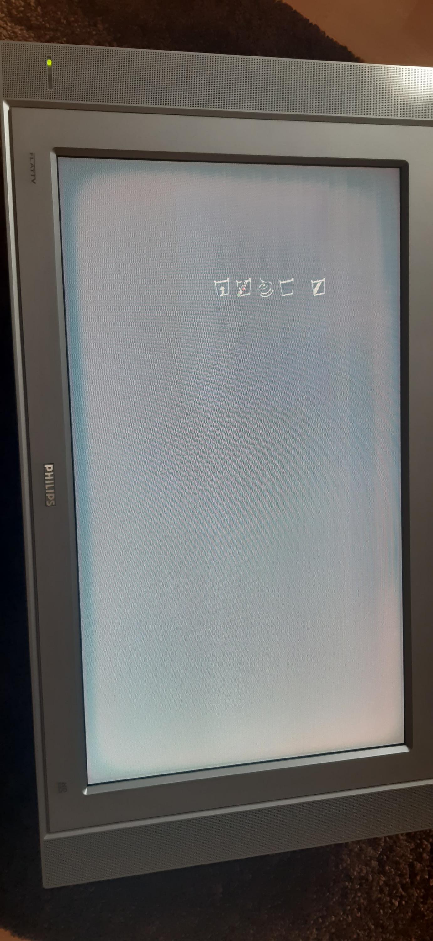

    After turning the TV on like this, I now have picture, and can confirm that the TV is in fact working in general, but the colors are waaaaay off.. It's like the picture had a white fog in front of it. It's hard to see.
    Also, if say, I open the menu for 10 seconds, then close it, the menu won't fully disappear, like it burns into the screen.. (picture attached)
    I have read some forums and watched videos, and I saw that the AS15-F chip can die and produce this, so I replaced it, but the problem remained.
    I didn't meausre everything yet, because I had to go to work, but I can confirm, that between GAM2 and GAM17 everything seemed fine about the voltages. But then I noticed, that the GAM1 and GAM18 is at a completely different spot on the board!

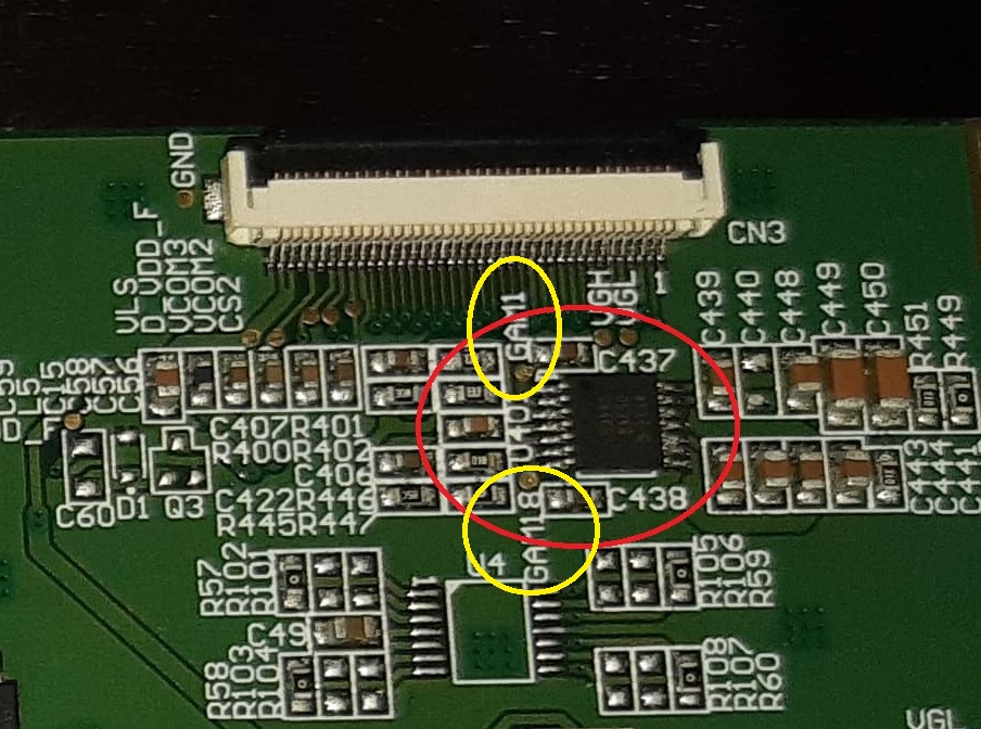

    The GAM2-GAM17 testpoints are connected to the AS15-F chip and they are located at the left side of the board (blue marking on picture), however, the GAM1 and GAM18 points are on the right side of the board, and connected to the AS34-G chip. (marked with red).
    And the voltages seem switched to me.. the GAM1 has 0V, while GAM18 has ~14.7.
    Meanwile, on the other side of the board, GAM2 has ~14V, and GAM17 has ~0.7V.

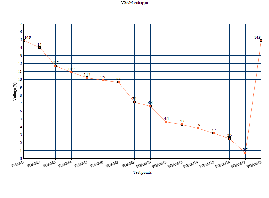

      However, I measured a lot more things than yesterday, like all the VGAM points an others.
      I made a graph with the VGAM voltages, you can see the attachments.
      Note: the GAM1 and GAM18 are connected to the AS34-G chip, and not the AS15-F chip.
      But I am not sure, which side of the chip is an input or output, nor how it really works, since there is not much information about it.

        That voltage graph looks ok untill VGAM18, that voltage should likely be around 0.5 and not 15v

          I looked at the t-con board picture and I only see GAM2~GAM17 where did the GAM1 & GAM18 come from? It would seem that the GAM voltages are ok and the graphed voltages are missleading.

            As I mentioned, the GAM1 and GAM18 are on the right side of the board, but I'm gonna attach a picture again, with them highlighted.
            Yes, I tried connecting only one side of the screen, but that didn't make a difference.
            Some new information: I have read that the VCOM voltages should be like ~7V, however, I have ~0V on the VCOM2 and VCOM3 (didn't measure VCOM1 yet). Could this make this problem?

              So, today I changed the AS34-G to a new one, and it fixed the problem! ...well, for a few minutes. Then, again, the picture got weird. Not as bad, as before, but definitely brighter than it should be. I was checking the GAM18 voltage, while it was good, the voltage was around 0.6V.
              Then, now, with the messed up picture, it's now around ~6V, so now I am pretty sure, that the GAM18 voltage is the problem. I got another spare chip, and I'm gonna try that one too, and if that also fails, at least I will know, that the GAM18 line is the one to fiddle with.
              EDIT: i put in the other chip, and now the colors are fine! And it worked so far. However, there are some weird flickering on the top middle part of the screen, I also see some horizontal lines on that area... it might be the burn in from the previous chip, so I'm gonna turn the TV off for a few hours, and then turn it back on.
