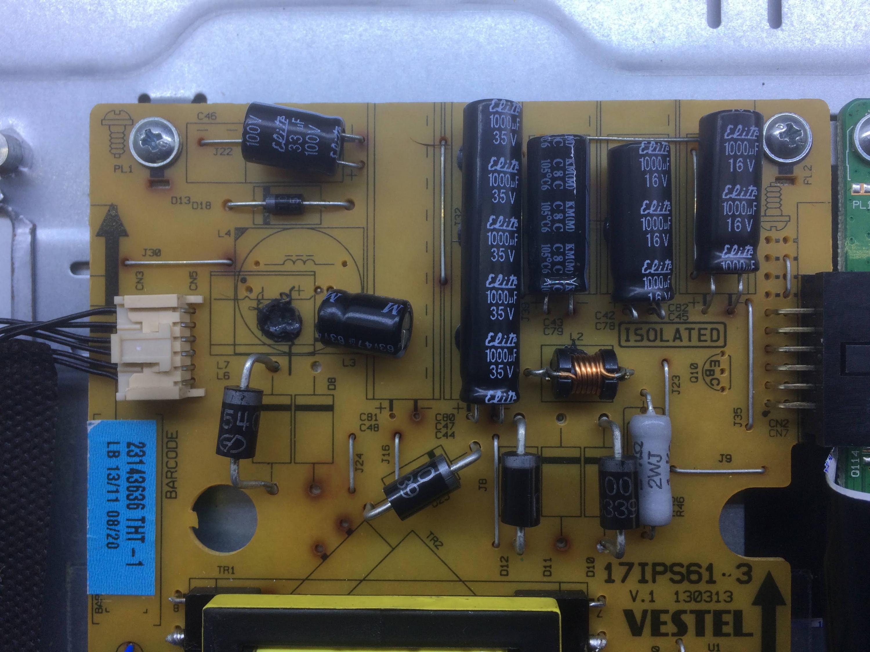

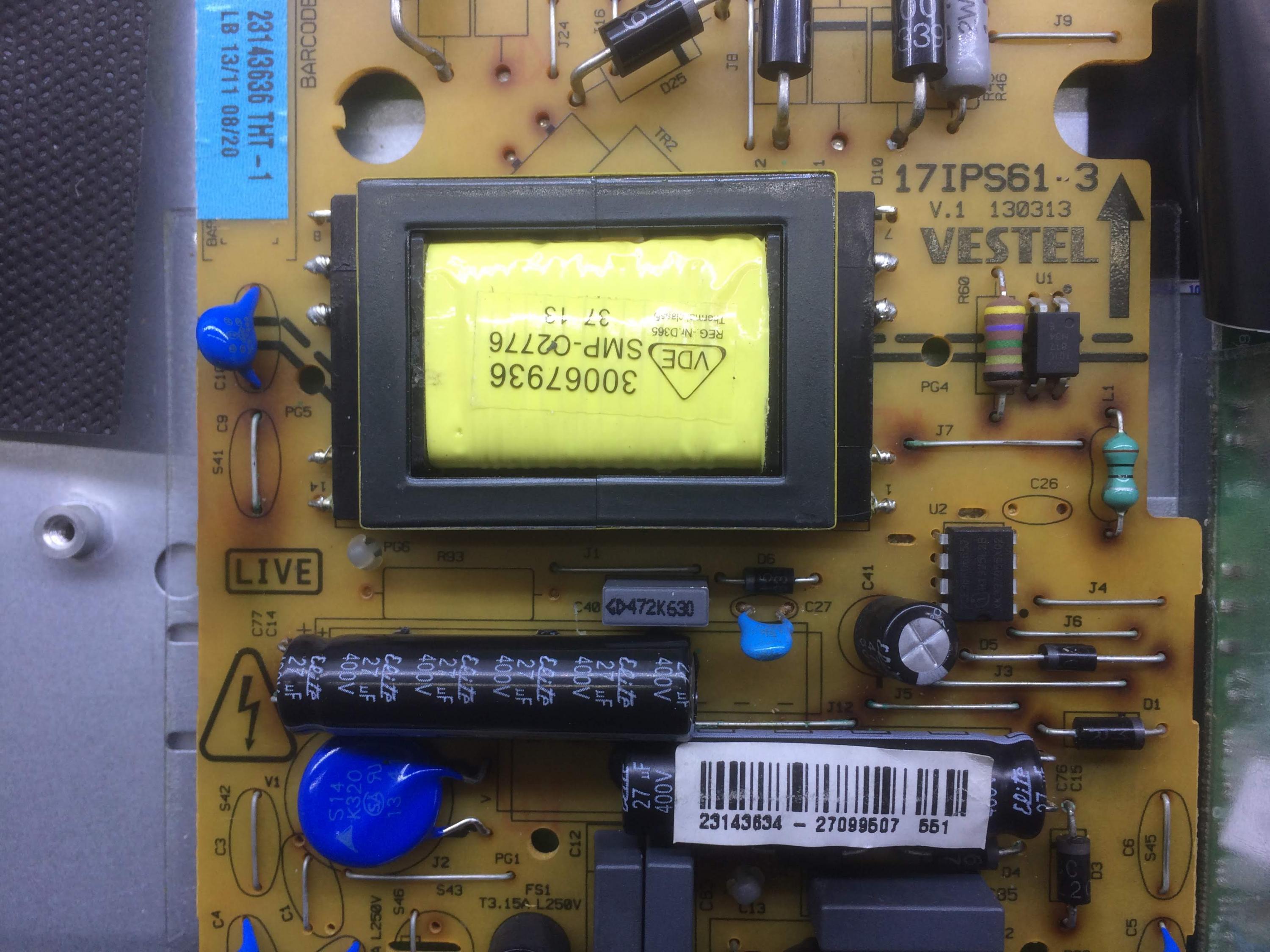

    Hello all,
    I have a TV with a vestel 17ips61-3 power supply and when I turn it on it doesn't display any image. However, I can see the power blue LED and after sometime or when I press any button on the remote control, the LED starts flashing from RED to BLUE and remains blinking alternatively for several seconds.
    I've measure all CAPS and they look fine. All the values are in the acceptable range of each capacitor.
    I'm not really sure how to test the diods, any feedback? Even so, the TV have power, I'm not sure if the issue can be related with them or with the power board.
    Any tips / advice? Anything I can do to debug it?
    Thanks.
    Best Regards!

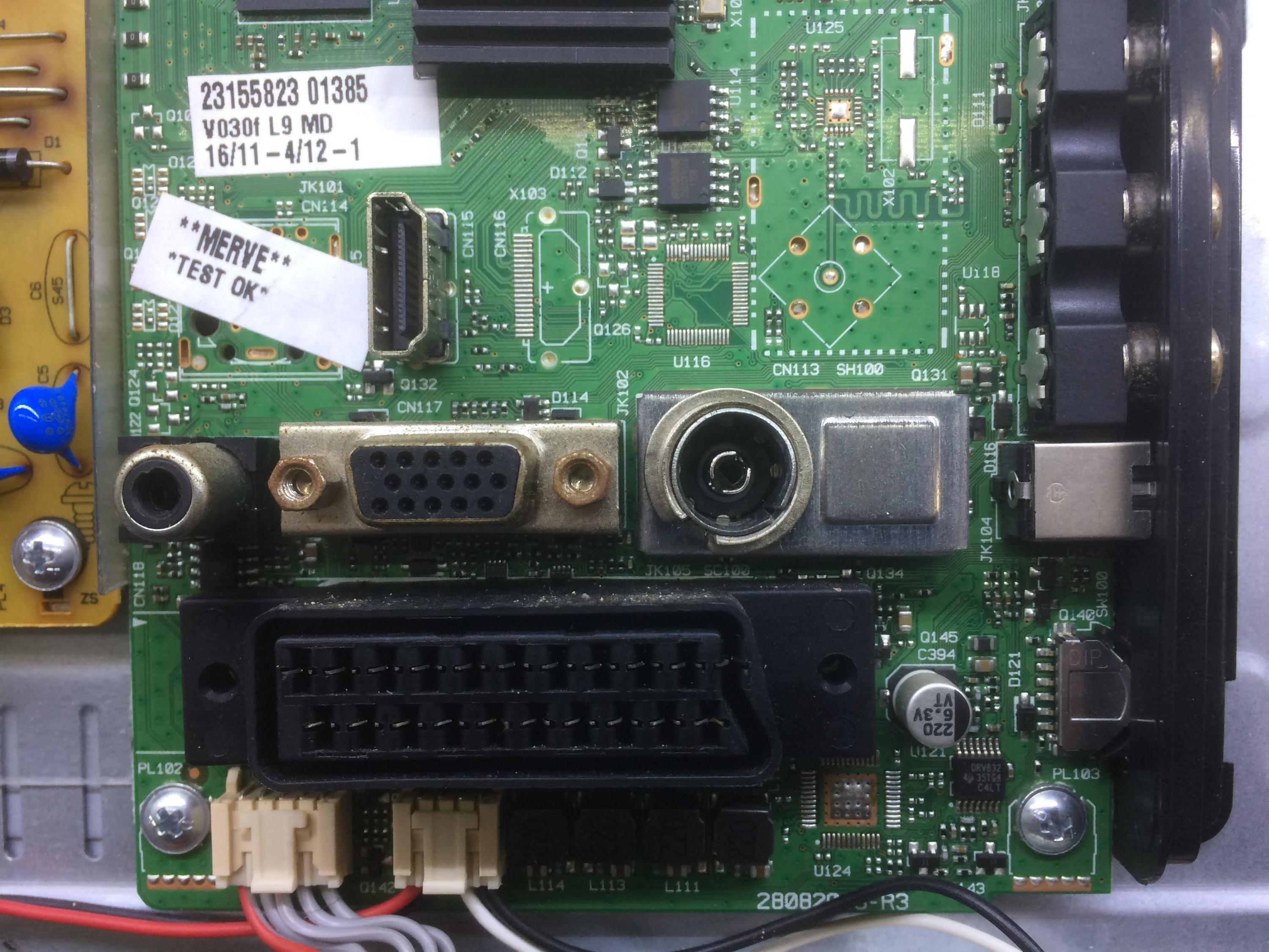

            Re: Power board vestel 17ips61-3 | Flash Red and Blue
            what is the mainboard number that is used in set 17mb55? what is the full model number of the tv?

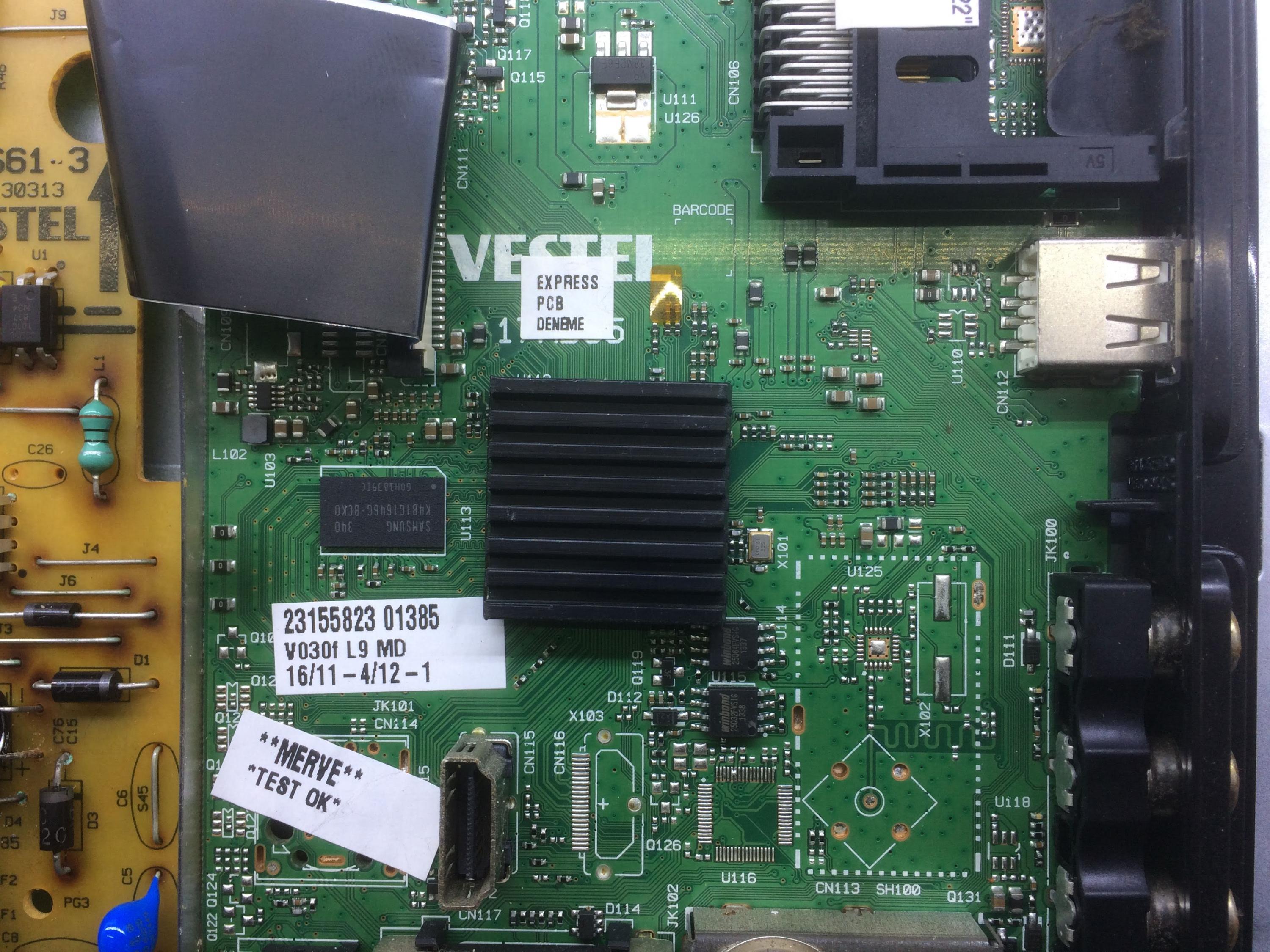

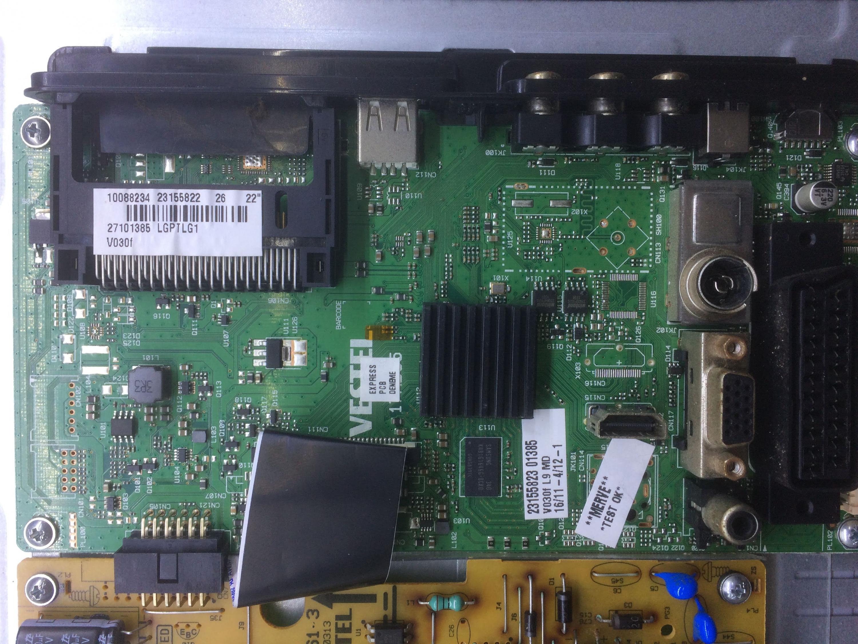

              Oh! I think this picture will help you.
              Please let me know if you need more details! Thanks for your support.
              Have a nice day!
                where it says vestel printed on the mainboard what is the number printed under the square sticker?

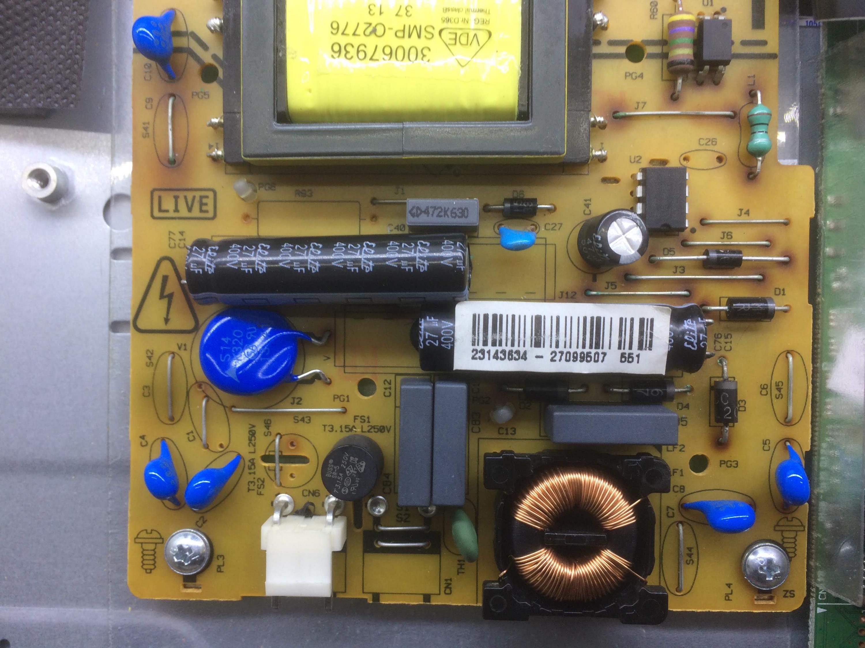

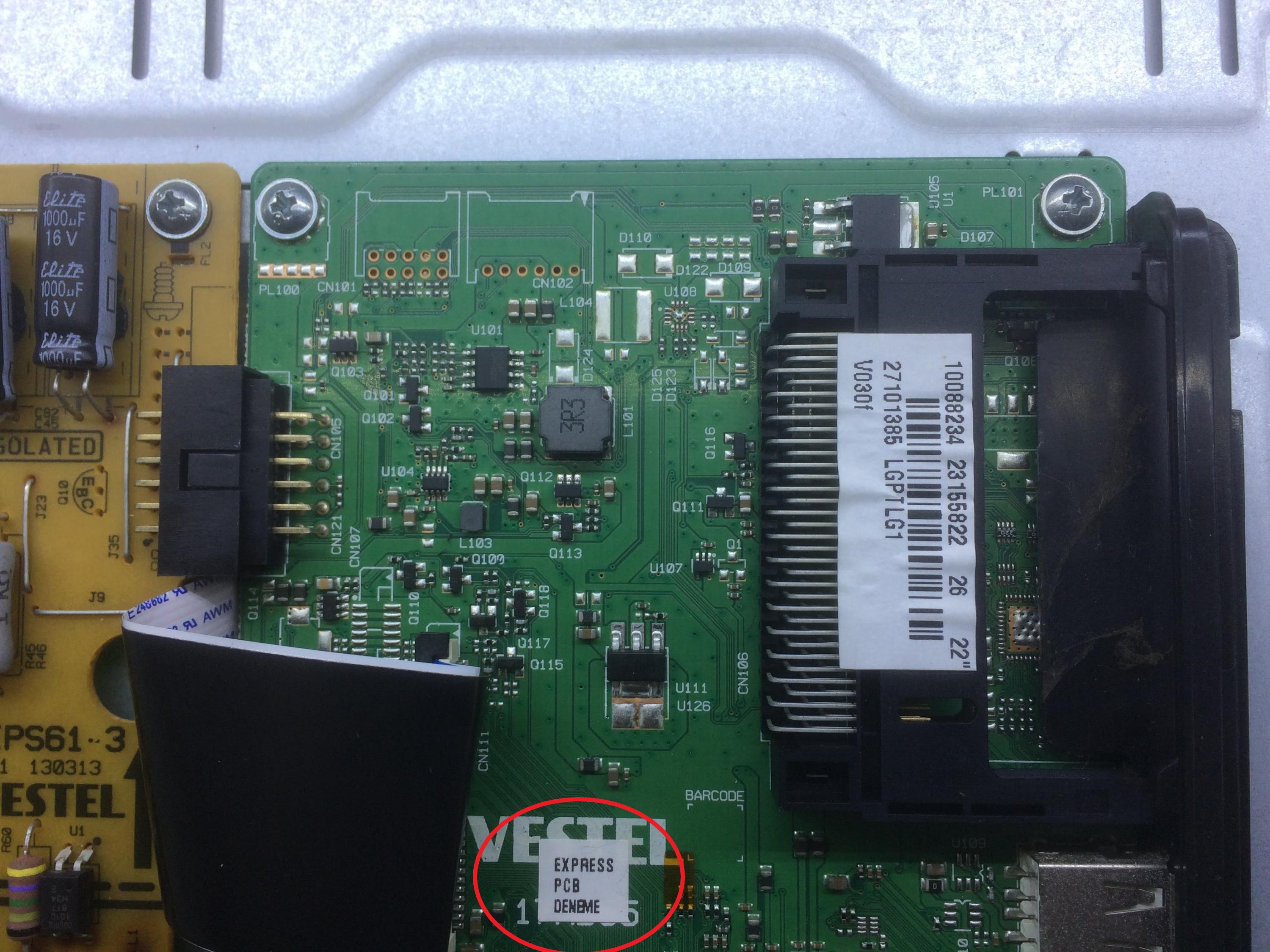

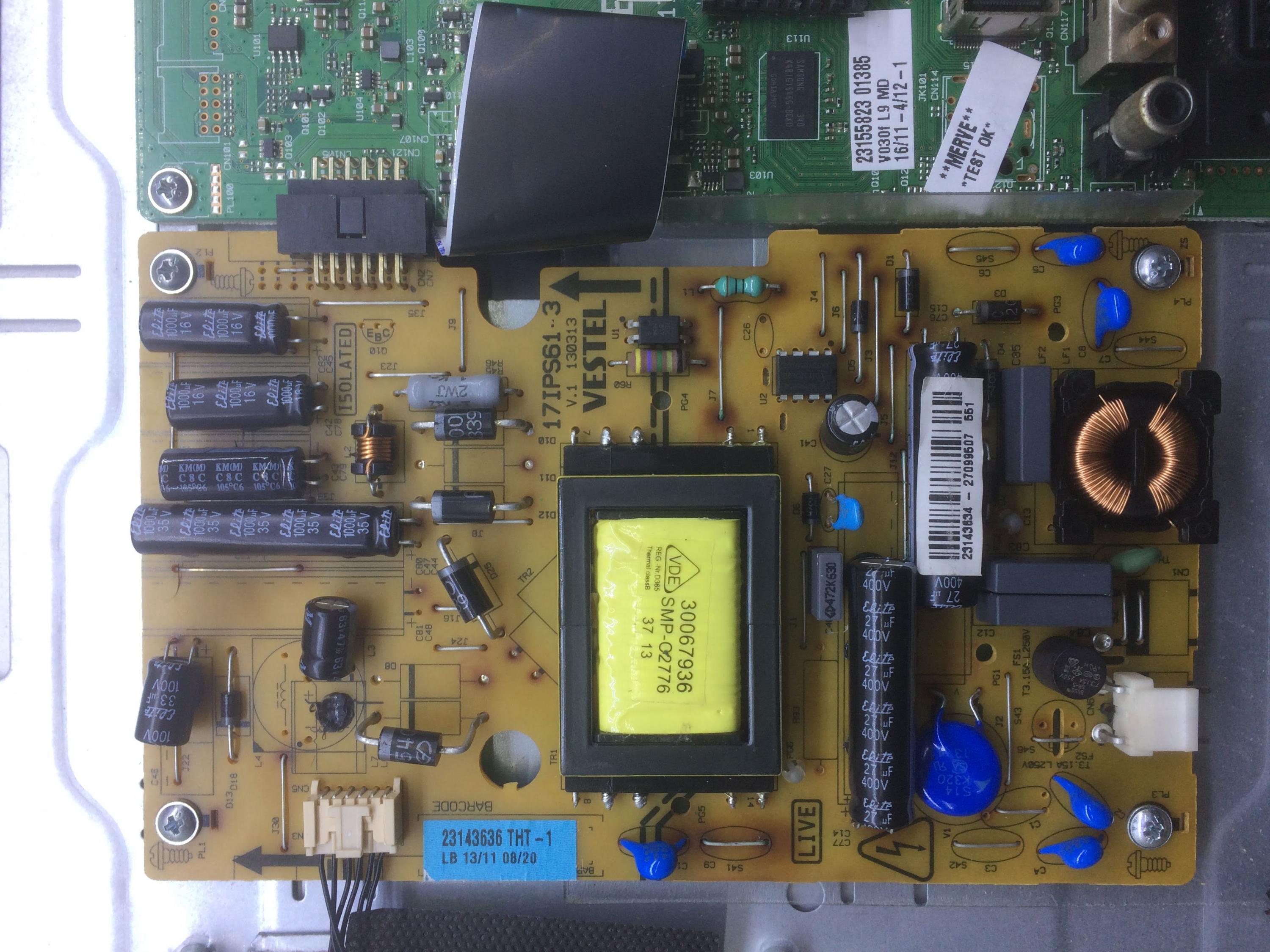

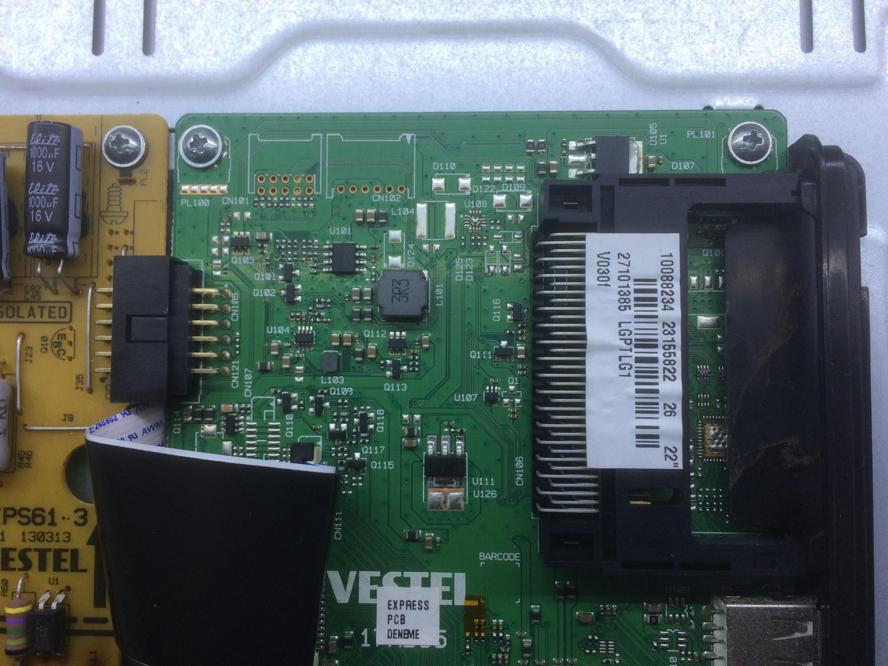

                  Hi, I'm sorry, but I'm not exactly understanding... I'm more a coding guy and not HW.
                  anyway, I attached all the pictures I have from the "power board" and the "green board".
                  I think the number you are referring is this:
                  23155823 01385
                  V030f L9 MD
                  16/11 - 4/12 - 1
                  The TV is a white brand and doesn't have a brand.
                  Hope it helps, if not, tell me what you need until I get it!
                  Anything you need to help me get this tv alive again.
                  Thanks.

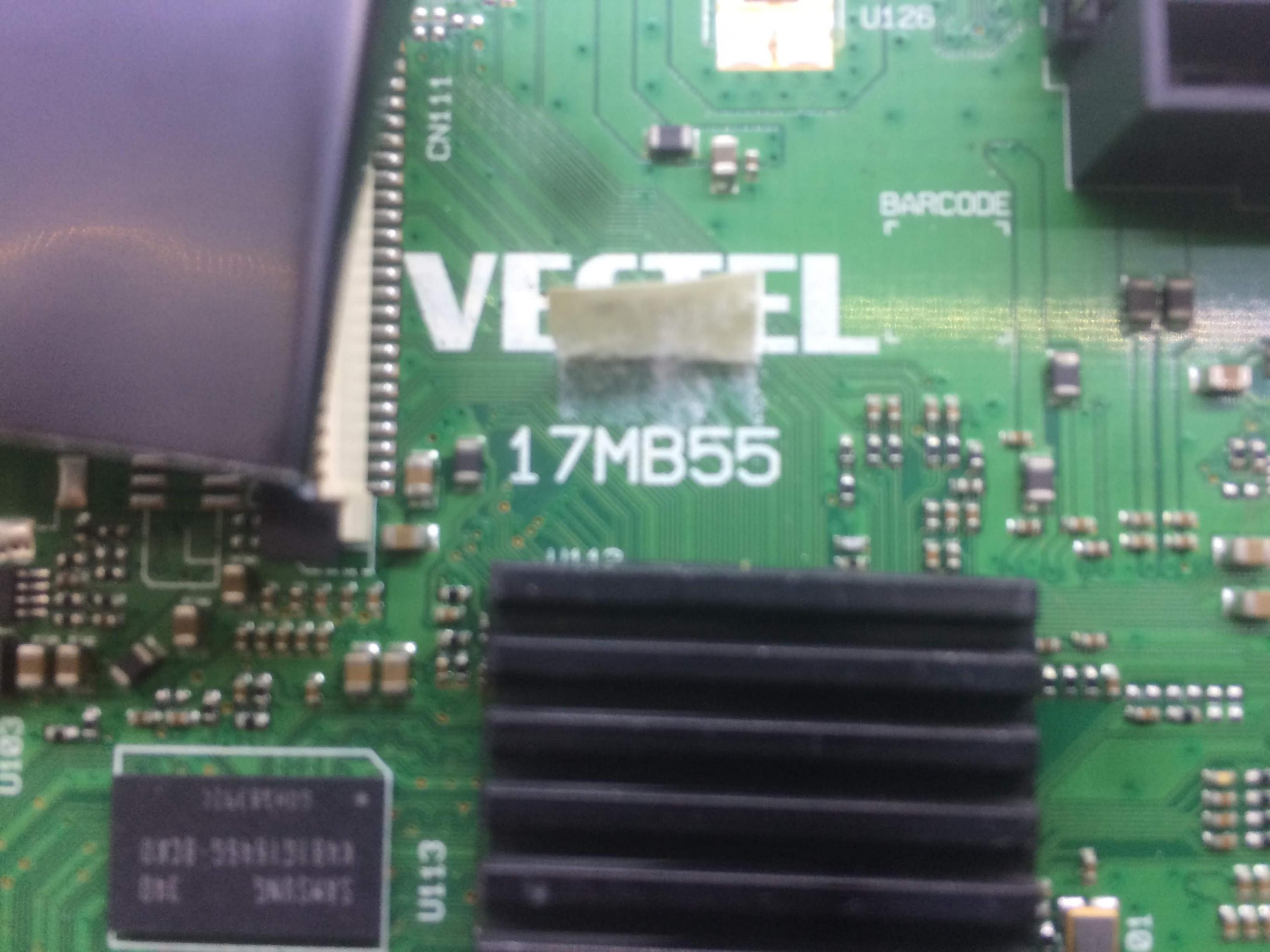

                    under the sticker i have highlighted in red there is a number printed onto the pcb as this could be a firmware issue we need to see what the mainboard number is
                      Oh! Shame on me, I looked several times for that sticker but I couldn't see the number. Soon as I get home I will give a look.
                      I don't know if this will help, but anyway.
                      This TV used to take a long time to show image. Around 30minutes, since its placed on a moisture place, I always thought that it could have some humidity inside and it needed to heat first before showing any image.
                      Recently, it doesn't show any image. As I described, I can turn on (red light) and it starts blinking between red and blue.
                      I measure the CAPS and Diodes, and they all look good. Even so, if you need me to take some additional measures, please let me know.
                        Have you tested the voltages on the psu are they all ok? have you got a schematic for the psu?
                          Hello @vinceroger69,
                          the number is: 17MB55
                          I checked the power supply, specially on the C2 connector and everything looks fine. I got 22v and 11v. Looks fine to me. I start to suspect the problem is relates with the main board.
                          Do you have any thoughts? Anything I can do?
                                        Hello all,
                                        unfortunently it still the same after flash. No image or any backlight.
                                        I don't think thats a power supply issue or, now we know, its not a FW issue. Every time I press the buttons of the remote the TV have some "normal" behavior. Looks the issue is related with the image itself.
                                        Any more tips? Now its a challenge to have it fixed!
