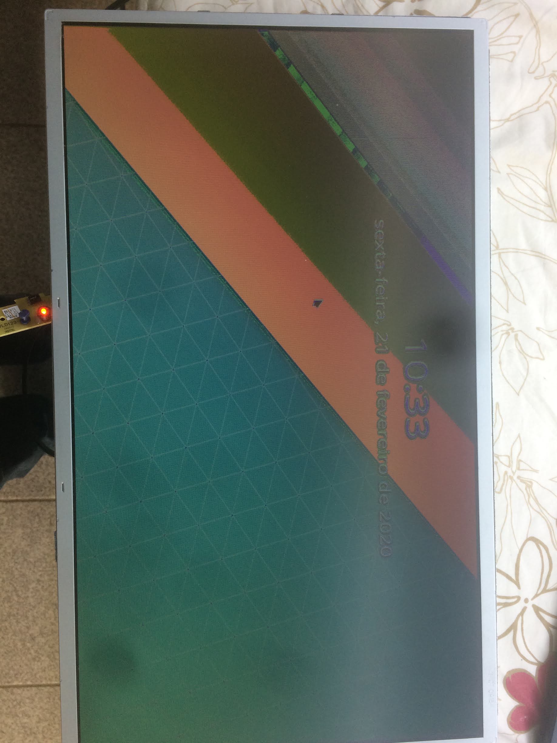

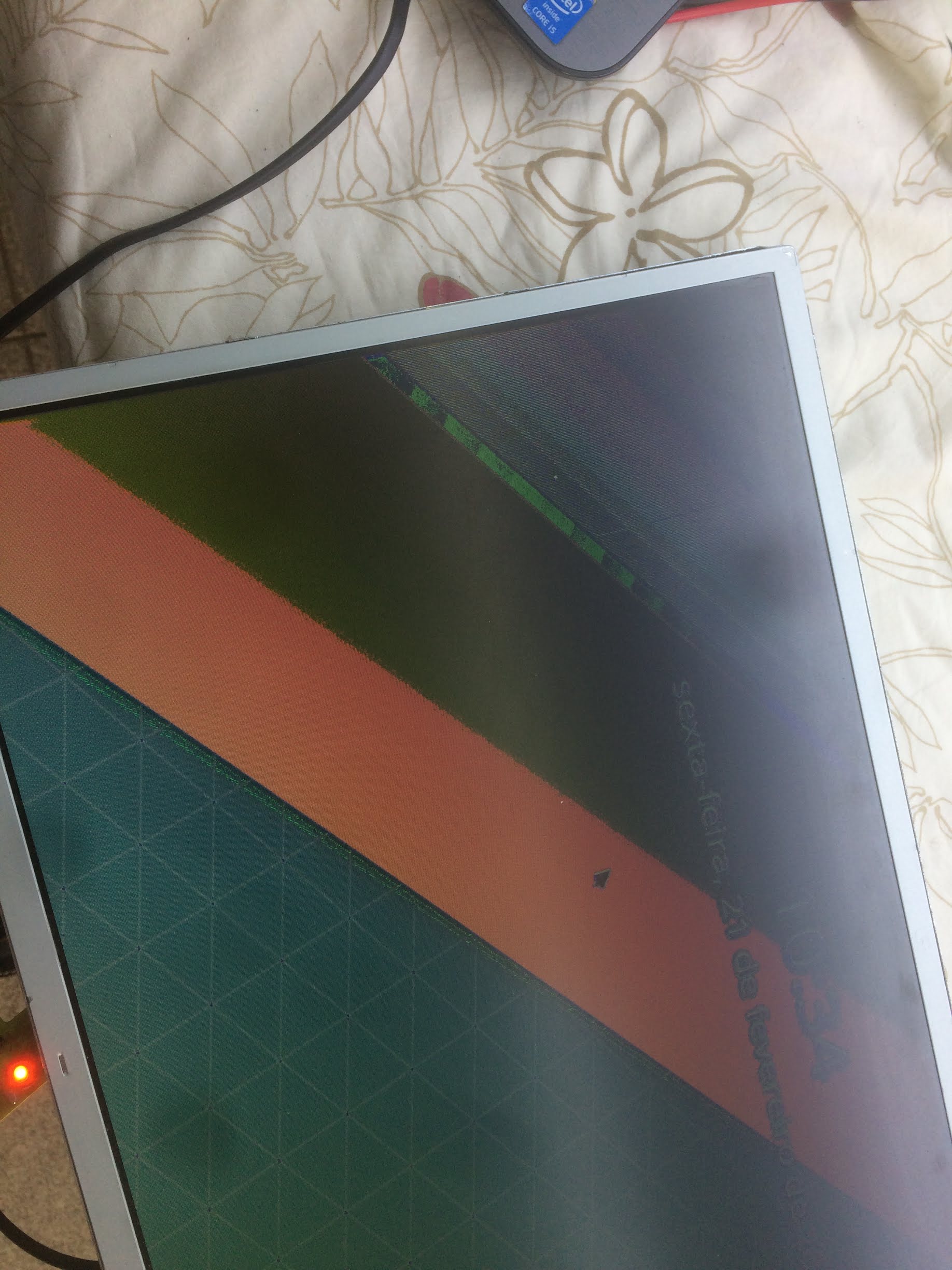

      Hello!
      So, I have some good and some bad news
      Good news: While I was checking the voltage on the bkl pin, one capacitor blown. Apparently he was working fine but... I replace it and now I have image
      Bad news: The image is a mess, I don't know if its the firmware or a damage screen. But its not possible to use on that way...
      Please see the pictures. It have the big triangle on the corner, but all screen is blurry... I'm not exactly sure how to describe.
      Thanks for everything.

        Glad you have got the backlight working do you get sound etc if you play a dvd etc through it i have never seen that screen fault before so im hoping a more experienced member can help/advise you.

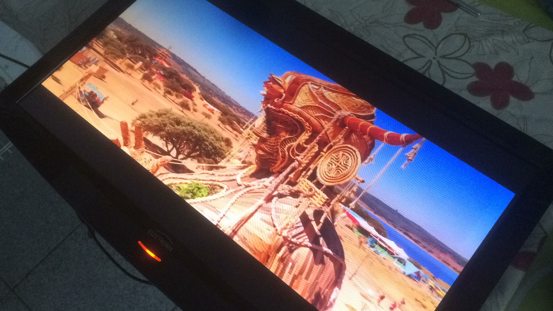

          I have some very good news!
          Everything is working fine. So, after everything you advised me, I was able to get the image. Today I found the issue was a bad connections on the LCD Flat cable. I opened and closed so many times the TV, maybe it got fault during the process.
          I don't have words to express how grateful I'm with your support.
          Thanks to vinceroger69 and yokoono support I was able to fix my tv!
          A huge thanks for you and all the community that make this forum alive.
          Have a great day!
