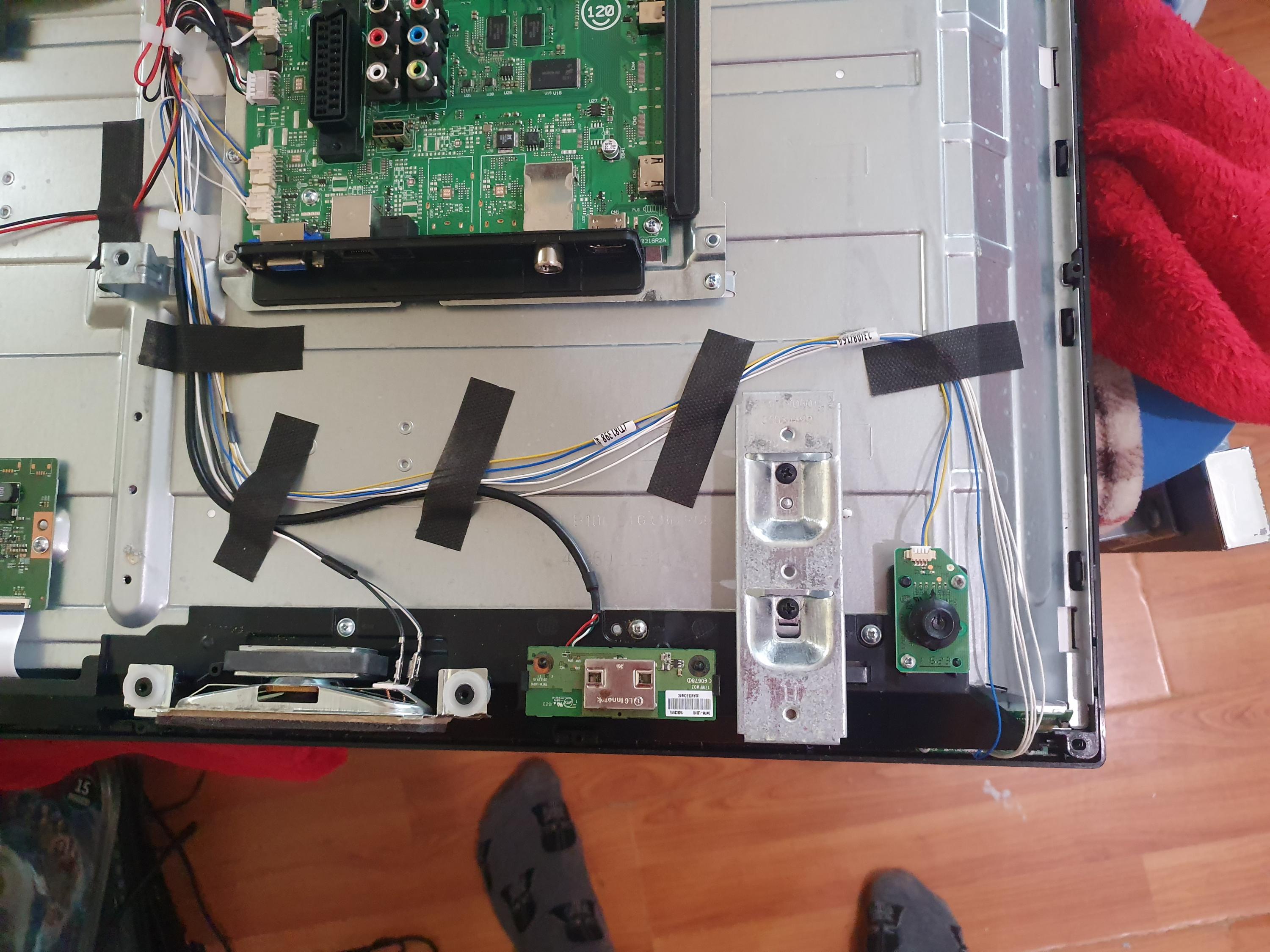

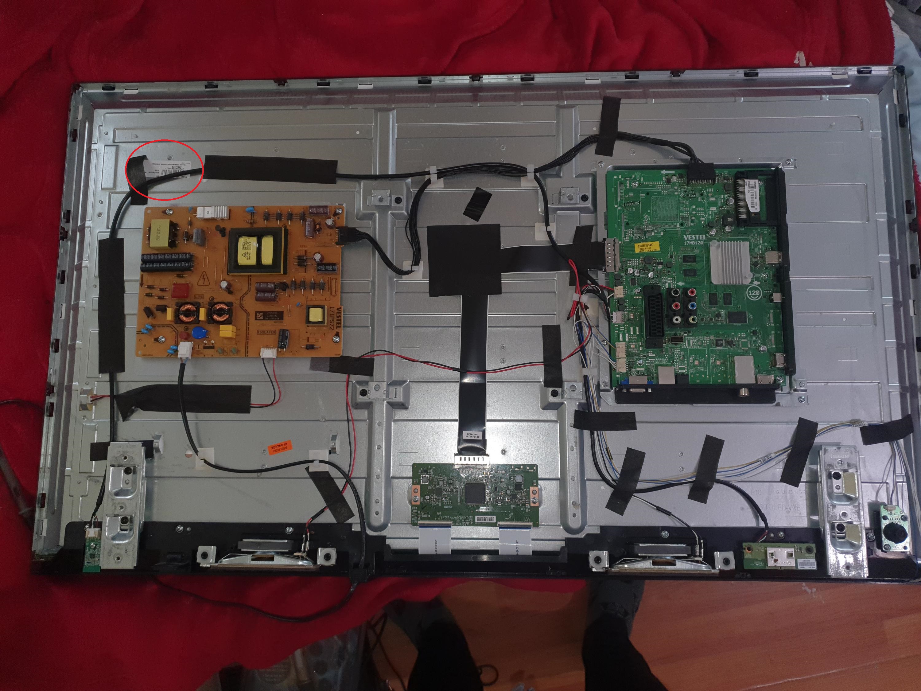

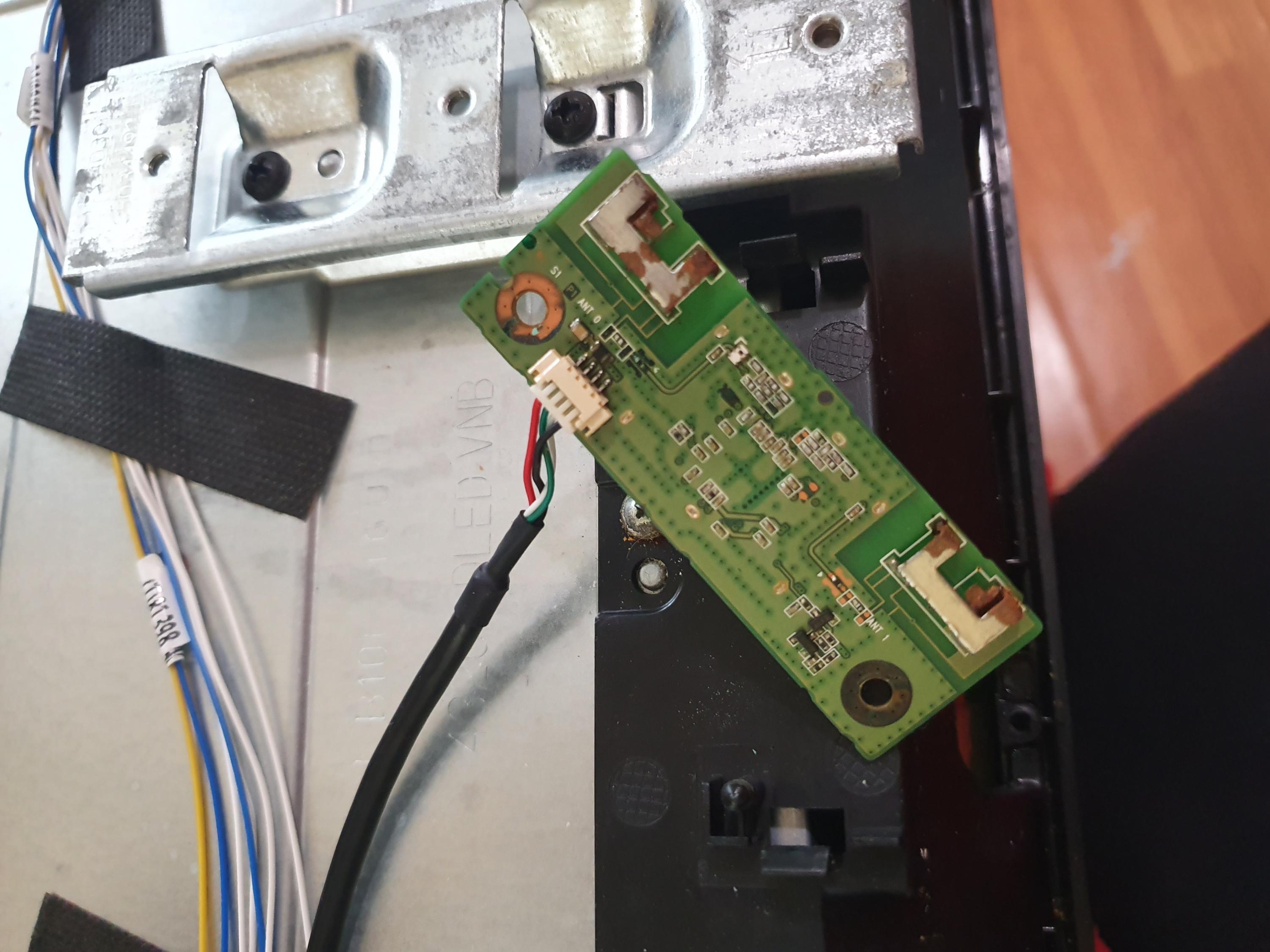

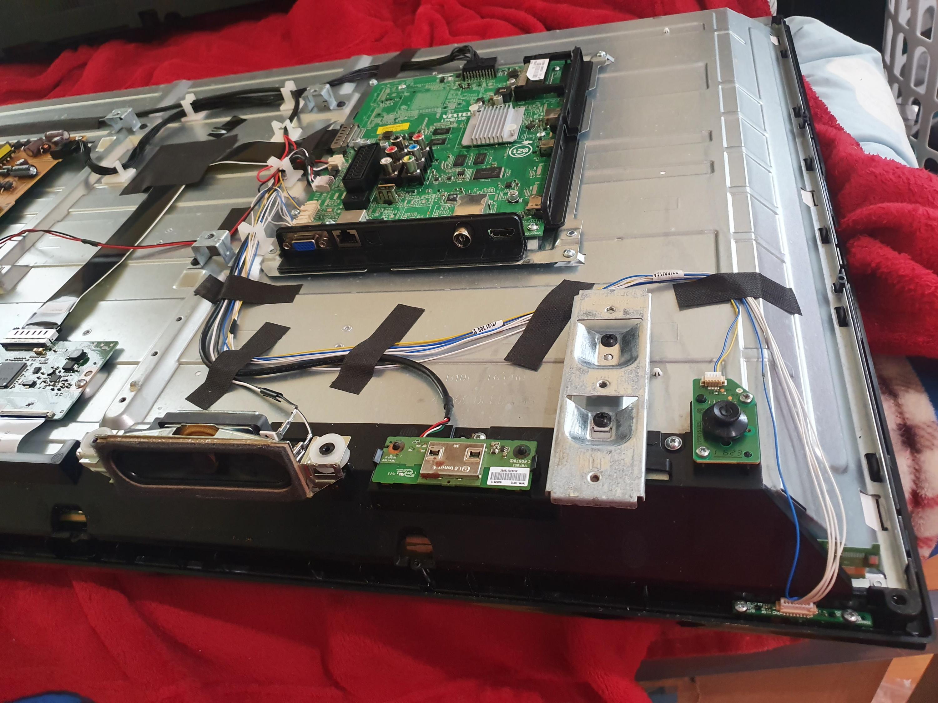

      Re: Finlux 43utd297b-p won't turn on
      Attached are the photos of the TV boards.
      The bottom right corner is where this business was made. There is a card with a small amount of rust so I take it this is the correct area.
      However, upon a quick google search, it shows that is just the Wifi card for the TV so I disconnected this and the TV would still not power up. Indicating this is not where the problem lies.
      As you can also see from the photos there's a strip which runs behind where this card is and I have no idea what that does or if there has been any damage to this.
      Could this also be as simple as the switch for the TV has been damaged so won't turn on as that is also in the area of impact?

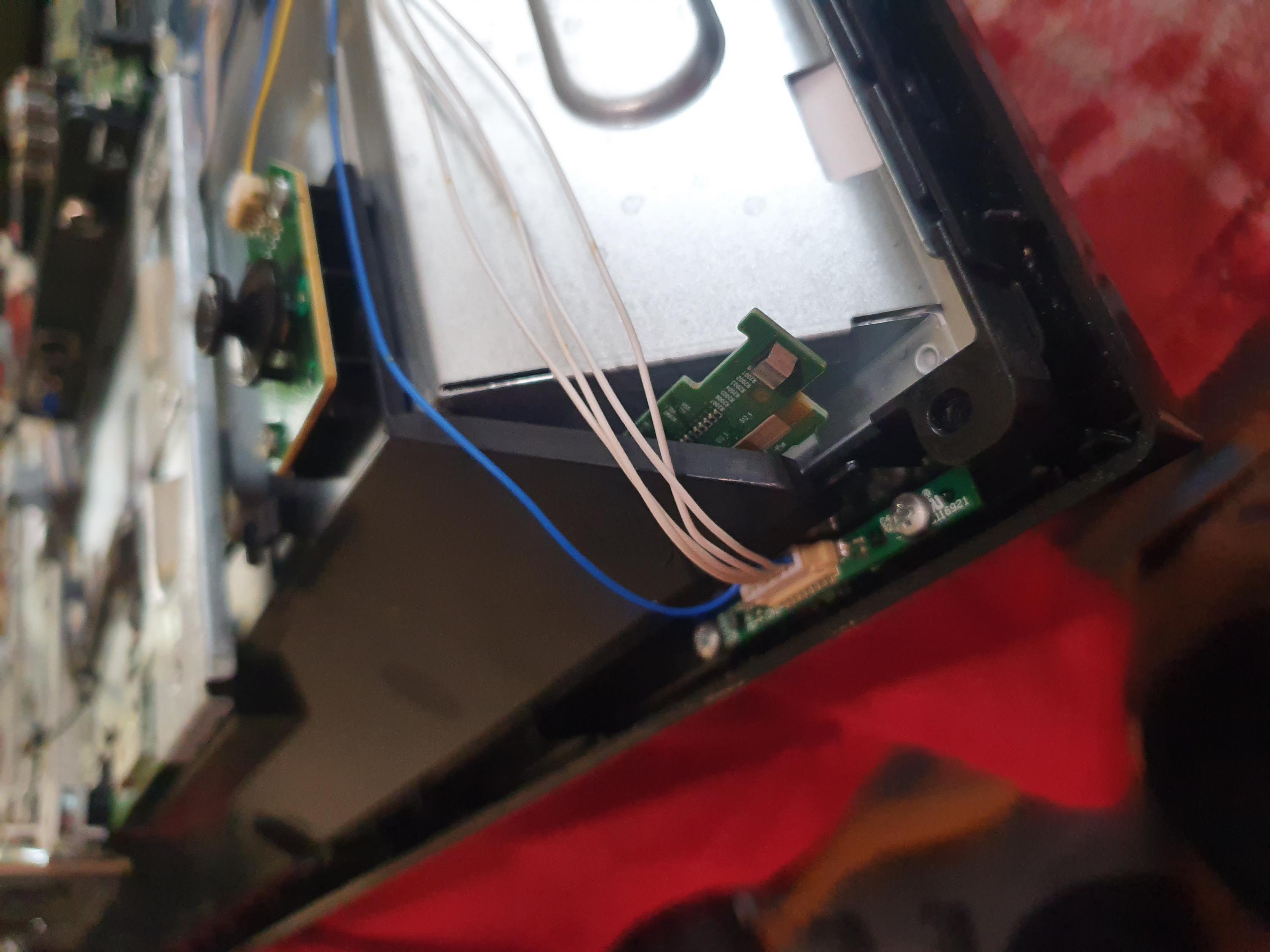

              I would guess the cat pissed on the panel and it damaged the board that connects the panel to the t-con. Try disconnecting the LVDS cable from the t-con board and see if the tv turns on.
              What is with that board between the plastic and metal frame in the last picture, that does not look right, did you remove it?
