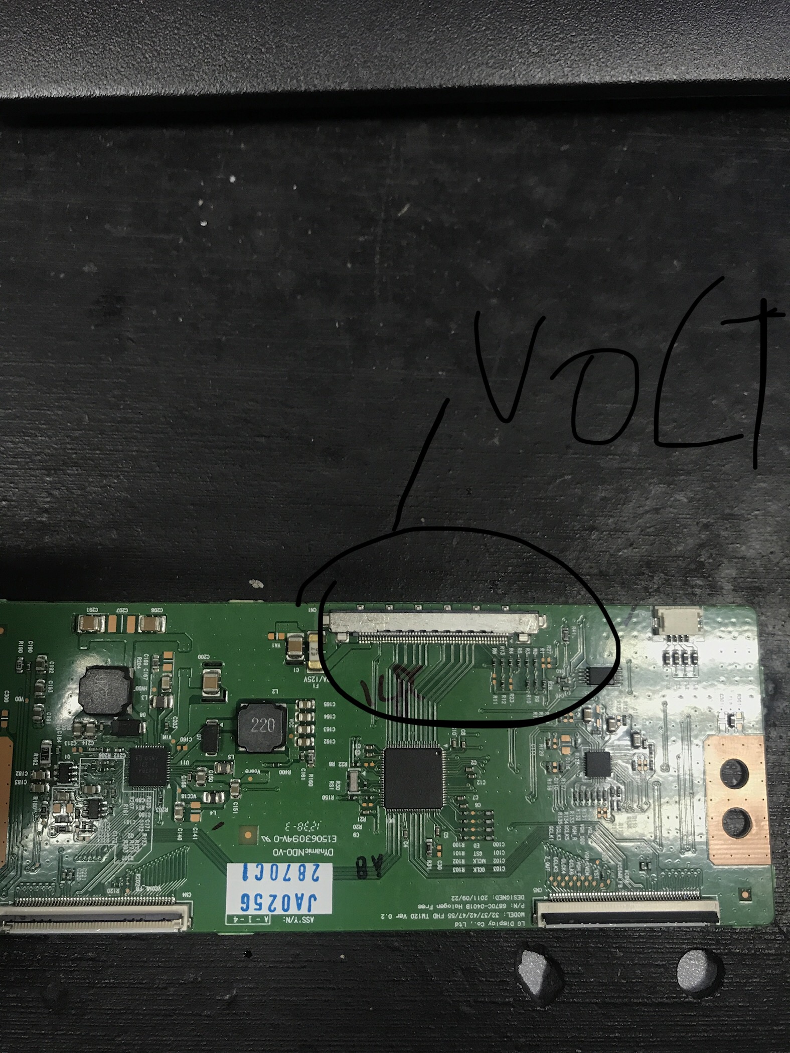

    hi everyone i have tcon pn :6870c-0401b halogen free i need shcematic or voltage in connector lvds

    Only known voltage is the 12V you can measure on the fuse. The rest are data lines

      Re: T - Con shcematic or voltage
      i have 12 v . 3,3 or 5v i not have
        And VGH, VGL ?.
          Vgh-f -5 v vgl -5v
            Search on the board for a little solder dot whit the writing V_ON. That should be you LCD panel voltage if the T-CON power supply is working correctly. There are also other voltages to supply your ICs also usually written on the board near a solder dot (example V1.1 means at that point you should have 1.1V) .
              in t-con or main bord ? problem is no display is black scren nothink . i remove conector lcd from tcon display stay white . this is not tv is matherboard pc
                  Can we see good clear straight shot of the whole T-CON board?
                    On the T-CON. Even whit the 2 connectors to the LCD disconnected you have power, as long you don't disconnect the cable to the main board.
