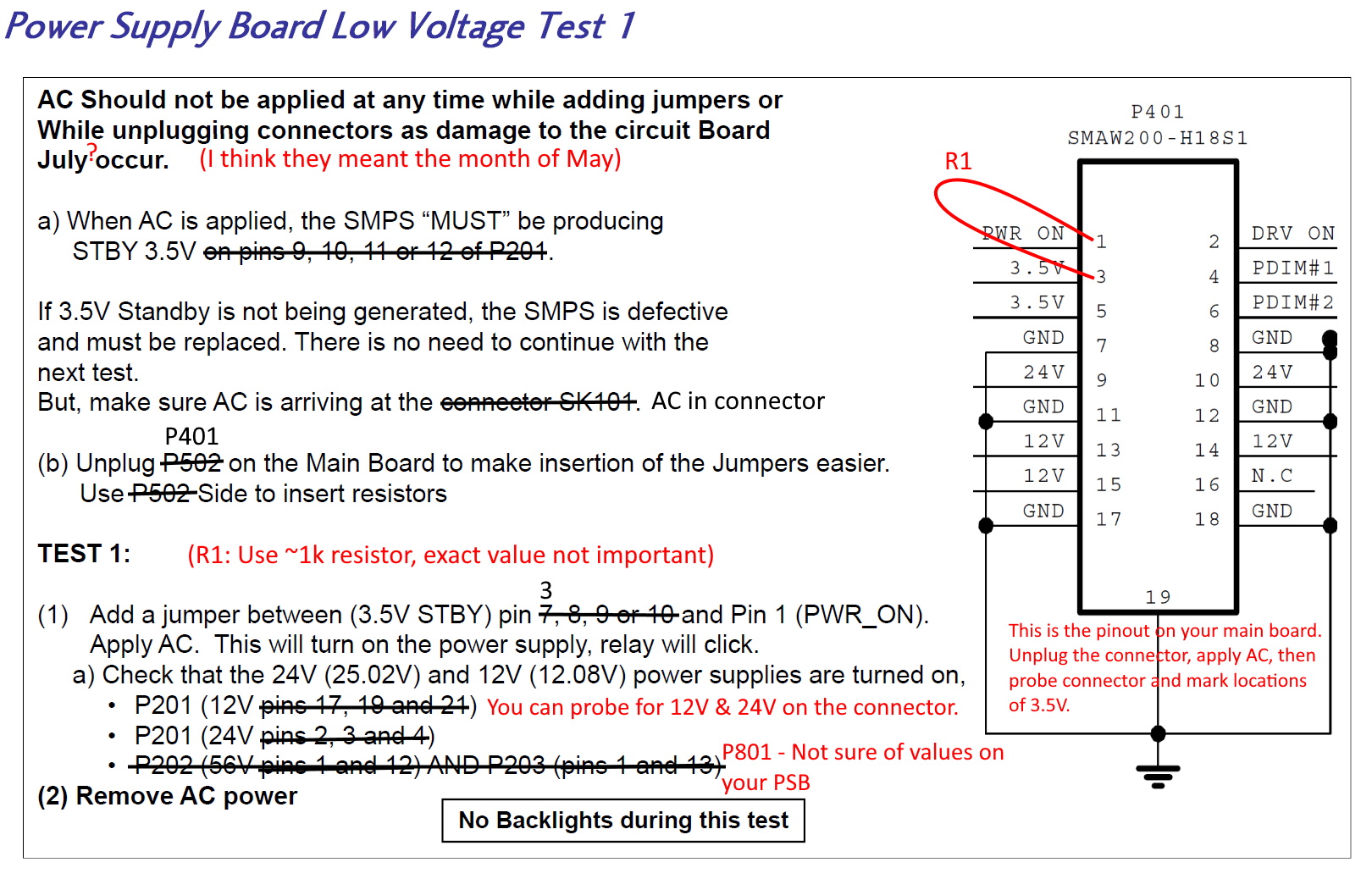

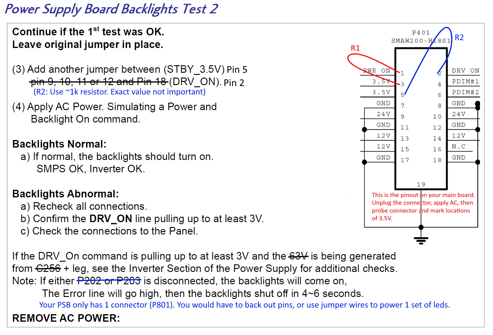

                              While you're waiting on the eeprom, why don't you run a couple of tests to make sure that the PSB and LEDs are good. See attached diagrams.
                              Edit: Once you have the resistor jumpers in the connector, put something like cardboard down, so that if you lay the connector down, the resistors do not short on the chassis or main board.

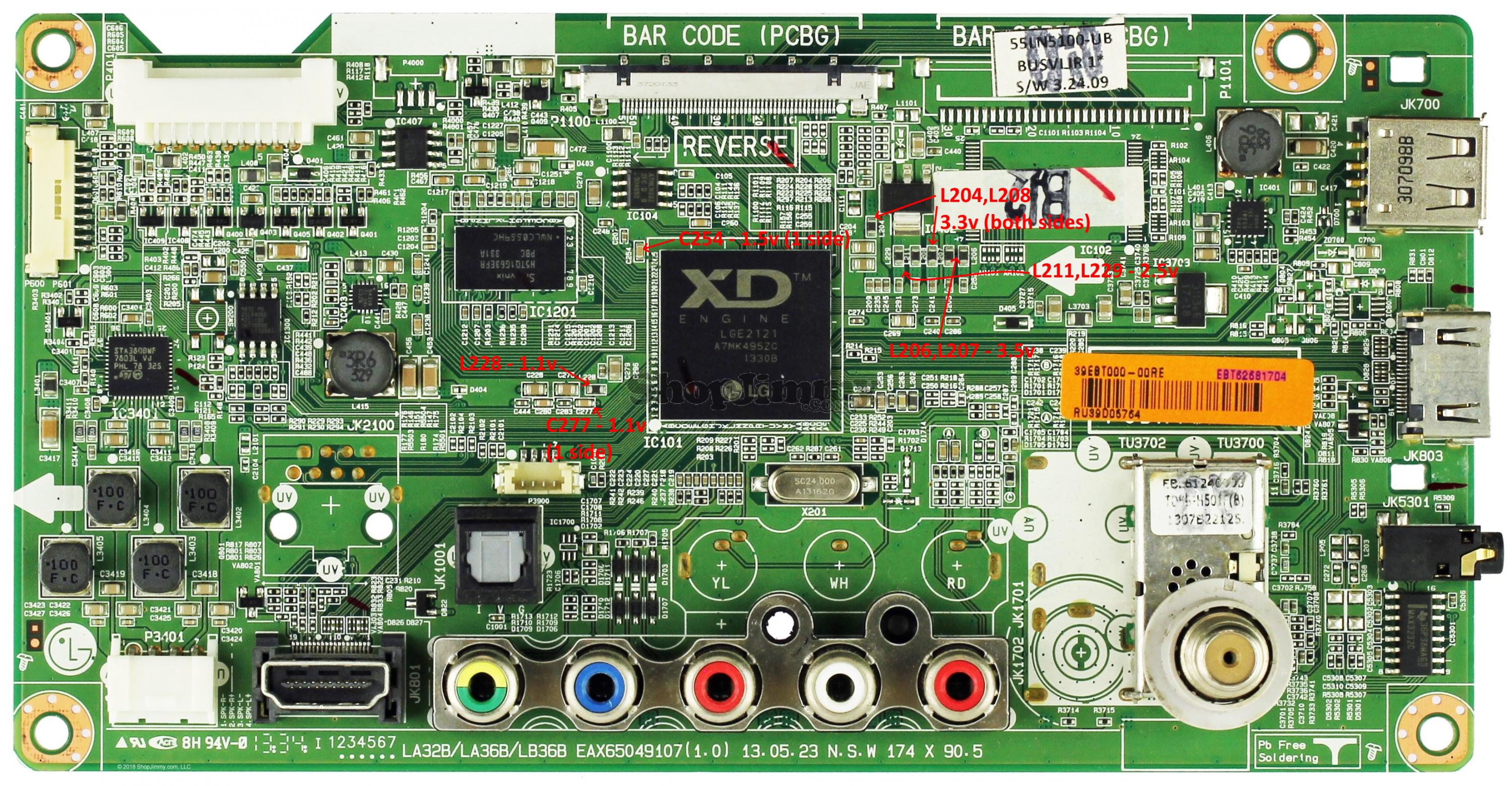

                                        Before you toss that main board, do you want to check some of the required voltages?
                                        I'm including the SM for a 47LN54**. The main board in that set is also used in the 55LN5400. I believe the only difference in the "5100" is that it doesn't have the SmartShare option.
                                          Sorry I already ordered a new main board before you posted that
