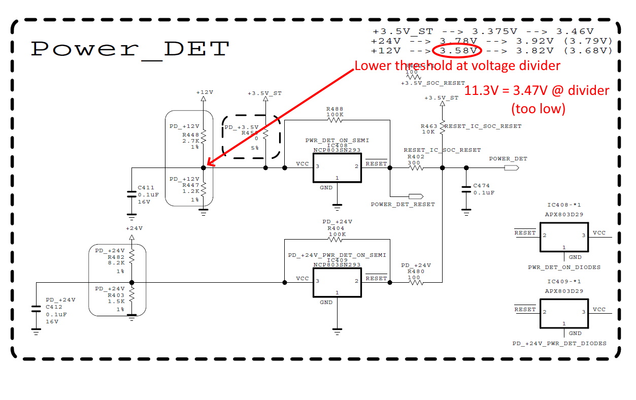

                          #52
                          Re: Another LG, 55ln5100 power issues
                          I don't believe that 11.3V is high enough to clear the Power Detect on the main board (see attached). Whatever is pulling down the 12V, may be pulling it down slow enough (relative to processor speed), That the power detect instruction is cleared before the voltage reaches the minimum threshold. Once it goes below that threshold, a flag bit is set on the IC. When you turn it off and on with the power button, you are not resetting any flag bits, because standby voltage is still there. When you unplug and replug, you are clearing all flag bits, and the process starts over.
                          Either the PSB is not putting out its rated 12V, or something on t-con or panel is pulling it down. That part would be putting out some heat if you want to try freeze spray.

                              #54
                              Thanks for the info will62
                              Budm. I read your previous post as you wanted me to plug the lcd to tcon while I had the backlights on. However no picture appears, just a lit up screen. I'm just about ready to wave the white flag on this one
