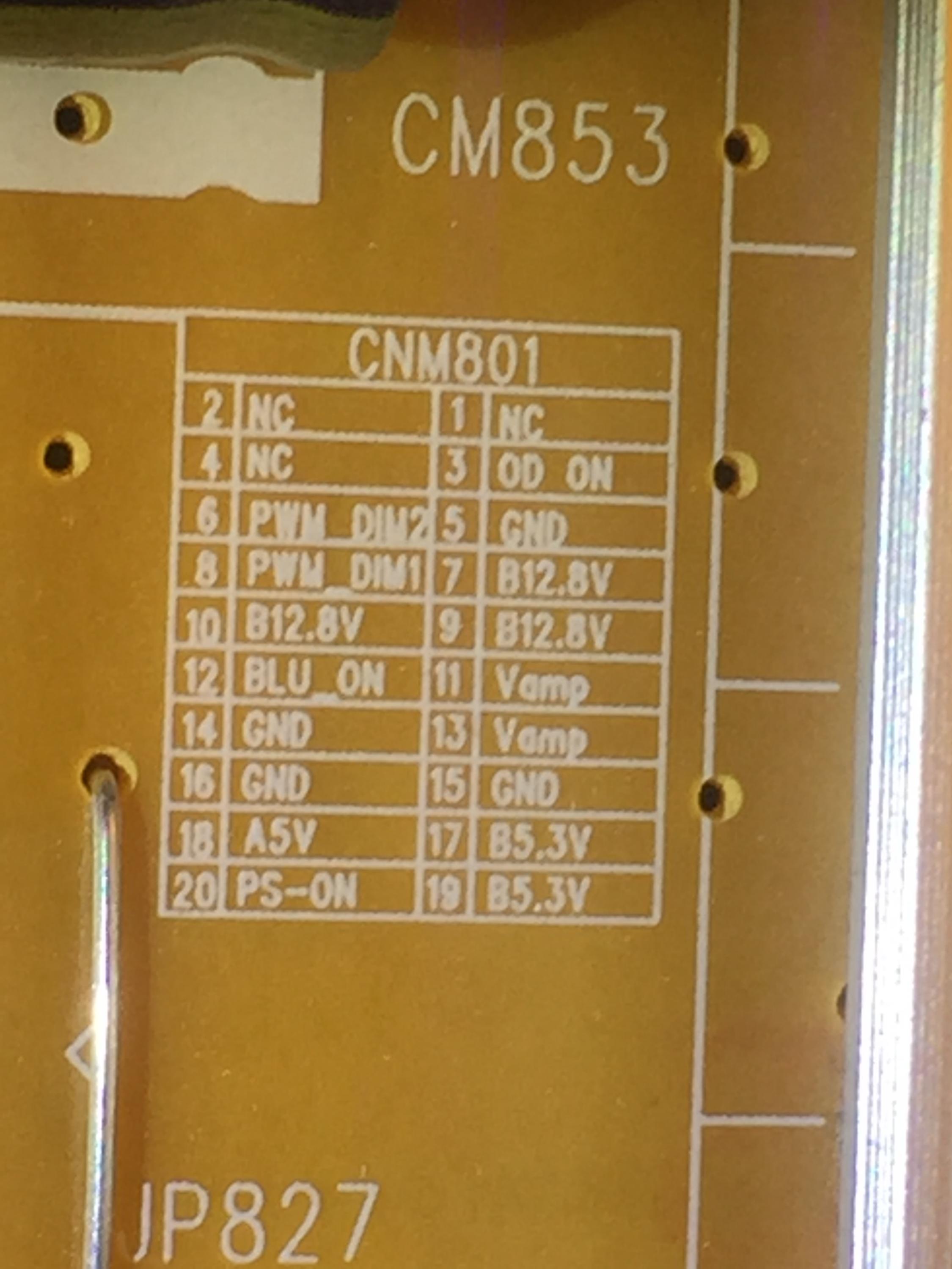

                              I am back with a heat gun after 3 months out of town.
                              I have tried to reflow the processor. This time when power is turn on, I get the black light on but no image on the screen. Also, the standby red light comes on and keep on flashing 5 times and repeats like before.
                              When testing the connector from mainboard to powerboard, I got the following voltages.
                              PIN 1 NC = 3.3V
                              PIN 2 NC = 3.3V
                              PIN 3 OD ON = 1.786V
                              PIN 4 NC = 3.3V
                              PIN 5 GND = 0V
                              PIN 6 PWM DIM2 = 1.94-2.04V
                              PIN 7 B12.8V = 12.35V
                              PIN 8 PWM DIM1 = 1.94-2.04V
                              PIN 9 B12.8V = 12.47V
                              PIN 10 B12.8V = 12.36V
                              PIN 11 Vamp = 12.47V
                              PIN 12 BLU_ON = 0V
                              PIN 13 Vamp = 12.34V
                              PIN 14 GND = 0V
                              PIN 15 GND = 0V
                              PIN 16 GND = 0V
                              PIN 17 B5.3V = 5.39V
                              PIN 18 A5V = 5.4V
                              PIN 19 B5.3V = 5.39V
                              PIN 20 PS-ON = 3.33V
                              Did I damage the processor during the reflow?
                              What further can I do to try fix this tv?

                                  #36
                                  Re: Samsung UN60ES6100F black screen with standby led flashing 5 times
                                  OP post #34:
                                  PIN 1 NC = 3.3V
                                  PIN 2 NC = 3.3V
                                  PIN 12 BLU_ON = 0V
                                  That must be an reading error. You have backlights but BL-ON is 0V so that cannot be right. N.C. pins which are Not Connected should not be showing 3.3V
                                  But at this you do have backlights now but no Video, then check the Voltage on the T-CON fuse as suggested.
                                  Do you get sound at this point?

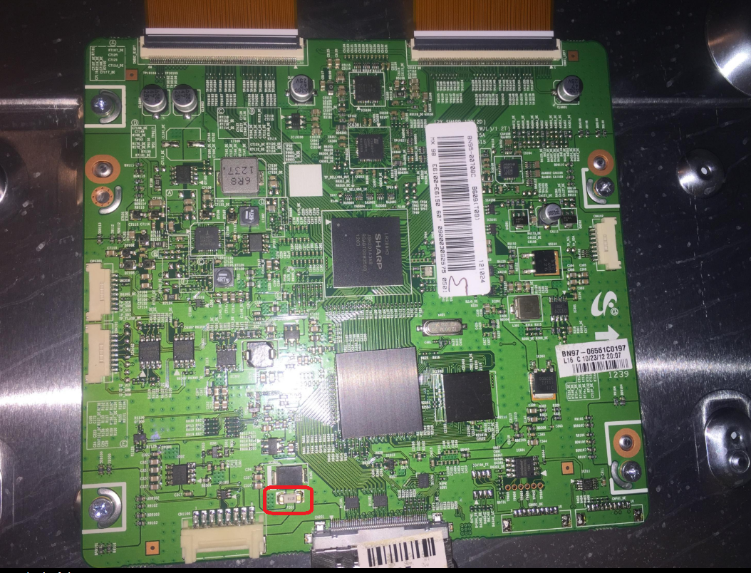

                                      #38
                                      So backlight are on now but no picture right? did you check the tcon fuse, see if you have about 12 volts on each side of the fuse, black - probe on metal chassis ground red + probe on each end of fuse.
                                      Thanks for your reply.
                                      Yes, now backlight is on but no picture.
                                      Sorry, I do not know which is the T-con fuse. Could you please mark it on the attached photos so that I can check accordingly?

                                        #39
                                        Your T-CON fuse is the white SMT component that i circled.
                                        -Thomas

                                          #40
                                          Originally posted by budm
                                          OP post #34:
                                          PIN 1 NC = 3.3V
                                          PIN 2 NC = 3.3V
                                          PIN 12 BLU_ON = 0V
                                          I have double checked the readings. They are okay. Since the pins are arranged in two columns as shown on the photo, if I made mistake on the columns, then the correct readings should be as follows. Would that make more sense?
                                          PIN 2 NC = 3.3V
                                          PIN 4 NC = 1.786V
                                          PIN 6 PWM DIM2 = 0V
                                          PIN 8 PWM DIM1 = 12.35V
                                          PIN 10 B12.8V = 12.35V
                                          PIN 12 BLU_ON = 12.47V
                                          PIN 14 GND = 12.47V
                                          PIN 16 GND = 0V
                                          PIN 18 A5V = 5.39V
                                          PIN 20 PS-ON = 5.39V
                                          PIN 1 NC = 3.3V
                                          PIN 3 OD ON = 3.3V
                                          PIN 5 GND = 1.94-2.04V
                                          PIN 7 B12.8V =1.94-2.04V
                                          PIN 9 B12.8V = 12.36V
                                          PIN 11 Vamp = 0V
                                          PIN 13 Vamp = 0V
                                          PIN 15 GND = 0V
                                          PIN 17 B5.3V = 5.4V
                                          PIN 19 B5.3V = 3.33V
                                          Yes, I got 12V at both ends of the T-CON fuse. (Thanks ngth82 for advising which component is the T-CON fuse)
                                          At this point, I do not get sound from the tv. May be the tv is at the mode (such as menu mode) which should not have sound.
