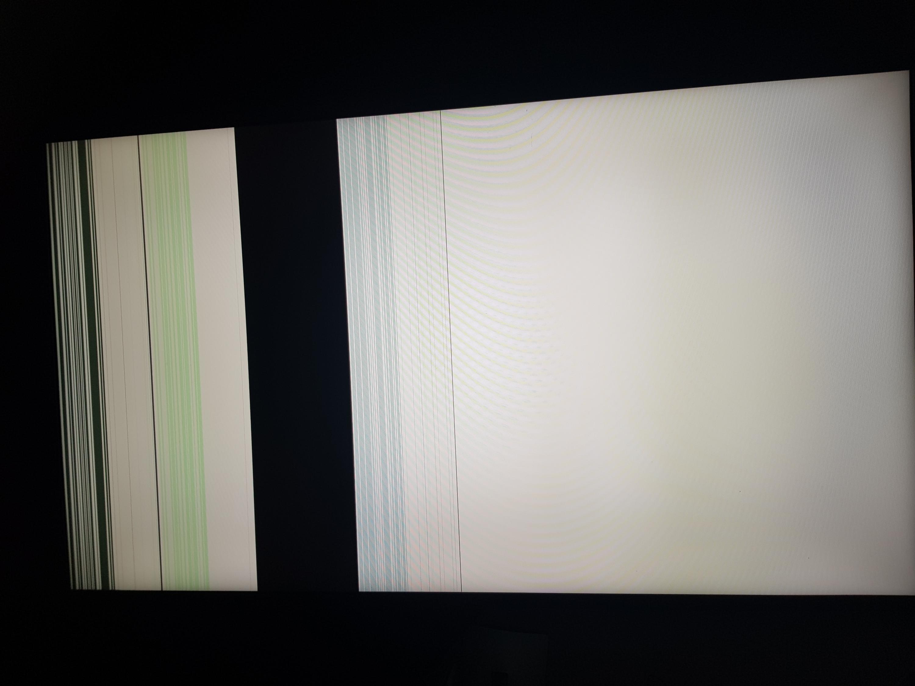

Hitachi 50HYT62U no picture
  • Bloopeta
    replied
    Re: Hitachi 50HYT62U no picture
    Originally posted by budm
    Show us the pictures of the boards that are connected to the LCD panel..
    Hope these help as hard to fit all in pic with being long
    Leave a comment:
    replied
    Re: Hitachi 50HYT62U no picture
    Show us the pictures of the boards that are connected to the LCD panel..
    Leave a comment:
  • Bloopeta
    replied
    Re: Hitachi 50HYT62U no picture
    Originally posted by budm
    "Doesnt appear to be any damage to anything. Which board is the driver board??"
    So you remove the LCD frame to get to the T-CON/Tab bonding boards?
    Yes, Ive had the screen out n checked the backlights whilst I was on
    Leave a comment:
    replied
    Re: Hitachi 50HYT62U no picture
    "Doesnt appear to be any damage to anything. Which board is the driver board??"
    So you remove the LCD frame to get to the T-CON/Tab bonding boards?
    Leave a comment:
  • Bloopeta
    replied
    Re: Hitachi 50HYT62U no picture
    Guess you could test your caps on the driver board for shorts or very low ohms.
    Originally posted by budm
    The LCD panel has integrated T-CON board and also located at the bottom edge of the LCD panel which is easily damaged by the cleaning liquid, so inspect the T-CON/Tab bonding board for damages and also check the caps resistance as suggested.
    Doesnt appear to be any damage to anything. Which baord is the driver board??
    Leave a comment:
    replied
    Re: Hitachi 50HYT62U no picture
    The LCD panel has integrated T-CON board and also located at the bottom edge of the LCD panel which is easily damaged by the cleaning liquid, so inspect the T-CON/Tab bonding board for damages and also check the caps resistance as suggested.
    Leave a comment:
  • nomoresonys
    replied
    Re: Hitachi 50HYT62U no picture
    Guess you could test your caps on the driver board for shorts or very low ohms.
    Leave a comment:
  • Bloopeta
    replied
    Re: Hitachi 50HYT62U no picture
    Originally posted by Bloopeta
    If I unplug the left ribbon, I get no change.
    If I unplug the right ribbon, I get the attached pic
    Just hoping its not the LCD panel thats at fault :/
    Leave a comment:
  • Bloopeta
    replied
    Re: Hitachi 50HYT62U no picture
    Originally posted by budm
    What do you get on the screen if you only have one ribbon cable between LCD panel and the T-CON connected one at a time?
    If I unplug the left ribbon, I get no change.
    If I unplug the right ribbon, I get the attached pic
    Leave a comment:
    replied
    Re: Hitachi 50HYT62U no picture
    What do you get on the screen if you only have one ribbon cable between LCD panel and the T-CON connected one at a time?
    Leave a comment:
  • nomoresonys
    replied
    Re: Hitachi 50HYT62U no picture
    Any chips on the tcon or mainboard getting really hot?
    Leave a comment:
  • Bloopeta
    replied
    Re: Hitachi 50HYT62U no picture
    Try unplugging the wifi module, check for any change.
    Tried that, no change.
    Also tried holding power button for 60 seconds, plugging in tv, and continuing to hold a further 60 seconds
    Leave a comment:
  • nomoresonys
    replied
    Re: Hitachi 50HYT62U no picture
    Try unplugging the wifi module, check for any change.
    Leave a comment:
  • Bloopeta
    replied
    Re: Hitachi 50HYT62U no picture
    See if you have about 12 volts on each side of the fuse on tcon board.
    12.08v on each side
    Leave a comment:
  • nomoresonys
    replied
    Re: Hitachi 50HYT62U no picture
    See if you have about 12 volts on each side of the fuse on tcon board.
    Leave a comment:
  • Bloopeta
    started a topic Hitachi 50HYT62U no picture
    Hitachi 50HYT62U no picture
    Hitachi 50HYT62U, has backlights but no picture, just completely blank screen, any ideas anyone??
  • mecha1166
    KDL-60EX500. Comes on fine, sound is fine, backlights come on. Blank screen.
    by mecha1166
    KDL-60EX500. Comes on fine, sound is fine, backlights come on. Blank screen. Already tried reset POWER/VOL-. Anyone else have this problem? Possibly bad T-Con RUNTK4244ZZ or panel? Could main or power supply cause this? There were 2 blown 560u 35v on power going to backlights but they were still working fine. Thanks for your help.
    11-25-2024, 05:22 PM
  • KYBOSH
    Hitachi 55HDS69 55" Plasma TV - No Picture But Sound
    by KYBOSH
    Picked up a bahemoth plasma TV not too long ago and just now getting around to looking at it.
    No picture but you hear the TV static (white noise) playing loud and clear.
    The back was already taken off (and no screws were provided) as the previous owner had already taken a look.
    But it seems they didn't get too far and just left it.
    When I first took a look I was amazed at how pristine the inside looked.
    Its as if the TV had been in a time capsule.
    Caps looked like they were just pulled off the self.
    Copper coils had no sign of corrosion on...
    02-01-2023, 11:10 PM
  • DXseekerMO
    TCL 55US57 backlights, no picture.
    by DXseekerMO
    So here we go with another screen short TCL. For this exercise left and right will be reference looking at the screen.
    The person I got this TV from said the color was bad in a vertical fashion about 1/4 of the way over the left side of the screen. Shortly after the symptoms below started.
    Power Supply, main and T-CON board are working.
    Symptoms: The TV has backlights but no picture with both FFC's attached to the T-CON and does not respond to the remote or buttons, and the TV appears to continuously re-boot.
    Unhook FFC from left side...
    09-18-2021, 03:56 PM
  • sordids999
    SAMSUNG UE43AU7020K BACKLIGHTS BUT NO PICTURE
    by sordids999
    Hi
    Really stuck on this TV
    I'm thinking it's a bad screen ?
    Voltages all seems good
    Tcon 12v ok
    Remove one tcon cable at a time no half image on the screen just backlight and no picture
    even tried the tape trick still no luck
    Thanks...
    05-12-2025, 10:36 AM
  • stinger
    Samsung UN70TU6980FXZA no sound no picture but does have backlights
    by stinger
    When I turn tv on, the backlights come on but there is no sound or picture. I have read that these tv's have problems with the panels going bad but the "no sound" has me questioning if the main board is bad. Is there a way to troubleshoot the main board to determine if that is the problem?
    04-17-2024, 03:06 PM
