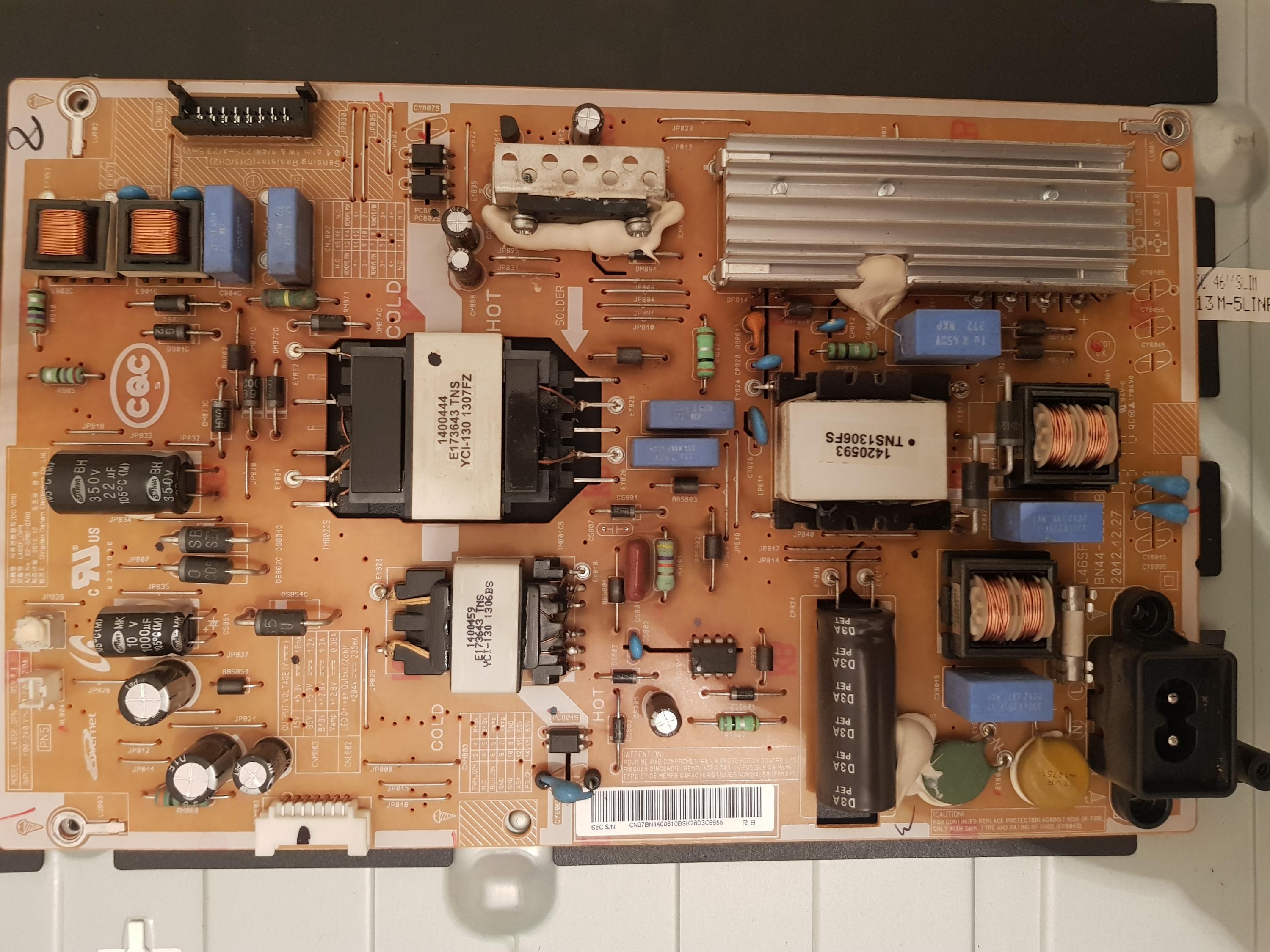

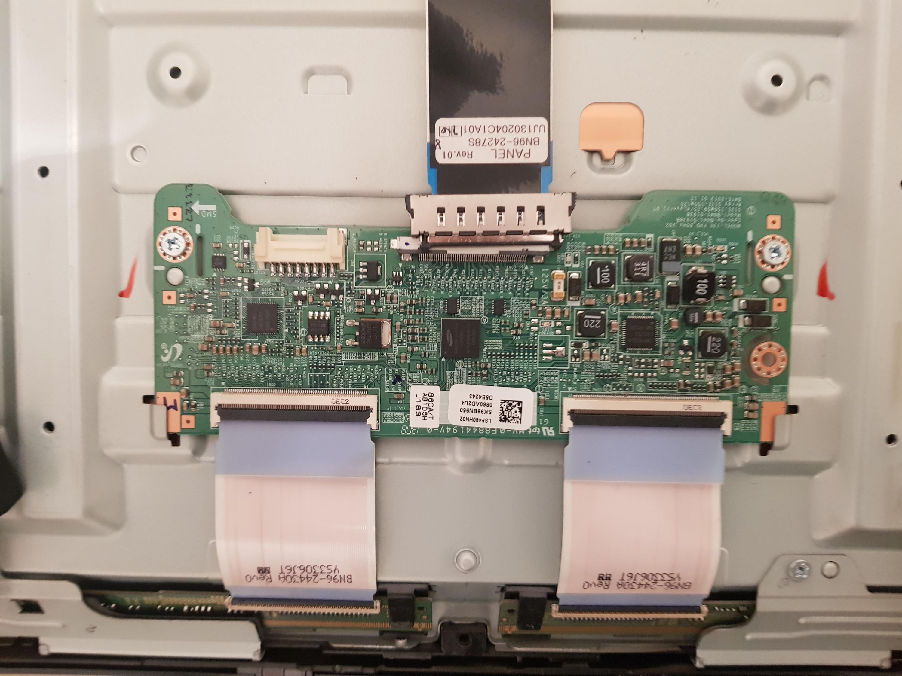

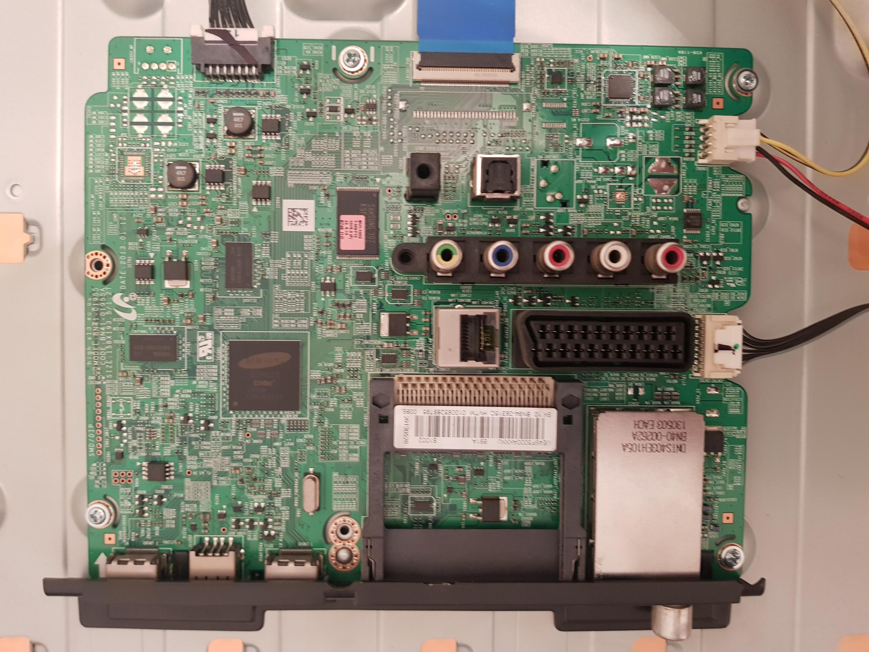

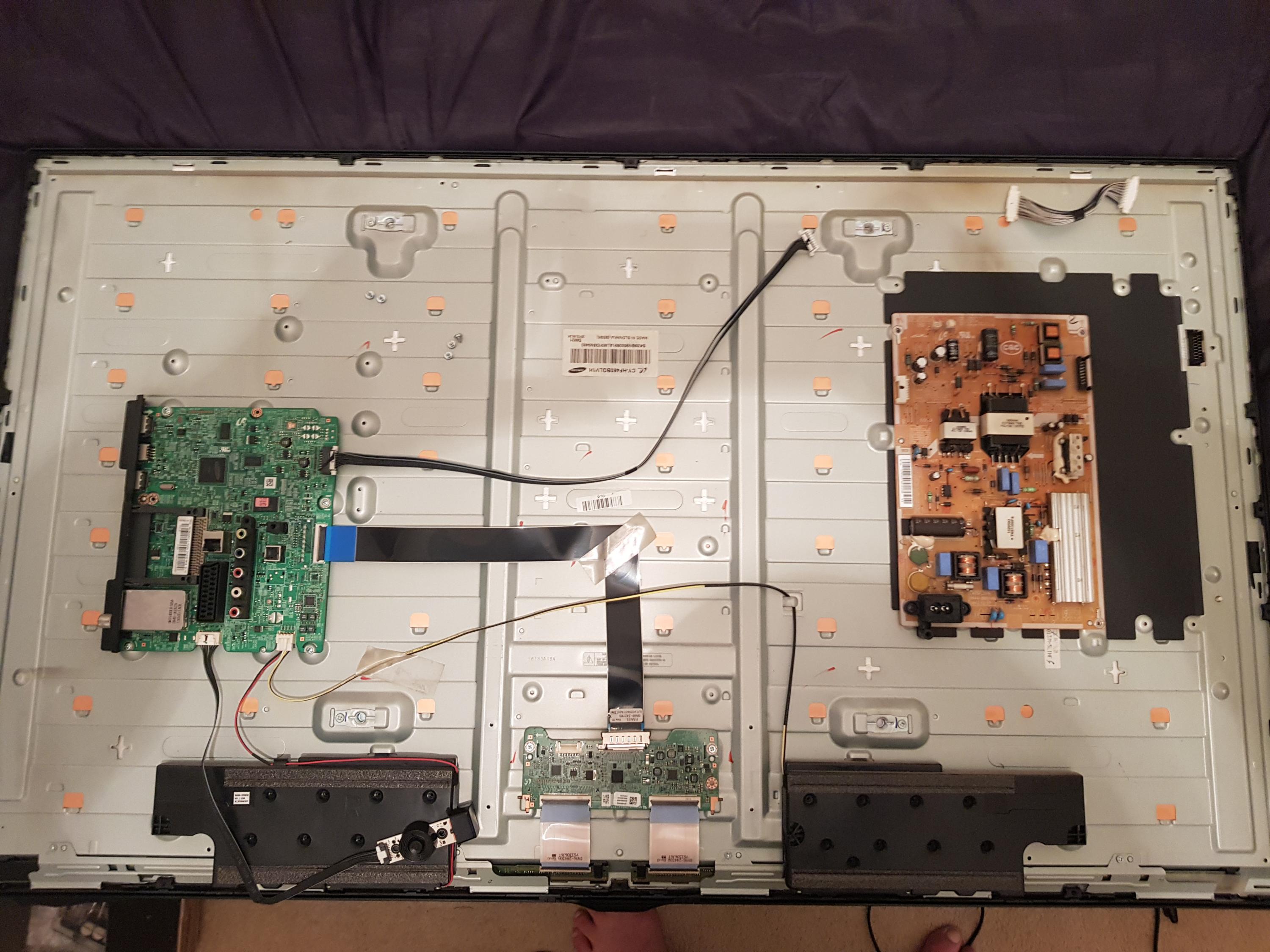

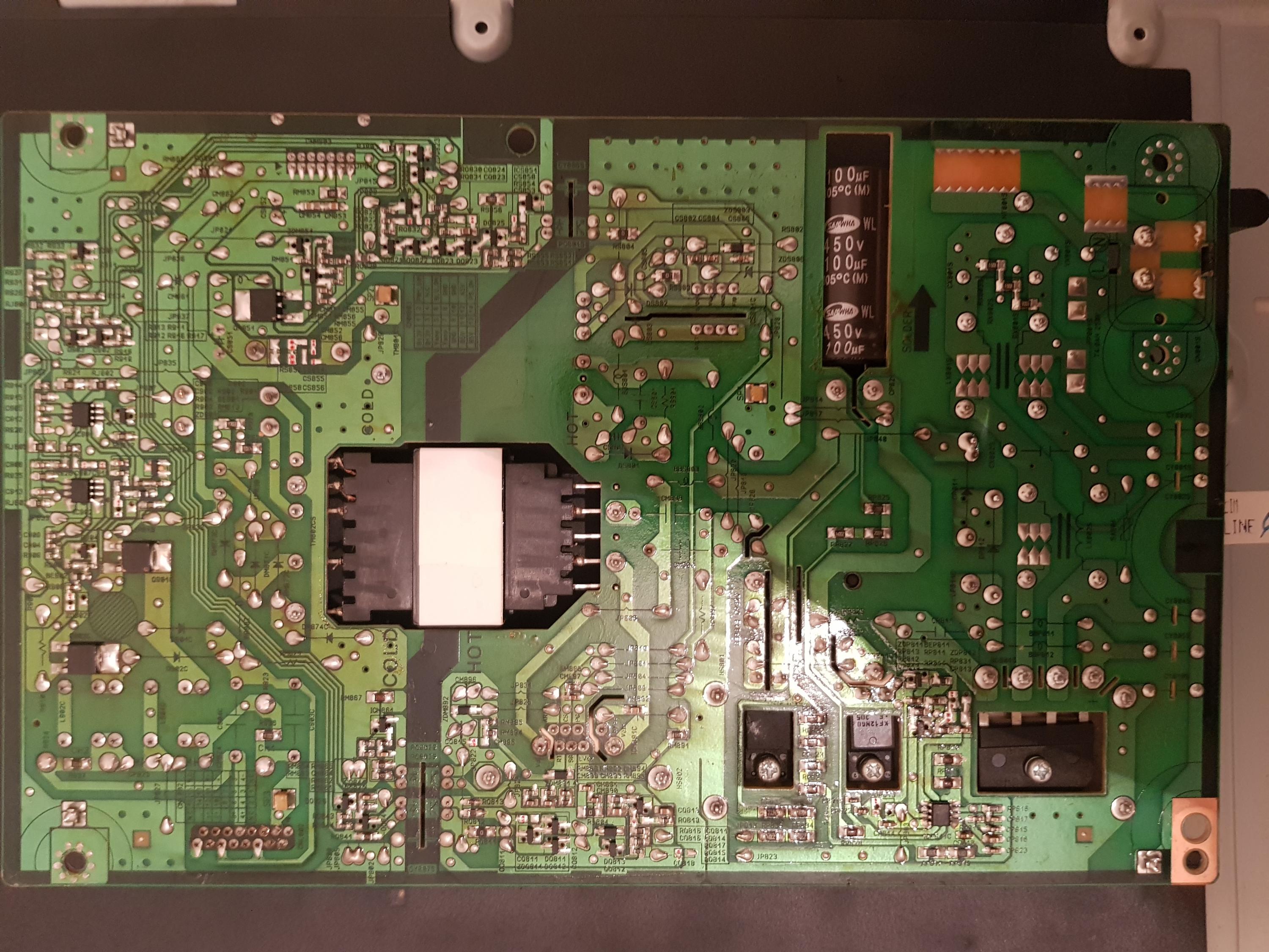

    Have a Samsung ue46f5000, wont power on, standby repeadly flashing, 5 times (double flashes)
    Pulled the back off, no obvious domed caps etc, disconnected T con, no difference, disconnected main board, no difference. Tested power board on bench with nothing connected and getting 0 readings on all pins.
    Here are some pics

      100% sure that you get ZERO Volt on ALL the power supply pins connector?
      The standby must be present to have standby LED flashes, so at the least the standby power supply is putting out something, so recheck the standby power output pin.

        Sorry, the actual accurate readings are
        1 B13v 0
        3 B13v 0
        5 Vamp 0
        7 Vamp 0
        9 GND 0
        11 B5v 0
        13 B5v 0
        2 Pwm.Dm 0
        4 N.C 0
        6 BLU ON 0
        8 GND 0
        10 GND 0
        12 A5v On 5.33
        14 PS.ON 3.16

          I would have thought powerboard, but would rather repair than replace it, anyone have any ideas as to what may be at fault?

            What is the DC Voltage measured between the two legs of the main cap in the hot side when TV is turned on?

              what is the dc voltage measured between the two legs of the main cap in the hot side when tv is turned on?
              333v
                Re: Samsung ue46f5000 standby light flashing
                PS-ON (3.16V as reported) is present but the PFC Boosted Voltage is not present, the Voltage on the main filter cap should be around 380 ~ 400VDC range for the rest of the power supply to be working.
                You need to locate the PFC IC, get the spec sheet to get the pinout of the VCC pin so you can verify if it has switched VCC for it to run or not.

                          1) What Voltage testing have you done so far on the power supply connector pins that go to the main board?
                          2) Is your power supply board bn44-00610A, D?
                          3) Most of these new Samsung models have pull-up resistors to allow self test of the power supply board, you can easily verify if it has pull-up resistors or not by checking the Voltages on the power supply connector pins when it is not connected to the main board.

                              Many thanks for your replies.
                              Nothing to do with backlight. PSU number bn44-00610A.
                              The fault was caused by a faulty PFC chip SPC7011F. Didnt have one but managed to find one on a scrap board and when fitted fault cleared and working fine again. I belief the original starter of this thread most probably had the same issue but never posted back if it was ever repaired.
                              So if any members in the future with similar issues with this PSU refer to this link hopefully this info will be of help to them.
