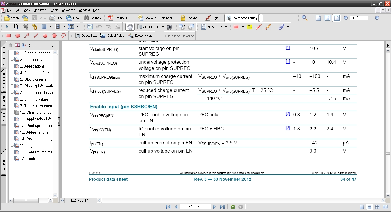

                            #53
                            Re: LG 65UH5500-UA Backlight flash on first power up only
                            P-DIM must be present since the backlights are on and you can dim the backlights at this point.
                            The PFC circuit, need to look at pin 22 of the SMPS/PFC IC as suggested.

                              #54
                              Pin 22 of the PFC IC reads 5.53 V when TV is off.. jumps to 8.6 when it's turned on.
                                #55
                                That must be measurement error. Did you use the chassis as the GND for the meter? You need to use the negative leg of the main filter cap as the ground for the meter because you are making measurement in the hot side.
                                See spec sheet of the IC on the page that I pointed out to for what the Voltage should be on pin 22.

                                  #56
                                  So not the cleanest solder job...but pin 22 connects to cap then to hot gnd, so i soldered across the cap. Just measured again from pin 22 referenced to large cap gnd and same results.
                                  I see what you're referring to on page 34.. table 5 on page 32 lists range for that pin as -1.4 to 12 v..(abs max maybe)...used in a different mode? This pin doesn't seem to be driven by a voltage.. just has a cap to hot gnd?
                                    #57
                                    It's page 34 (see my post #40).
                                    Enable input (pin SSHBC/EN).
                                    There may be trace going under the IC.
                                    I cannot see how you can have the same Voltage readings using the chassis GND and using the Hot side ground.

                                      #58
                                      Both measurements are referenced to hot gnd. First reading was pin 22 references to the pad the capacitor is connected to, which is shorted to negative lead of large cap. Second measurement to confirm for you was pin22 referenced to negative lead of large cap.
                                      I tried continuity check between pin 22 and the traces exiting top and bottom of chip and there doesn't seem to be a connection
                                        #59
                                        Pin 22 is the ENABLE pin so it has to be controlled some how, and it does change state, but I cannot see how the control Voltage, 5.53V/8.6V can be that high either..
                                        At this point you will have to find the schematic to really find out what is going on.

                                          #60
                                          Section 7.8.8.1 (page 26) explains the function of this pin when used as soft start. I think the voltages i am reading are as intended. Don't you think?
