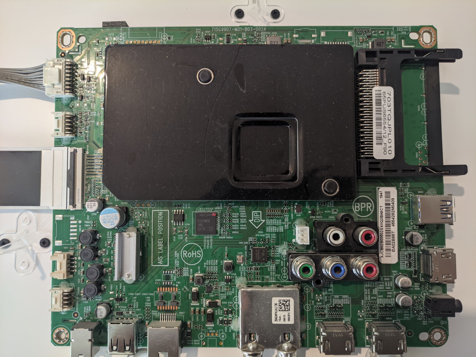

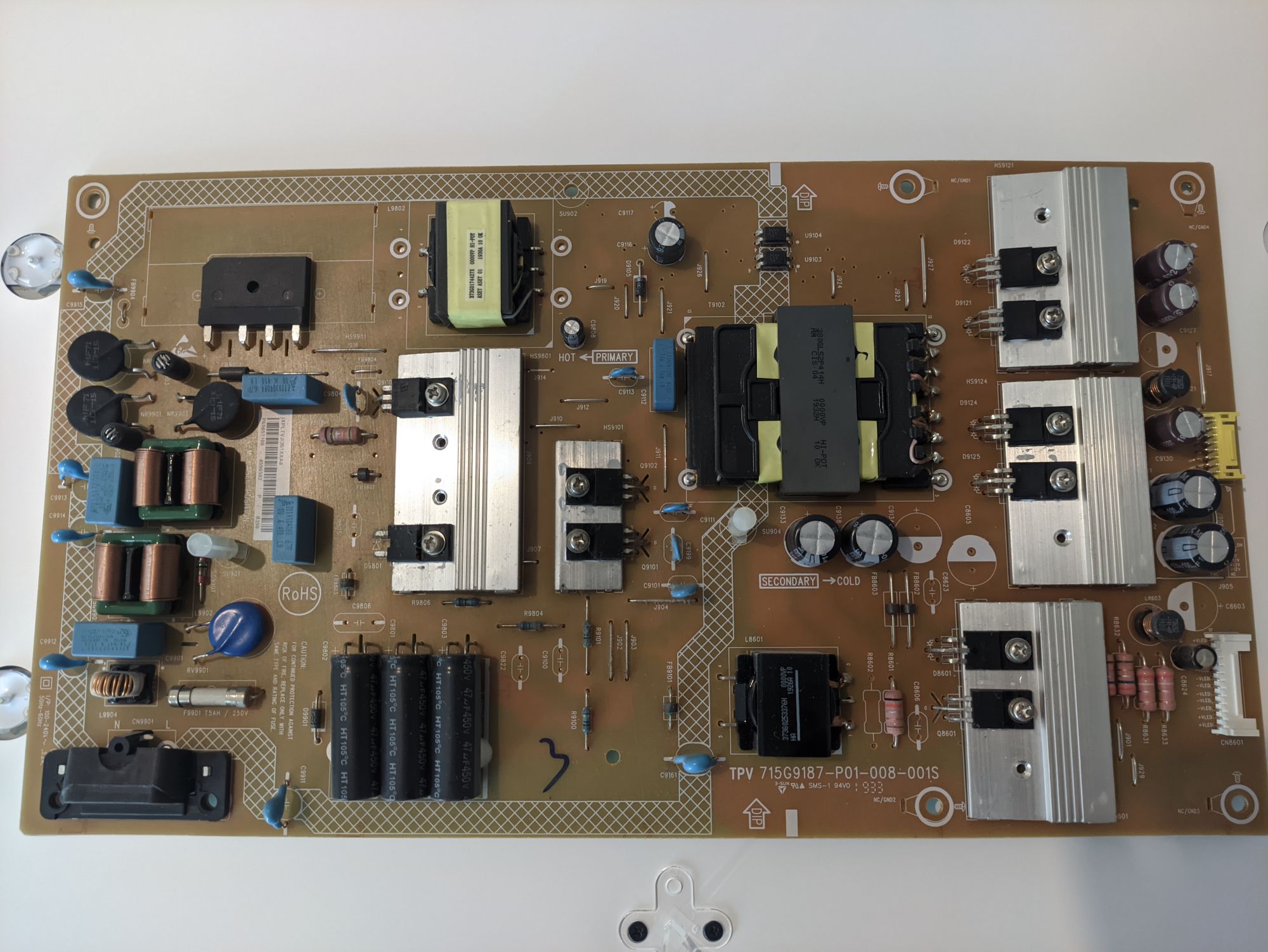

    I have Philips 65" TV (65PUS6554/12).
    Problem is when turn on tv backlight flash only one time for about 1 second then turns off and display is dark but sound is there.
    Sometimes TV turns on and work with no problem, had backlight and picture, but mostly Tv wont turn on backlight. Any idea where to start looking?
    Power board TPV 715G9187-P01-008-001S
    Main Board 715G9907-M01-B03-005K

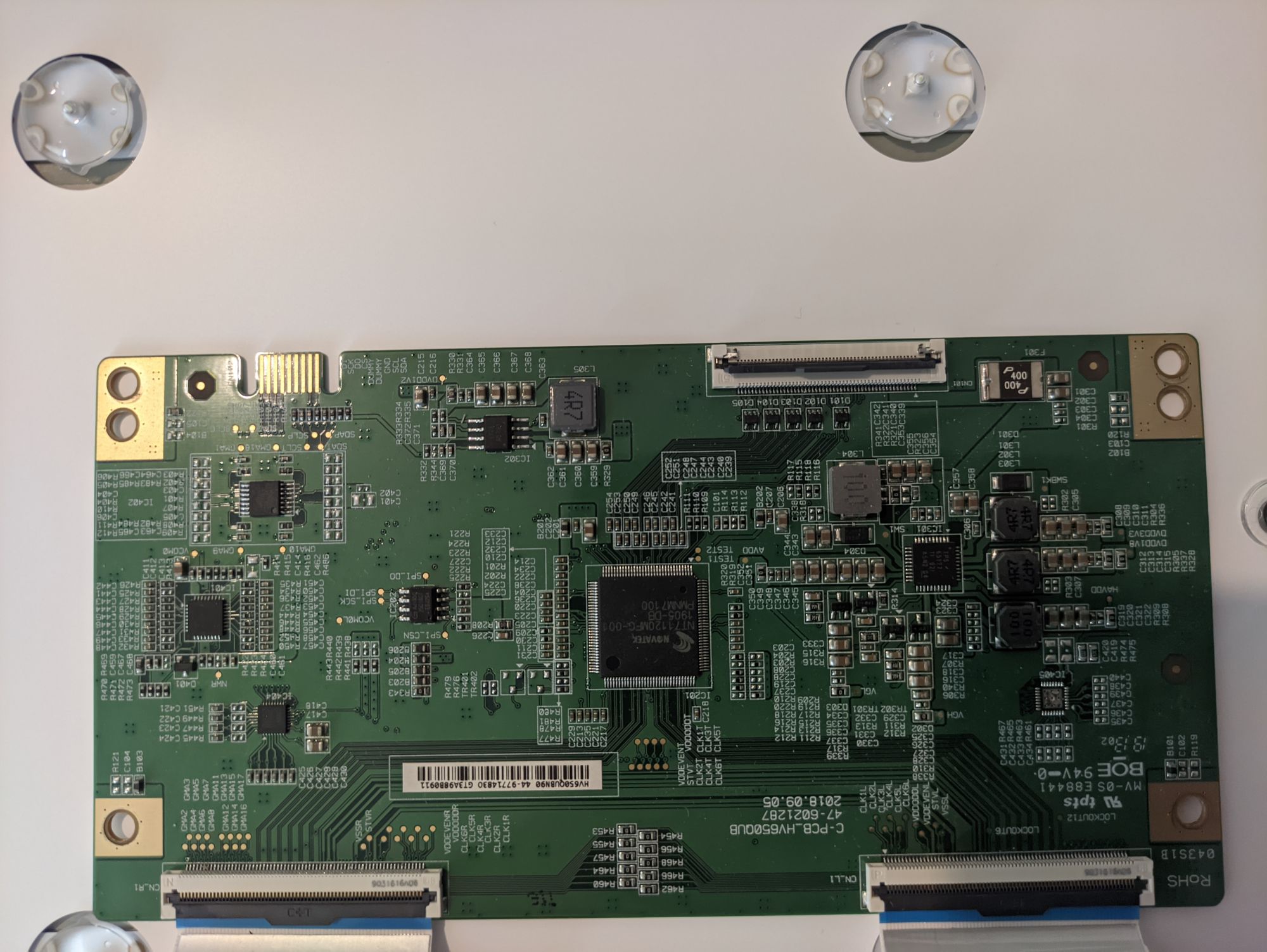

        i have disassemble panel reconect power board, main board and t-com without display. now backlight turn on every time.

            tv operate for a while without display panel and backlight suddenly went off. reconect 220v plug but nothing hapen. backlight is off.
            1. unplug connector of main board from power board reconect 220v plug nothing hapen
            2. voltage on connector for mainboard is 10V but it should be 12 V
            3. connect main board to power board and start messuring on connector voltages when conect 220v plug to power board on connector voltage start 12v and after few second voltage drop to 10v and strage noise cames from mainboard
            • dskall
              • Oct 2016
              • 2905
              • usa
              Re: Philips 65PUS6554/12 one time backlight flash
              Sounds like something is shorting. Unplug T-con.
