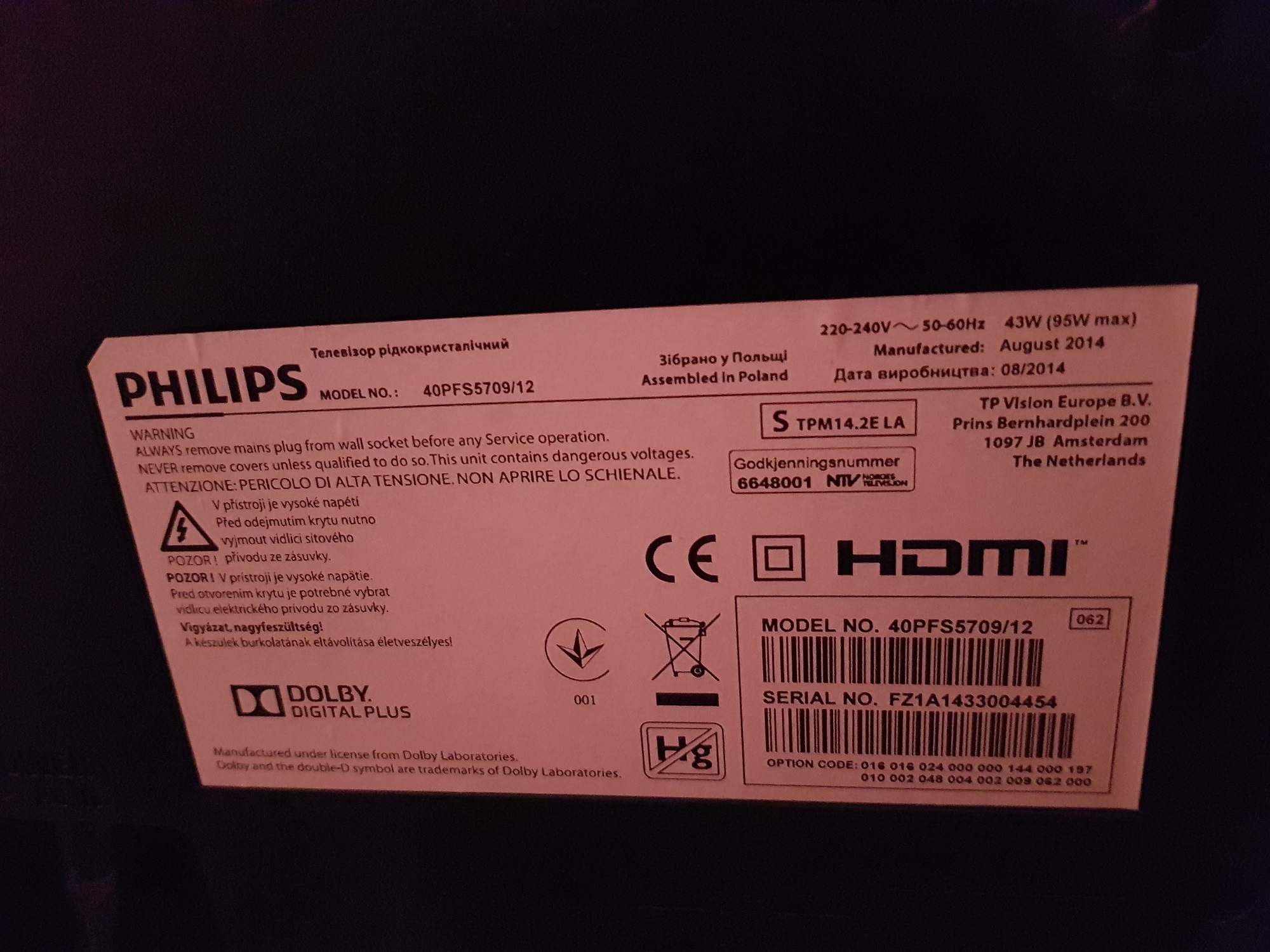

philips lcd tv 40PFS5709
  • klj2030
    • Nov 2019
    • 13
    • Danmark

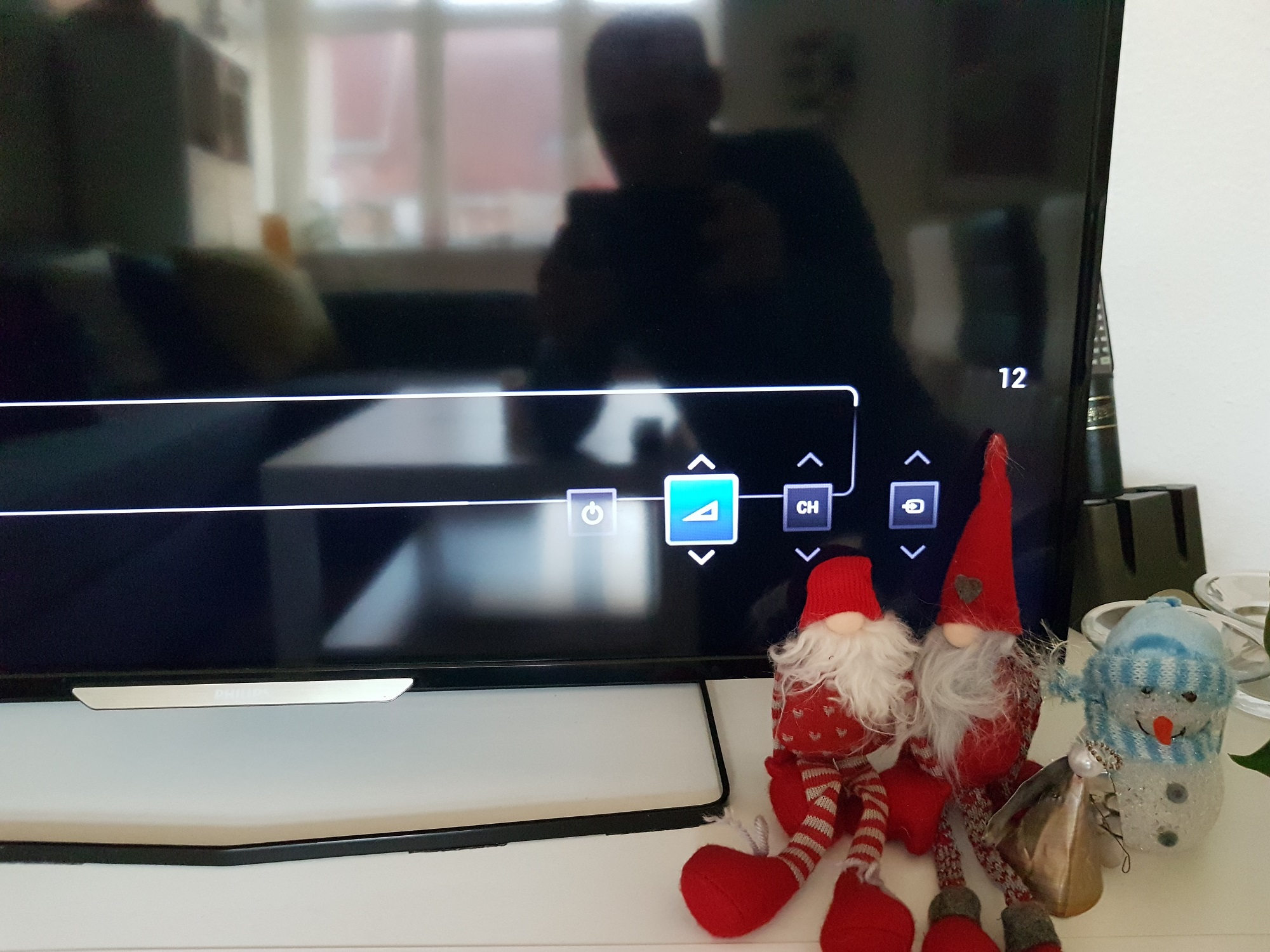

    This LCD tv have this strange display, there are sound and picture, but cant use the remote anymore to change channel etc. Just stuck, it runs back and forth between on-off, sound up-down, channel etc. (check the zip file)
    Any ideas?
    Thank you
    Kurt

              Yes I have invested in a new RC and. You can use the RC, but only to sound volume, change the channels. Trying to use other sources or TV setup is not possible.... so the smart TV is not so smart
              Thank you for link, I have tried the latest software, will give it another try

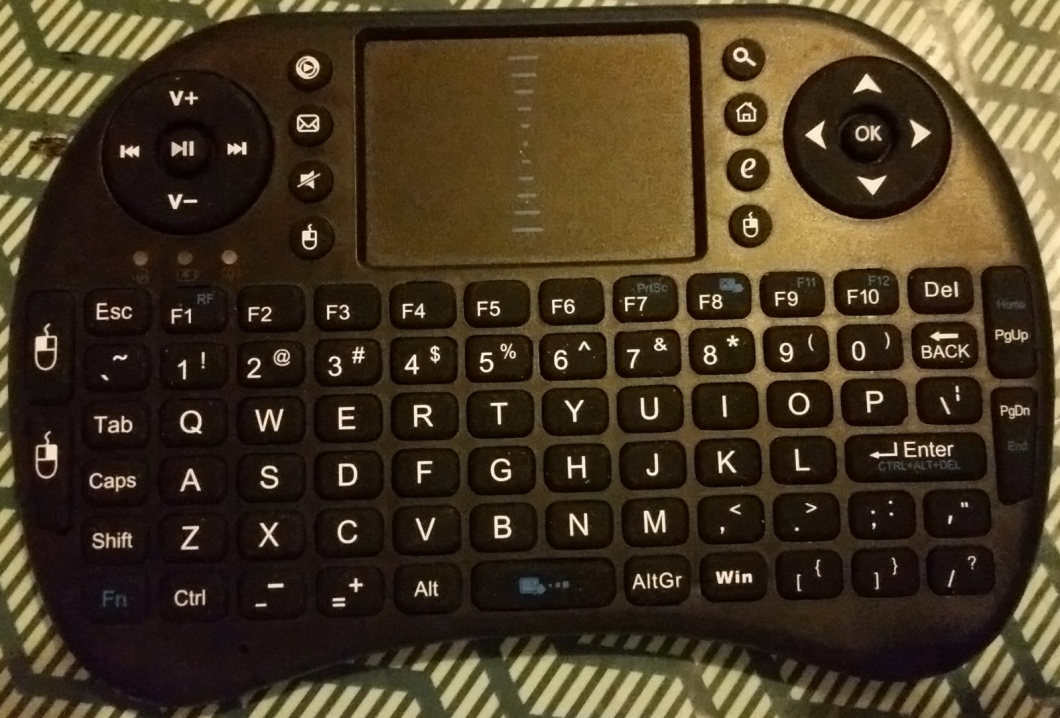

                              use USB 2 mouse or (air mouse Keyboard ) to control the TV and make hard reset from SM

                                Hi Diah, thank you for suggestion, USB mouse shows connected, however it is not able to function

                                  i didn't understand how it show connected but no function !!
                                  i use always this air mouse keyboard at TVs with RC no function. to control it..
                                  F are function which lead to many item at setup.

                                    Diah, have you had the same problem... as shown in the first post of the thread...pics and video? Im tellin you, it is not possible to acccess setup or any other function.... I can power up, volume control, change channels that is it.... the mouse connect... when I try to use it... it freezes and also turns of the tv sometimes I really value the replies... but Im throwin in the towel...dont have the tools to fix the possible nand memory corruption, as yokoono said... so Philips suck air, and will never buy another one

                                        thank you Diah... I will try again with an air mouse keyboard next weekend, I only had USB 2 mouse. The UART and service port no experience
