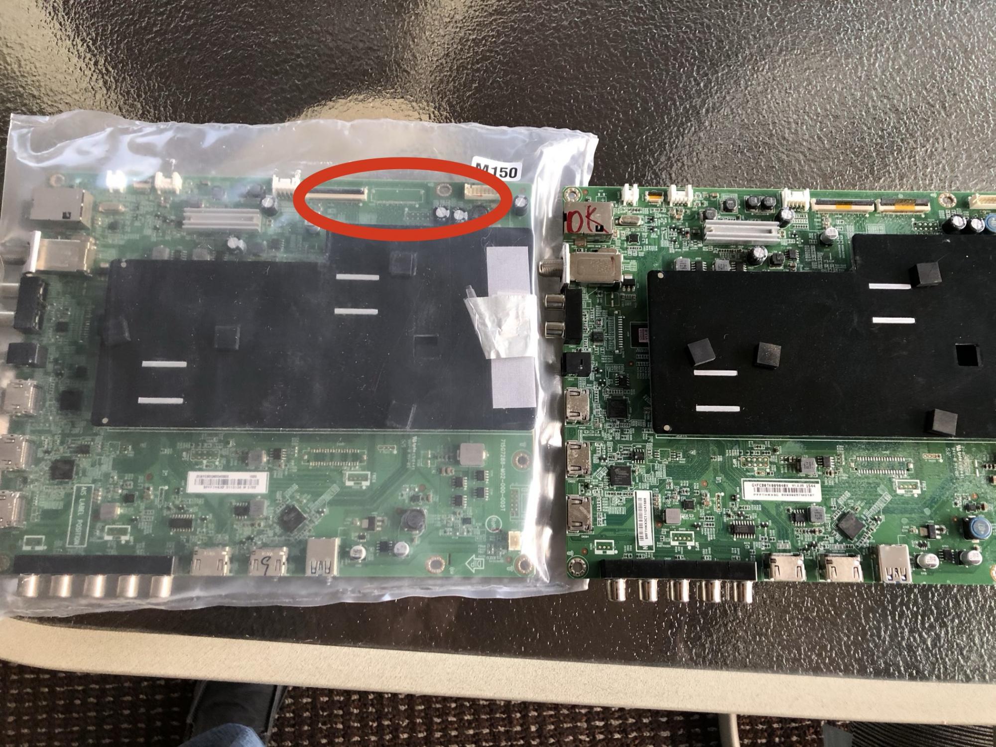

    I got this new from Costco about 4 years ago. Sadly I only had 3 years warranty on it. I noticed the picture from the post mentioned above shows a main board that looks similar and replacing the board seemed to fix it.
    I ordered one from eBay, hopefully it's the correct one and it works!
    Very strange looking board(s). The other post person never posted a picture of the "cleaned up" card but it is hard to imagine that the board is functional. That looks like significant "contamination" but not sure what. My guess would be "flooding".
    It does appear that the other poster found a new main and got his set working so you could also get there.

      Finally was able to take a look at the main board and all does not appear well. On the back of it is all this residue. Anyone know if that can just be cleaned off or is that the blood of a dead CPU oozing onto the board?
      Do you live by the coast at all? My in-laws have a beach house right off the pacific and have a TV in the garage - the salty air just got to it and coated the board.
      The coax connector cage looks like it's rusted as well.

                      What you can do is to have all connector in place but not having the ON/OFF wire going to the main board connected then force backlights on by connecting 470 ~ 1K resistor between Standby power supply pin and the ON/OFF pin on the power supply board to simulate the ON/OFF CONTROL SIGNAL. Power up and turn on the TV and see if you get video on the screen and all the functions are OK or not. If that works then we can use other control signal to be used as ON/OFF signal.
                      Thanks so much for the tips, but this was sounding a bit over my pay grade so i opted for the replacement main board.
                      The first one i ordered ended up being the wrong one since it was missing one of the connectors. It appears the seller wasn't sure what numbers on the board were relevant and neither was i so even though the numbers they mentioned matched my board, it still wasn't the correct one. (Pic attached)
                      Heading back to eBay i found another board and the seller referenced the code on the white sticker on the board and that matched what i have. So i ordered it and plugged it all in and now its back up and going again. I noticed the LED on the main board lite up purple right when i plugged it in then turned red, it wasn't doing that before with the bad board.
                      Thanks so much for the heads up on what to look for, at first i was sure it was a power supply issue but you guys got me straightened out on that part and looking at the main board.
