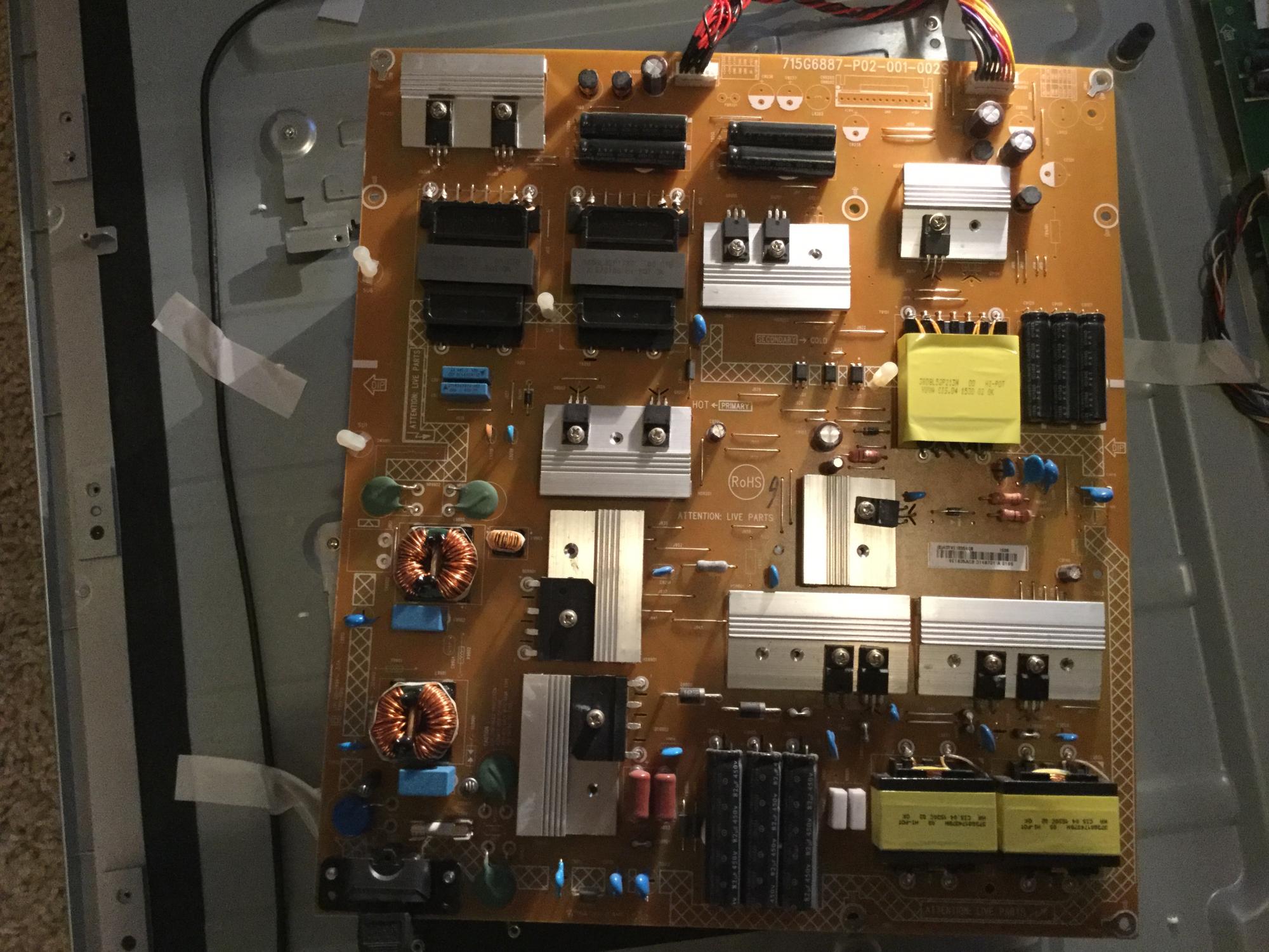

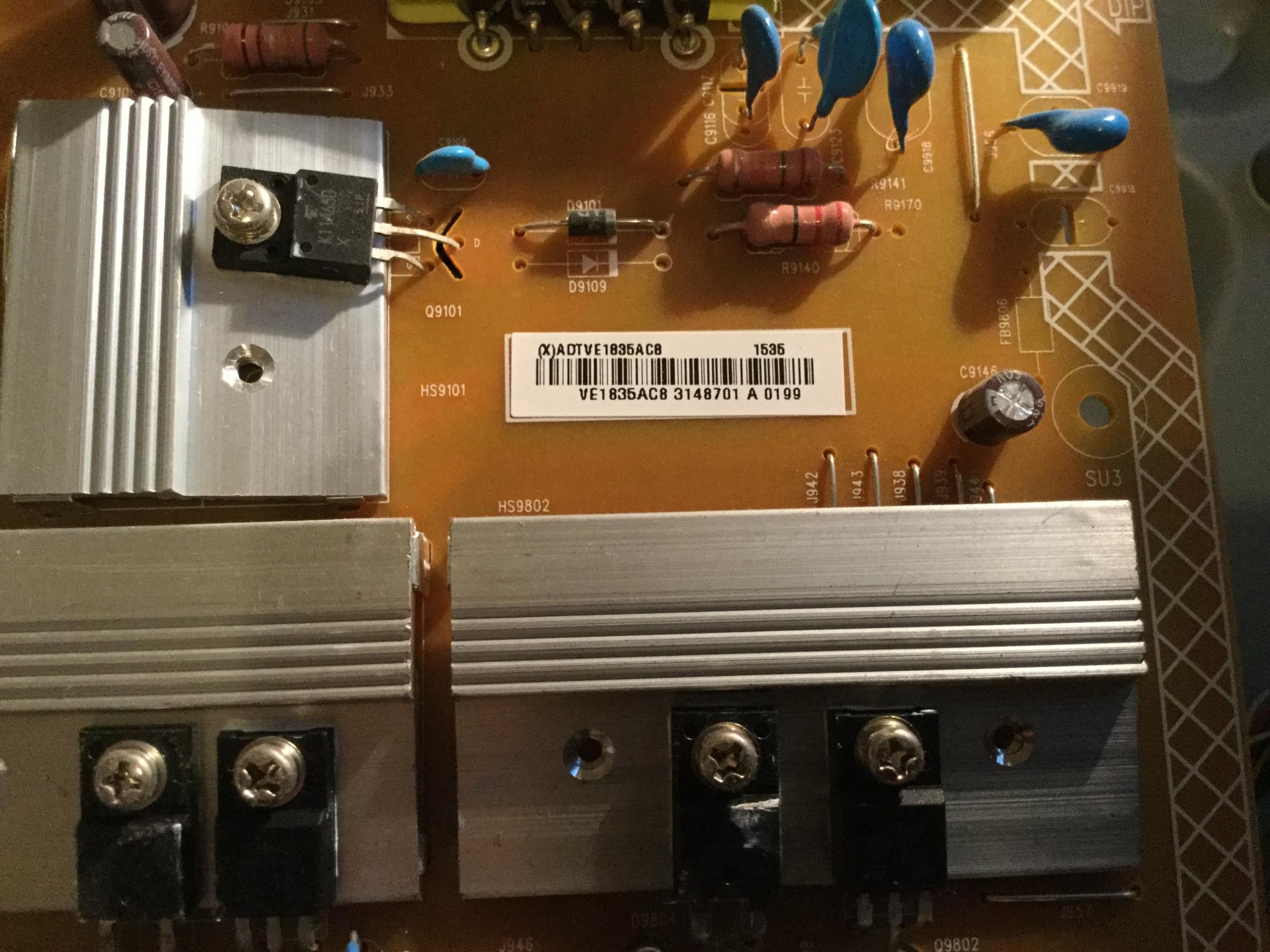

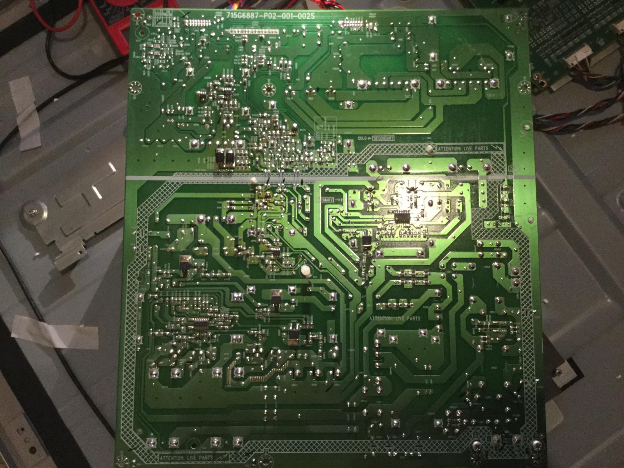

          How about reporting the Voltage for each pin of the power supply connectors?
          Please make sure to report in the format (Pin name follow by the Voltage reading) that we can easily what is there and not there for each pin when the TV is off and when the power switch is activated.

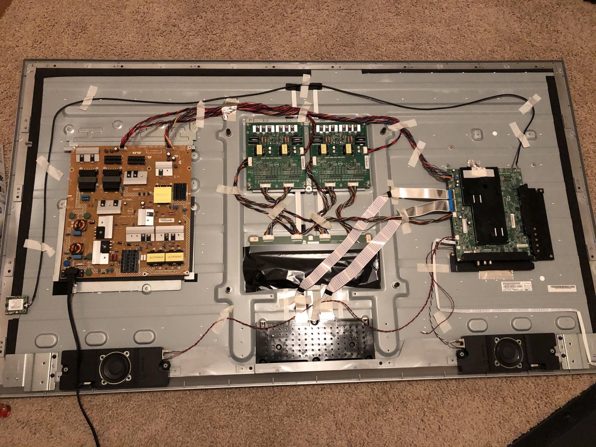

          Also upload good clear pictures of the whole backside of the TV showing how the boards are connected together.

            Re: Vizio M65-C1 No Power

            Back of TV picture attached.
              OK, I am confused, your post #1 indicated no 24V but your post #6 shows 24V is present when PS-ON command from the main board is present.
              So far what you show on post #6 the power supply board is putting out Voltages as it should.
              Since you do not have any indicator light which is driven by the main board, I would try disconnecting the WI-FI card first and see what will happen.
                  In your picture as you look at it, it's far left small unit, it goes to top right of mainboard.

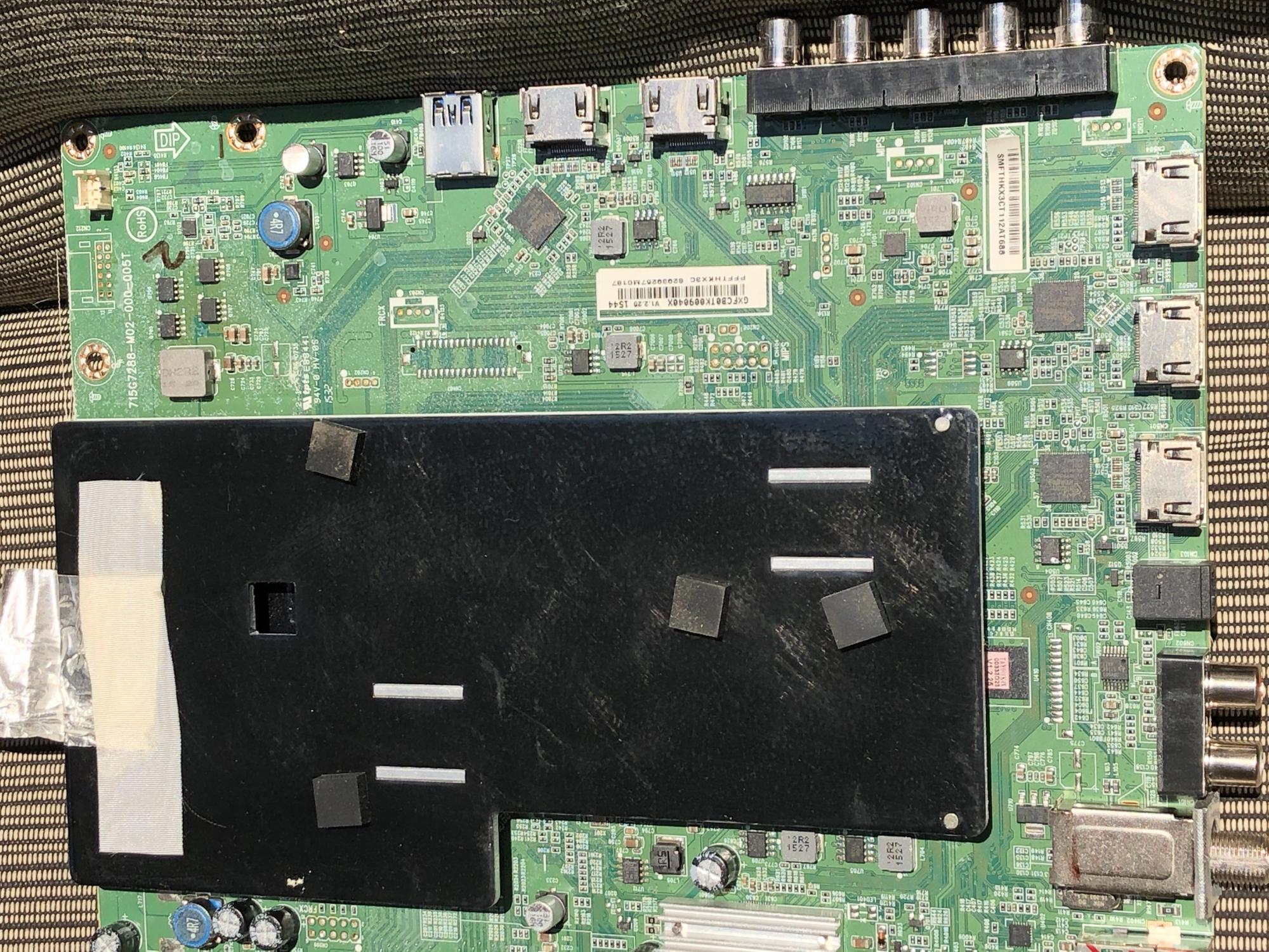

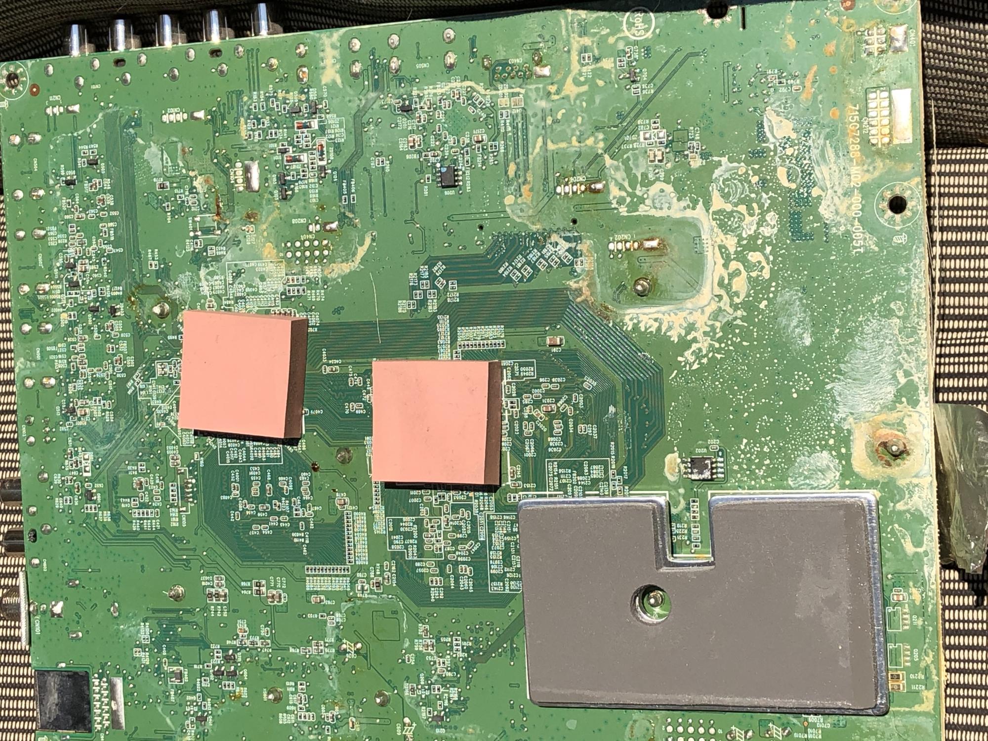

                                  Finally was able to take a look at the main board and all does not appear well. On the back of it is all this residue. Anyone know if that can just be cleaned off or is that the blood of a dead CPU oozing onto the board?
                                  • budwich
                                    • Jul 2015
                                    • 3097
                                    some one did some "washing". What is the history of the set?
                                      I got this new from Costco about 4 years ago. Sadly I only had 3 years warranty on it. I noticed the picture from the post mentioned above shows a main board that looks similar and replacing the board seemed to fix it.
                                      I ordered one from eBay, hopefully it's the correct one and it works!
