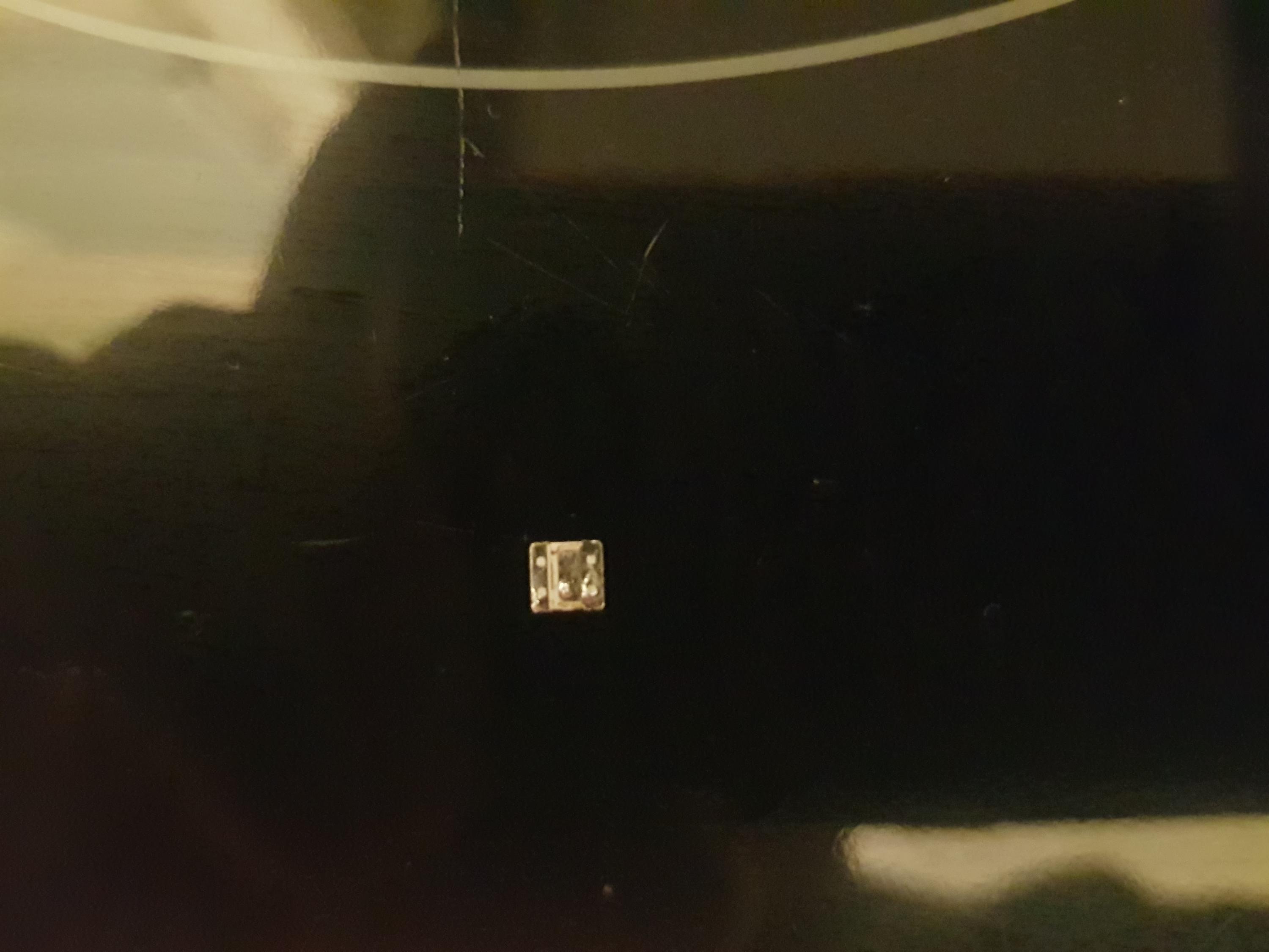

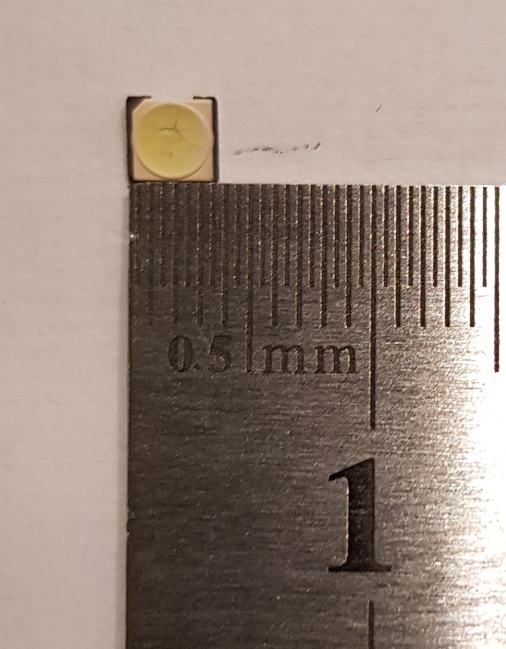

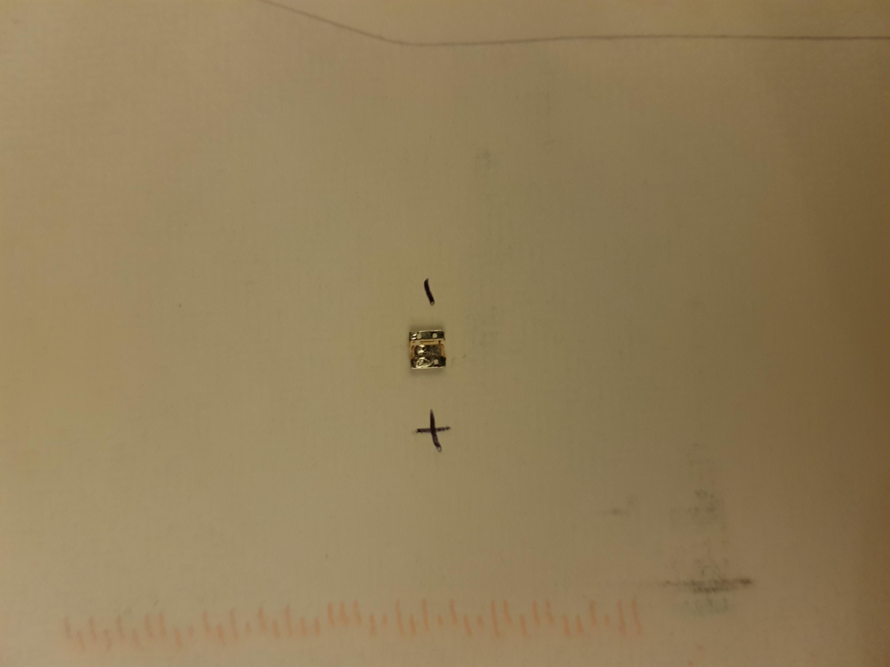

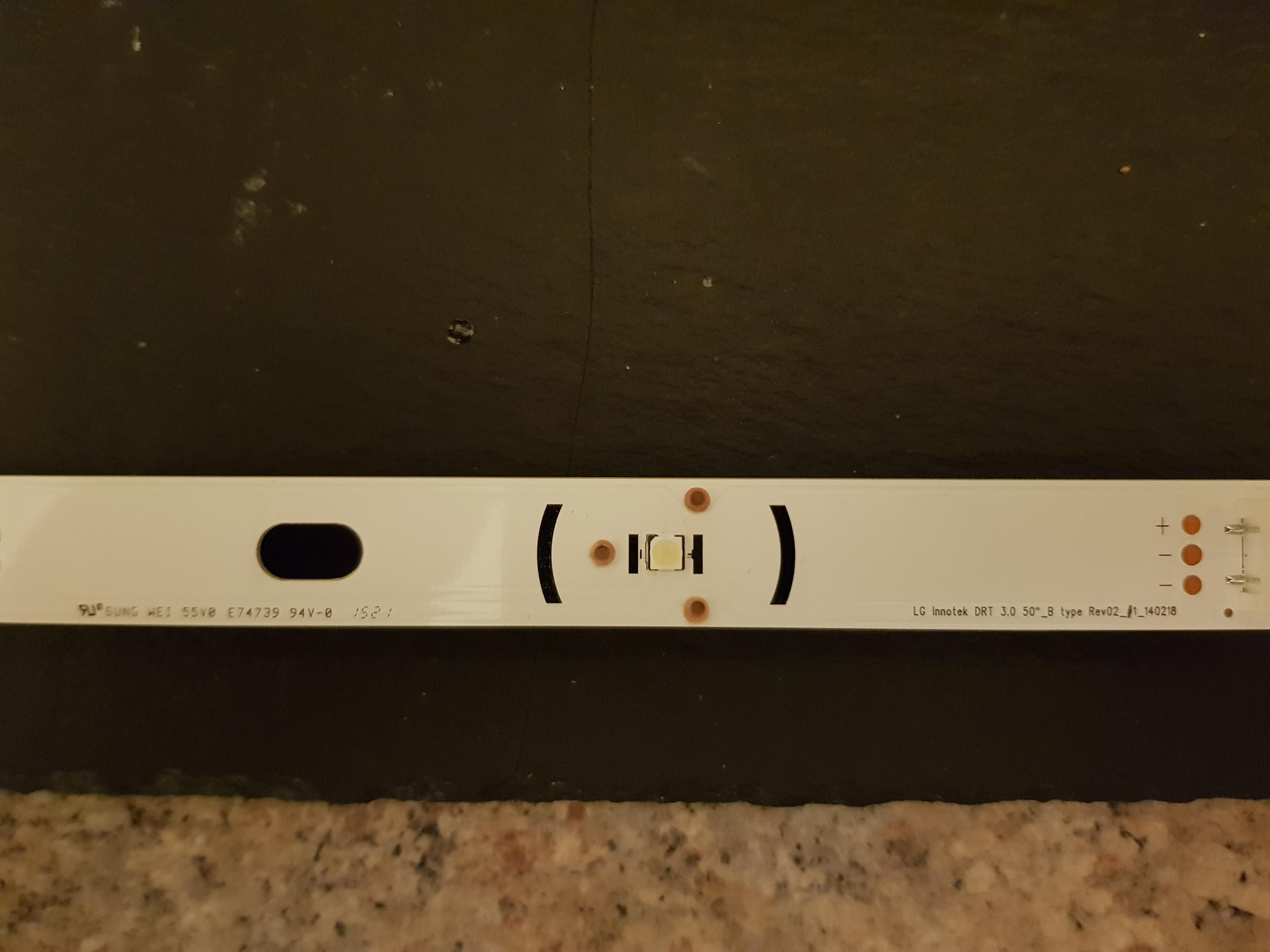

LG 50LF561V LEDs
  • Bloopeta
    • Jun 2018
    • 526
    • United Kingdom
    LG 50LF561V LEDs
    Can anyone tell me which LEDs are required for LG 50LF561V please? Its individual LEDs I am wanting, not replacement strips, not sure if it helps but strips are -
    6916L 1978A
    6916L 1979A
  • vinceroger69
    • Mar 2012
    • 6714
    • uk
    Re: LG 50LF561V LEDs
    maybe send this ebay seller a message he has helped me out in the past with replacement leds
    https://www.ebay.co.uk/usr/microtech...88.m1543.l2754
    • Bloopeta
      • Jun 2018
      • 526
      • United Kingdom
      Re: LG 50LF561V LEDs
      maybe send this ebay seller a message he has helped me out in the past with replacement leds
      https://www.ebay.co.uk/usr/microtech...88.m1543.l2754
      Ill drop him a message thankyou
      • Diah
        • Feb 2013
        • 6470
        Re: LG 50LF561V LEDs
        as i know most LG with direct LED BL used SMT 3535 4.6V if you measure one led with mm you will know the type and the V should be written on the strip
        • Bloopeta
          • Jun 2018
          • 526
          • United Kingdom
          Re: LG 50LF561V LEDs
          Originally posted by Diah
          as i know most LG with direct LED BL used SMT 3535 4.6V if you measure one led with mm you will know the type and the V should be written on the strip
          The LED is 4mm, here is the info on the strip.
          • vinceroger69
            • Mar 2012
            • 6714
            • uk
            Re: LG 50LF561V LEDs
            i have these saved in my ebay watch list so if yours are the 6v version it maybe these they do 1 watt or 2 watt versions not sure which you need though
            https://www.ebay.co.uk/itm/50pcs-LED...IAAOSwu1Fd0dzE
            • Bloopeta
              • Jun 2018
              • 526
              • United Kingdom
              Re: LG 50LF561V LEDs
              i have these saved in my ebay watch list so if yours are the 6v version it maybe these they do 1 watt or 2 watt versions not sure which you need though
              https://www.ebay.co.uk/itm/50pcs-LED...IAAOSwu1Fd0dzE
              Ive messaged a few sellers of eBay now, and no1 seems to know which LEDs I need lol, its a nightmare
              • vinceroger69
                • Mar 2012
                • 6714
                • uk
                Re: LG 50LF561V LEDs
                on the back of the leds as you probably know you have to match up the anode and cathode pads as they are two different size pads you can remove a led and test which one is which. wattage wise im not sure maybe budm will know?
                • Bloopeta
                  • Jun 2018
                  • 526
                  • United Kingdom
                  Re: LG 50LF561V LEDs
                  maybe send this ebay seller a message he has helped me out in the past with replacement leds
                  https://www.ebay.co.uk/usr/microtech...88.m1543.l2754
                  That guys just replied to my message and said and of his LEDs that come in packs of 25pcs will work. Doesnt sound right surely? Lol
                    Re: LG 50LF561V LEDs
                    Did you measure the Vf of the working LED?
                    • Bloopeta
                      • Jun 2018
                      • 526
                      • United Kingdom
                      Re: LG 50LF561V LEDs
                      Originally posted by budm
                      Did you measure the Vf of the working LED?
                      I havnt as yet, how would I go about this please?
                        Re: LG 50LF561V LEDs
                        Do you have LED tester?
                        You also need to verify which pad is Anode and which pad is Cathode.
                        • Bloopeta
                          • Jun 2018
                          • 526
                          • United Kingdom
                          Re: LG 50LF561V LEDs
                          Originally posted by budm
                          Do you have LED tester?
                          You also need to verify which pad is Anode and which pad is Cathode.
                          I dont unfortunately, I have ordered one but hasnt arrived yet, so far Ive always just used a home made battery and wire/probes setup to test if LEDs are functioning.
                          In regards to anode/cathode, please see attached pic.
                          Another eBay seller has just messaged and has advised that these are the ones I need. Could you confirm he is correct please? Have more faith in you than an eBay seller lol
                          https://www.ebay.co.uk/itm/254371437338
                          • nomoresonys
                            • Jan 2013
                            • 12306
                            • U.S.
                            Re: LG 50LF561V LEDs
                            Last edited by nomoresonys; 11-25-2019, 02:40 PM.
                            • Bloopeta
                              • Jun 2018
                              • 526
                              • United Kingdom
                              Re: LG 50LF561V LEDs
                              See if that's it, seems to fit a shitton of tvs: https://www.ebay.co.uk/itm/Replaceme...8AAOSwJWddRGXE
                              Im after individual leds mate not the strips
                              • nomoresonys
                                • Jan 2013
                                • 12306
                                • U.S.
                                Re: LG 50LF561V LEDs
                                Yeah, my bad, just caught my error and deleted.
                                  Re: LG 50LF561V LEDs
                                  Originally posted by Bloopeta
                                  I dont unfortunately, I have ordered one but hasnt arrived yet, so far Ive always just used a home made battery and wire/probes setup to test if LEDs are functioning.
                                  In regards to anode/cathode, please see attached pic.
                                  Another eBay seller has just messaged and has advised that these are the ones I need. Could you confirm he is correct please? Have more faith in you than an eBay seller lol
                                  https://www.ebay.co.uk/itm/254371437338
                                  That seller does not provide any spec for the LED.
                                  • Bloopeta
                                    • Jun 2018
                                    • 526
                                    • United Kingdom
                                    Re: LG 50LF561V LEDs
                                    Originally posted by budm
                                    That seller does not provide any spec for the LED.
                                    Thats why I was worried, thats the second one today thats replied to me and just said yes buy these they will work lol
                                    • Diah
                                      • Feb 2013
                                      • 6470
                                      Re: LG 50LF561V LEDs
                                      its seem 3 V. one with VR 0.8-1.2V round 5mA and it forward IF 400mA
                                      but are you sure 4x4mm ???
                                      Last edited by Diah; 11-25-2019, 03:05 PM.
                                      • Bloopeta
                                        • Jun 2018
                                        • 526
                                        • United Kingdom
                                        Re: LG 50LF561V LEDs
                                        Originally posted by Diah
                                        its seem 3 V. one with VR 0.8-1.2V round 5mA and it forward IF 400mA
                                        but are you sure 4x4mm ???
                                        Heres a pic, as my eye sight isnt the most reliable these days lol, may be more 3.5mm??
                                        • mc900fthanna
                                          Visio M70-C3 LED replacement strips
                                          by mc900fthanna
                                          So... I have the patchy back light issue with my Visio M70, meaning some light up, others do not. I finally got around to testing the LED driver board and found that was not the issue (swapped another one in and the same issue persisted) and I am considering if i dare dive deeper into this TV and go after the LED strips.
                                          Right away i see that they don't seem to stock them anywhere out there (E700DLB0016-002) is a part number that i see a you tube / seller guy list out. He has a nice video of how to get into my exact TV out there: https://www.youtube.com/watch?v=0AcUPiN83Tg
                                          11-28-2022, 03:03 PM
                                        • lmcancu
                                          RCA RLDED 4331B: 43 inch LED TV: Backlight issue
                                          by lmcancu
                                          Hi I am having an issue with the LED backlight of this TV. I can see the picture with a flash light, so I determined it was a backlight issue.
                                          Initially, after opening it I found 2 shorted and 1 open LED on 2 strips (total of 4). I removed the LEDs and shorted the pads together to verify if the backlight would work.
                                          Testing it, I found the backlight turned on and I measured 54V when TV was in standby (off), and 100v when TV was turned on. The 4 strips each contain 9 LEDs, so 36 in all minus 3.
                                          Instead of putting it back together I decided to replace...
                                          04-01-2023, 01:11 PM
                                        • Firentiosi
                                          1/3rd of screen black with occasional vertical lines - repair attempt for learning! - Kogan KALED58RT9220SVA
                                          by Firentiosi
                                          Thanks for offering your assistance with this. I'm an electronics enthusiast with moderate level of competence (have a decent lab with two power supplies, microscope, DSO, hot air, good iron, can competently work at a component level on SMDs, design and solder own PCBs etc). I really enjoying fixing things and learning new stuff so took up a free 58" LED TV and have been googling and watching Youtube videos to see if I can fix this! I am happy to go down to individual component replacement/strip replacement etc - it's all in the name of learning.
                                          The issues are as follows: the...
                                          11-27-2024, 12:33 AM
                                        • anupkg1985
                                          Insignia NS-50DF710NA21 Replacement LED strips
                                          by anupkg1985
                                          I have this Insignia tv with most of the led's damaged. I'm not able to find the replacement LED strips for the same. The numbers marked on LED strips are -
                                          LB-GM3030-GJBETTY504XBBB19. Please find the photo for the same. Can somebody help finding replacement/equivalent led strips for the same....
                                          05-02-2022, 04:59 PM
