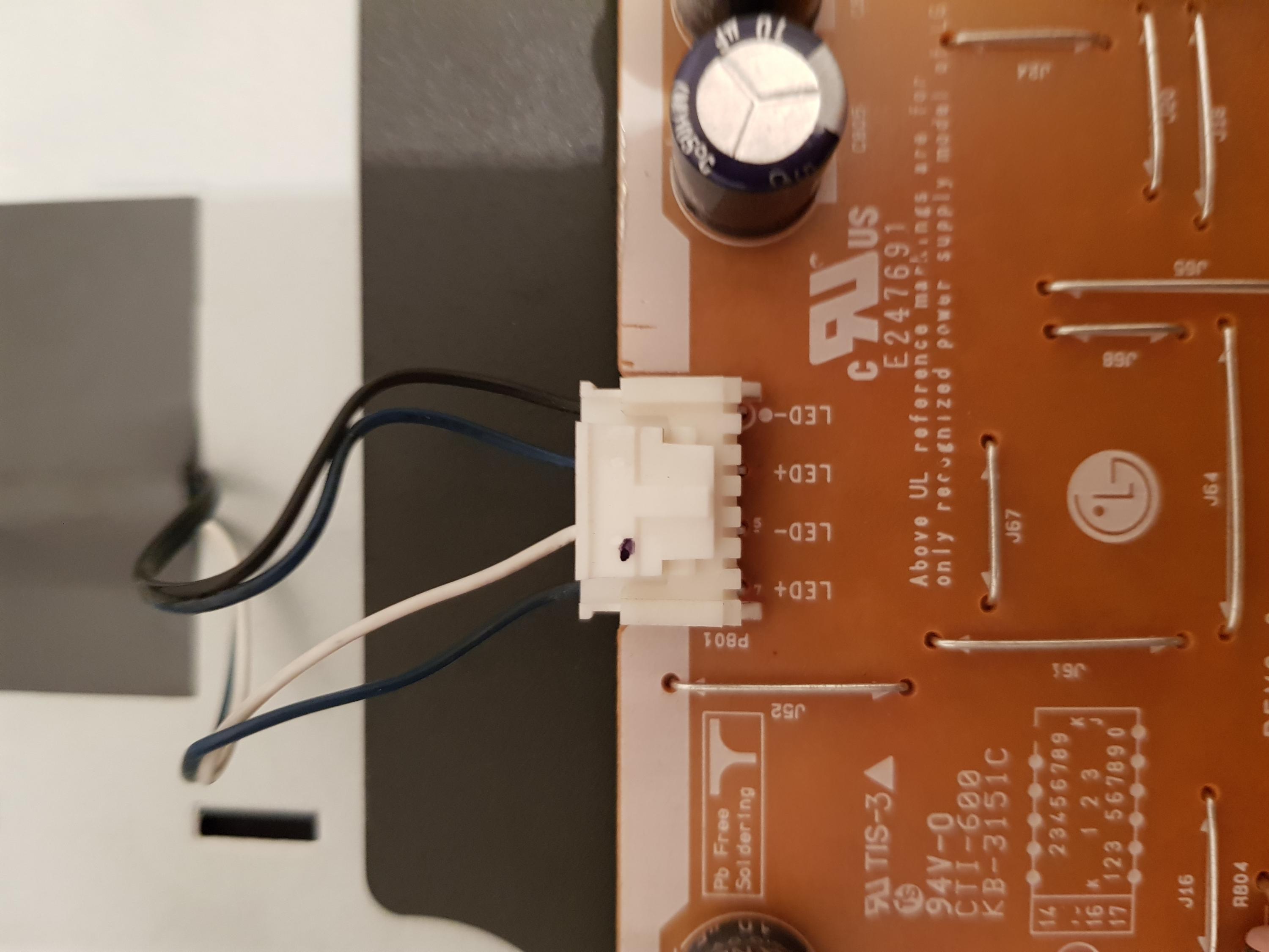

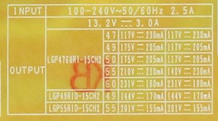

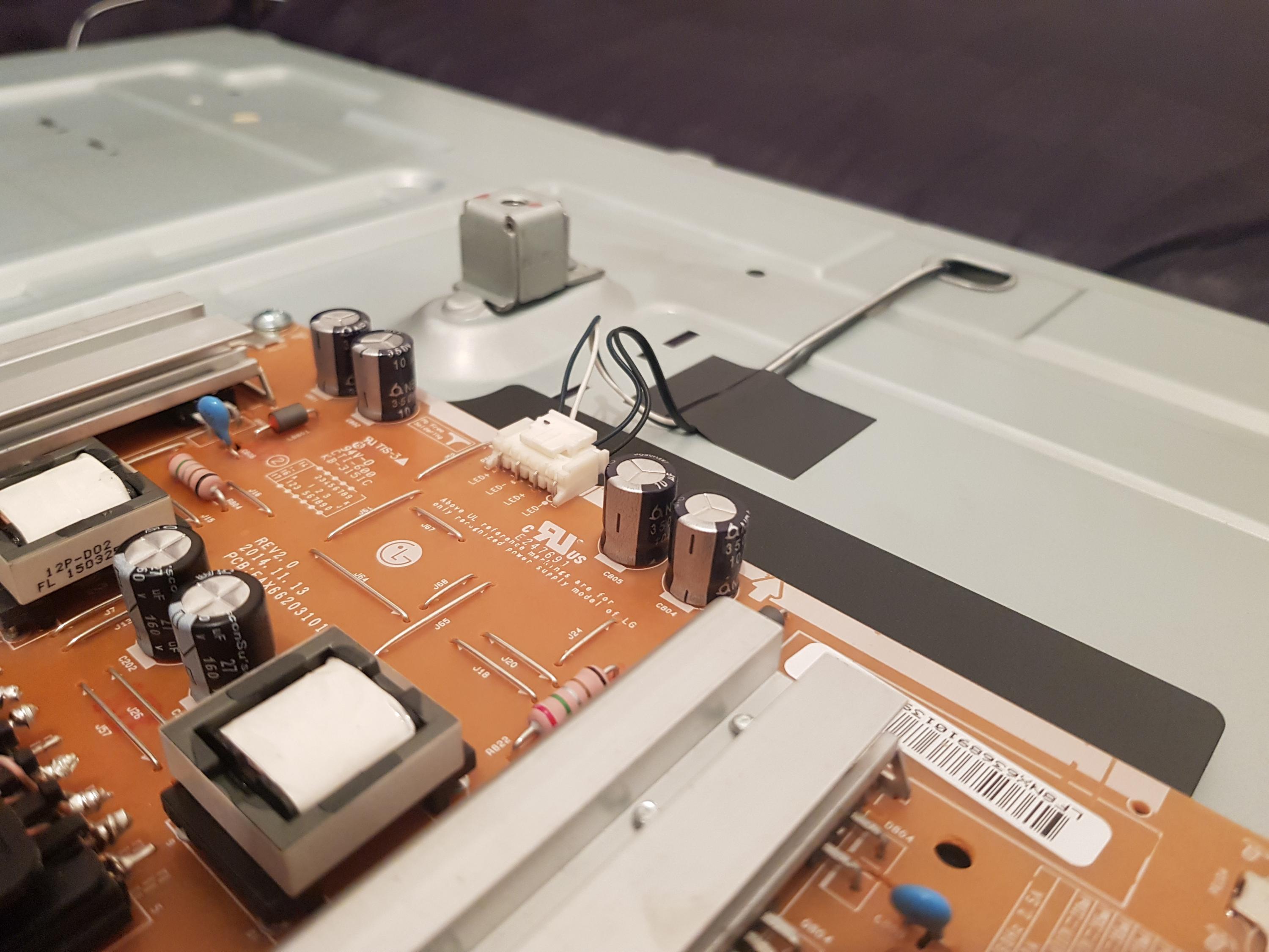

LG 50LF561V LEDs
  • Diah
    • Feb 2013
    • 6615
    Re: LG 50LF561V LEDs
    Originally posted by Bloopeta
    Heres a pic, as my eye sight isnt the most reliable these days lol, may be more 3.5mm??
    LOL neither my...
    any way 4040 SMT Led called too 3535 as measurement with out soldering pad
    you can find on ali express many... but just advice use the one round 4.6 volts not the 3 volts for long life if you are going to replace one or 2 pieces
    • nomoresonys
      • Jan 2013
      • 12323
      • U.S.
      Re: LG 50LF561V LEDs
      So they're not 6v ? these are 6v, whole strips but described as 6 volt: https://www.ebay.com/c/1264935641
      • Bloopeta
        • Jun 2018
        • 526
        • United Kingdom
        Re: LG 50LF561V LEDs
        So they're not 6v ? these are 6v, whole strips but described as 6 volt: https://www.ebay.com/c/1264935641
        They are for a different TV are they not?? A 55" model?
        Mine is LG 50LF561V
        • nomoresonys
          • Jan 2013
          • 12323
          • U.S.
          Re: LG 50LF561V LEDs
          Says 55LF561V, I'm thinking same led but those strips would be a little longer, you couldn't use those strips of course but I think vinceroger is right about them being 6 volts.
          • Diah
            • Feb 2013
            • 6615
            Re: LG 50LF561V LEDs
            the seller are wrong the photo he put on are 3V. as OP
            we look on his other offer... no V written at all.
            as i wrote on my post 4 LG are 4.6V, however it measured always how much it reserve current and how much it forward to next led..
            Last edited by Diah; 11-25-2019, 04:17 PM.
            • vinceroger69
              • Mar 2012
              • 6714
              • uk
              Re: LG 50LF561V LEDs
              once your led tester arrives you can test a good led and see what the voltage is
              • Bloopeta
                • Jun 2018
                • 526
                • United Kingdom
                Re: LG 50LF561V LEDs
                once your led tester arrives you can test a good led and see what the voltage is
                May be a stupid question, but can they be tested without the tester? I.e of using battery equal to 3v, a 3v will illuminate but 6v wont?? Or am I totally missing how they work in that regard?
                • Bloopeta
                  • Jun 2018
                  • 526
                  • United Kingdom
                  Re: LG 50LF561V LEDs
                  Originally posted by Bloopeta
                  May be a stupid question, but can they be tested without the tester? I.e of using battery equal to 3v, a 3v will illuminate but 6v wont?? Or am I totally missing how they work in that regard?
                  Just if that is the case, ive just tried with battery on a 3v LED and it illuminated, and also tried on a good one of these ones, and it doesnt. Yet it does illuminte with a 9v battery
                  • Diah
                    • Feb 2013
                    • 6615
                    #29
                    Re: LG 50LF561V LEDs
                    could you post clear photo on the LED socket on power board.. and tell how many strips line you have... we do know each line are of 2 pieces... one with 5 led and other with 6 led ??
                    • Bloopeta
                      • Jun 2018
                      • 526
                      • United Kingdom
                      #30
                      Re: LG 50LF561V LEDs
                      Originally posted by Diah
                      could you post clear photo on the LED socket on power board.. and tell how many strips line you have... we do know each line are of 2 pieces... one with 5 led and other with 6 led ??
                      5 x strips of 4
                      5 x strips of 5
                      Pic attached as requested
                      • Diah
                        • Feb 2013
                        • 6615
                        #31
                        Re: LG 50LF561V LEDs
                        so total 45 Leds on 2 line, if they are 6V mean each line 135 V. and this so much
                        if they are 3.V mean each line round 67 V and this is normal.
                        however you can take look on the 2 caps near to the led socket and tell the value and the working voltage... i guess they will be 150V...
                        • Bloopeta
                          • Jun 2018
                          • 526
                          • United Kingdom
                          #32
                          Re: LG 50LF561V LEDs
                          Originally posted by Diah
                          so total 45 Leds on 2 line, if they are 6V mean each line 135 V. and this so much
                          if they are 3.V mean each line round 67 V and this is normal.
                          however you can take look on the 2 caps near to the led socket and tell the value and the working voltage... i guess they will be 150V...
                          Here are the caps
                          • nomoresonys
                            • Jan 2013
                            • 12323
                            • U.S.
                            #33
                            Re: LG 50LF561V LEDs
                            Doesn't seem that hard to me: https://www.ebay.com/itm/LED-Backlig...-/283501847659
                            • Bloopeta
                              • Jun 2018
                              • 526
                              • United Kingdom
                              #34
                              Re: LG 50LF561V LEDs
                              But again, they are full strips, not individual LEDs??
                              Does say in the description that they are 6v, but I dont have much faith in eBay sellers after today lol
                              Last edited by Bloopeta; 11-25-2019, 04:53 PM.
                              • Diah
                                • Feb 2013
                                • 6615
                                #35
                                Re: LG 50LF561V LEDs
                                i am afraid i am wrong with 3V. if the double cap of 350V are related to LED back light say different stroy.. could you please post clear photo on the back side of the led socket little more covered area to follow the line all caps on the photo you post early
                                • nomoresonys
                                  • Jan 2013
                                  • 12323
                                  • U.S.
                                  #36
                                  Re: LG 50LF561V LEDs
                                  Ok, all done.
                                  • Bloopeta
                                    • Jun 2018
                                    • 526
                                    • United Kingdom
                                    #37
                                    Re: LG 50LF561V LEDs
                                    By everyones input, and powers of deduction lol, im thinking these are the ones lol
                                    https://www.ebay.co.uk/itm/20pcs-353...IAAOSwFZZb8Vw0
                                    • diif
                                      • Feb 2014
                                      • 6978
                                      • England
                                      #38
                                      Re: LG 50LF561V LEDs
                                      There answer was on the power supply.
                                      There are obviously 27 LEDs on the first string and 18 on the second.
                                      A little over 6v.
                                      • Bloopeta
                                        • Jun 2018
                                        • 526
                                        • United Kingdom
                                        #39
                                        Re: LG 50LF561V LEDs
                                        Originally posted by diif
                                        There answer was on the power supply.
                                        There are obviously 27 LEDs on the first string and 18 on the second.
                                        A little over 6v.
                                        🤣🤣 oh well I did say my eye sight wasnt great lol
                                        Thankyou everyone for your input, much appreciated, got there in the end n theyve been ordered.
                                        • Diah
                                          • Feb 2013
                                          • 6615
                                          #40
                                          Re: LG 50LF561V LEDs
                                          diff, before 4 years i bought from aliexpress and they was 4.6 voolts. i cant find the seller any more... but now all write 3 or 6 v. and this wrong... as no one mentioned the current of sure if we use 6 it will fit to work... but the spot if the lumen are higher and if the forward current are higher so the old one will die soon.
                                          • mc900fthanna
                                            Visio M70-C3 LED replacement strips
                                            by mc900fthanna
                                            So... I have the patchy back light issue with my Visio M70, meaning some light up, others do not. I finally got around to testing the LED driver board and found that was not the issue (swapped another one in and the same issue persisted) and I am considering if i dare dive deeper into this TV and go after the LED strips.
                                            Right away i see that they don't seem to stock them anywhere out there (E700DLB0016-002) is a part number that i see a you tube / seller guy list out. He has a nice video of how to get into my exact TV out there: https://www.youtube.com/watch?v=0AcUPiN83Tg
                                            11-28-2022, 03:03 PM
                                          • lmcancu
                                            RCA RLDED 4331B: 43 inch LED TV: Backlight issue
                                            by lmcancu
                                            Hi I am having an issue with the LED backlight of this TV. I can see the picture with a flash light, so I determined it was a backlight issue.
                                            Initially, after opening it I found 2 shorted and 1 open LED on 2 strips (total of 4). I removed the LEDs and shorted the pads together to verify if the backlight would work.
                                            Testing it, I found the backlight turned on and I measured 54V when TV was in standby (off), and 100v when TV was turned on. The 4 strips each contain 9 LEDs, so 36 in all minus 3.
                                            Instead of putting it back together I decided to replace...
                                            04-01-2023, 01:11 PM
                                          • Firentiosi
                                            1/3rd of screen black with occasional vertical lines - repair attempt for learning! - Kogan KALED58RT9220SVA
                                            by Firentiosi
                                            Thanks for offering your assistance with this. I'm an electronics enthusiast with moderate level of competence (have a decent lab with two power supplies, microscope, DSO, hot air, good iron, can competently work at a component level on SMDs, design and solder own PCBs etc). I really enjoying fixing things and learning new stuff so took up a free 58" LED TV and have been googling and watching Youtube videos to see if I can fix this! I am happy to go down to individual component replacement/strip replacement etc - it's all in the name of learning.
                                            The issues are as follows: the...
                                            11-27-2024, 12:33 AM
                                          • anupkg1985
                                            Insignia NS-50DF710NA21 Replacement LED strips
                                            by anupkg1985
                                            I have this Insignia tv with most of the led's damaged. I'm not able to find the replacement LED strips for the same. The numbers marked on LED strips are -
                                            LB-GM3030-GJBETTY504XBBB19. Please find the photo for the same. Can somebody help finding replacement/equivalent led strips for the same....
                                            05-02-2022, 04:59 PM
