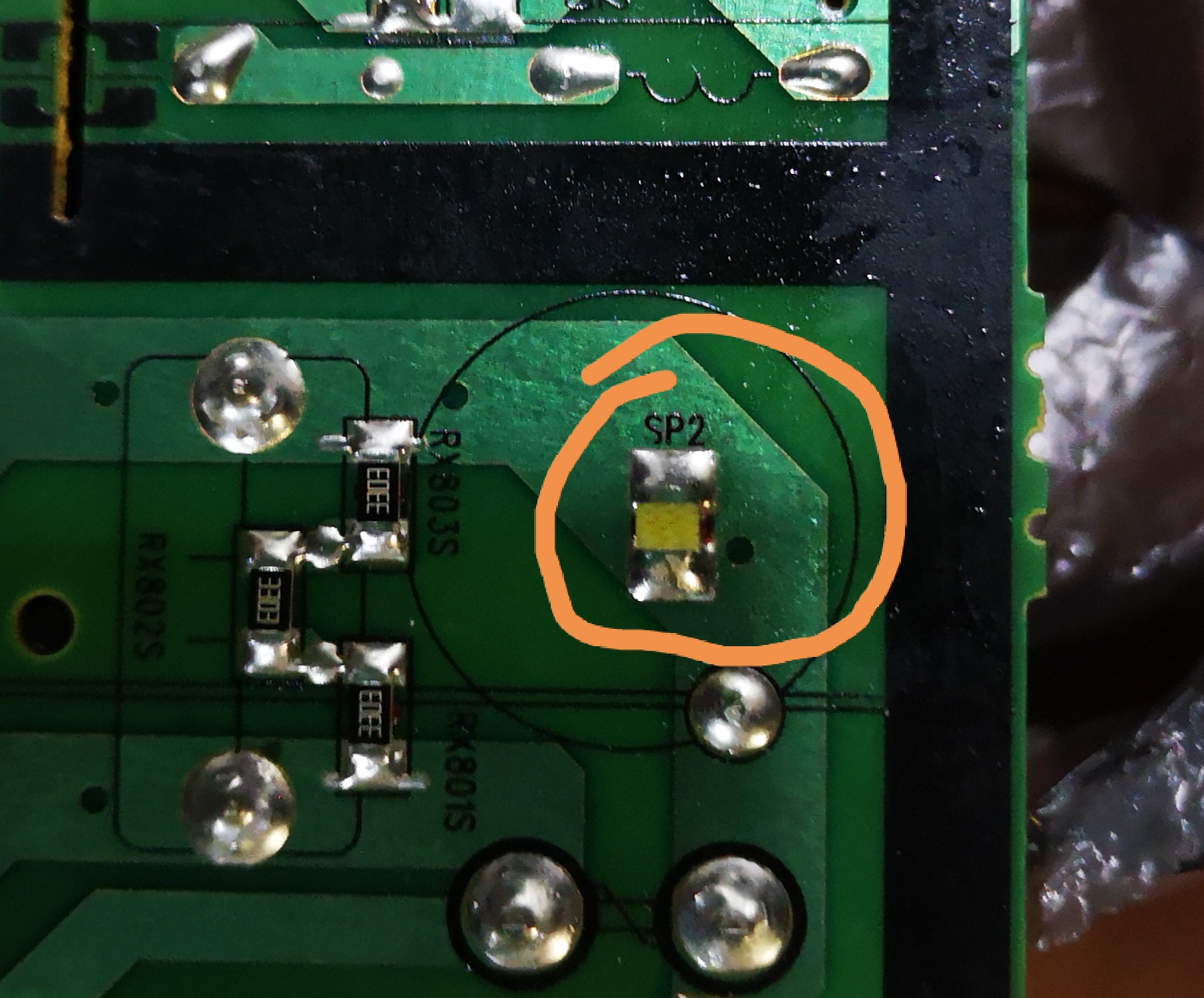

    Ho to everybody can anyone help me and explane what component is in photo? Thansk
  • KvnTM
    • May 2018
    • 434
    Re: Help for identify componenti on Samsung Power supply
    Looks like a vertical soldered pcb to me. Is there anything on the other side?
    Can't be any component since both pads are soldered on one copper plane.
    Would make no sense.
      Yes Is vertical, but there isn't anything on the other side.
      It Is soldered like an smd.
      • Beau28713
        • Feb 2018
        • 50
        I swear that looks like a surface mount LED to me.But i could be wrong.

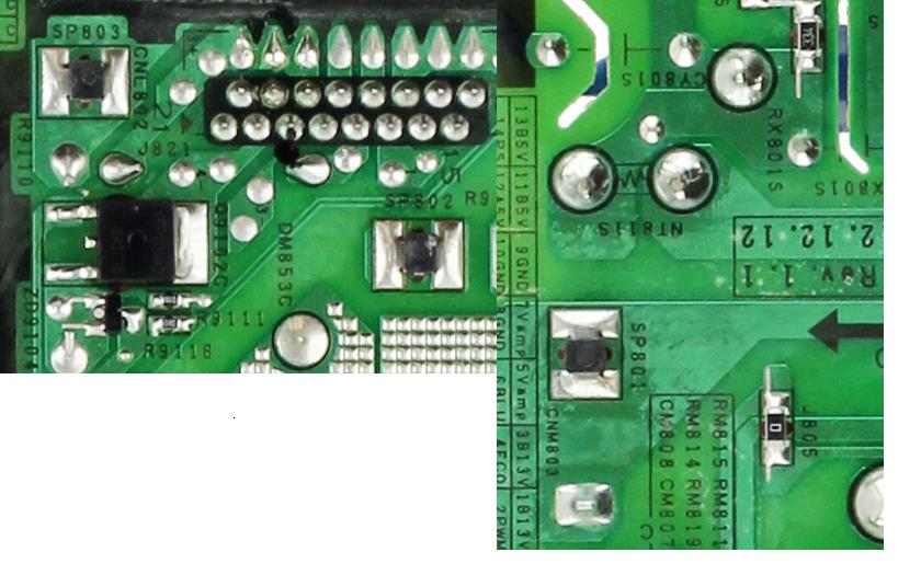

              I don't really know what they are, mabe just a SPacer? Other similar boards have them and in different places
                i looked up smd spacer .
                  Could those be big vias to connect the top layer to bottom? Maybe plated vias couldn't handle enough current or it would be impossible/too expensive to make such large plated vias?
                  That would make sense to me as i can't see any vias on that board.. Or is this a single layer board? I know PSUs are usually single layer.
                    The board is single layer, no via's. They don't seem to be part of the circuit, so maybe they are used during the manufacturing of the board.
                      Ok I'm out of ideas then as to why they would put those in. Increasing BOM cost for no reason?
                        Ok thanks to everybody,now i understand thas this component isn't important for this board...
