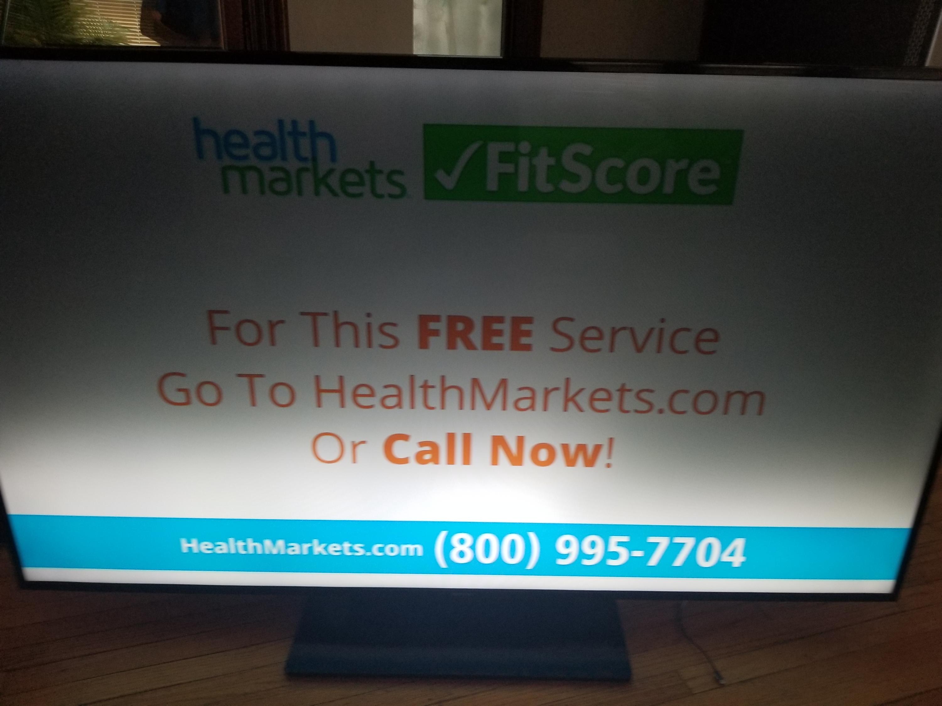

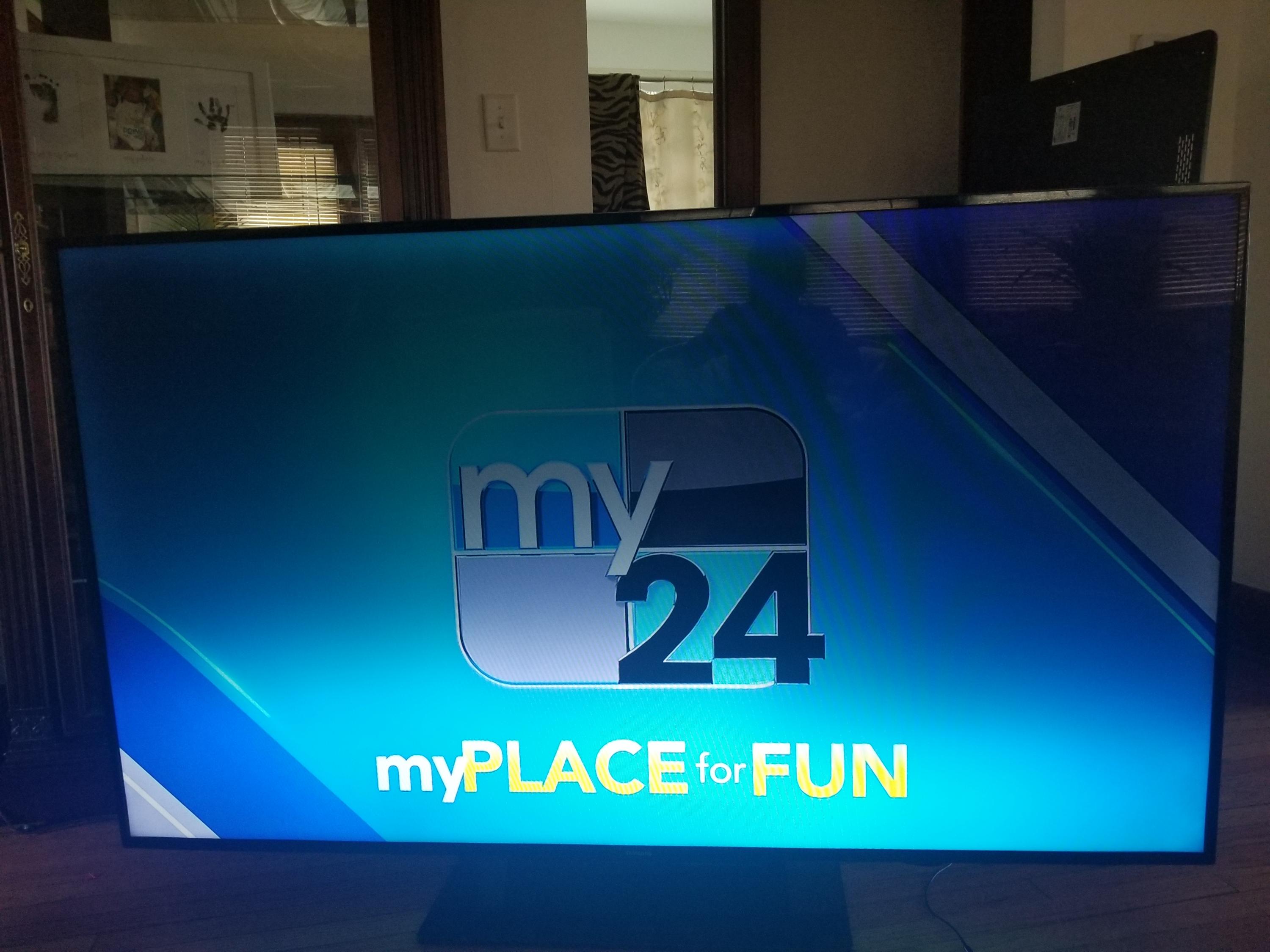

    Hi guys this is a TV that is at my friend's house he needs help repairing I told him I'd ask if it's even worth fixing. I will have all specs tomorrow but could this be panel issues and unfixable. Any thought?

    It looks like it could be edge lit with the top edge not being illuminated.

        Yes, either by replacing the individual dead LED(s) or the whole strip.

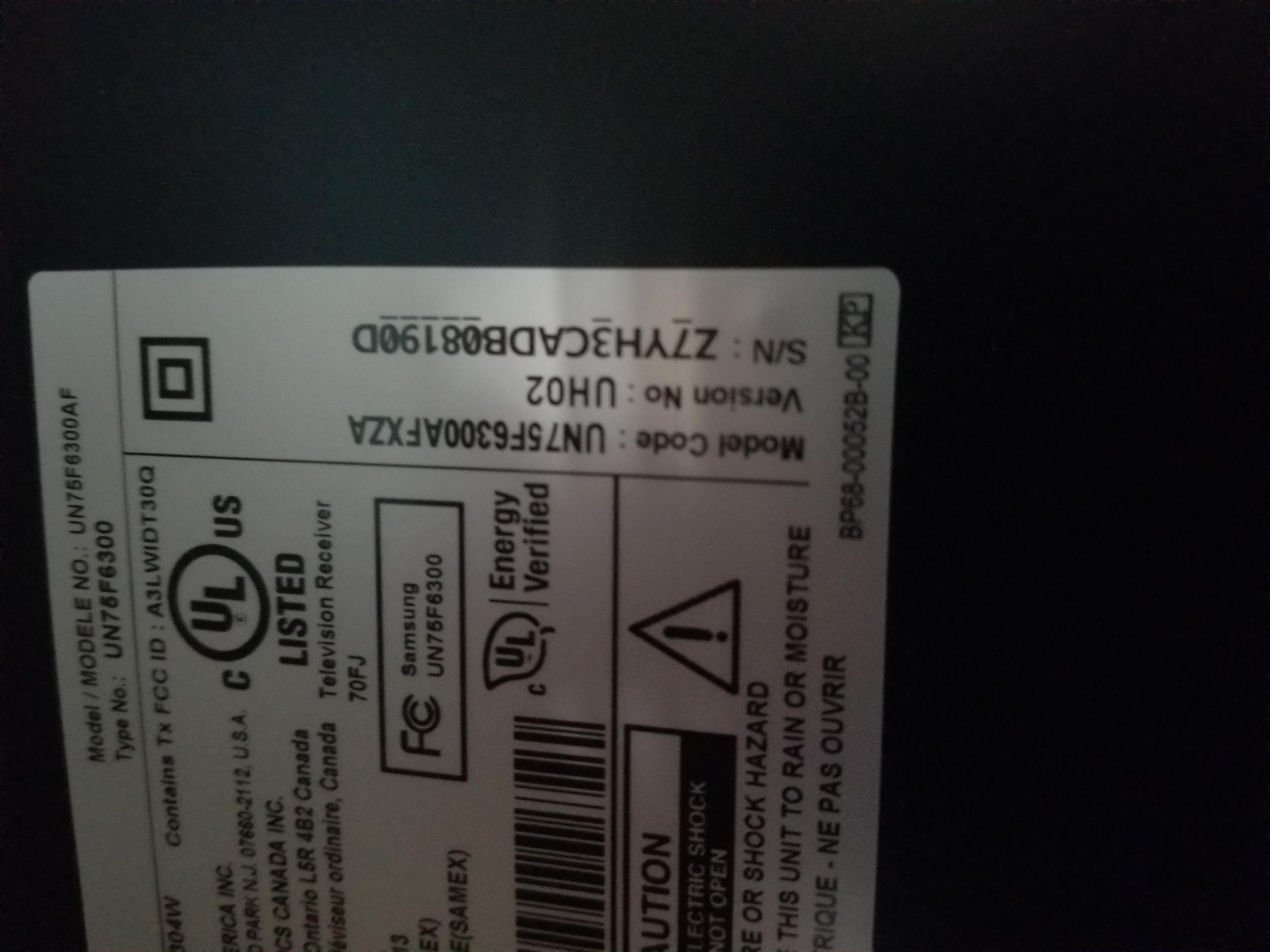

            This is a UN75F6300
            Version UH02
            2013.

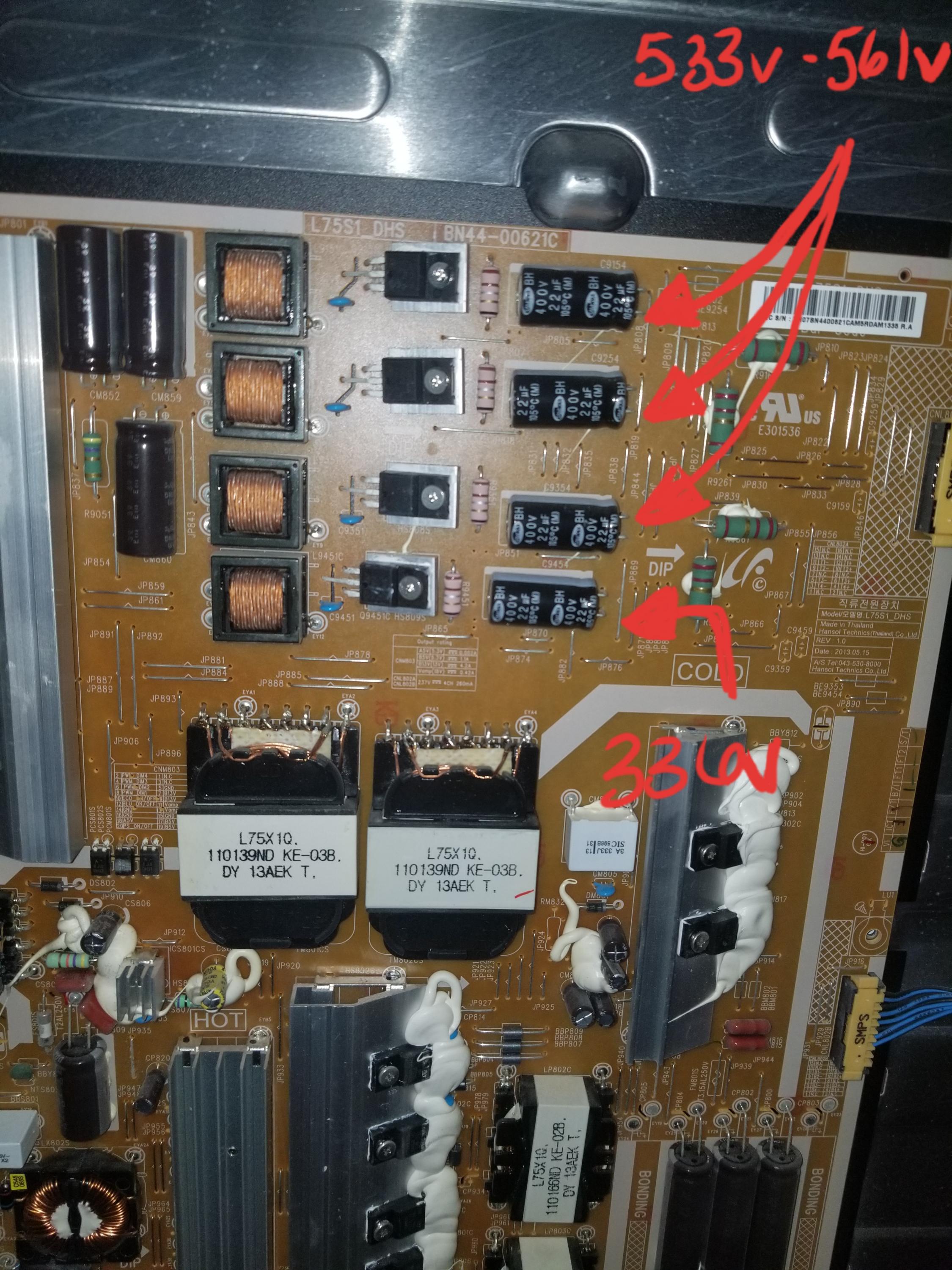

            I found a few posts on this actual TV but they never seemed to get to the bottom of the issue. So I did test the LED capacitors and I got 336 in the lower capacitor and fluctuation between 533v-561v on each of the top three capacitors. Now I'm assuming I'd have to open the whole TV up anyway to check on the LEDs?
                    If you check the dc voltage across the two legs of each of those capacitors it cannot measure more than 400V, the rating of each capacitor, otherwise the capacitors would explode.
                    I can't quite read the print on the circuit board photo but it looks like the led drive voltage is 237V @ 250mA
                    Shopjimmy do a repair kit for this board which may give you an idea of what to check out.
