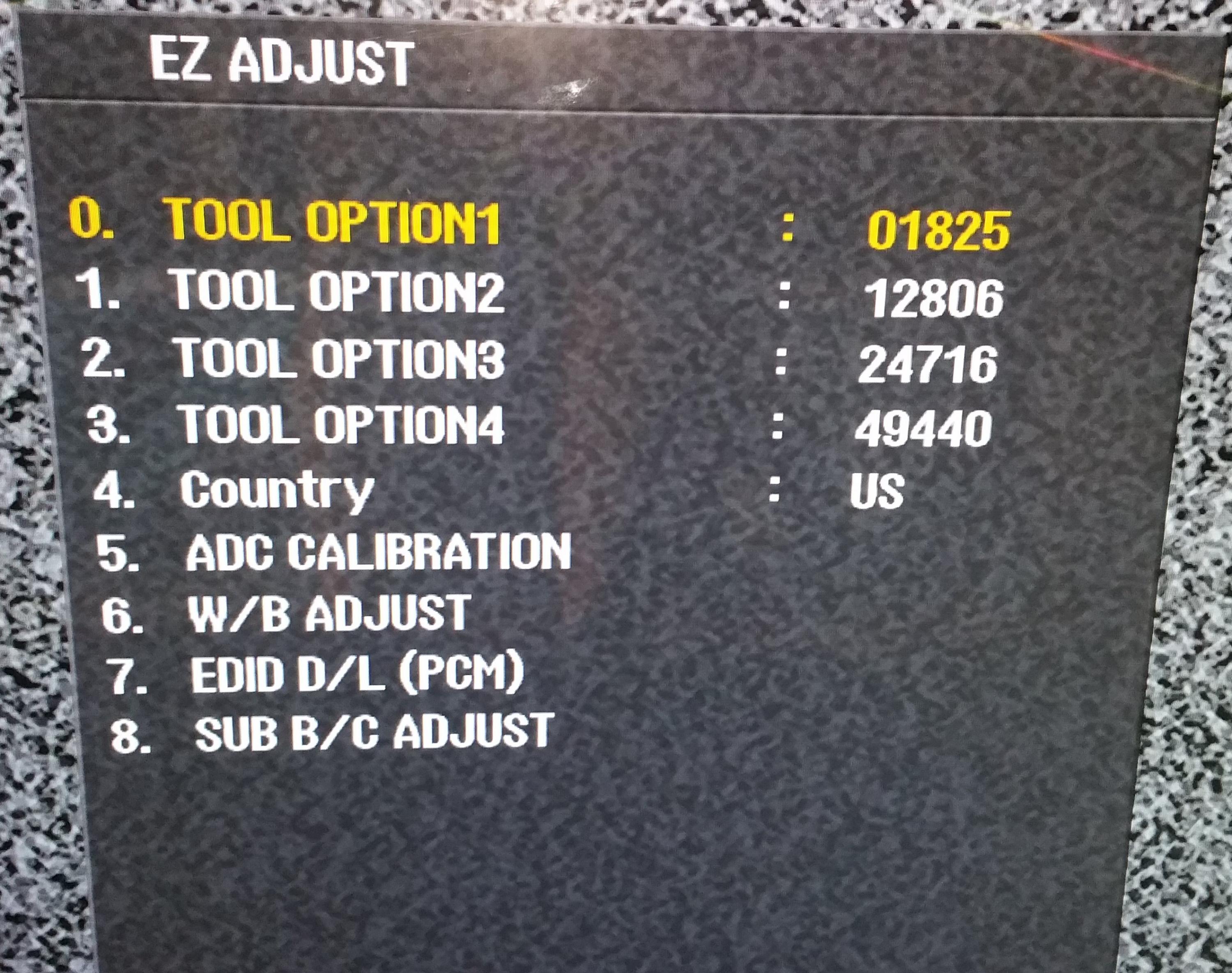

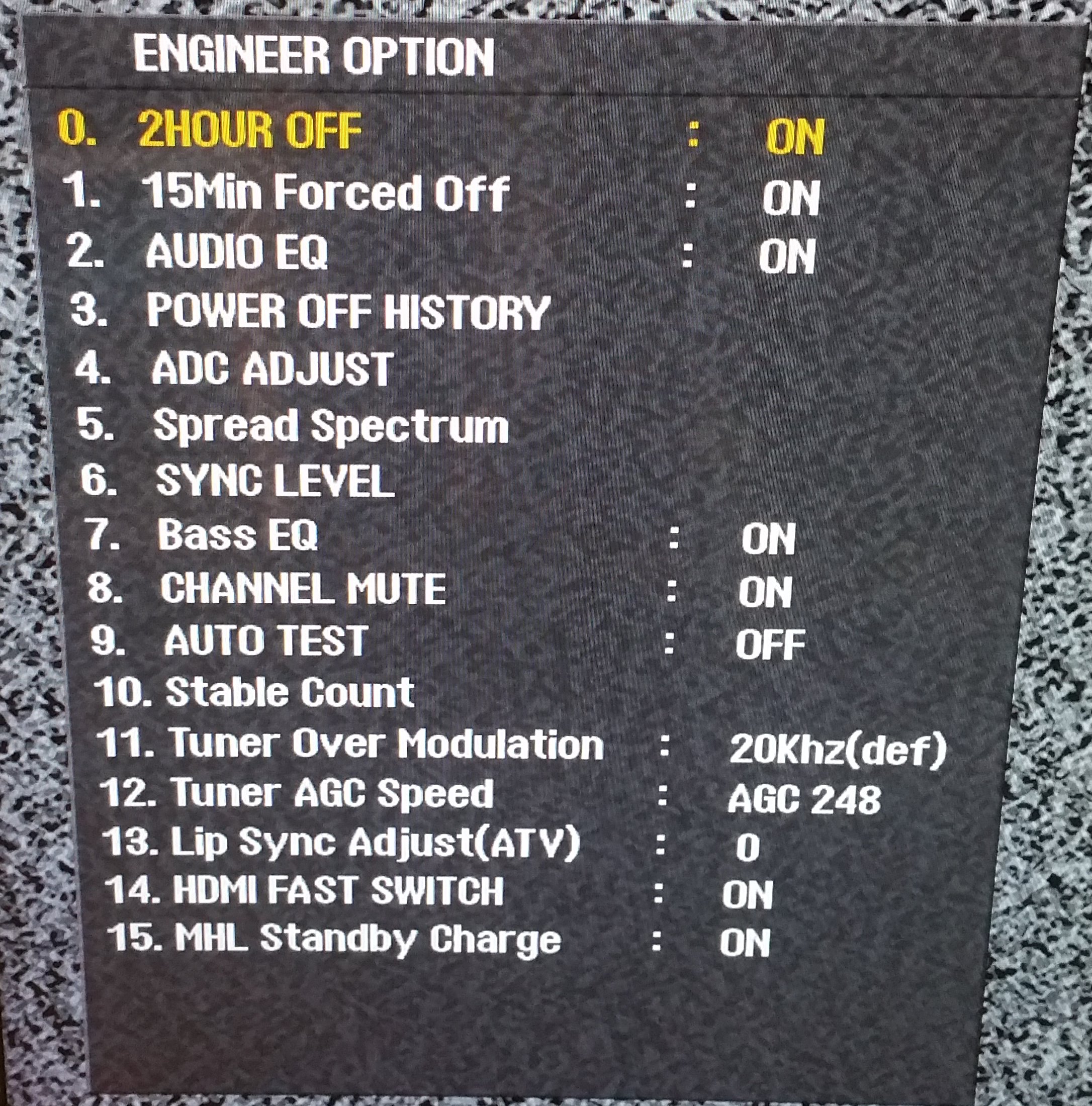

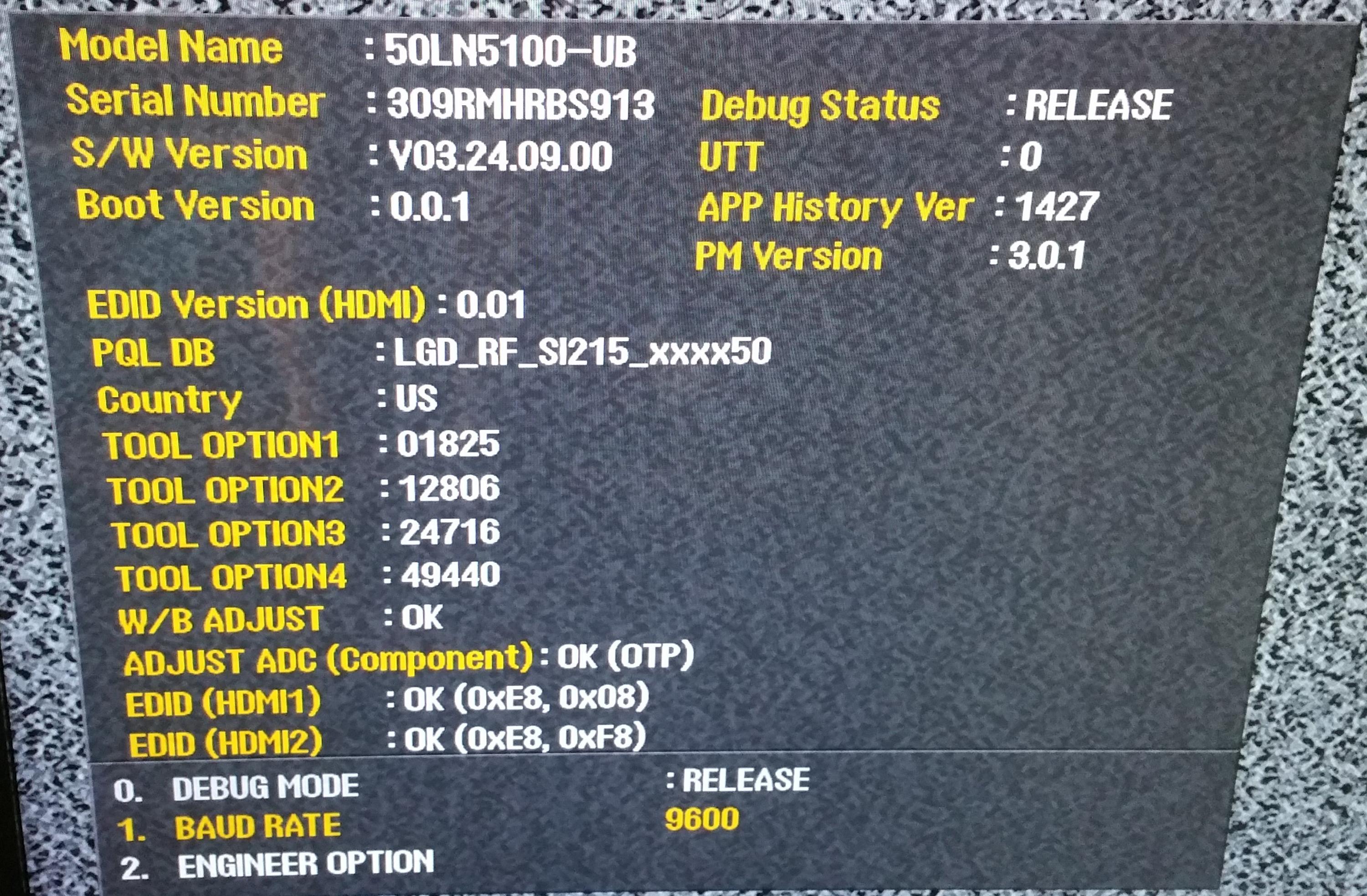

                        Holy Carp!!!! 0413 worked!!! Thanx a bunch!!!
                        These are the screens I have access to now..
                        Any idea what may flip the screen???

                              Re: Another LG, Another TCON Issue.. 55LN5100
                              SUCCESS!!!!
                              I thought those "TOOL OPTION"s were numerical values..
                              They were actually OPTIONS... Duuuuhhhhhh
                              First one had mirror mode...
                              We're golden now.. Thanx a bunch for all the help!!!
