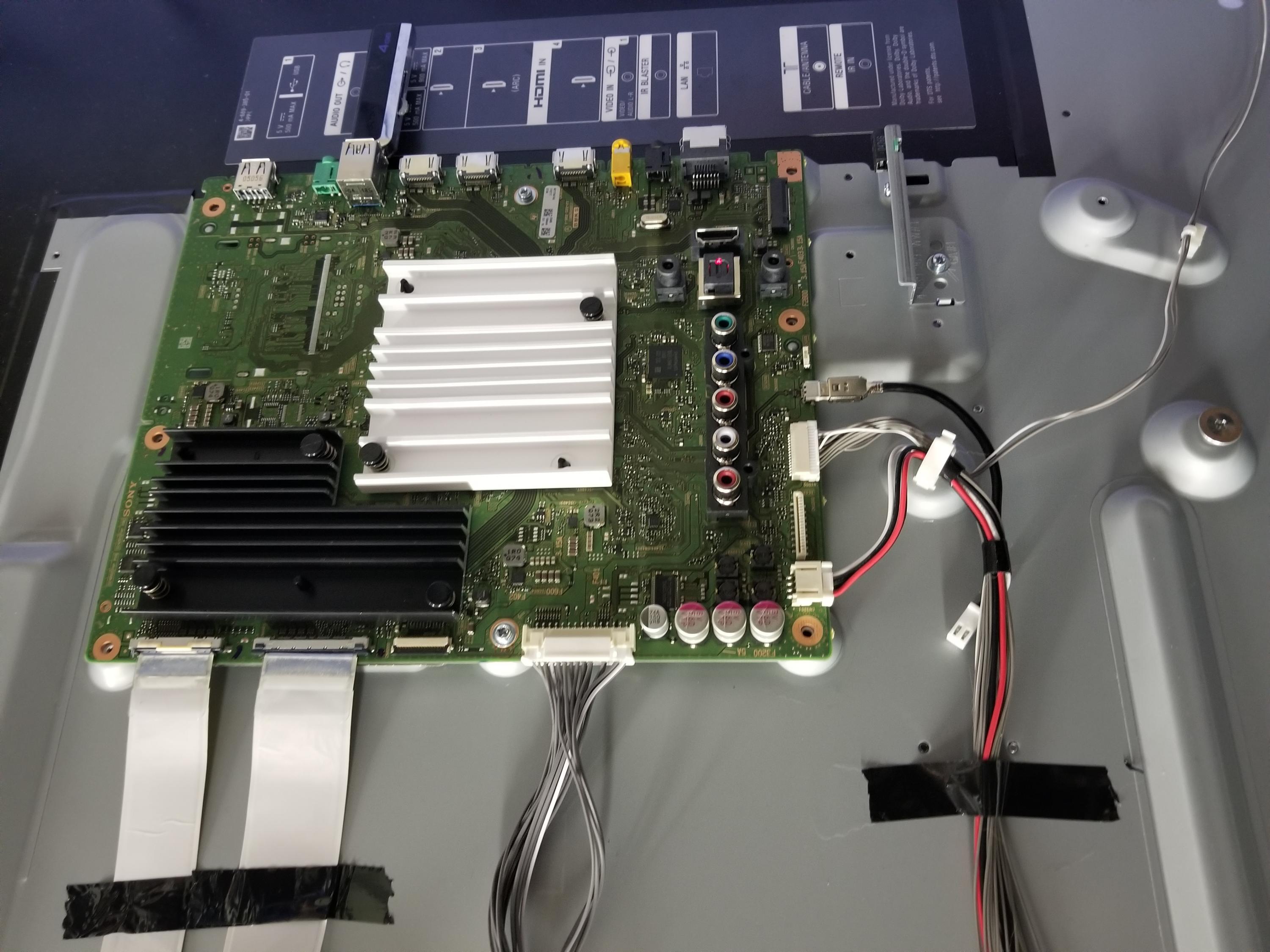

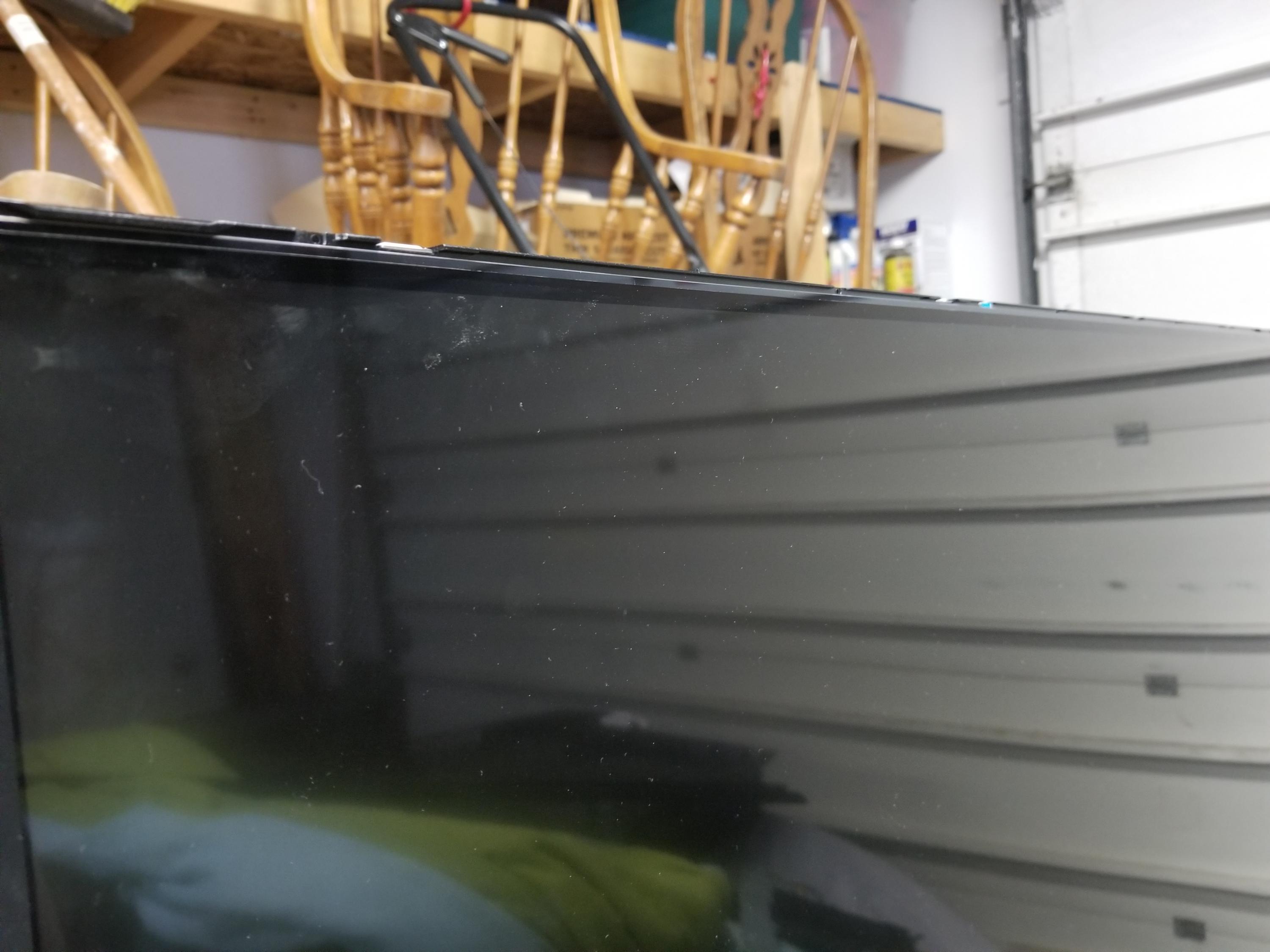

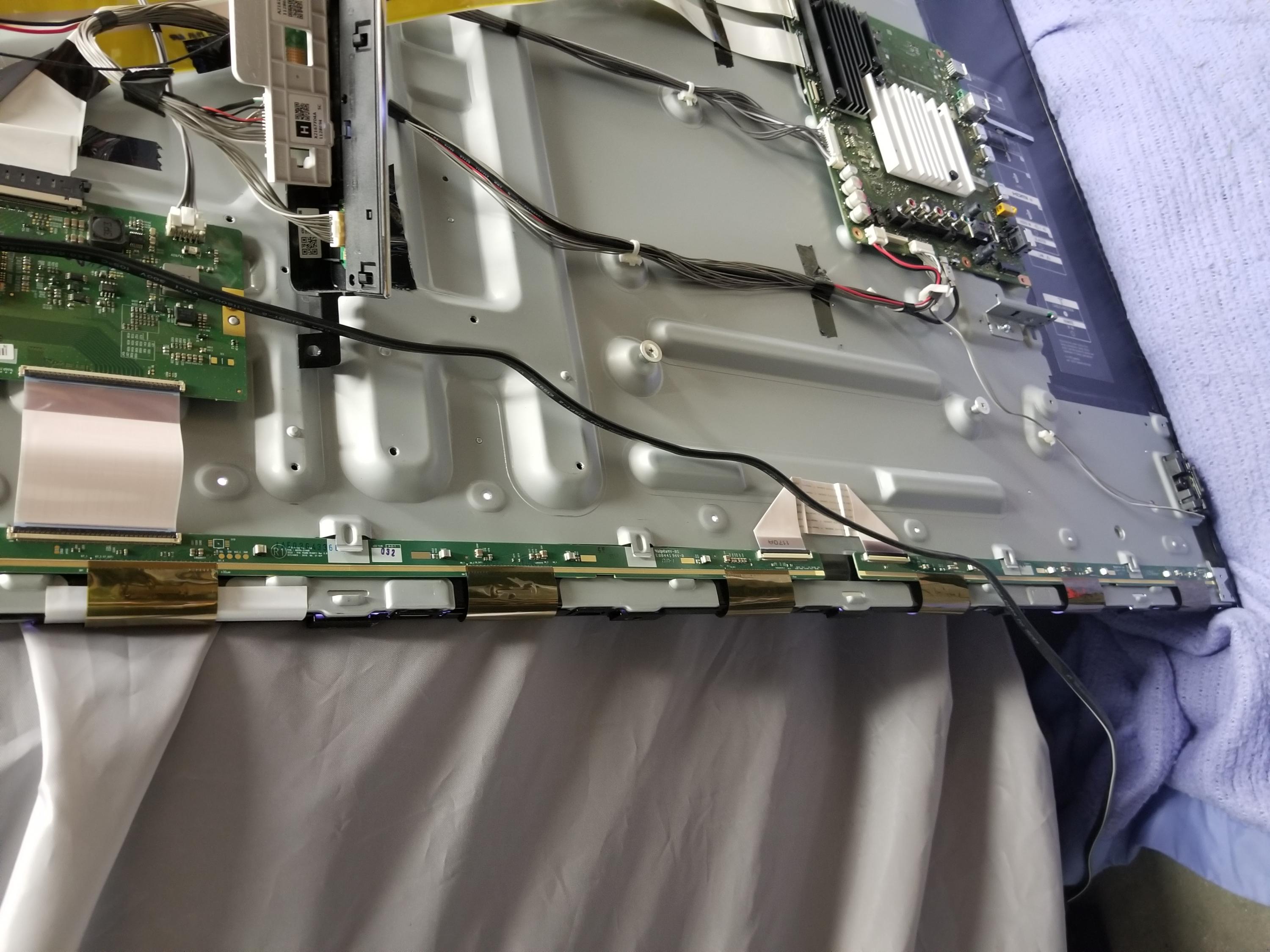

                Yes I removed all the side bezels and there are no tabs, even lifted the lcd up a bit and nothing. I started to try the tape method and unhooking one side of the tcon causes just a fully white side with no distortion. Unhooking the other side still causes distortion with the white so I am guessing the side that takes away distortion is the problem side
                One problem though...the screen will no longer display anything...just a black screen. The back light is on and I can tell there is something happening because when I hit buttons on the remote the screen dims and lights up...I tried the reset method with the green light and all but still no picture.
                • codycowgill
                  • Aug 2015
                  • 21
                  Re: Sony xbr 75x850e flashing lines

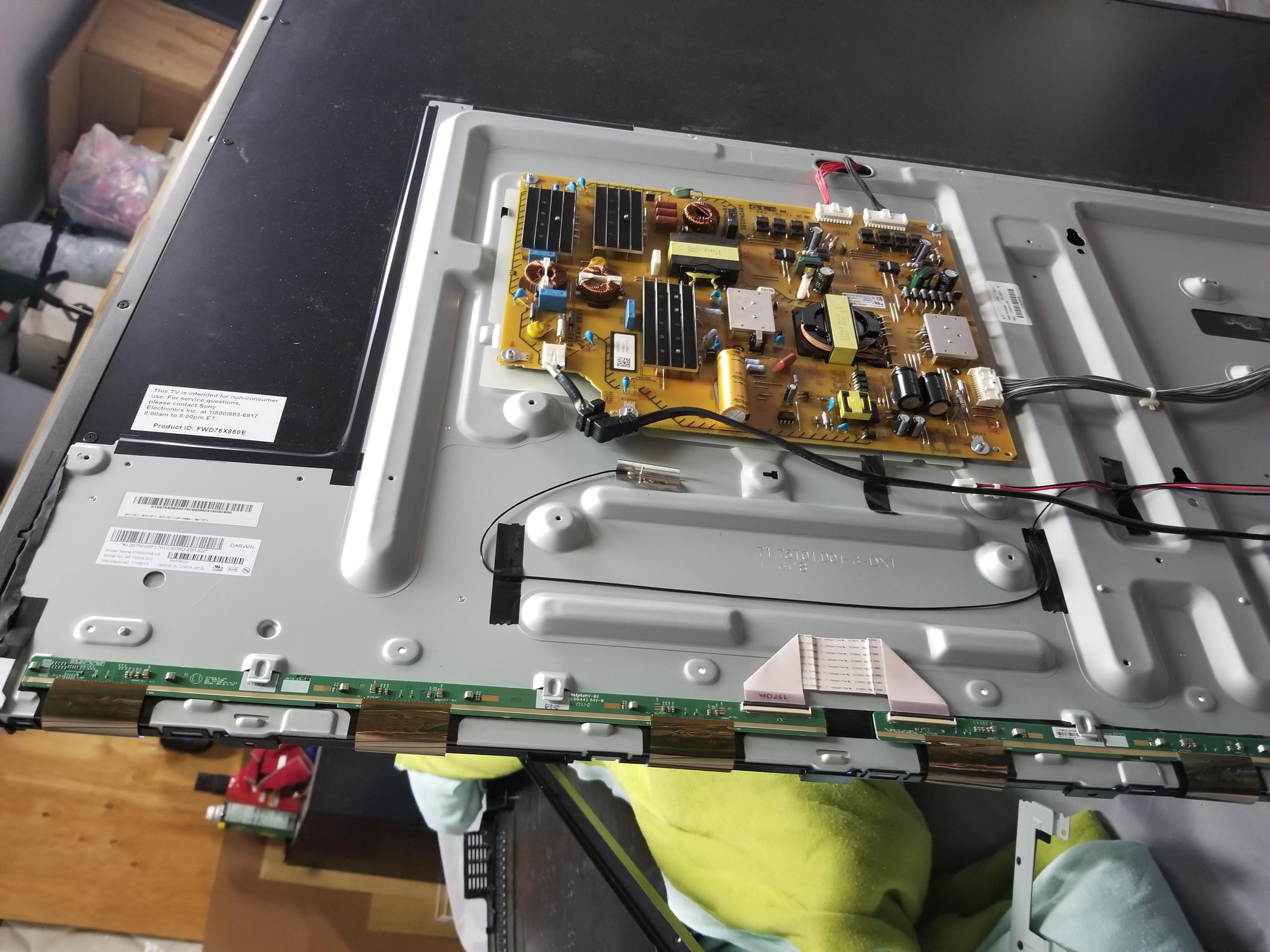

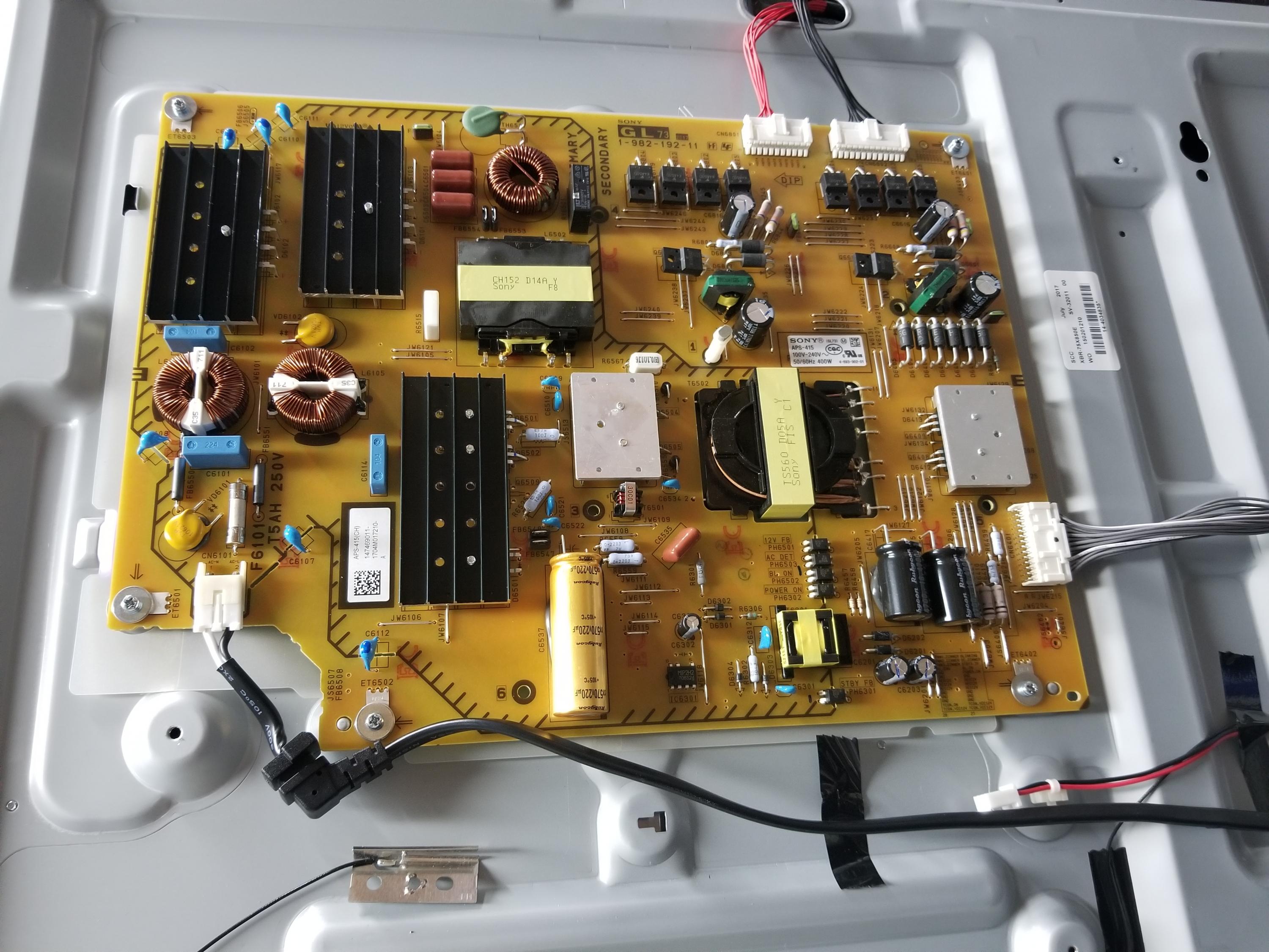

                  Here are some pics. I included one with the side bezel removed. Both sides look the same. No tabs. Lifted lcd layer up a bit and there are none tucked underneath either

                        That usually means that you don't have the cable align properly in the connector or that there is an issue on the contacts at the end of the cable or in the connector. Look carefully to see what up. Further, when a cable is removed, there corresponding side should be white as you seen. IF that no longer happens, then there is a problem usually with the edge boards (ie. shorted / open smd components).
