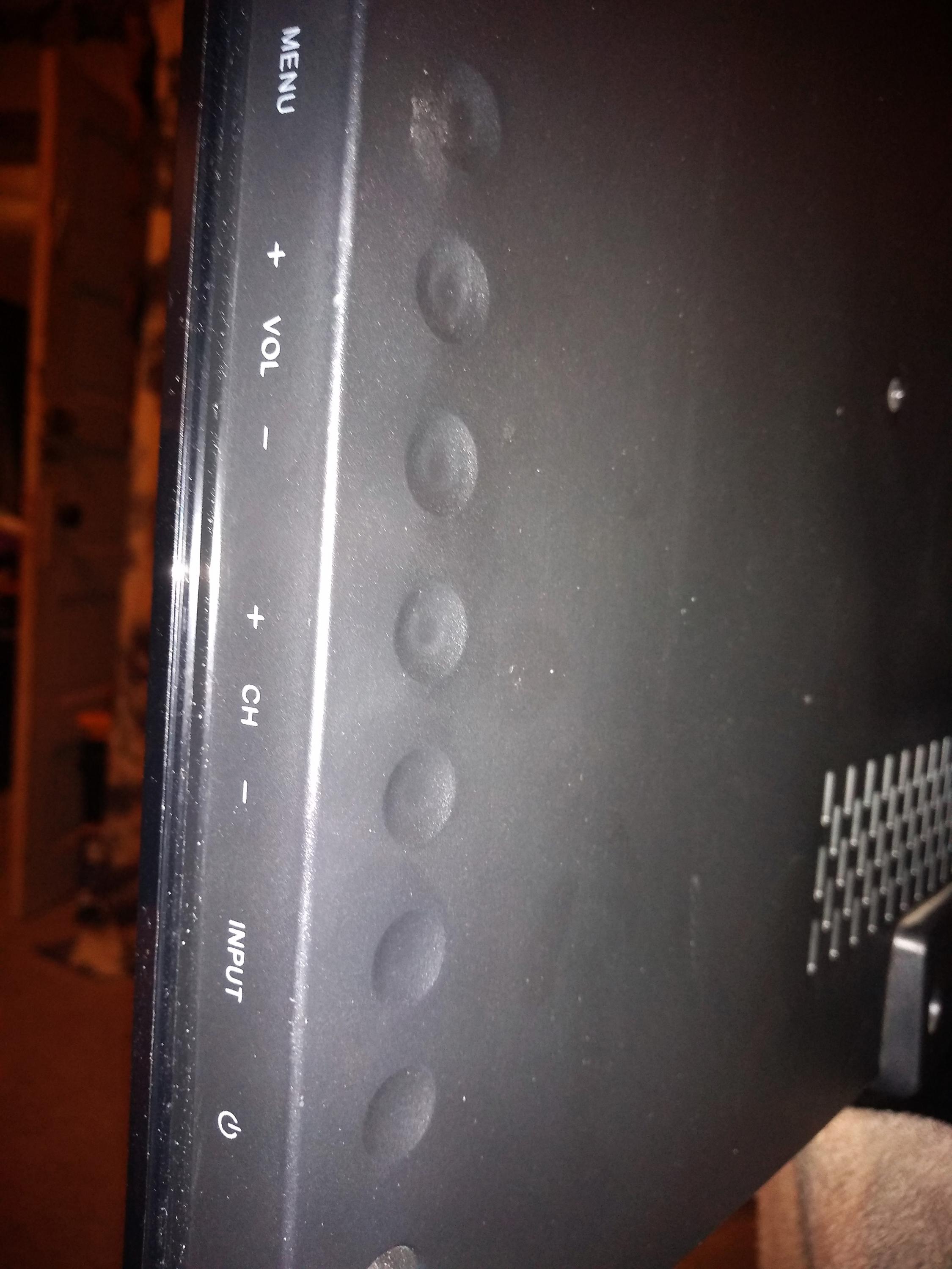

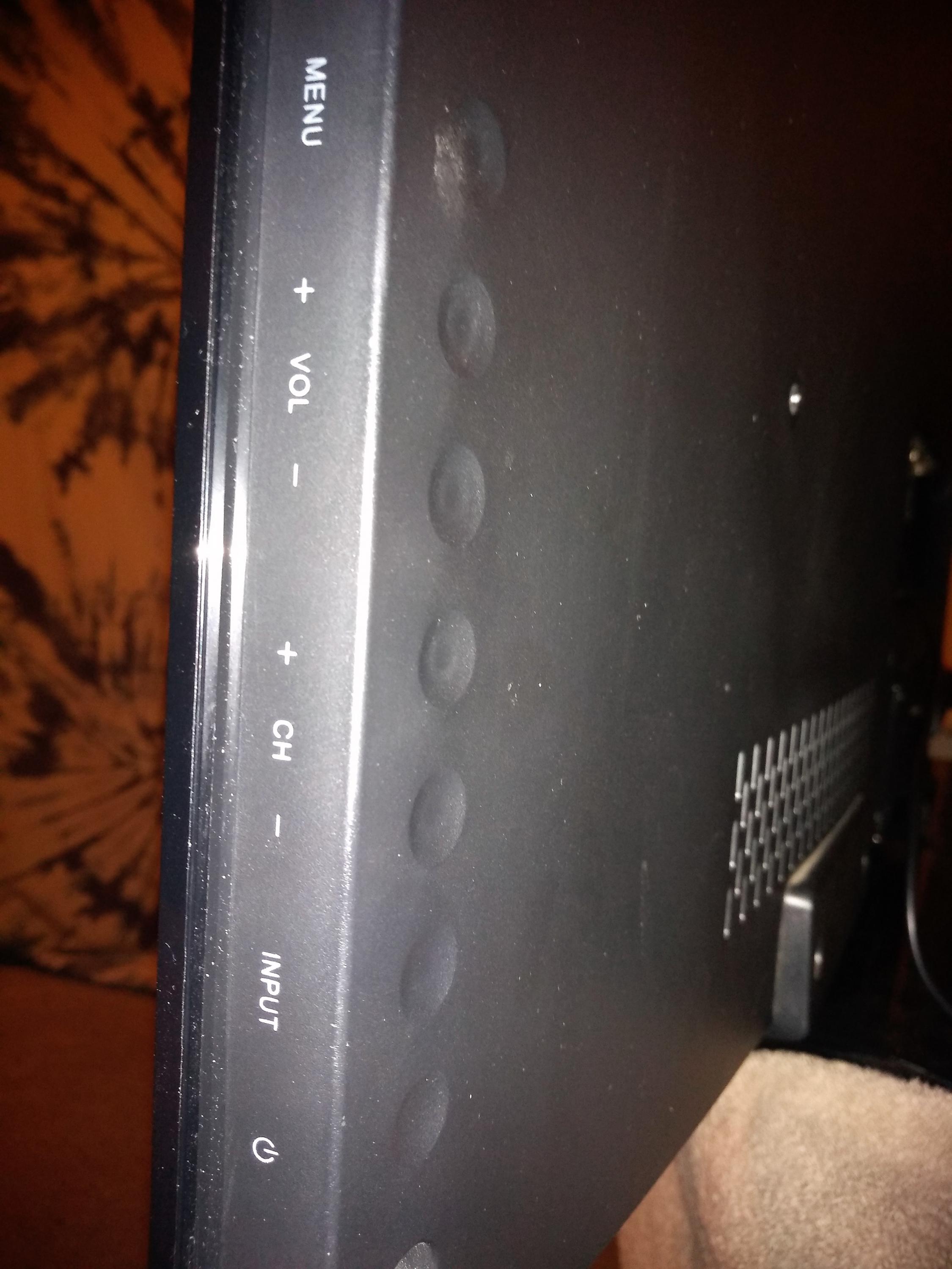

              They are new batteries. It isnt just the remote that acts weird sometimes, the side touch board, besides the + - volume being reversed, will also bring up that "Lets Get Connected" menu if you press the buttons fast enough. I've posted a few pics of the touchboard. I wonder if I would need physical buttons, or maybe a jumper to do the button combo you posted.

                I'll tell ya, I dont think there actually is a service menu on these things. Maybe the old ones had them. But if they have them, why doesnt ANYONE know how to access it? You would think that after all these years, there has to be SOMEONE who worked on these that let that info out. Yet, no one here seems to know. I've searched online for hours upon hours and havent been able to find it. Its like it doesnt exist. So yeah, maybe it doesnt exist because there isnt one. Its garbage because I'm certain this has a perfectly working panel but I'd have to pay someone 80-100 bucks for a mainboard that *might* *hopefully* work. UGH.

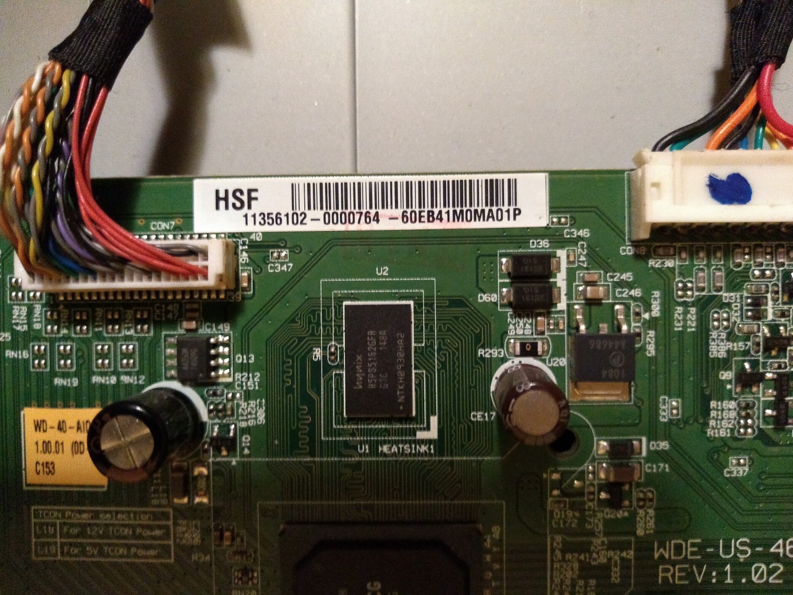

                            Ok, now is the board with this number 60.EB41M.0MA on the sticker, the one that is NOT matching up?

                              Thats a good question. I didnt think of that. I contacted the previous owner who said she would try to get me the picture they took of the old mainboard they replaced. She said she had forgotten and would look. Not sure how that will help things, I just would like to know.

                                  60EB41M0MA01P is the board thats in there now.

                                    It's looking like you need 60.EB41M.0SA, I think the other folks ordered the M.OMA and that's probably where the problem lies.

                                      Now the 15 dollar eeprom on ebay might be the same for both mainboards and might work, someone with just a little soldering experience could probably get the job done, it's a 20 minute job with a coffee/beer break in the middle, even if you are slow. BUT if the boards are different then it probably wouldn't work, but if it's just a firmware problem it might work, at this point I would take the 15 dollar gamble on the eeprom.

                                        I agree. She said they gave the person they bought the "new" board from the numbers off the board and thats what they seller sent them. I'm not sure why they didnt return it and try for a diff board but she said they were over it at that point and just wanted to cut their losses and get rid of it. I would like to know exactly what board was in there they replaced to begin with. If they still have the old one or a decent picture of it we could put this to rest. The TV is worth maybe $50 working to me and I have $16 in it by fault of me throwing 2 T-Cons at it. If someone with the right mainboard would trade me for mine plus a little cash that would be super swell. The chances of that happening are slim.

                                          Picture I was sent of the "old" mainboard was terrible. Picture taken of a picture on a monitor screen. She doesnt have anything better. Not gonna post it here because the resulting laughter at my expense would just be insult to injury, lol. I can make out that there is nothing populating the RN20 & RN21 locations. So, the original defective board was the correct board(obviously) and they did indeed get the wrong replacement board. I'm done harassing her over something she gave me for free. I'm going to try to sell the mainboard in the TV, and then put the $ toward one I found online for a decent cost.
