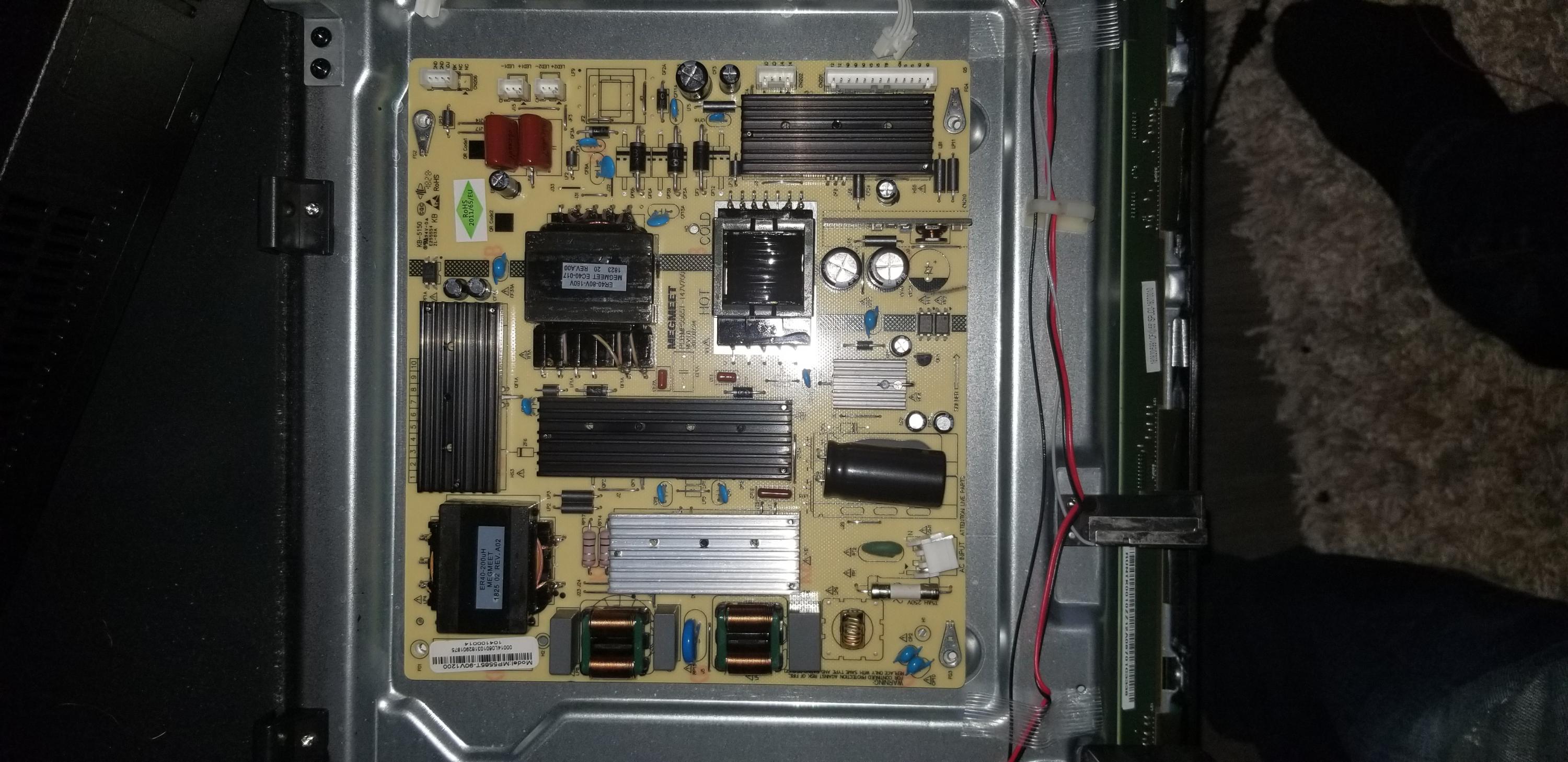

    I have a Westinghouse TV, when I plug it in the green light comes on no backlight no video showing on the screen with flashlight listed below are the voltages.
    There is no response when pressing buttons on tv or remote.
    Cn201
    V12= 12.3v
    V12= 12.3v
    Gnd
    Gnd
    Gnd
    V5= 5.1v
    V5= 5.1v
    Stb= 5.1v
    Ps-on= 3.1v
    V5= 5.1v
    V5= 5.1v
    Cn202
    V24= 24.6v
    V24= 24.6v
    Gnd
    Gnd
    Led2+ 0v
    Led1+ 0v
    Led2- 0v
    Led1- 0v
    Cn206
    Bk= 0.1v
    Adj= 0v
    Gnd
    Gnd

    With tv unplugged from power, unhook cable from powerboard to mainboard, plug tv into power, see if backlight comes on and stays on.
      Re: Westinghouse wg55ur4100 no response
      Bk= 0.1v. Bad, there is no BL-ON from main board to turn on backlights circuit.
      Adj= 0v. Bad, there is no Dimming control control signal from main board.
              Looks like the TV is actually running, just no backlights...
              BLon is generated on the main IC on the main board. :-(
              You could try to unhook the BLon at the PSU, and jump STBY or PSon to it via a 1k or so resistor. Just make sure you don't backfeed power. I'd either cut the BLon wire or take the wire with the pin out of the connector.

                    Jumped bl on still no backlights. The led connector showing 3.5v on led1+ thats it. I cant find a 12v supply on tcon ethier

                      Probably need to use a resistor on each pin ps-on and BK and maybe ADJ too, going to 5v standby, so 3 resistors, one going from each of those pins to 5v stndby. That might bring backlights on to verify backlights and powerboard.

                          Did you disconnect the BL-ON wire before jumping it? I hope you did otherwise you will damage the main board, which at this point it already has problems.
                            Oh shit, forgot to say if you do this MAKE SURE the cable/s from powerboard to mainboard are unhooked.

                              Ill try jumping all 3 to stby. I did unhook main.

                                Jumping all 3 to stby worked for backlights. So guess need find main board unless possible to trace where issue on main is.

                                  Nice job, yes sure looks like the main is the problem.

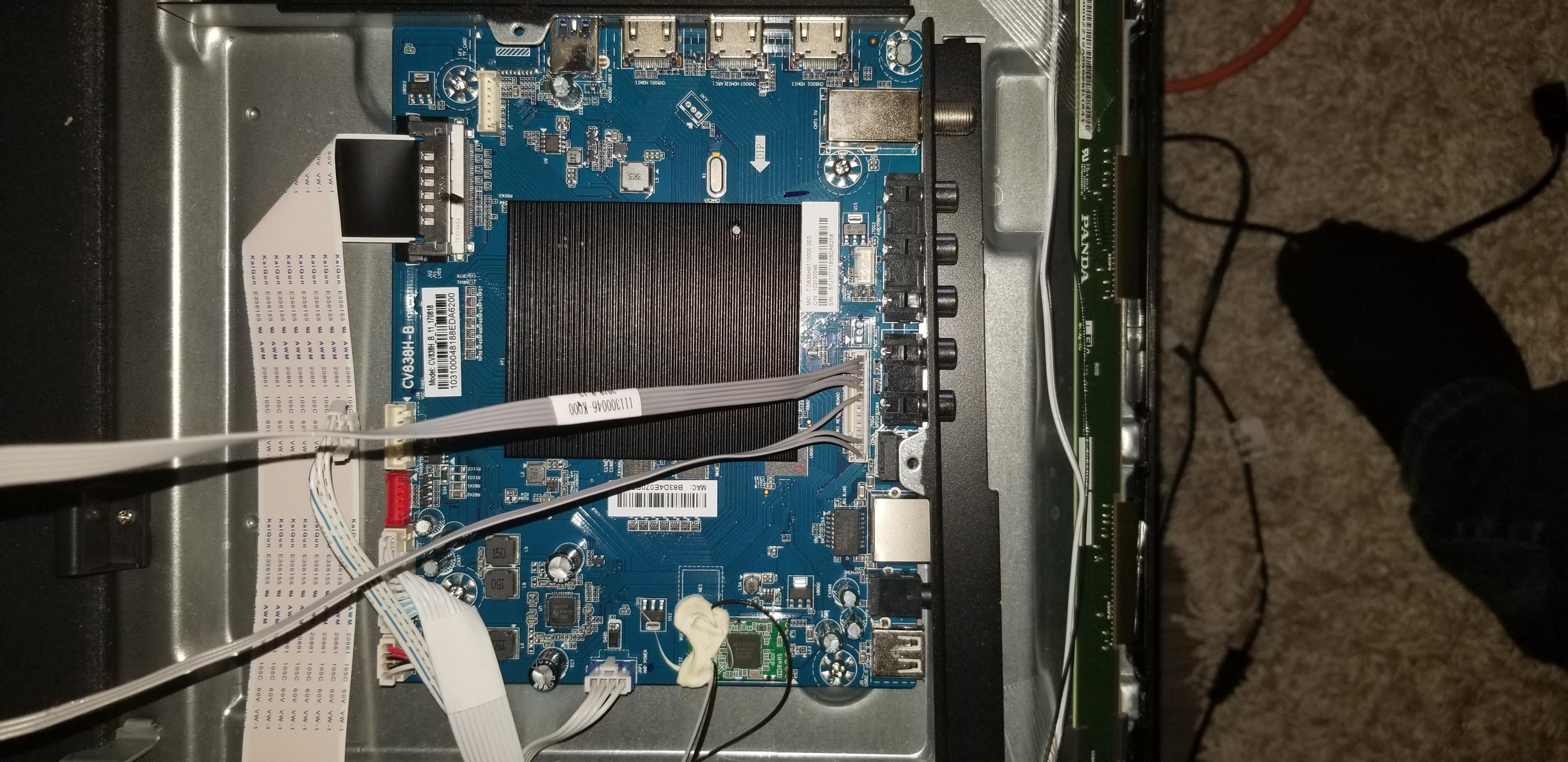

                                    Cant seem to find replacement main board, be nice if these main boards could be repaired.
                                      Would main board from50" work or one from 55" element?

                                        Well, there are too many main boards. You have to look after an CV838H-B from a 55 inch tv. I could cut it down to 6 different main boards. Anyway, maybe take the main board out and see if there is a sticker on the back of it.
