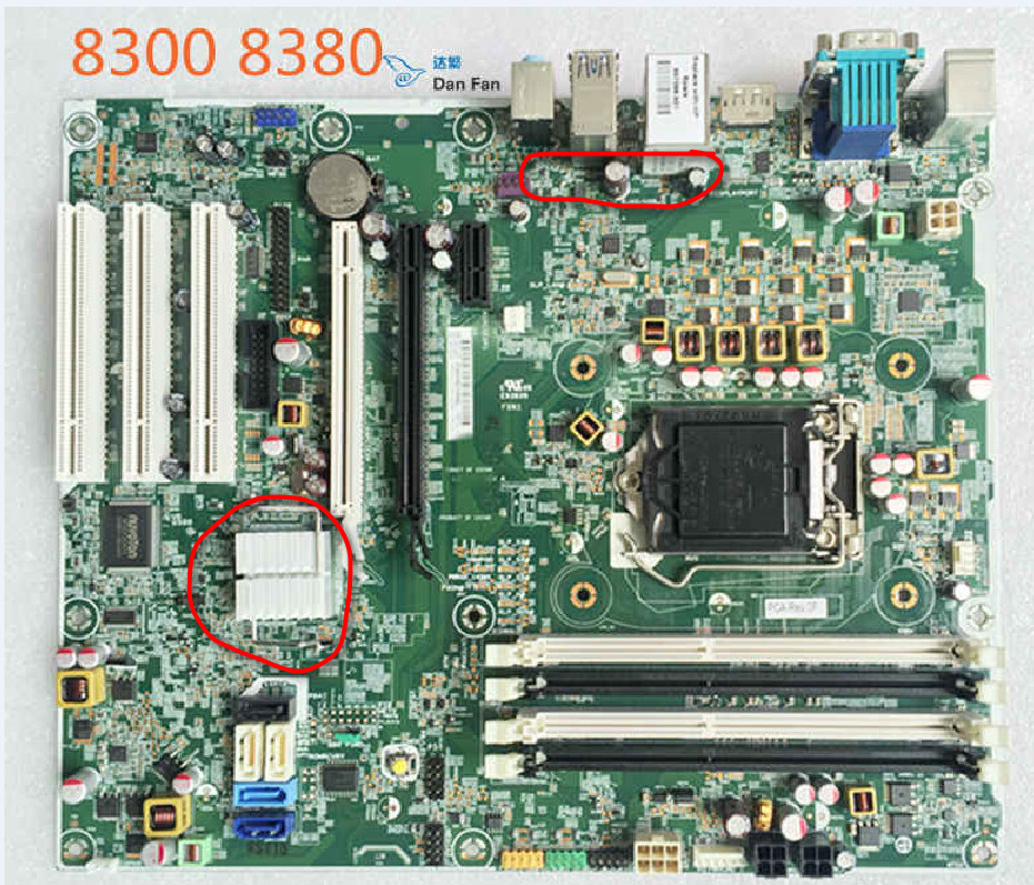

                  Re: HP Elite 8300 computer completely locked no response from key board or mouse
                  Remove the heat-sinker of main chip. Power on the board and feel the surface, if it is more worm than normal.
                  If it is then keyboard and mouse will stuck, and u have to replace that chip
                  Sometime the smd capacitors near usb ports short. Also check them
                      Thanks for the photo and pointing out what to check
