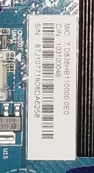

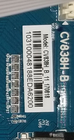

    Re: Westinghouse wg55ur4100 no response
    Cv838h-b-11-170818 is the number
    • CapLeaker
      Leaking Member
      • Dec 2014
      • 8327
      That is the main board number. I am looking for the part number.
      • microvibe
        • Mar 2013
        • 275
        • canada
        These are only numbers i find on board
        • nomoresonys
          • Jan 2013
          • 12276
          • U.S.
