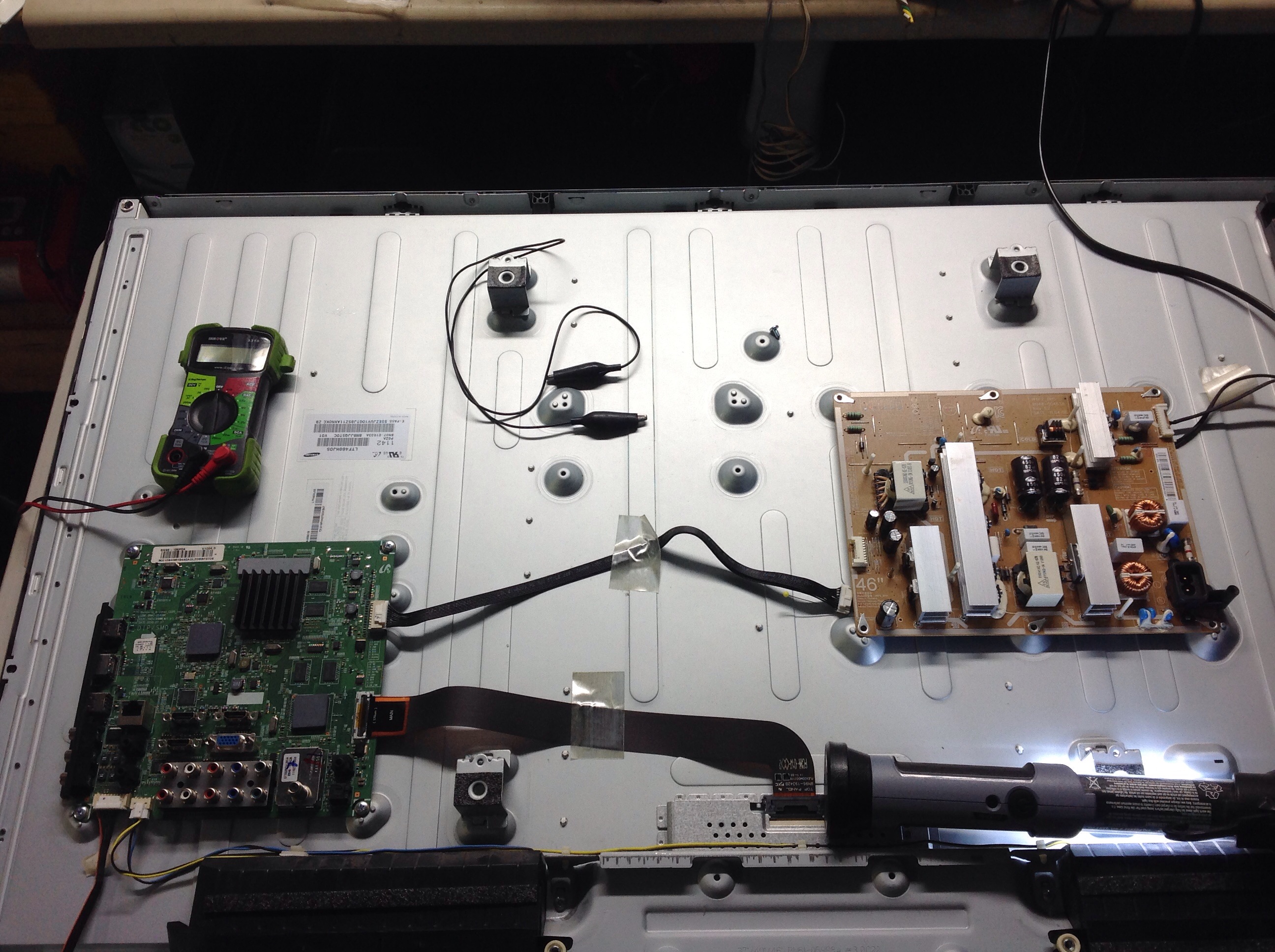

    Hello I'm by no means savvy but I can spot boldged caps and do basic soldering. I've fixed e few TVs but this one has me stomped. Visually everything look good. The TV has the same symptoms as the following post.
    https://www.badcaps.net/forum/showthread.php?t=53599
    Audio but no picture, if I disconnect the inverter board the LCDs come on for half a second.
    BLU_ON 5.05v
    PS_ON 4.87v
    CP802 158v should be 380-390v? 515 ohm
    CP803 158v should be 380-390v? 515 ohm
    DP810 445 ohm
    Inverters 841 ohm
    CP801 481 ohm
    CP802 481 ohm
    CI1818 0 ohm is this expected?
    CX802S 0 ohm
    CX802S 0 ohm
    Both fuse are good
    CM811 450 ohm
    CM809 199 ohm shouldn't it be the same as CM811 they are the same part?

    Test connector from mainboard to powerboard on powerboard side with all boards hooked up, test with tv plugged in but off then hit power, report both conditions here, give pin number, pin description/name and condition on and off, that is where you start in most cases, it gives the helpers a lot of info. to work with. When you get the audio no picture, can you see any text or anything on screen with a flashlight by pressing menu or anything?

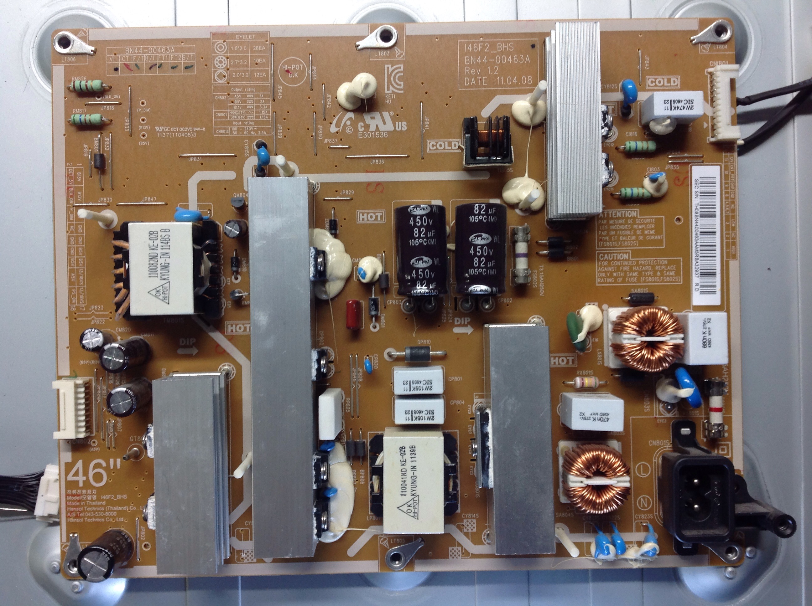

        Right now you do not have the PFC Boosted Voltage even though the PS-ON is present. Please upload good clear straight shot pictures of the power supply board top and bottom side of YOUR board, also pictures of the whole backside of the TV showing all the boards.
        Your power supply board is BN44-??????

            Bn44-00463a i46f2_bhs

              Look closely check for bad/cold solder joints.

                    So what happens if you unplug cable from powerboard to mainboard, (tv power cord unplugged of course) then plug tv power cord in, see if backlights come on.

                            Main board disconnected from power board: I get no sound and LED strips light up for half a second. I did the flashlight test and I see no text or image. The low and high voltage pins going to the inventer board 0v.

                                      The control signals are fine but you do not have PFC boosted Voltage so you need to check and work in the PFC section first to get that 380 ~ 400VDC on the main cap first.
                                      So you need to get the P/N of the PFC IC ICP801 to look up the spec sheet to find out which pin is the VCC pin so you can verify if the VCC is present or not for the PFC IC to run.
                                      Samsung BN44-00463A (I46F2_BHS) Power Supply Unit
                                      https://www.shopjimmy.com/samsung-bn...upply-unit.htm
