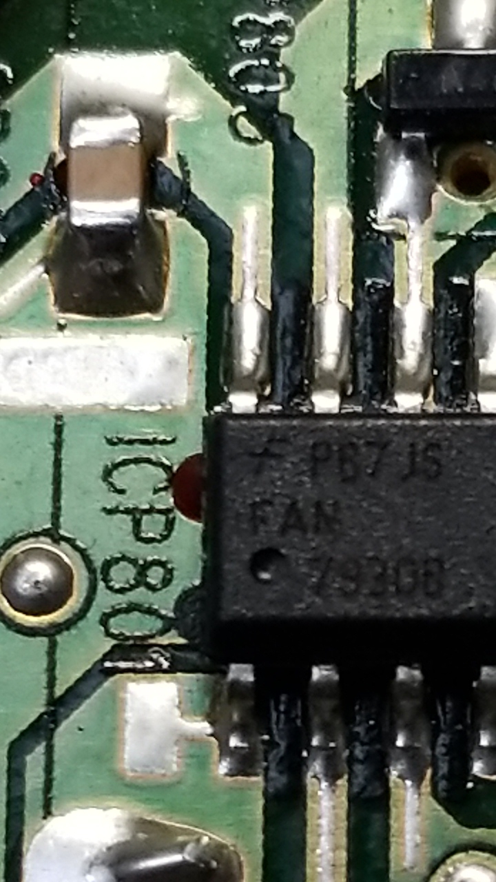

      Here's a pic of PFC IC ICP801

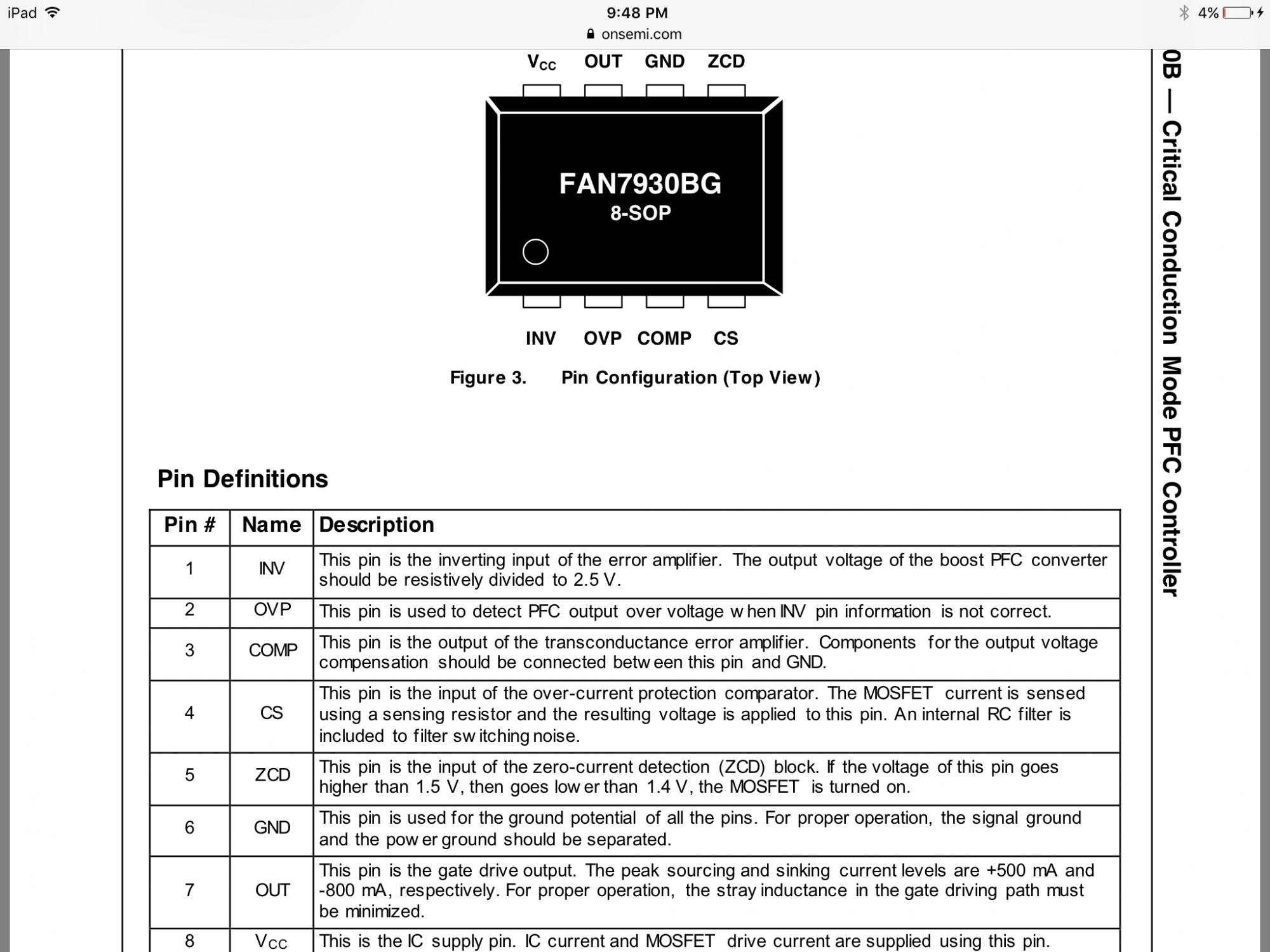

          Here's the ICP801 FAN7930B pin out, what is the testing procedure? The power board is out of stock on jimmy...
            Re: Samsung LN46D630 no picture
            Remove the board so you can test the board by itself but you MUST be careful since you will be working in the HOT DEALY side of the circuit so you should at least power the board from GFCI outlet in case you make body contact with the board, you will use 470 up to 1K 1/4W resistor between the Standby power supply output pin and the PS-ON pin then power up the board and see what Voltage you have on VCC pin and the GND pin.
            BTW: Make sure to put the parts you remove back in correctly before doing the test.
