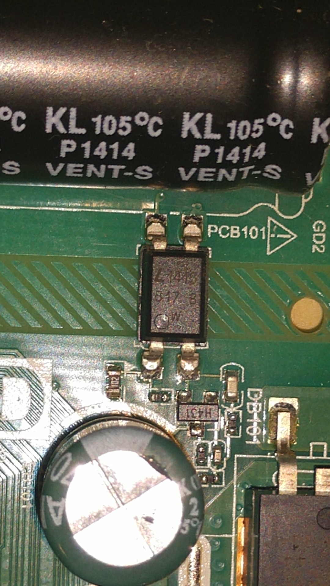

    That 817c is a very common opto

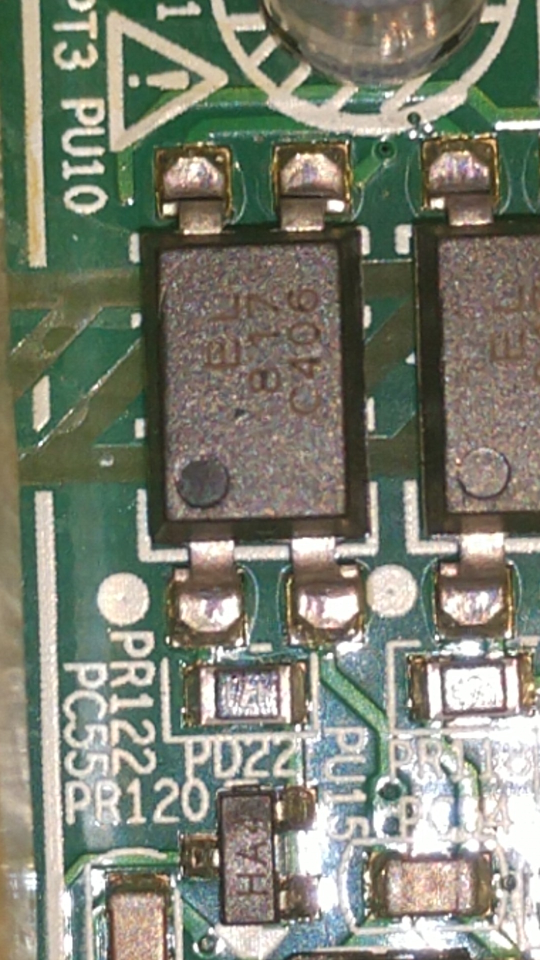

      Re: LG 65UH5500 Dead
      Do you think these might work?
        #63
        You should try shorting the OPTO pins as RJ suggested to find out if you will get the 13V and the 80V or not first

          #64
          It tics twice as fast with pins 3 and 4 shorted.

            #65
            Yes those optos would work, but shorting 3&4 should have told the power supply to turn full on.
                    Heat the opto with a hairdryer see if your voltages come up, go ahead and switch out the opto, if for nothing else to eliminate it from possible suspects.

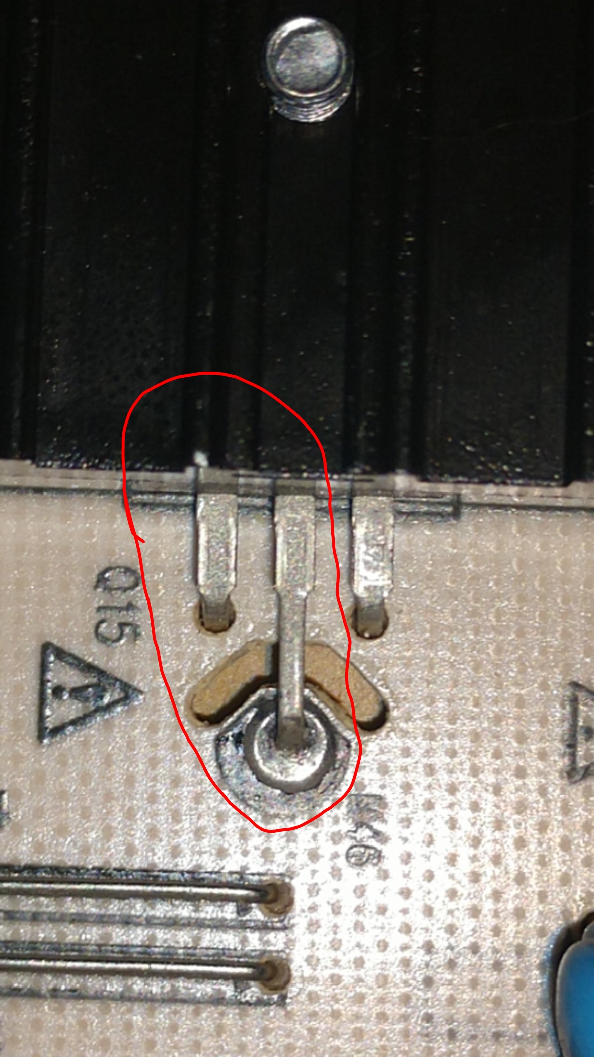

                          #72
                          I haven't changed the opto out yet.
                          Q15 is reading .5 ohms across the pictured legs.
                          I wonder... seems really low.

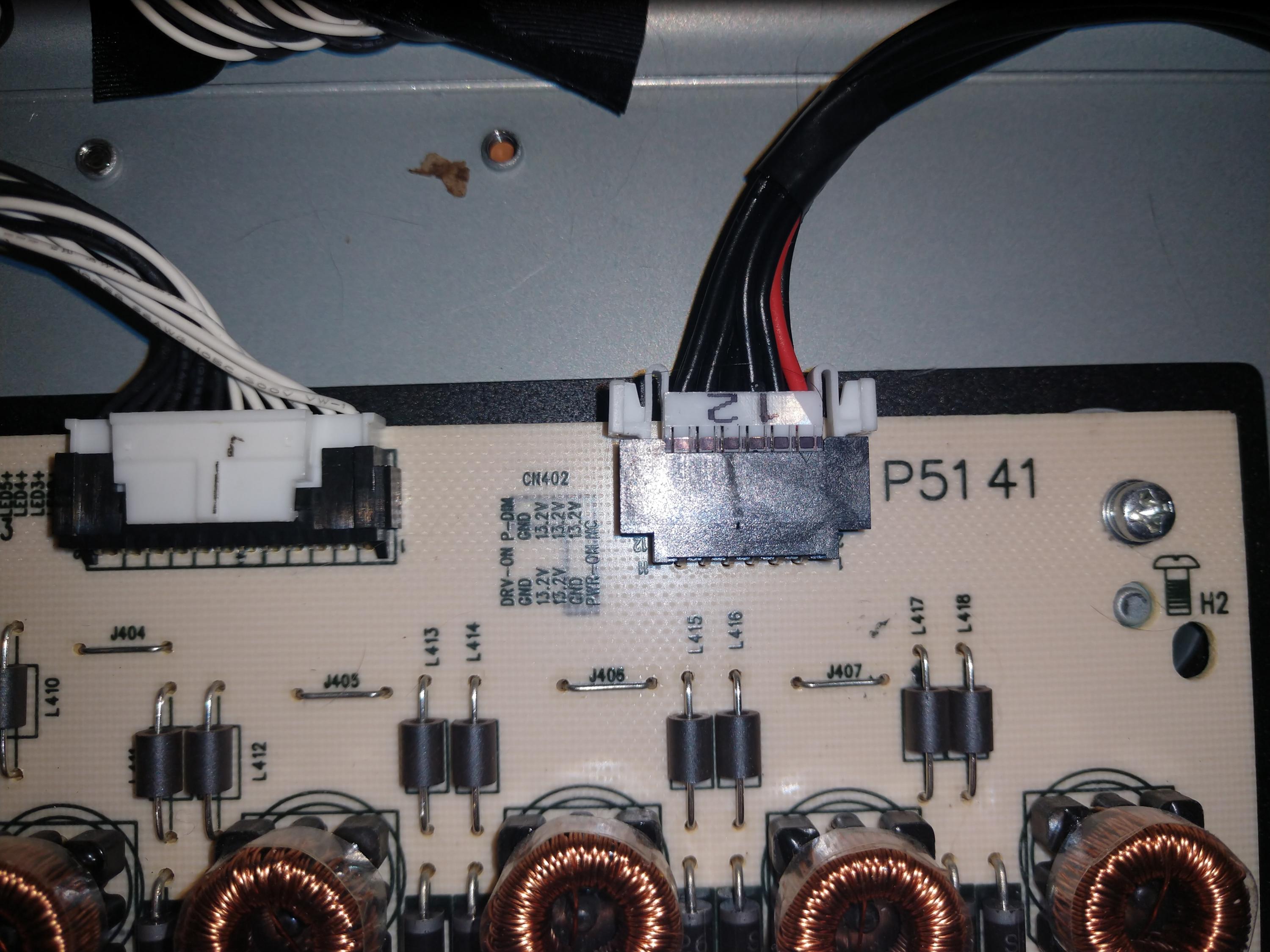

                                #75
                                I replaced the optocoupler. No changes.
                                There's other pins that have no voltage on the middle board (inverter). PWR-ON P-DIM? and DRV-ON.
                                Not sure how to check those.

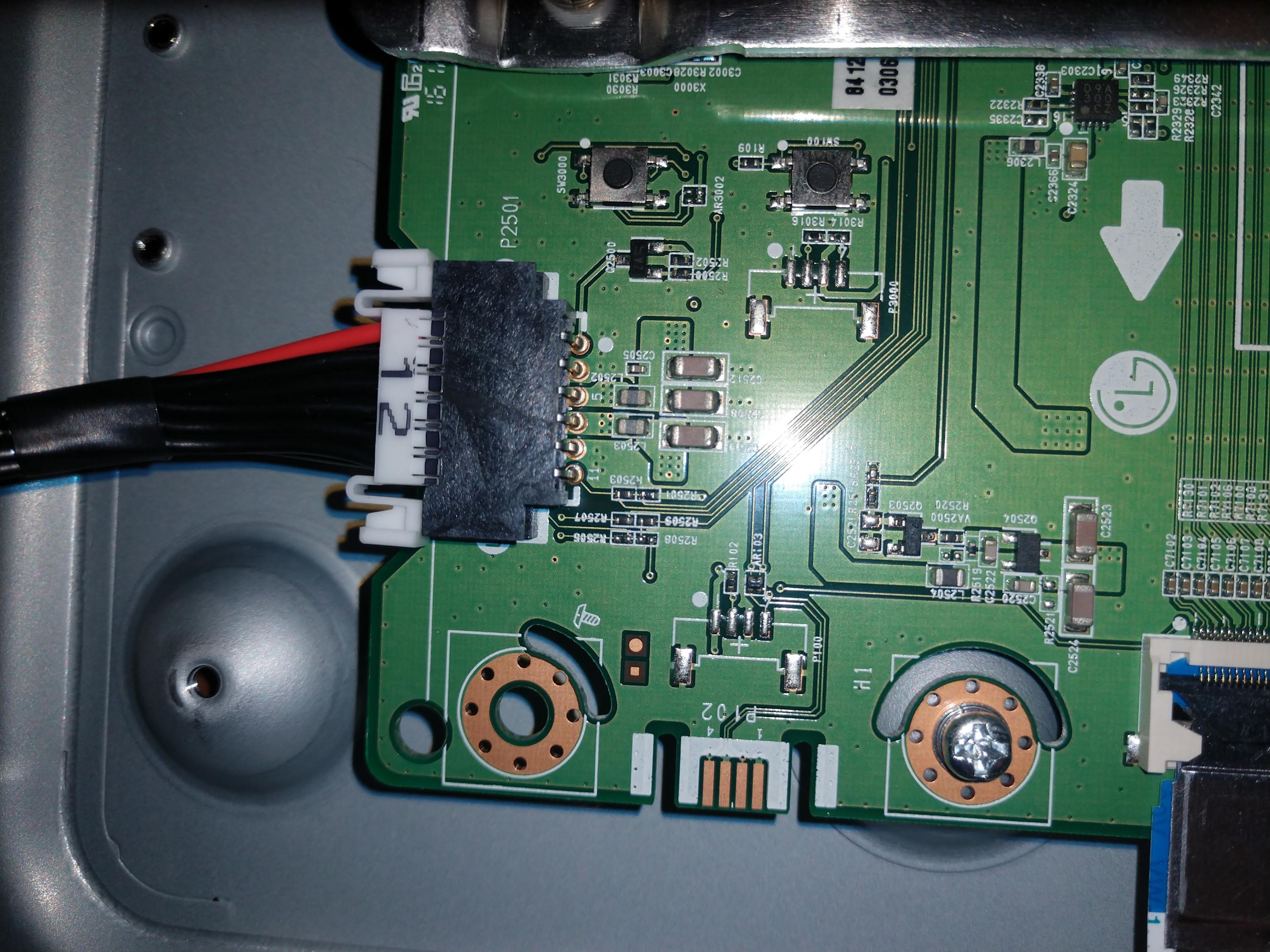

                                  What are those 2 push button switches for?

                                    #77
                                    Looks like this is spinning in circles, I would isolate the powerboard and force it on, see what's missing and fix what's not working. Most repair manuals say check the standby voltage of powerboard if it's not there it needs fixed first.

                                      #78
                                      Wonder if your replacement opto is good, we had a thread a while ago where the new optos from ebay china I believe it was, were doa.
                                        these are for reset / reload same to LG OLED, after replace C10 you have cycles of volts. over this forum i followed trouble shooting with user over the phone and we do find he had cracked MOFST. at HOT Area. so i doubt the C10 was bad.. as you my have now cracked MOFST or Diode under cooling sink or the U1 self. best way take parts out from board and test them
