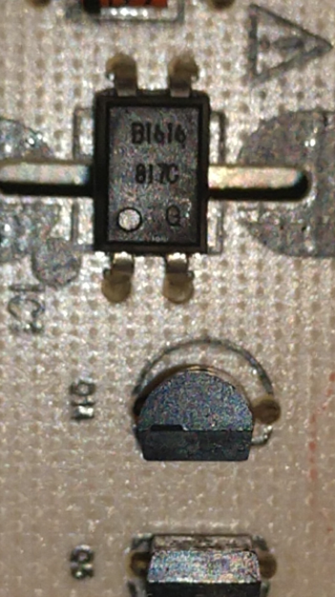

                                  #56
                                  Re: LG 65UH5500 Dead
                                  Originally posted by R_J
                                  Find Q1 and short the collector to ground (C is connected to R57) that should turn on ic1
                                  I did that, and get these voltages now.
                                  IC1 Pin 1 = 8.2v
                                  Pin 2 = 7.5v
                                  Across Pins 1 and 2 = pulses to 1.5v

                                    So with Q1 collector connected to ground, you had 1.5v across the opto pins 1&2 did the power supply give you 13 & 80volts? if not we can confirm that the opto is working by checking the:
                                    Voltage on ZD2 anode=
                                    Voltage on ZD2 cathode=
                                    with 1.7 volts across pins 1 & 2, the voltage on ZD2 should be very close to the same on anode & cathode.
                                    Do you ever get the full 13 & 80 volts like you did before?

                                      #58
                                      Voltage across ZD2 starts out at 3.8 volts, then with each (tic) it drops in voltage until it reaches 2.2 volts and then recycles at 3.8 volts.
                                      Voltage on ZD2 anode= 0 volts (at times it hit .5 volts maybe) strange
                                      Voltage on ZD2 cathode= 2.5 to 3.7 and anywhere in between on the (tics)
                                      80v and 13v are still 45v and 8V
                                      • R_J
                                        • Jun 2012
                                        • 9588
                                        #59
                                        so when you have 1.7 volts across pins 1 & 2 of the optocoupler (led side), the photo transistor side (pins 3 & 4) should be conducting and close to the same voltage on each pin so the same voltage should be on both pins of the ZD2 diode.
                                        You could have a bad optocoupler. Whats the number on it?
                                        You could monitor either 13v or 80v supply line and short pins 3 & 4 of the optocoupler, if the opto is at fault the voltage should come up to or slightly above spec.
