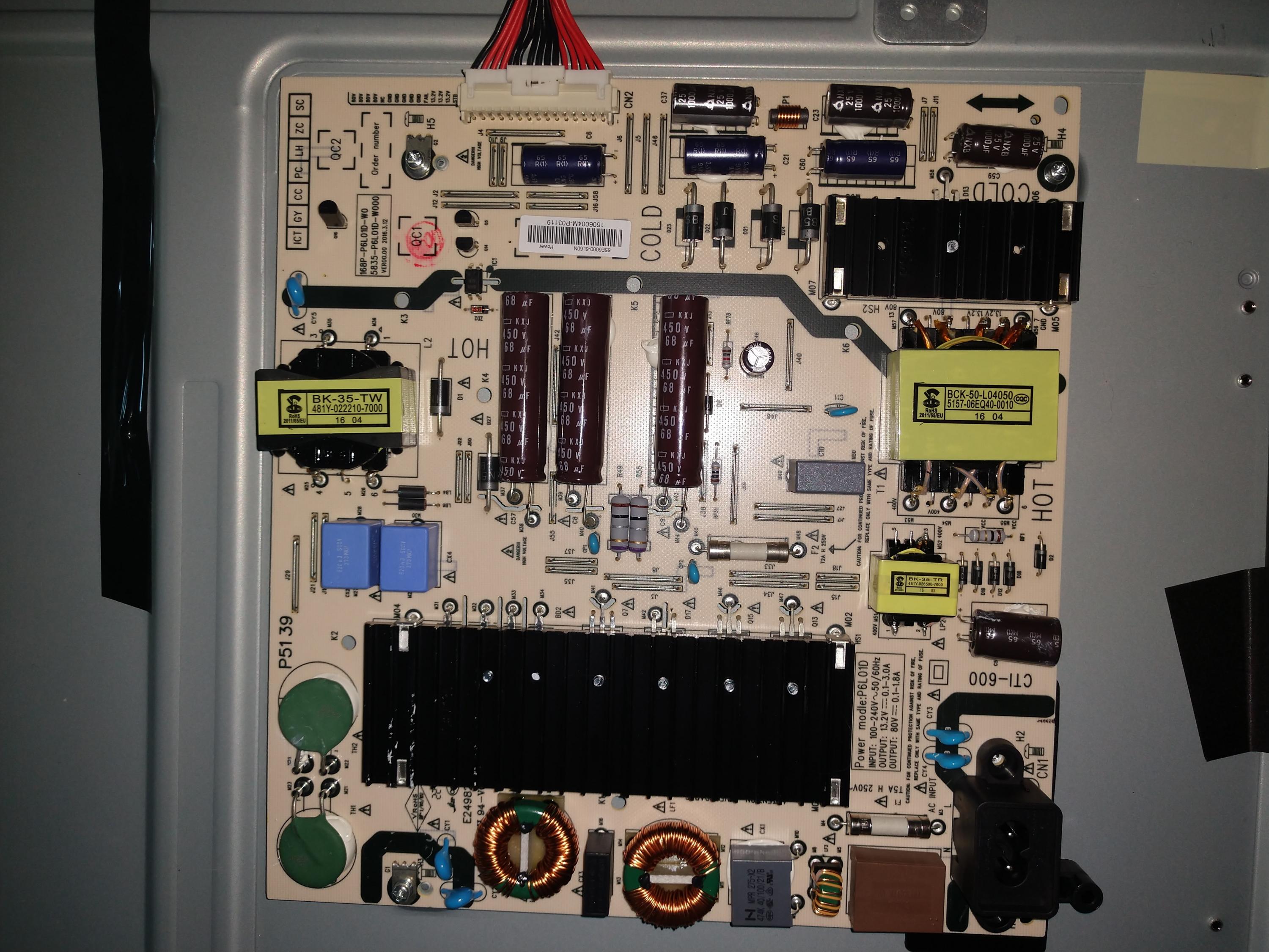

    LG 65UH5500 Dead
    It does does nothing, no power light.
    It was getting all of the 80, 13 voltages, but Zero on the standby pin. I warmed the board with a hair dryer for 30 seconds. Now the 80 volts is 45. The 13 volts is 8. Still no life on standby pin.
    Disconnecting LED board makes no difference in the voltage readings.
    It makes a faint high voltage hissy pulse sound coming from the larger transformers.
    Bridge rectifier shows 160 volts output.
    360 volts on the 3 long capacitors.
    The small yellow LP2 gets 130 degrees F.
    The bridge rectifier heat sink gets 125 degrees F.
    Everything else is room temperature.
    Resistor RF1 reads open, replaced it, no change.
    All diodes and fuses check good.
    Not sure where or what to check next.
  • hbdeals
    • Oct 2014
    • 55
    Re: LG 65UH5500 Dead
    The power board.

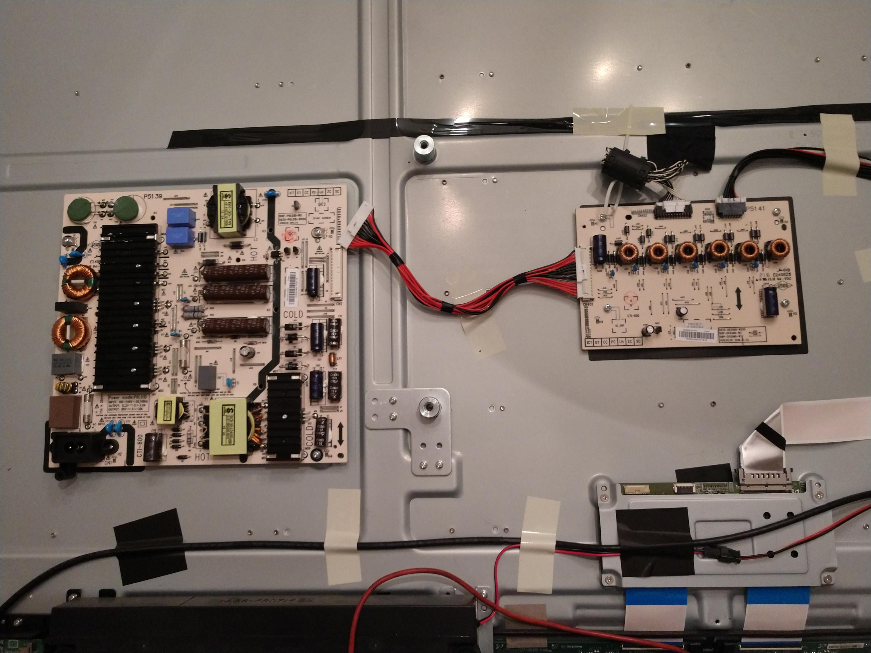

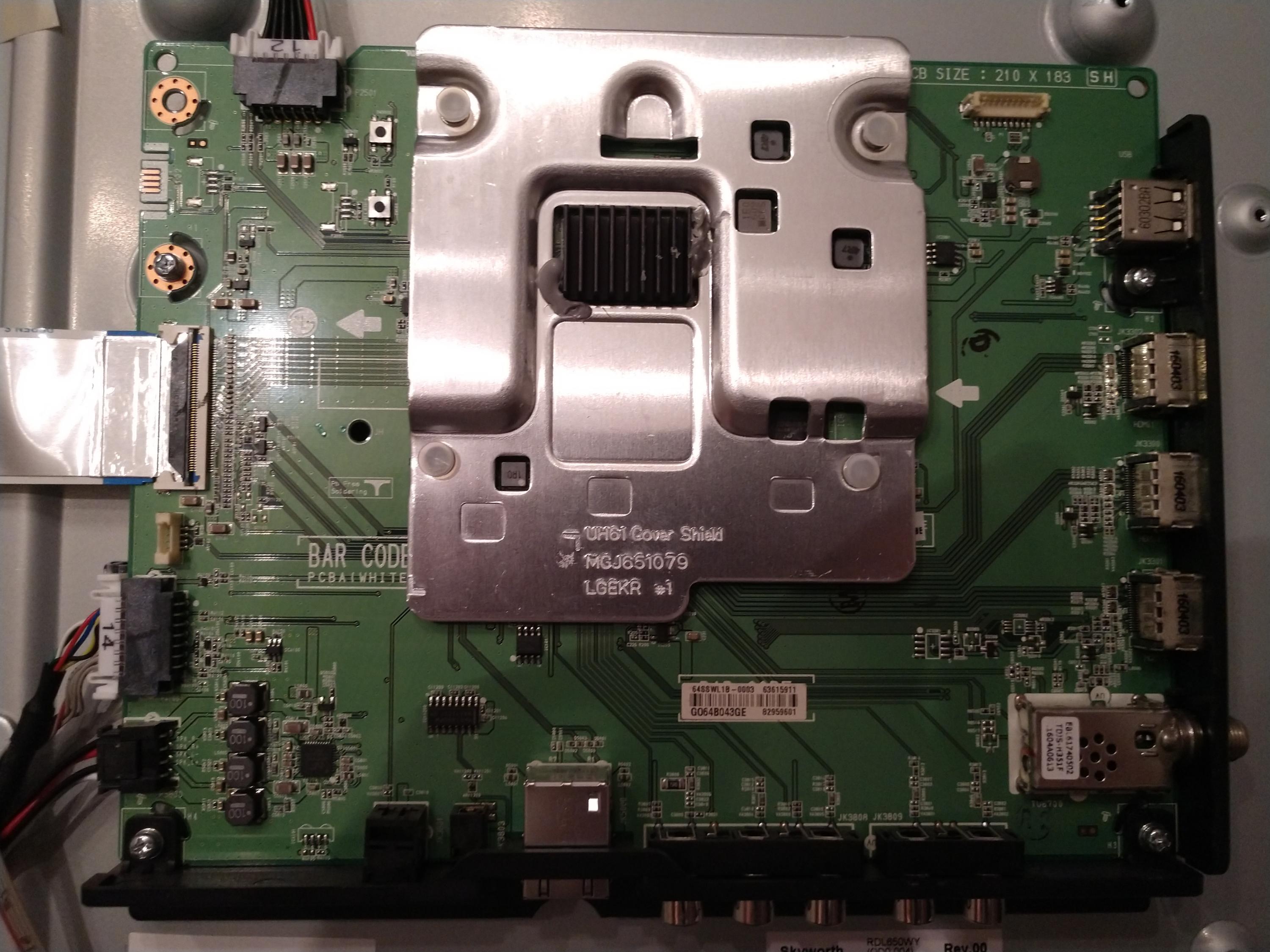

            man, are you posting here to trouble shooting TV or Kitchen Oven ? reading temprature or all what did you wrote on first post had nothing to bring any good known member to join and help.
            1- start with upload complete photos on whole boards to see how they are connected each other, either the edge BL strip and the connector
            2- you have noise at the transformer at hot area... mean you should consider on cold area but you should 100% disconnected main board from PSU and just trace PW ON voltage at PSU side... so you can start repairing
                The oven might be in this boards future indeed.
                It is disconnected.
                I posted a picture of it earlier. It only has one 15 pin connector.

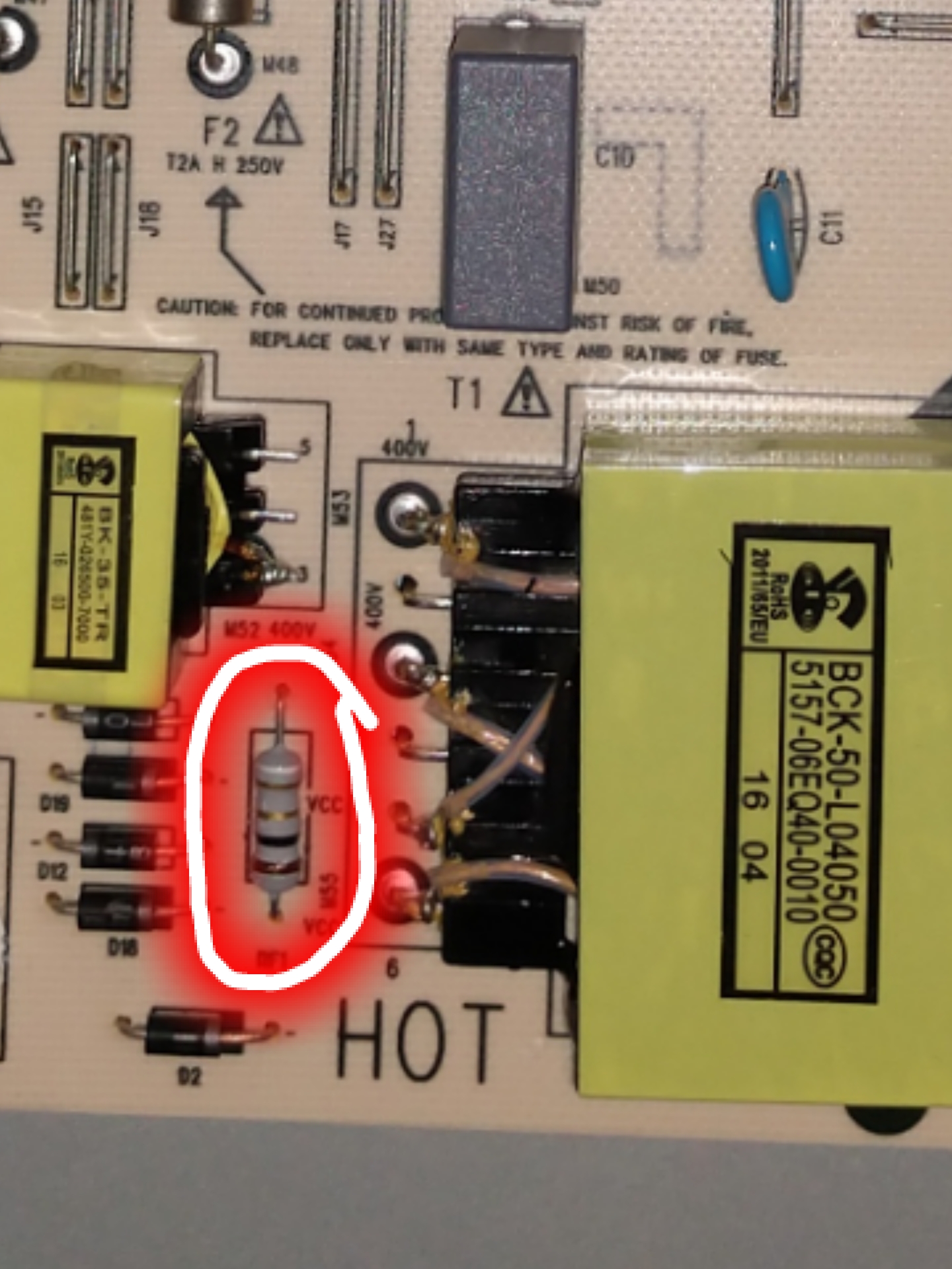

                      "Resistor RF1 reads open, replaced it, no change."
                      Pictures of this RF1? Also provide other pictures as requested by other helpers.

                        The resistor is circled in the picture. That's the one that tested open.

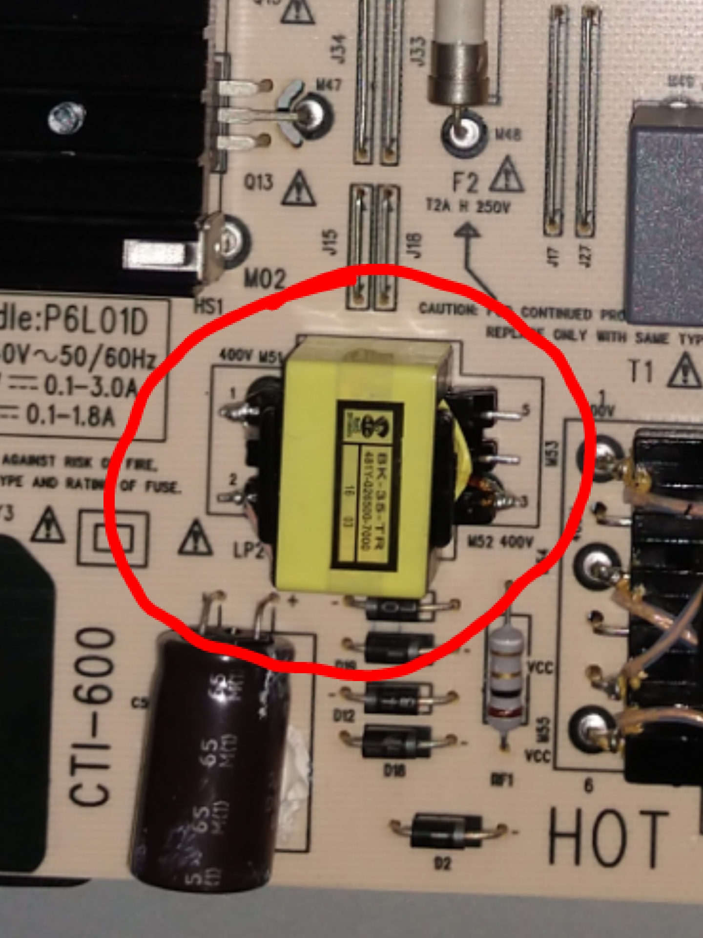

                          The yellow LP2 gets warm. 130 degrees via infrared thermometer.

                            Coils do get warm , did you try turning on the power supply with the battery?

                              I am also surprised that you even getting and DC on the output when RF1 (1 Ohm fusible resistor) is open circuit.

                                RF1 seems to be a fuse resistor for the circuit that has C56 as the filter and could be the vcc for u1 ? it seems to connect to pin 6 . whatever U1 is

                                    That thing is a fuse? Dang well the resistor I replaced it with is a 1 ohm resistor. C56 wasn't charging with the old resistor fuse. It charges up now with a good snap if I short the cap out with a screwdriver.

                                      It can be called a fusable resistor or it could just be a 1Ω flame proof resistor, it is there to protect the power supply if something shorts like the main ic, DON'T short capacitors like that, the high current spark can cause damage elsewhere in the circuit, like the main u1 ic. Always discharge a cap with a proper resistor
