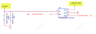

                  On my 5420, plugging the original charger into USBC-1 shuts down the charger. Using USBC-2, it only goes to 5V. I am using the LA-K371P schematic because the LA-K491P schematic is not available easily. SCRIBD has it but there a too many hoops to go through to get it. The LA-K371P schematic is close but not exactly the same.
                  After some poking around I found that the 5V rail is not not working. I disconnected the solder jumper PJP4 and USBC-1 no longer shuts down the charger but still only went to 5V on the input. Measuring resistance on both sides of the open PJP4 showed a short on the output side. I have not isolated where the short is. The next step will be to put an external supply on the 5V path and see what gets hot.​
                  • mon2
                    • Dec 2019
                    • 14476

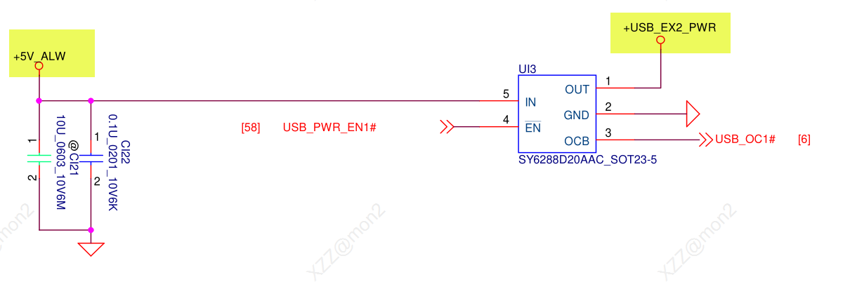

                    Check you PM for details on the true schematic.
                    See below. What is the voltage to ground on this USB load switch?
                    • bk304
                      • Jan 2025
                      • 22
                      I don't want to hijack this thread, but could BTubbs200​ check to see if there is a short in their board between ground and pin 5 of UI3?
                      Thanks for the partial schematic.
                      • mon2
                        • Dec 2019
                        • 14476

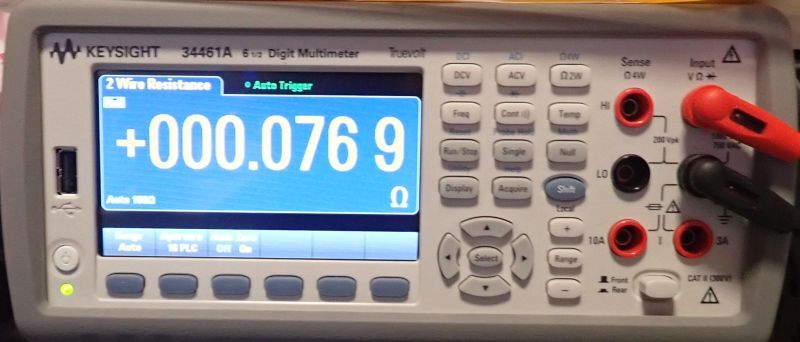

                        What is the exact resistance to ground on pin #5 of UI3 on your board?
                        What about pin #1 of UI3 on your board?
                        • bk304
                          • Jan 2025
                          • 22
                          Between pins 2 (GND) and 5 the resistance is .087 Ohms. Pin 1 shows about 3.5 MOhms to gnd.
                          • mon2
                            • Dec 2019
                            • 14476
                            Is your multimeter auto-ranging or manual type for the scale selection? If manual, can you post a pic of the meter face (scale) being used?
                            • bk304
                              • Jan 2025
                              • 22
                              My meter does both autoranging and manual. I am using a Keysight 34461A and nulling out the probe resistance. I can send a photo of the meter face tomorrow.
                              • bk304
                                • Jan 2025
                                • 22
                                Here is the photo. I don't think it says much becuase anywhere I measure +5_ALW shows similary results. This measurement was done on UI3. I am not sure what to do next. This circuit has so many protections that I can't tell what is shutting down what.
                                • mon2
                                  • Dec 2019
                                  • 14476

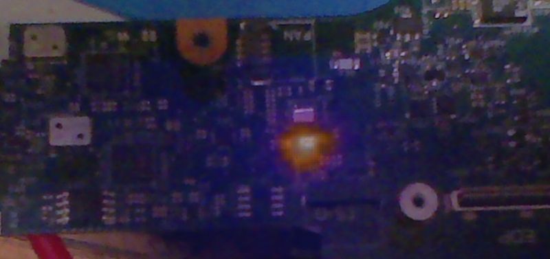

                                  OMG - you truly have a nice measurement tool here. This is a dead short. Would you have an adjustable power supply?
                                  Suggest to dial it up to 1 volt and inject with the highest current your power supply can support onto this shorted line. Be sure you are not injecting onto the ground plane of the pcb but otherwise the shorted part will be smoked out or will crack under pressure.
                                  You can pour IPA (alcohol) onto the part or parts you suspect to be shorted. If the IPA evaporates quickly, that part is shorted. Share details on which part is the guilty one.
                                  • bk304
                                    • Jan 2025
                                    • 22
                                    I should have done this first. I measured the resistance to ground of the 20V bus on the USBC connectors. The 20V buss connection on USBC1 measured about 9 Ohms to ground. The 20V buss connection on USBC2 measured about 229k Ohms to ground. Using a bench supply, I applied 6V to the 20V buss on USBC1 and turned up the current until it reached 6V @ 0.9A. The TPS65994AD USB PD controller chip got blistering hot as shown in the thermal image. I guess that is the problem.
