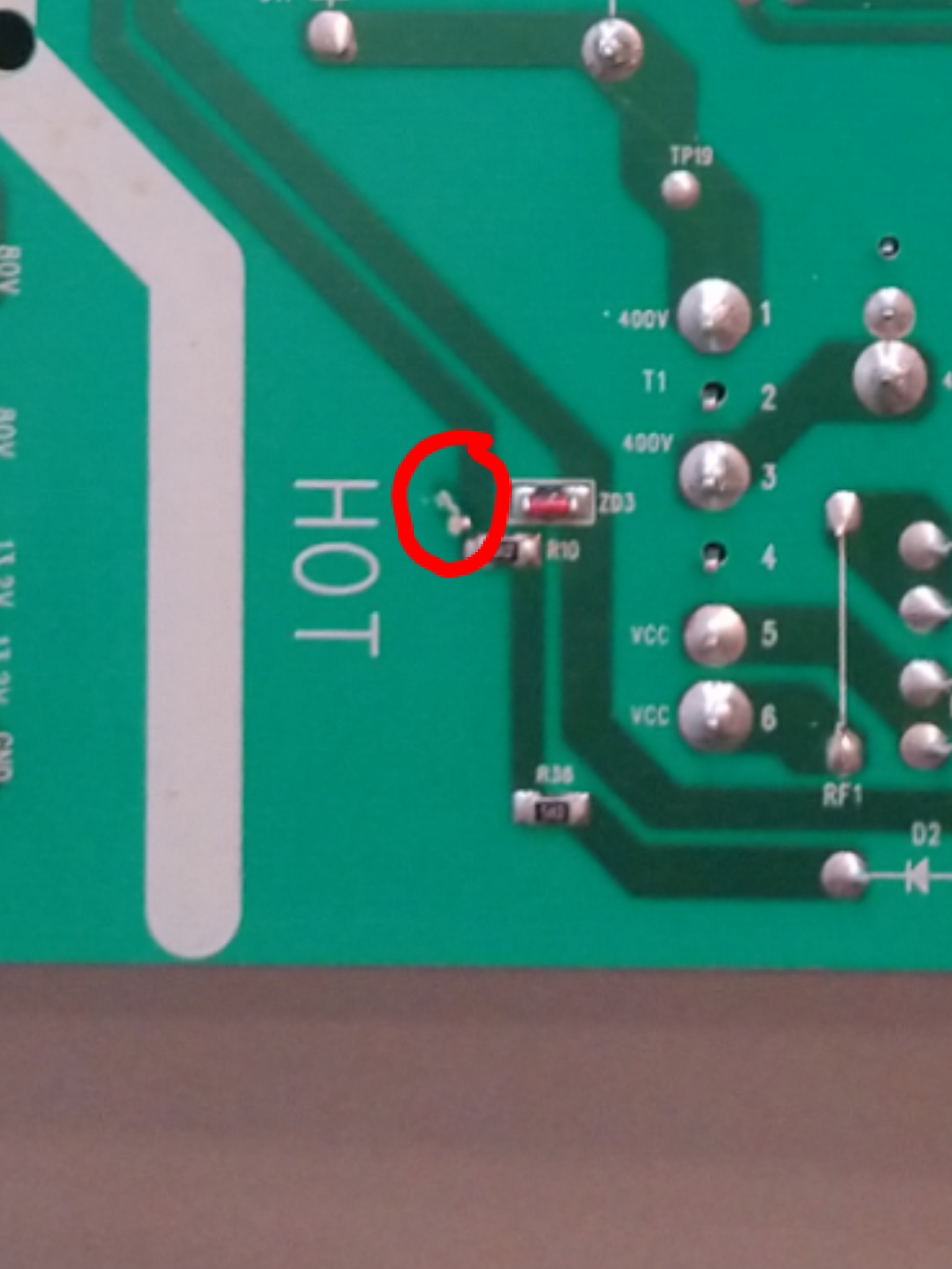

    Re: LG 65UH5500 Dead
    did you take a look on the down side of the power board..?? you need inspect it... it may there toasted components. the over load you have not normal regards yours statements
    • hbdeals
      • Oct 2014
      • 55
      There's one tiny spec, like scratch. Everything else looks good to me.
      I put 3.3 volts to the STB pin. No change in voltages. 45v and 8v.
      Tried 3.7 volts on STB pin. No change either.

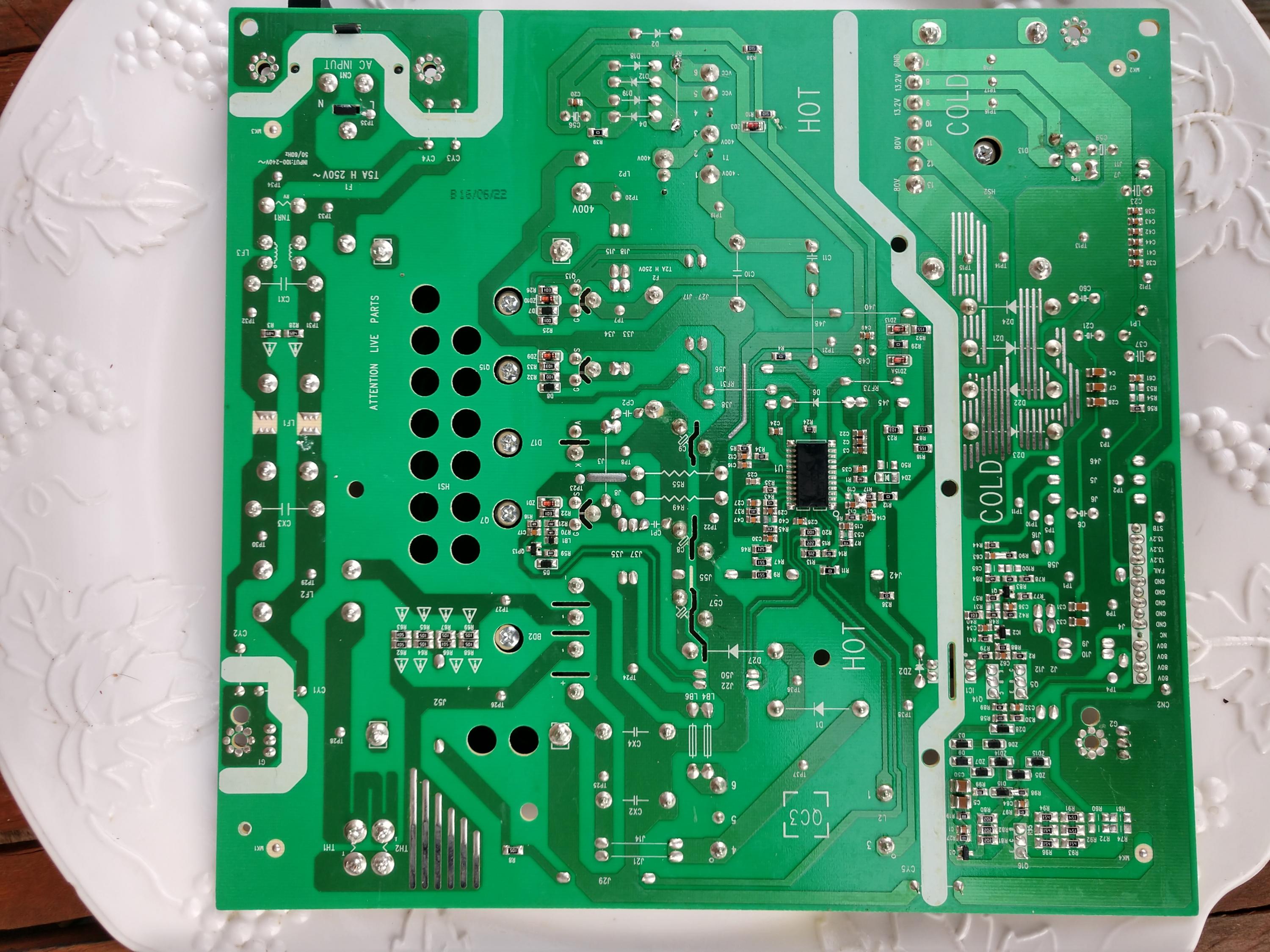

        That last picture was sort of blurry. Better shot.

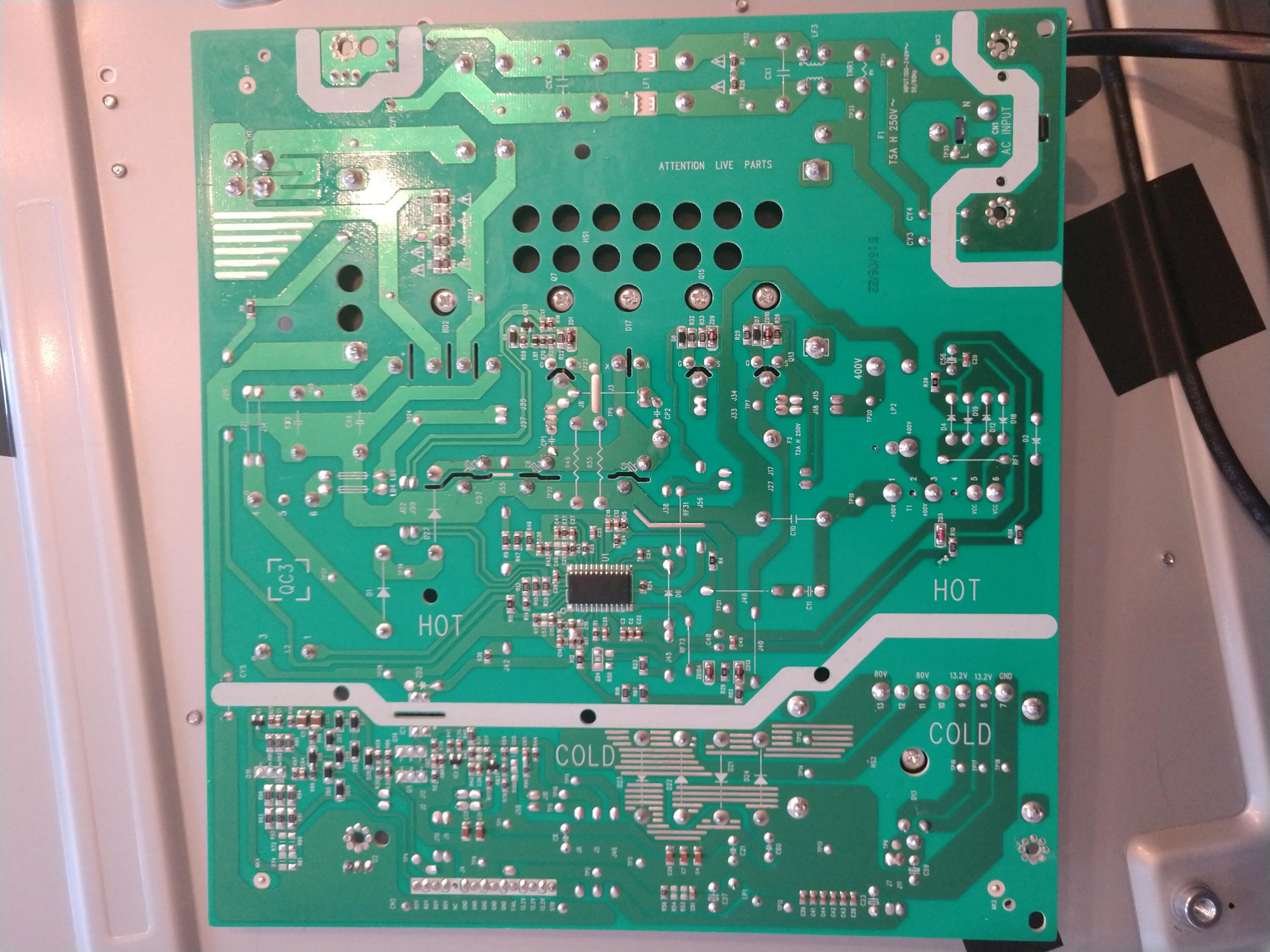

          The thing that puzzles me is that it was getting the full 80 and 13 volts when I first checked it. 80 and 13 voltages dropped to 45 and 8 after slightly warming the board with a hair dryer. I fully expected the voltages to come back up after the board cooled to room temperature.
          A slight temperature change did something.
          STB has been Zero volts from the start and still is.

                                  #36
                                  U1 is the big black chip about in the middle of your board in pic. in post #23.

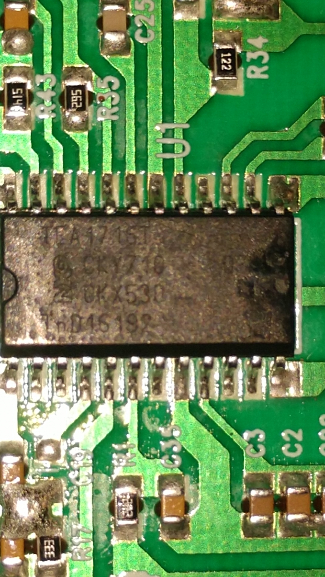

                                    TEA 17 16 T
                                    CKY710
                                    CKX530
                                    D16198?
                                    It's kind of faint and hard to see. lol
                                    https://cdn.badcaps-static.com/pdfs/...f06b063bd3.pdf

                                        • hbdeals
                                          • Oct 2014
                                          • 55
                                          #40
                                          I just tried some freeze spray on U1.
                                          There is no voltage on the 80v and 13 v pins while it's cold.
                                          I watched the meter slowly creep up over a period of 5 minutes as the chip thawed.
                                          The tic sound got louder as the voltage crept back up to 45v.
