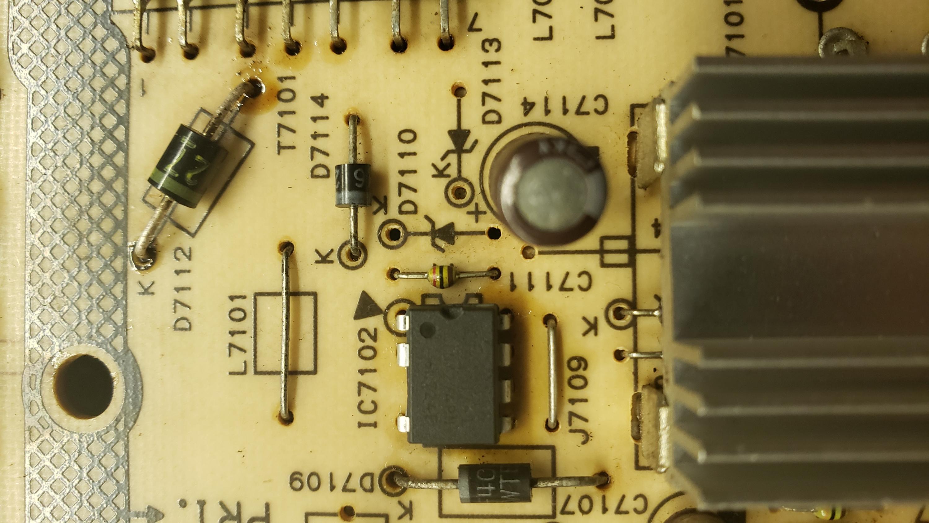

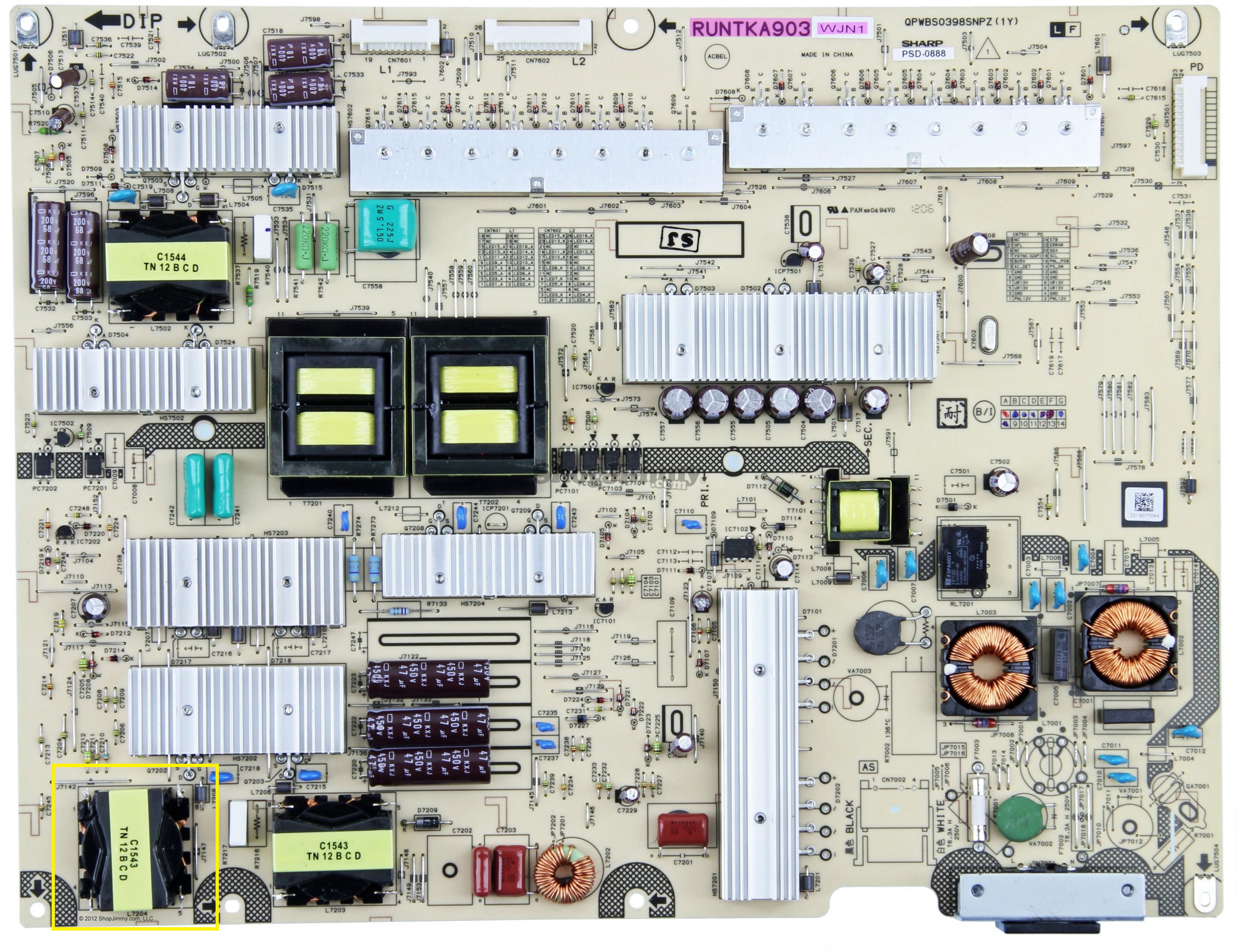

    OK, I will look at the board layout of the standby power supply section and will get back to you with the test points for you to test.

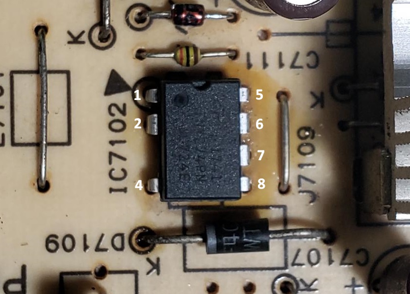

        See attached photo for IC7102 Pinout with measured voltages. Using HOT ground. All DC.
        Pin 1 - 0.56v
        Pin 2 - 5.89V
        Pin 4 - 170V
        Pins 5-8 - 0v. After tracing, it looks like pins 5-8 are on the HOT ground bus.
        Also, the "burn" marks on this board is flux from where I installed the new IC. No obvious burns or anything anywhere.

          After reading the PDF for the TNY274 attached earlier in this thread, I may have a direction to chase. Pin 1 of the IC controls the oscillation of the chip. Pin 1 signal is fed from the optocoupler, and the optocoupler is referencing the secondary voltage. If the secondary voltage goes high, the optocoupler begins to close the emitter and collector side of the OC, forcing the voltage of pin 1 to drop, thus controlling the secondary voltage. According to the IC PDF, Pin1 (EN/UV) switches the IC off when voltage drops below 1v. No IC on equals no oscillation which would thus keep the transformer from working.
          Looking at my diagram above, pin 1 is at 0.56v. This tells me that I might possibly have an issue with that optocoupler. One possible way to test it is to uncouple the OC from the circuit on the Collector/Emitter side and see if it powers up. Any harm in that? I will continue to dig into this tonight once I get off work.

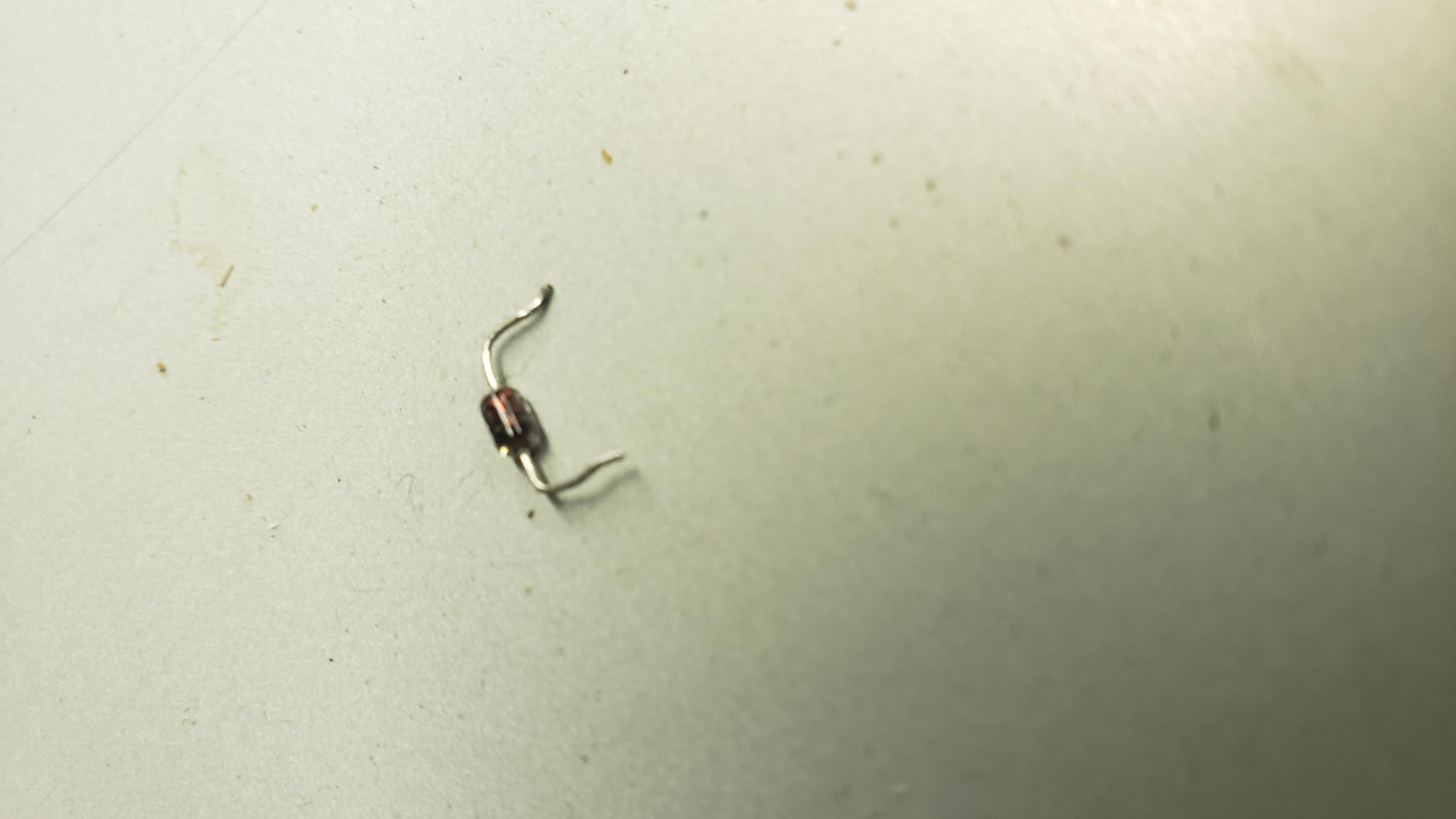

            Update! As mentioned, I began probing around IC7102 Pin 1. First I unsoldered pin 1 from PC7103 and had no affect on the voltage. Next, I unsoldered diode D7110 and viola! Pin 1 came up to 1 volt! 5v bus on and TV powers up! So it appears D7110 is bad. It appears to be a zener. Any ideas on the spec for it?
            Diode is marked either B62, 2B6, or 62B. Hard to say as the numbers go all the way around.

              That Zener diode on pin 1 (EN) is for protection to clamp down the Voltage to protect that input pin, as you can see in the application circuit, they do not even install the Zener on that pin.
              Since EN typ Voltage is about 2V per spec, you can use 6.2V or 5.1V Zener.
              BTW, did you check the resistance in both direction of that Zener?

                I did check resistance. It shows resistance both ways (170 ohm forward, 350 ohm reverse) which makes me think its bad?

                  It is bad, that is why EN pin is only getting 0.56V, it should be around 2V on EN pin to enable the TNY to run.
                  I am glad you found the cause of the problem on your own.
                  When TNY blows up, it will usually take the opto and zener (if it is implemented) with it.

                    On a similar power supply using a TNY274PN, pin 1 has a MTZJ8.2B zener
