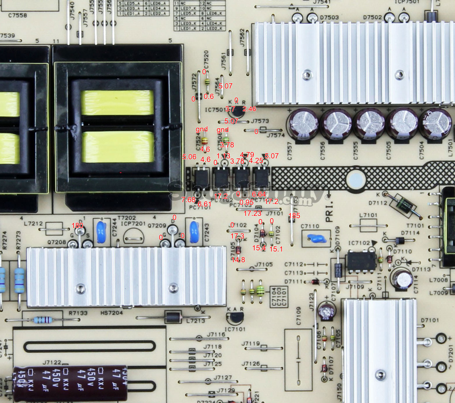

          I just had a closer look at this picture, I suspect the PSON opto is working, A quick way to tell for sure is check J7105 jumper, it should switch between 0 and 15 volts depending on the state of PSON
          Based on the voltage on D7105, I believe that is the vcc that supplies ic7203
          It could be that the power supply is working, check if you have UR13v

                            From your picture the 17 volts (which is produced by the standby circuit) IS getting to the optocoupler and IS getting to the Q7101. this transistor, switches the 17 volts which gets zenered to 15volts that supplies the vcc to ic7203 (main drive ic) and I believe it also supplies vcc for ic7201 (pfc ic)
                            Can you supply the number for ic7203?
                            Just a note on panel power, don't worry about that now, it takes ur13 volts and via a 12 volt 4 pin regulator (which has on/off control) supplies the panel 12 volts

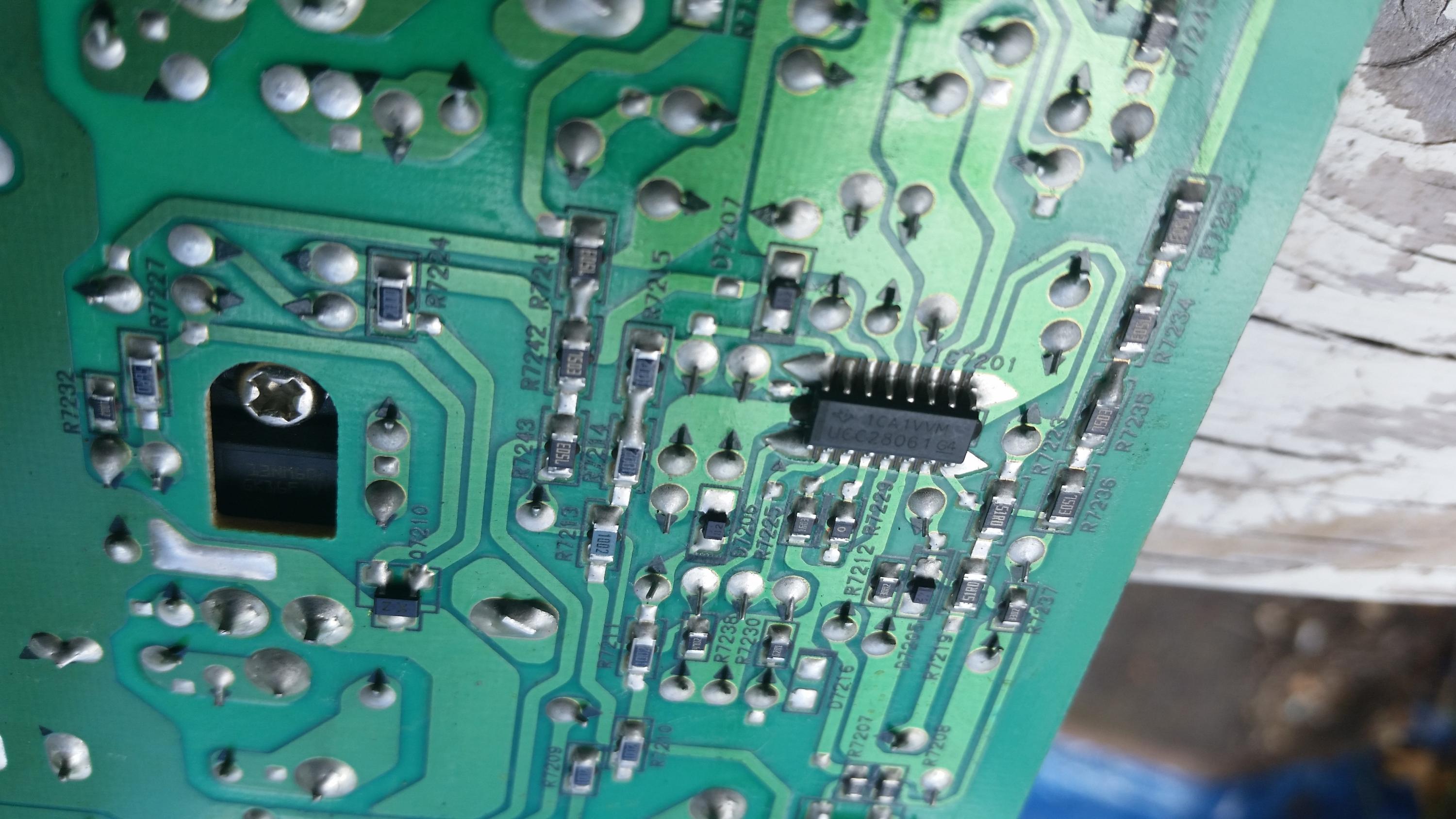

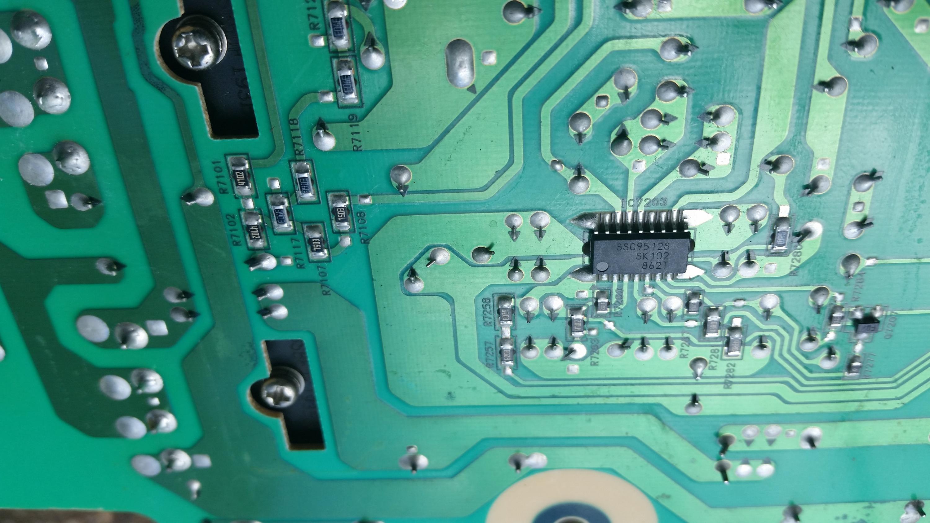

                                  sorry for the delay. as usual life gets in the way! but here are the IC's
                                  IC7203
                                  SSC9512S
                                  SK102
                                  862T
                                  Don't fear the repair...

                                    IC7201: UCC28061 PFC IC
                                    https://cdn.badcaps-static.com/pdfs/...fc433d57cd.pdf

                                          so the datasheet i posted for IC7203 doesnt really help me. because in the datasheet where it shows what pins are what, it is talking about the 16pin package. (SSC9512) then it says SSC9512S(SOP-18) is different
                                          pin number.
                                          SSC9512S is the IC i have on this board, and it has 18 pins....how can they just say "is different pin number" but not have another diagram showing the pinout? i looked around and this is the only datasheet i can find. how do i proceed?
