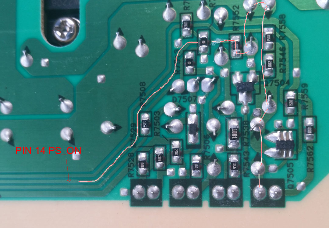

      great we're on page 3 now.
      thank you RJ. that makes sense why i would be getting 0v there then. and makes my mind just a little more clear...possibly can understand what the datasheet is saying now about this IC. which is fine anyway so moving on...
      my question is about where the PSON signal is going, and where it is not going, what it is not getting to, what is not getting the message to turn on!
      specifically i dont understand why the side of the octocoupler i traced it to is the side with the phototransistor and not the side with the LED as i was expecting to find.

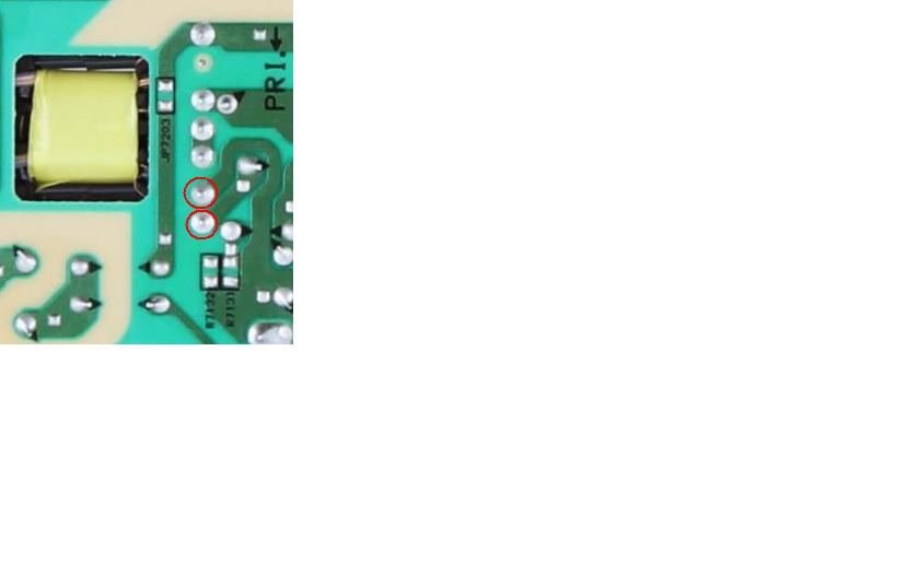

        I think you traced the AC_DET line and not the PS_ON line, that would explain why the opto's output connects to that pin.
        I had one of these one time and I had poor connections on the standby transformer, so it might be an idea to resolder it.
        On the one I repaired, the standby 5 volts was there but it was more of a phantom voltage, it had no current, as soon as it was loaded down it would drop to almost nothing.
        when I measured the resistance of the feedback winding it checked open, I removed the transformer and rechecked it and it was ok, I reinstalled it and it worked fine.
        I marked the feedback winding in red

          Re: SHARP LC-80LE633U has open resistor r7133 on PSU
          i triple checked my tracings. did you see the image i posted with the trace in red? also i can trace the voltage along the capacitors and jumper wires all the way to where it is present on the pin of the octocoupler which if i read the datasheet right, is pin 3 which is the emitter. (again makes no sense to me)
          this voltage is not present if i disconnect 5v from pson, so it must be coming from there.

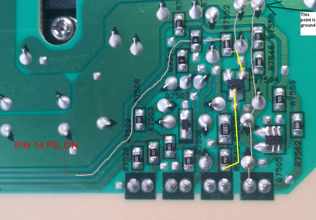

            Your tracing is wrong, before you get to the opto your trace is connected to ground, R7552 connects to the base of Q7504, the collector goes to the opto PC7102
            Make sure your 5 volt standby stays up when you try to turn on the tv.
              im not seeing what you're talking about. can you give more details? i trace pin 14 PSON to the SMD resistor labeled 1002 which measures 10k as it should. from there it goes thru C7520 then thru J7572 and thru C7524 to pin 3 of the optocoupler. also i see this voltage with my meter the whole way there. how can i be wrong?
              where is ground in this area?
                ok thank you for your edit. i see now that it would go to ground there. and learned again another thing to look for to help understand where things are going. i still dont understand why i see that same voltage on that pin tho. i better do some more poking around.

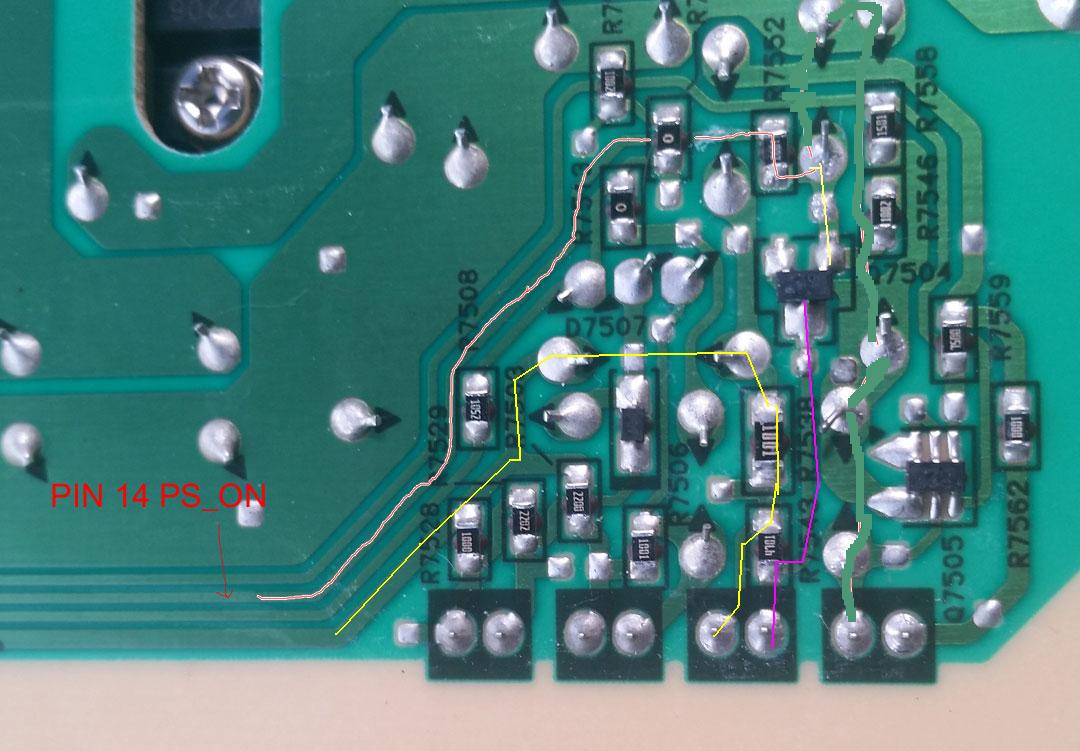

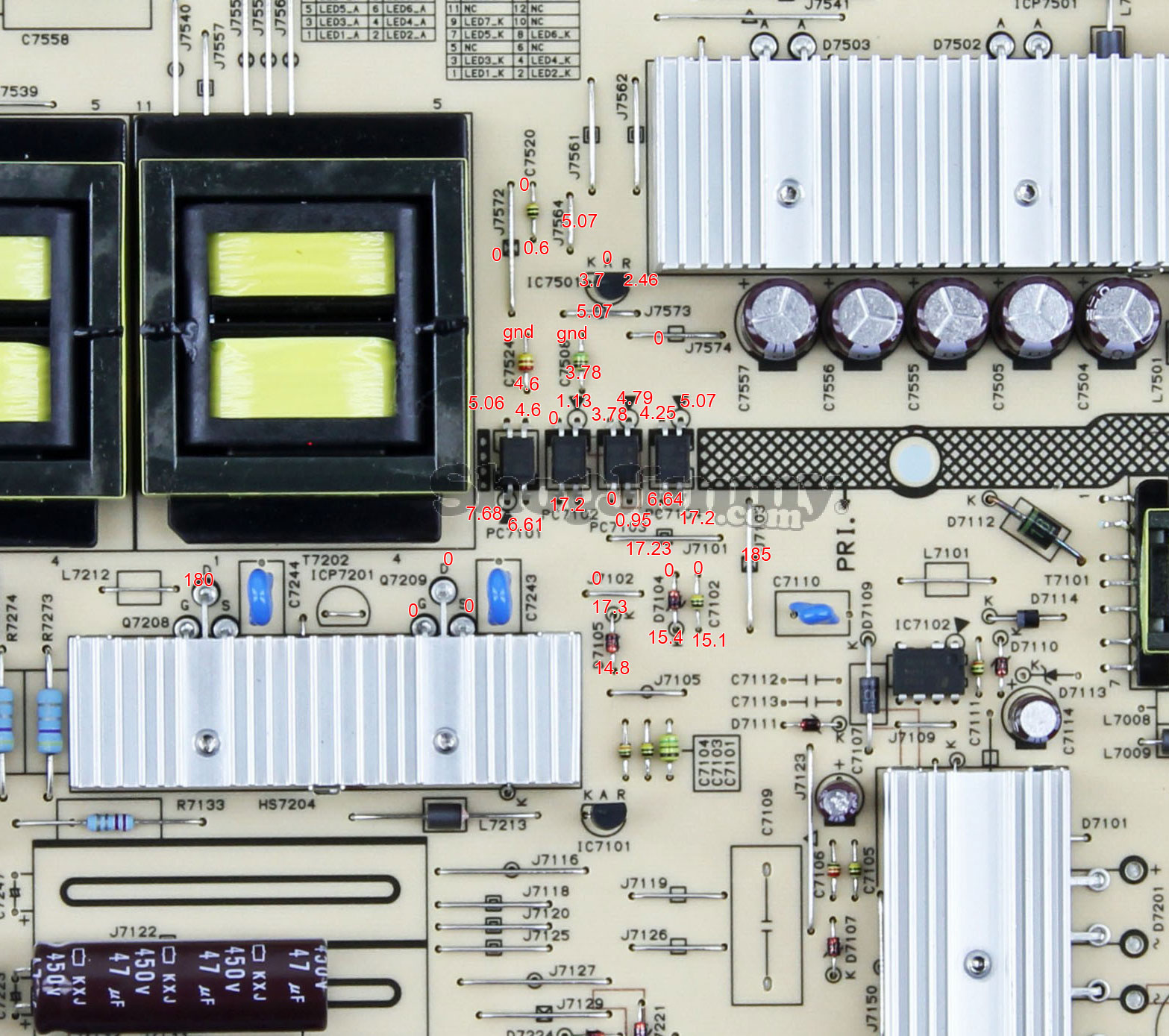

                    i thought i was tracing the voltage going from pin 14 to pin 3 of the octocoupler all the way to the left. but i was wrong about that. thanks for your help in seeing that. so disregard that.
                    so now i see that the true path from the PSON is to pin 2 of octocoupler PC7102
                    which is the cathode of the internal LED and i am reading 0v to that pin. also 1.13v on the anode would not be enough to light a LED, right?
                    im still confused though...why does PSON go to the cathode of the LED? if its purpose is to light that LED, shouldnt it go to the anode? and where am i getting that 1.13v from? and what is Q7504 and how do i test it? maybe thats bad and why im not getting any voltage to pin 2 of the octocoupler?
                    see picture for voltages in the area

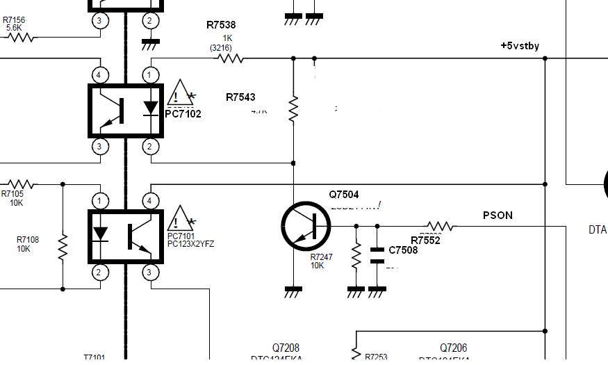

                      I think pin 1 of pc7102 should be connected to 5 volts standby via R7538 1k (1001) and Q7504 collector connects to pin 2, the base of Q7504 gets switched by the PSON voltage and Q7504 emitter is ground.
                      I see 5 volts on J7573 so re check the voltage on R7538 and pin 1 of the opto
                        ok i just checked again and those voltages in the picture are correct. i get 5v on that jumper J7573 , and it only goes thru that 1k resistor R7538 (which checks out fine at 1k btw) and then it ends up being only 1v when it hits pin1 of the octocoupler PC7102?? who stole my 4 volts??? also, tracing pin1 back to the line that you did, and following it, it does indeed go to the 5vsb pin.
                        i am sort of getting the picture of what is going on here... the base should get the signal from PSON and then switch on the path between collector and emitter, allowing the voltage coming in on the anode to pass through the cathode, and through Q7504 emitter to ground?
                        how do i look at Q7504 and know which is base, collector and emitter? and what should i call it? a NPN transistor? or is it a PNP transistor?
                        do i think like this? :
                        knowing thats a LED in the optocoupler, and the cathode needs a path to ground to work, i should assume the transistor handles (collects) that, and then seeing which pin of it goes to ground, tells me the identity of the base pin?

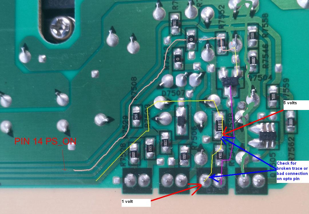

                            What is between pin #1 of the optocoupler 7102 and the resistor R7538? it's a piece of copper. Did you ever remove that optocouler? are you getting the pins for the opto confused and checking pin 2 instead?
                              DAVI.P thank you for your input but i have moved on from checking that area because i have steady 5vsb all the time now. after i resoldered the IC a second time, i have had no problems there.
                              whats the best way to read voltages on the underside of the board?
                              soldering test wires is a pain.
                              can i safely run the board upside down, on a piece of cardboard, without any screws connecting it to a chassis?
                              <edit> i went ahead and used a piece of cardboard, turned the board upside down and used a wire to connect a cold ground to chassis. seems to work fine.
                              so what i found out:
                              im getting 4.6v coming in from the PSON line, but it gets cut to .6v by the 1002 resistor right before it hits (the base of the transistor?)
                              and im getting 5V coming from the 5VSB line but it gets cut to 1.1v by the 1001 resistor right before it reaches the optocoupler.
                              im not mixing up the pins.
                              so in your picture where you show i should have 5v after the resistor, thats not what is happening.
                              i checked with ohm meter and found only 7ohm resistance between the opto side of the resistor and the optocoupler pin so there is no broken trace or bad connection. but it wouldnt matter anyway because im already at 1.1 volts there. also there is low ohm resistance before the resistor. i have 5v on one side of the resistor and 1.1v on the other. what is the minimum volts the LED in the optocoupler should need to activate the phototransistor on the other side?
                              and no i never removed the optocoupler.
                              really not seeing what is happening here. how can a 1k resistor that checks out fine at 1k rob me of 3.9 volts? the 1k resistor i use to take 5vsb to the PSON only drops half a volt. stumped! ....for now?
                                    That circuit that turns on the opto should look like this.
                                    Now I want you to trace the pins of the optocoupler back to the nearest components on your picture
                                    There should be 0 zero ohms, nada, zip. That should be a copper trace.
                                    Also you can work on the board outside the tv, on the bench, you need a couple 1k resistors, you connect one 1k from 5 volt standby to PSON, that turns on most of the power supply, To turn on the PNL12v (panel power) you need another ik between 5volt standby and PNL_POW
