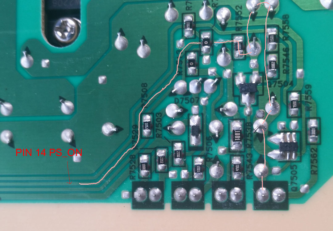

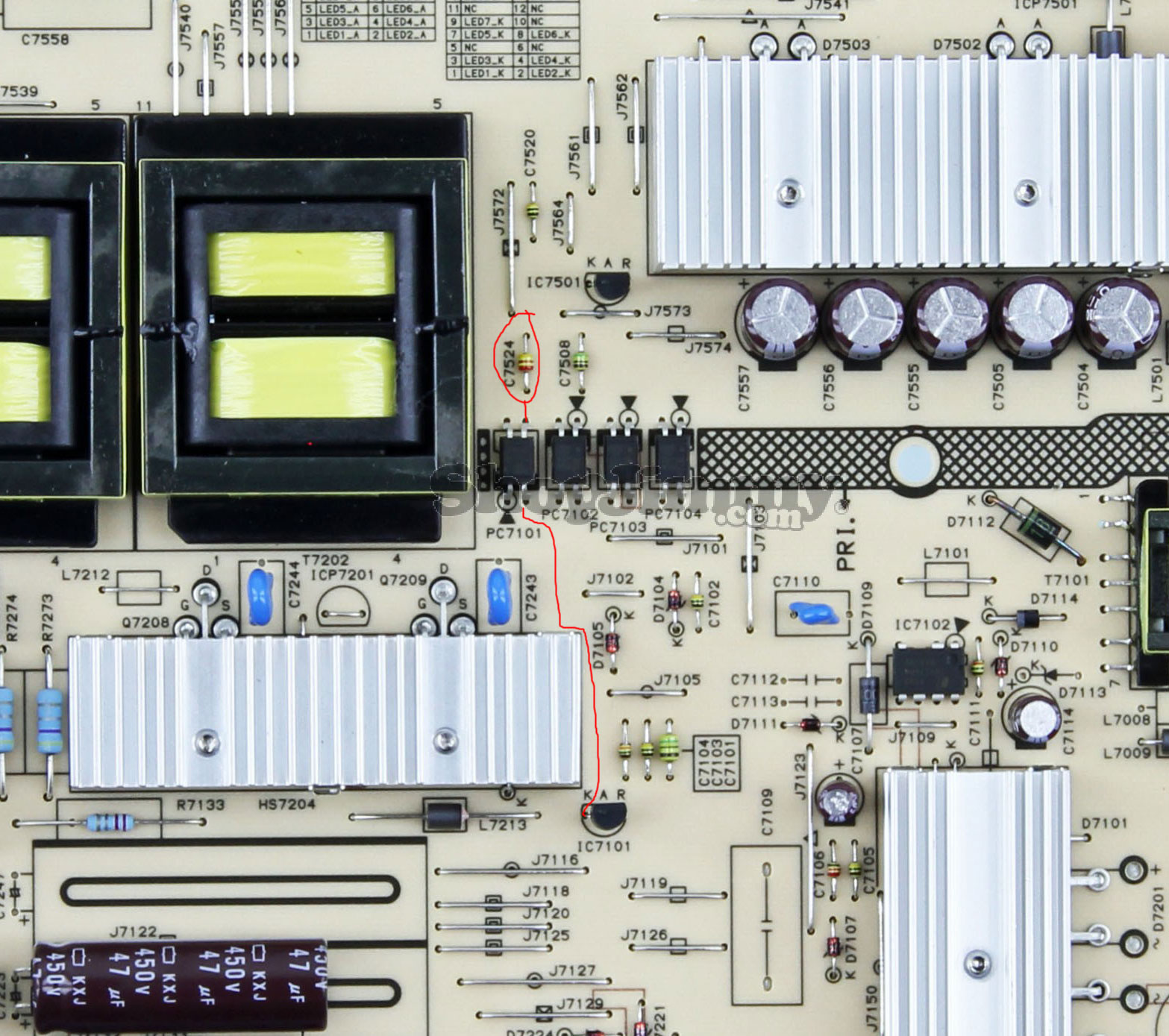

                            so i traced the PSON pin to where it goes...but im totally lost. dont even know what to call the things i see here.
                            the 4.6v i get from the PSON pin (due to 1k resistor between 5v and PSON, i dont get the full 5v...but this should be enough, right?)
                            goes thru C7520 and C7524 and into the top right leg of PC7101 which bridges the gap between the hot and cold sides of the PSU.
                            markings on it say:
                            R
                            2581A
                            WK 1.35
                            i have no idea what this part is or what it is supposed to do.
                            any explanation will be greatly appreciated.
                            out of the bottom right leg, i get 6.4 volts somehow (switching to negative leg of filter cap for ground ref)
                            which goes to the left leg of IC7101
                            which is another part im not too sure what it is or how it works. it says K A R above it.
                            markings say:
                            KIA
                            431A
                            145
                            it has 3 pins. i get 6.4 on the left, 0 in the middle, and 2.5 on the right.
                            after that, i kind of lost hope because there are just too many unknowns and i need help to understand which way current is going and what its actually doing.
                            what is supposed to happen to the ~5v PSON signal? i know its supposed to go back and tell the Hot side to crank up the juice in some way or another....
                            feeling a little sad cause i thought i was so close and now ive gone back a step
                            help! please

                              2 seconds on google and you would find 2581a = PS2581a photocoupler, It is used to isolate a signal from the the cold side to the hot side, Turning the led on or off on the cold side, causes the photo transistor on the hot side to conduct or not (switch on or off in this case)
                              On the hot side, kia431a is a reference ic, basically used in the power supply as a reference for regulation.
                              There is a fuse near that section you should check, it is labeled icp7201

                                but reading the datasheet for PS2581AL1 , i seem to see that the LED is the bottom pins 1 and 2, and the transistor is the top pins 3 and 4.
                                out of the 4 optocouplers there, 3 of them are oriented one way which would seem to me to be a LED flashing on the cold side, telling a switch on the hot side to open and close. but the one of them that i was actually looking at is oriented the other way, seemingly a LED flashing on the hot side, telling a switch on the cold side to open and close. this is backwards from what i was thinking, if i was thinking that a signal from the PSON pin should go to the hot side and ask for more power... what am i missing here?
                                any chance of a schematic for this PSU existing?

                                          Re: SHARP LC-80LE633U has open resistor r7133 on PSU
                                          the TVS or Snubber diode labeled T3D1D at location D7112. davi.p insists i must replace it. budm said i can test it with a LED tester.
                                          so if i have 5vsb, then this IC7102 and the area around it should be fine?
                                          it doesnt do anything but provide that 5vsb?
                                          why are all 4 of the source pins showing 0v?
                                          i looked at the datasheet for a long time but it still isnt clear to me which way current is flowing, where its going, what its doing... it seems to say current can both come out of and flow into pin 2 which really confuses me...did i read that wrong?
                                          and also when i trace the PS_ON 4.6v to the optocoupler, its not even going to the LED side of the optocoupler. everythings backwards and upside down in my mind right now
