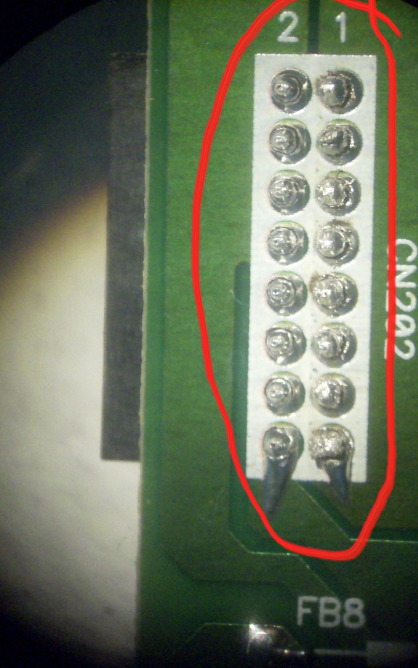

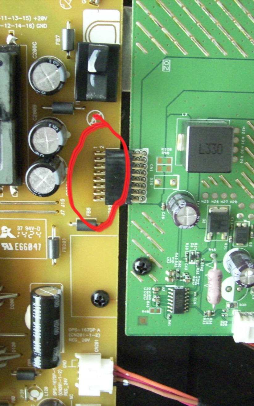

        You are in luck! All you need to fix your set is:
        1. Leaded solder
        2. Solder sucker

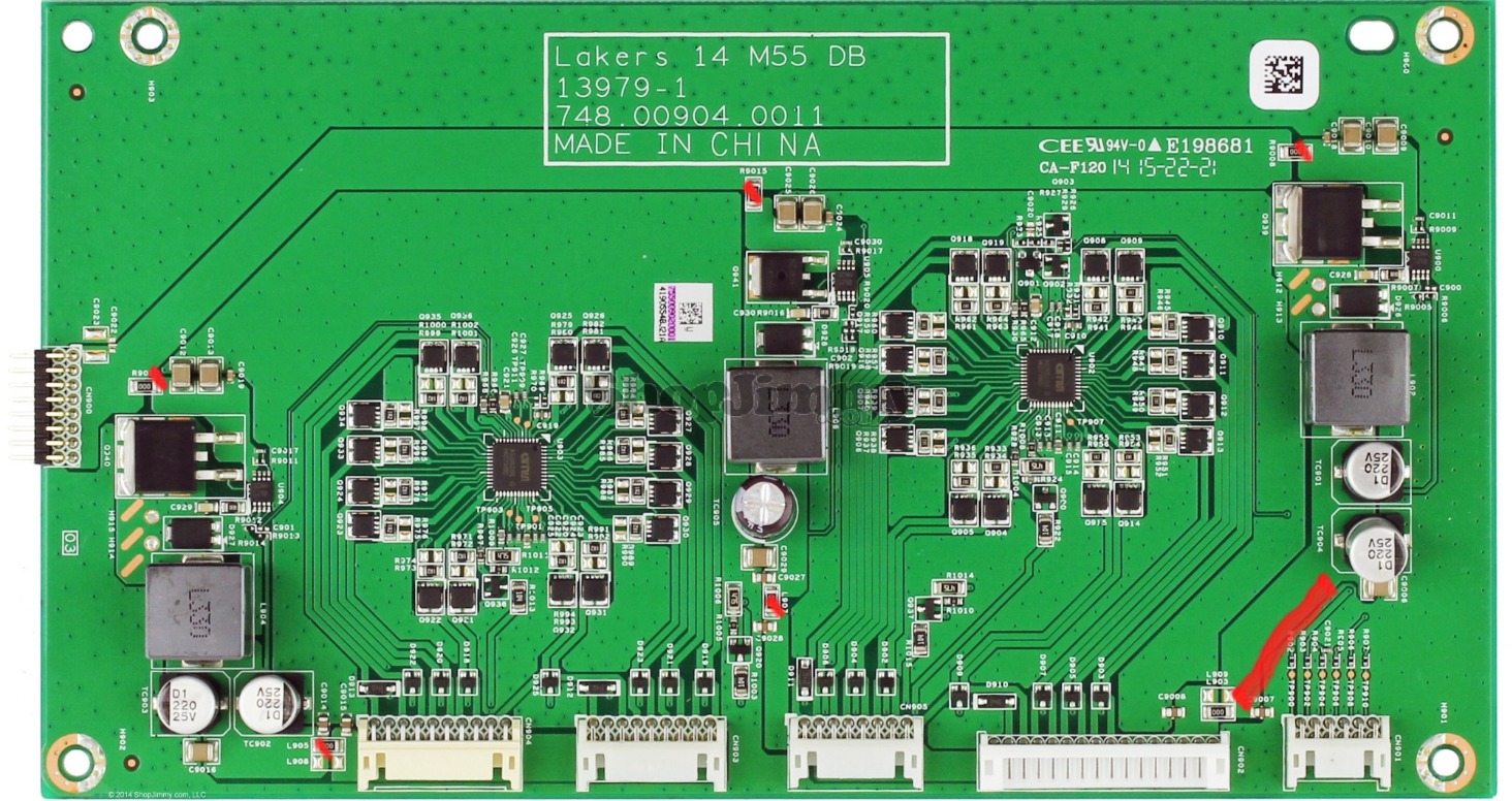

        Reflow the connector between the power board and the led driver board. I then remove the solder one at a time to get rid of the lead-free solder and then resolder for good.
        Then I glue down the black connector to the power board. There are 2 rows of pins. Row 1 are all common and row 2 are all common, you could run a line across each row. Dont bridge row 1 to row 2.
        I'll bet your connection looks like this picture.
          Re: VIZIO M552i-B2
          No, sorry I looked at that, it's fine.. and thanks.. any idea where I can get wiring diagrams?
            Re: VIZIO M552i-B2
            Check all the 000 resistors on the led driver board. I think I count 6.

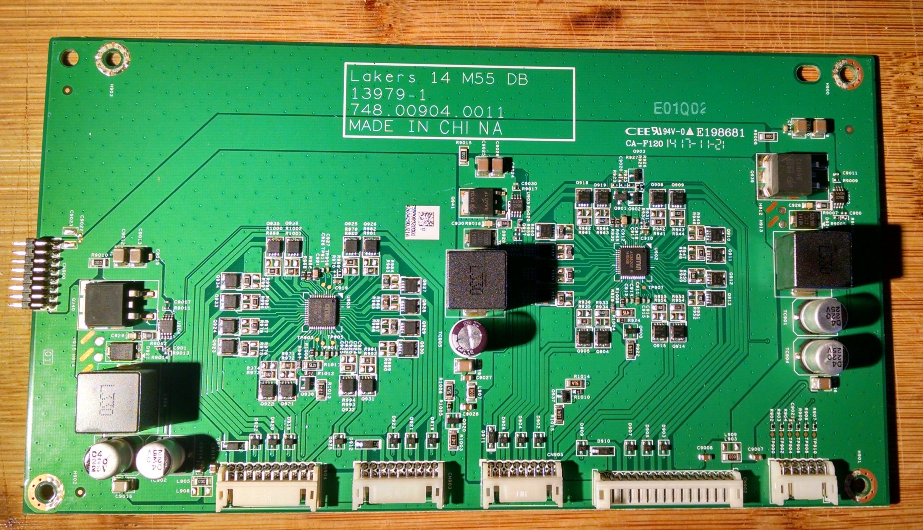

                6 resistors at 6 locations are not broken @ .6 to .7 ohms
                My board pictured below

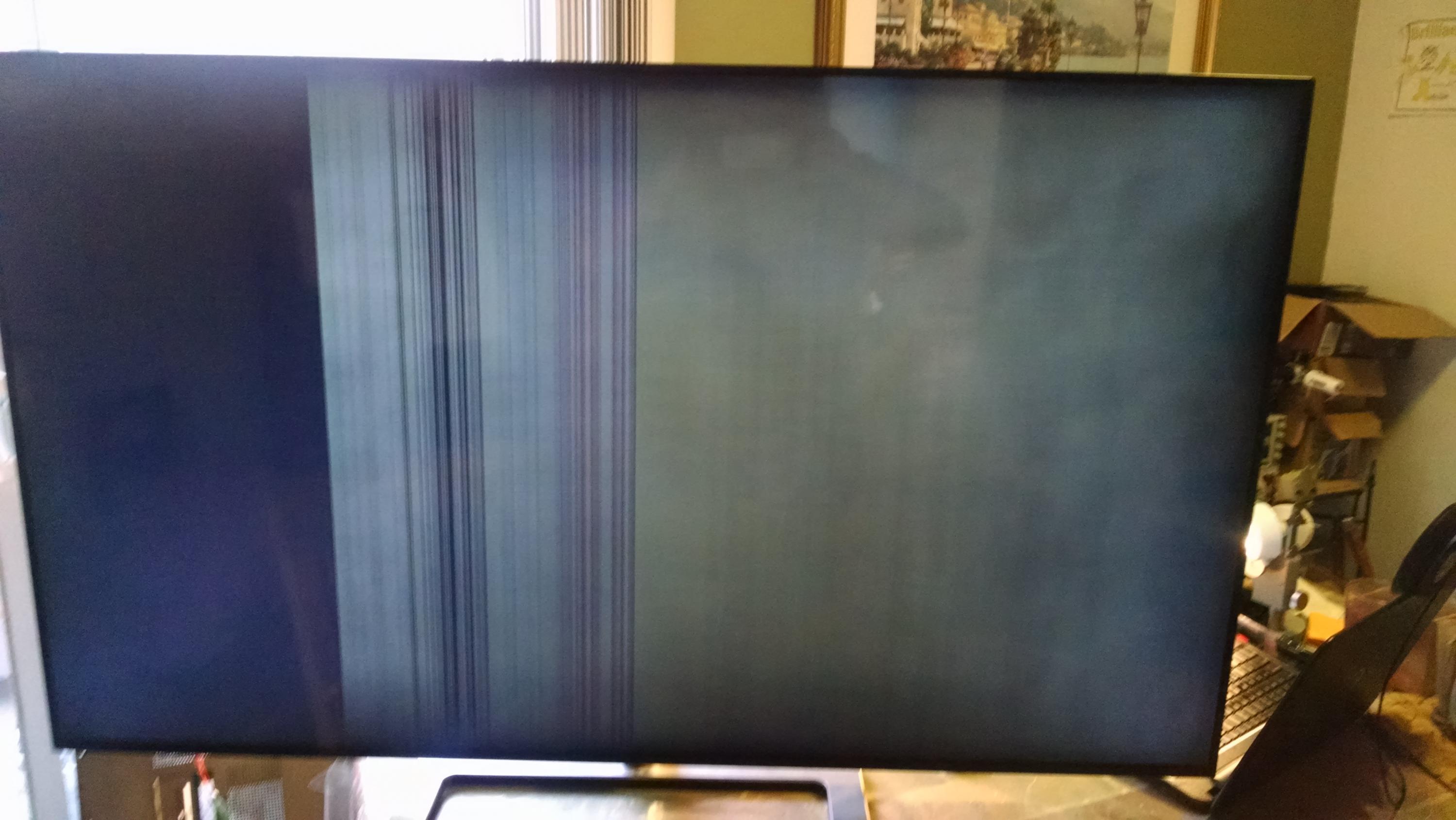

                  Re: VIZIO M552i-B2

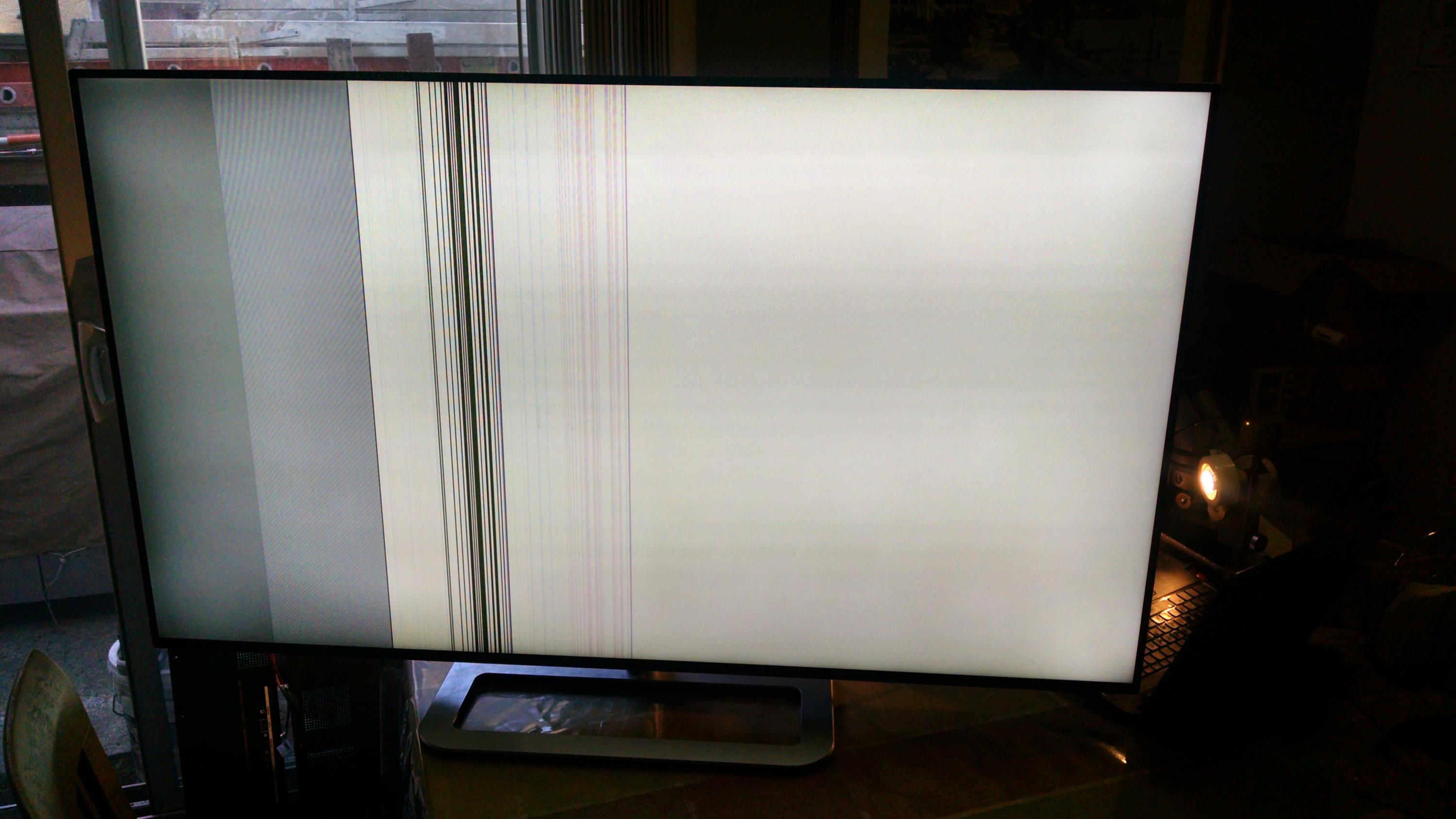

                  oh things just got interesting: ok in reference to me facing the tv from the front:
                  I removed the tcon board's ribbon to the display right hand side and 3/4 of the right hand screen lit up very brightly and tappers off to the left see picture 1
                  Then I removed the tcon board's ribbon to the display left hand side and 3/4 of the right hand screen it up dimly in comparison to the first test and has the exact same pattern showing on the screen just dimmer. picture 2

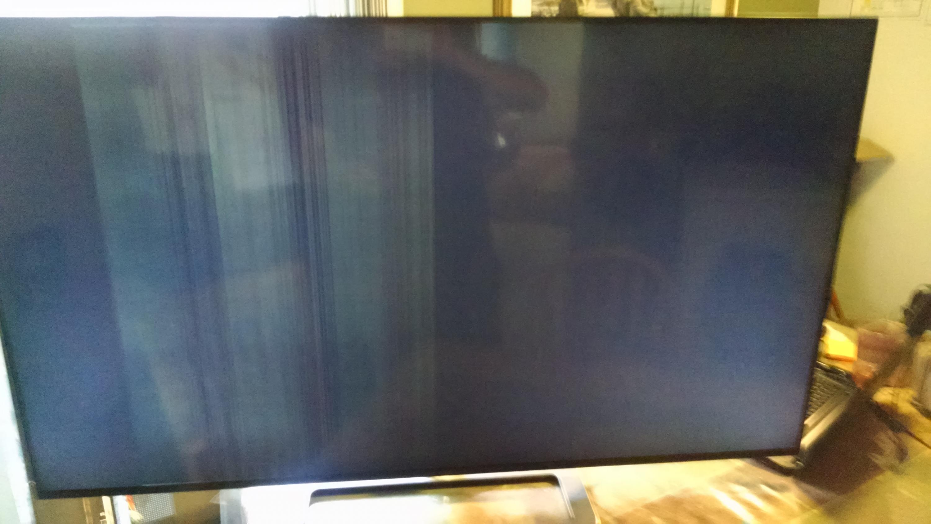

                    Ok fortunately I do have another tcon board with all references the same I swapped out the board.
                    From the second board round of test:
                    I removed the tcon board's ribbon to the display right hand side and 3/4 of the right hand screen lit up very brightly and tappers off to the left.
                    Then I removed the tcon board's ribbon to the display left hand side and 3/4 of the right hand screen it up dimly and darker than the first boards test in comparison to the first test and has the exact same pattern showing on the screen just dimmer much dimmer. see picture 2
                    ON either test I didn't hear sound or OSD just what is in the picture
                      Re: VIZIO M552i-B2
                      Sometimes if the panel has a problem, this test can show a picture on either half of the screen. since there is no real video, it could be a faulty main board, the issue of no audio could just be the tv is set to the wrong source, sometimes connecting a hdmi source will automatically switch to the correct input and then you might have sound.

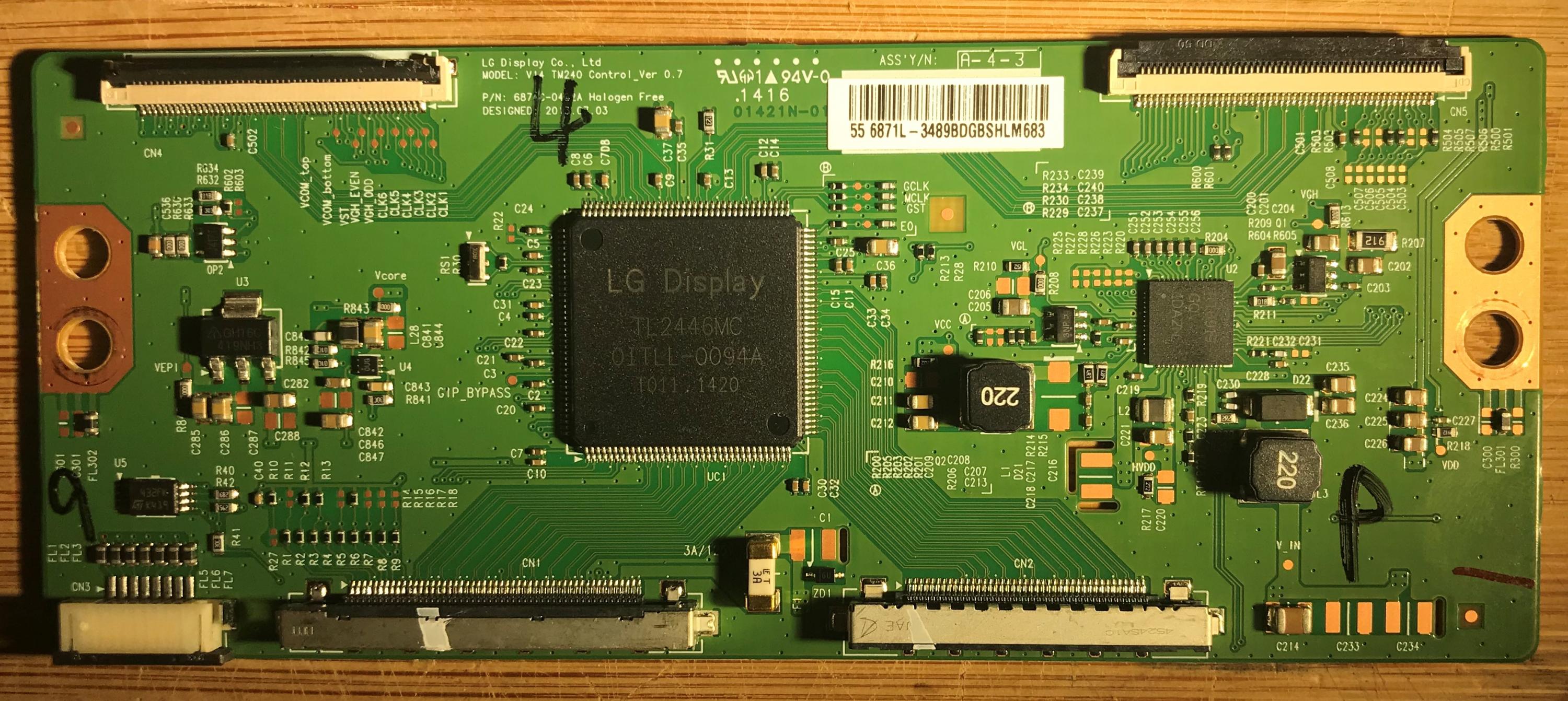

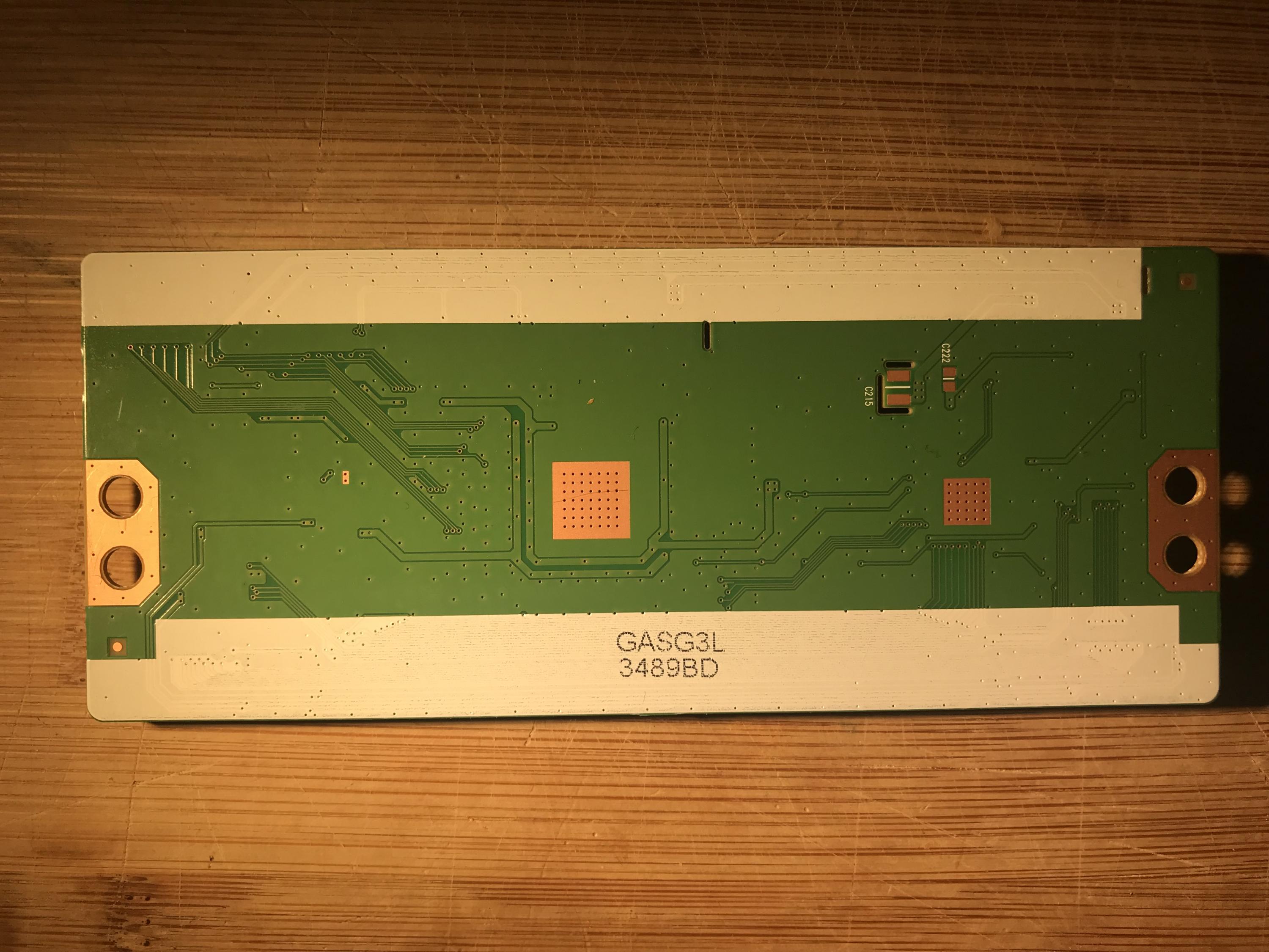

                            Can you please upload good clear hi-res pictures of the whole T-CON board? There should be a bunch of Voltage points that you can check.

                                Re: VIZIO M552i-B2
                                Tcon board front and back Hi-res

                                    Check the Voltages on the T-CON without having the cables between T-CON and the LCD panel connected first.
                                    Voltage test points around U2 (LCD power supplies): HVDD, VCC, VDD, VGH, VGL.
                                    On the left side of the board: VEPI, VCORE.
                                    Then do the same test with cables back in place.
                                        tv plugged in lcd panel disconnected:
                                        HVDD,7.87
                                        VCC,3.325
                                        VDD, 15.72
                                        VGH, 28.19
                                        VGL. 5.12
                                        VEPI,1.813
                                        VCORE.1.205
                                        tv plugged in lcd panel connect:
                                        HVDD, .8 mv
                                        VCC, 3.327
                                        VDD, 2.3mv
                                        VGH, -202.4mv
                                        VGL. -5.13
                                        VEPI, 1.811
                                        VCORE. 1.205 -- but drops to zero after 10 min during verification process.
