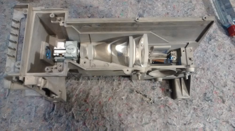

            Did you open the light engine and expose the lenses like in the picture I provided? on some light engines the have a actuator mirror, below the final lens, it can get dirty and is fairly easy to inspect
            some of the dlp lamps are vented so dust can get inside the reflector
                  I tore the entire light engine apart, minus where the colour wheel was. I will open it up and take pictures of it in a little bit. Thanks!

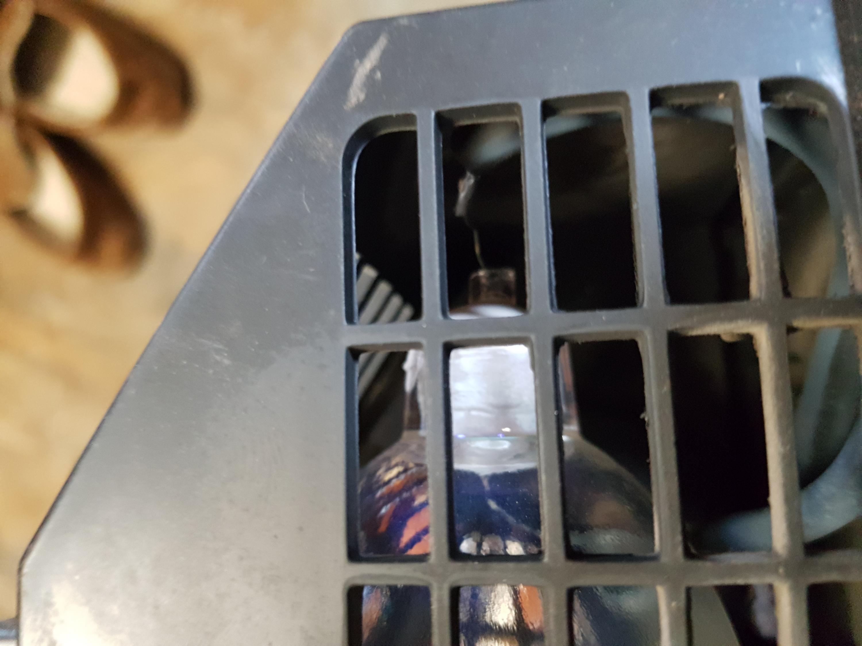

                    The previous lamp, it was really bad after market. In this picture, you can see how the bulb is "hard-wired" to the housing. I cannot find any identifiable marks on the bulb either...
                    What voltages would I be looking for and where would I be looking for them at? I figure I could maybe watch the voltage going to the ballast, and maybe the voltage leaving the ballast, but what should they be?

                      I removed the colourwheel. I looked throught the glass window that the light from the bulb shines through, the one that has the colourwheel on the other side. The wheel was in bad condition. There was dirt, but it was really hard to remove. I had to use water and a microfibre cloth.
                      I noticed it does not spin very freely. I think I should order a replacement.
                      **EDIT:
                      After looking at the price of a new colour wheel, I have decided to clean this one! A YouTube video shows a gentleman cleaning it with isopropyl alcohol and q-tips. I will do that, very careful like, and make sure there's no smudges before reinstalling, and see how things look then.
                      When I mentioned the TV looked brighter after being on for a while, it could be just because it became night time and appeared brighter...

                        If the (spinning) color wheel is dirty, you can bet the other 4 or 5 lenses after the colorwheel are also dirty, that piece of glass between the lamp and the colorwheel is usually a UV filter, not just a piece of clear glass, so it can get discolored over time due to heat.
                                    I cleaned the colour wheel and the UV filter. Is there more hidden lenses some where?
                                    I cleaned the main mirror behind the screen. I cleaned the round glass ball looking thing.
                                    Finally, we turn the TV back on, it's not bright. I go back, I push up on the HDMI cable, the video source flashes for a second, and the TV is bright. Could a bad HDMI port cause dimness or is the bad ports not related? I was thinking of trying to reflow those HDMI ports...
