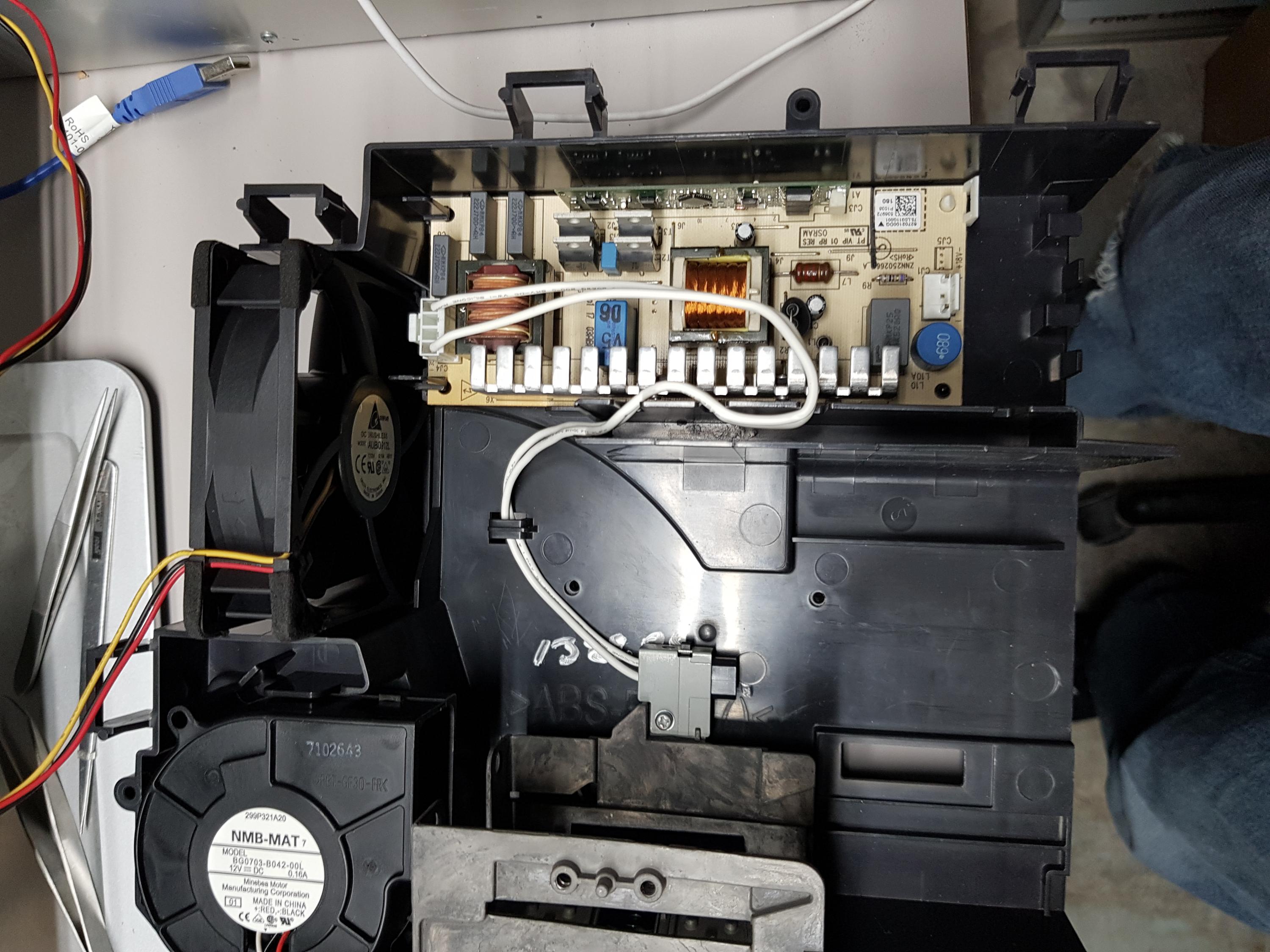

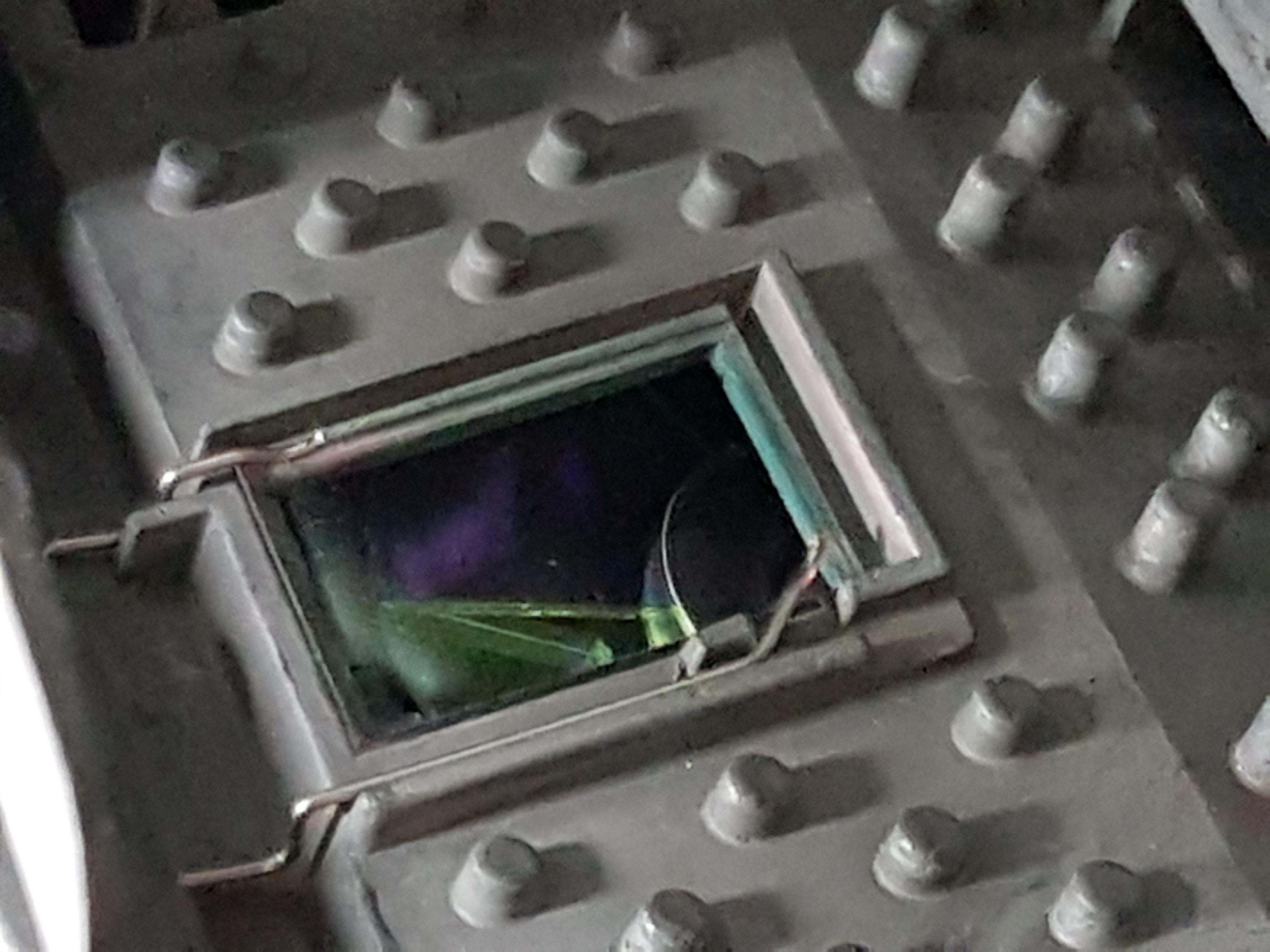

      Originally posted by Spork Schivago
      Fans aren't sticky. I checked them. Was kinda surprised, because of how dirty they where. I don't see how I could possibly tear the optical engine apart anymore to clean it. I've taken it all apart, minus removing the heatsink on the DLP chip. I don't think there's anything I missed. I got some pics if you guys wanna see the engine I got in this.
      I provided a picture of a light engine that is in some of these mits, If you have a picture of yours, post it.
      After the light passes through the color wheel, it goes through a light tunnel, then through a few more lenses befoe it gets to the dmd chip. There should be a black plastic cover over the rest of the light engine optics

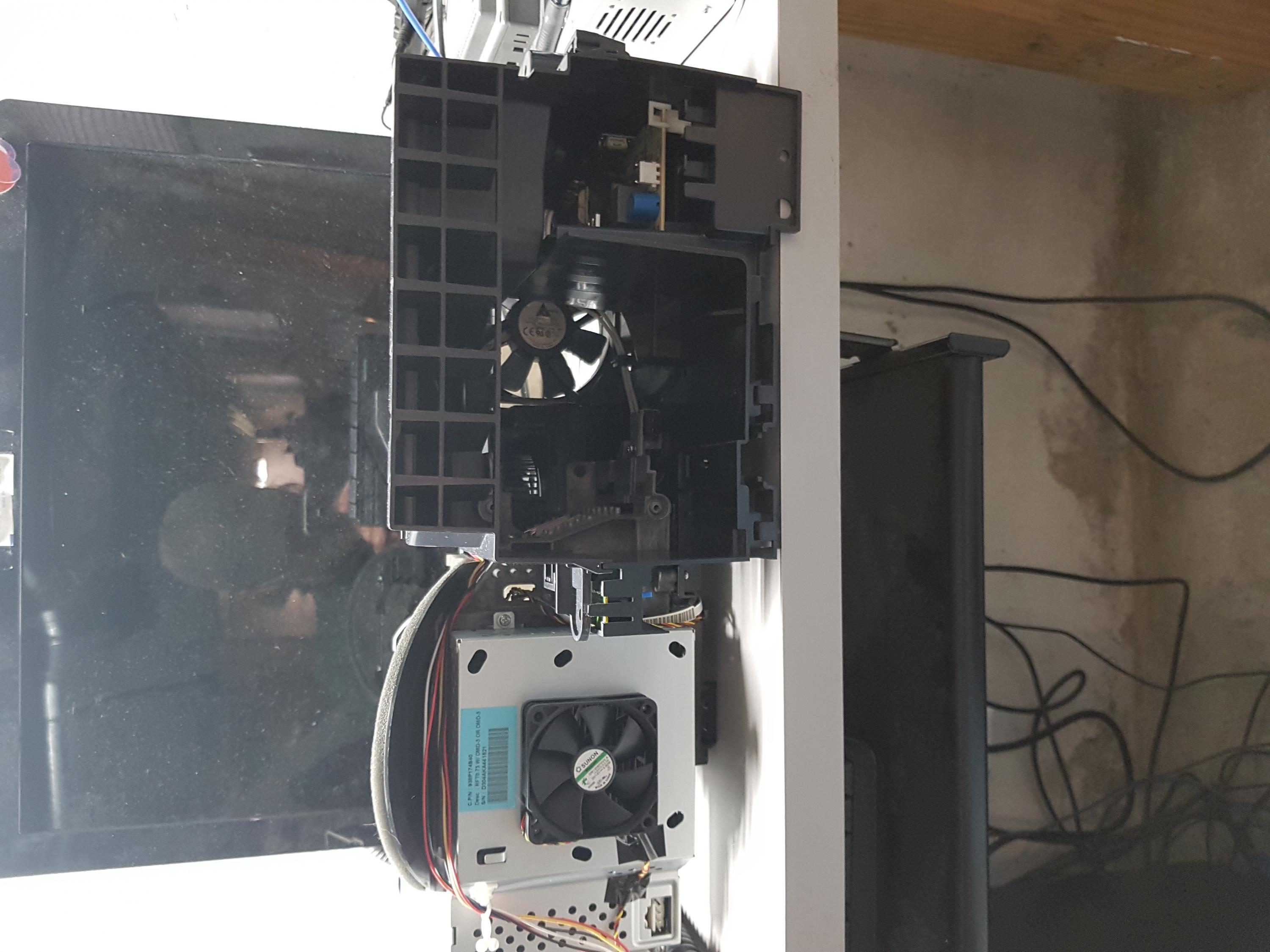

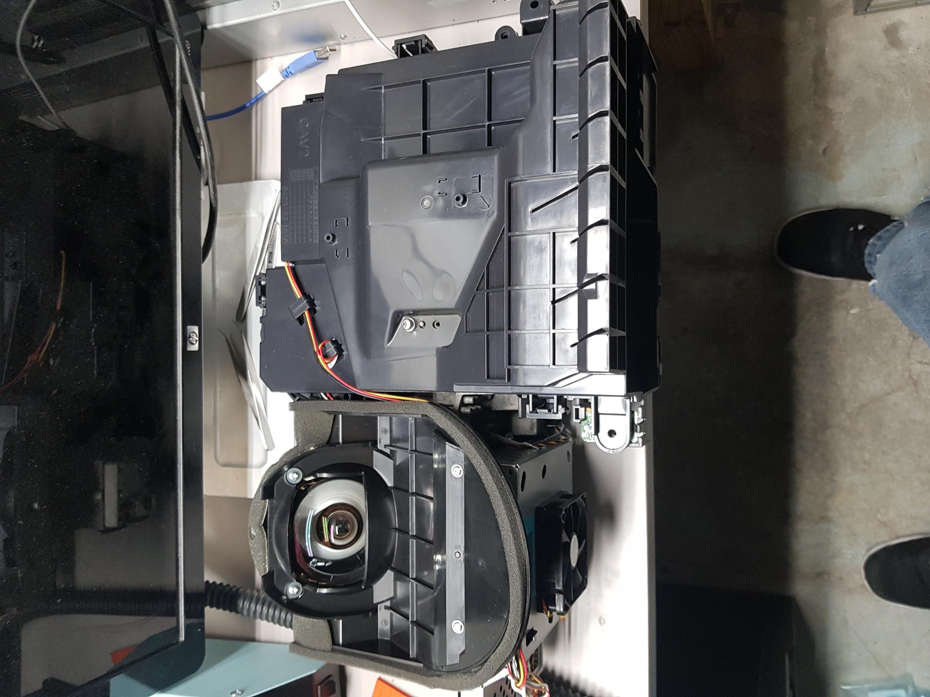

          I apologize for not doing this sooner. I've been having some issues with my memory and how I feel. Feels like I've been hit by a locamotive, all the time now. Seen the neurologist the other day and she thinks it's from my white matter. Says the MRIs show it's going away. She's got another MRI scheduled and now an EEG. For the EEG, they want me to go 24 hours or so without sleep. I think they're looking for seizures with the EEG.
          It just makes it hard to work on this for some reason. I turn the TV on today, I hit the menu button but on the remote, same thing, goes in a loop, like the menu button is stuck. But this was with the remote. And the video source would just cut out, cut in. Every few seconds. As soon as the picture would come, it'd cut out, sound would cut out as well, and come right back, like it's stuck in some sort of loop.

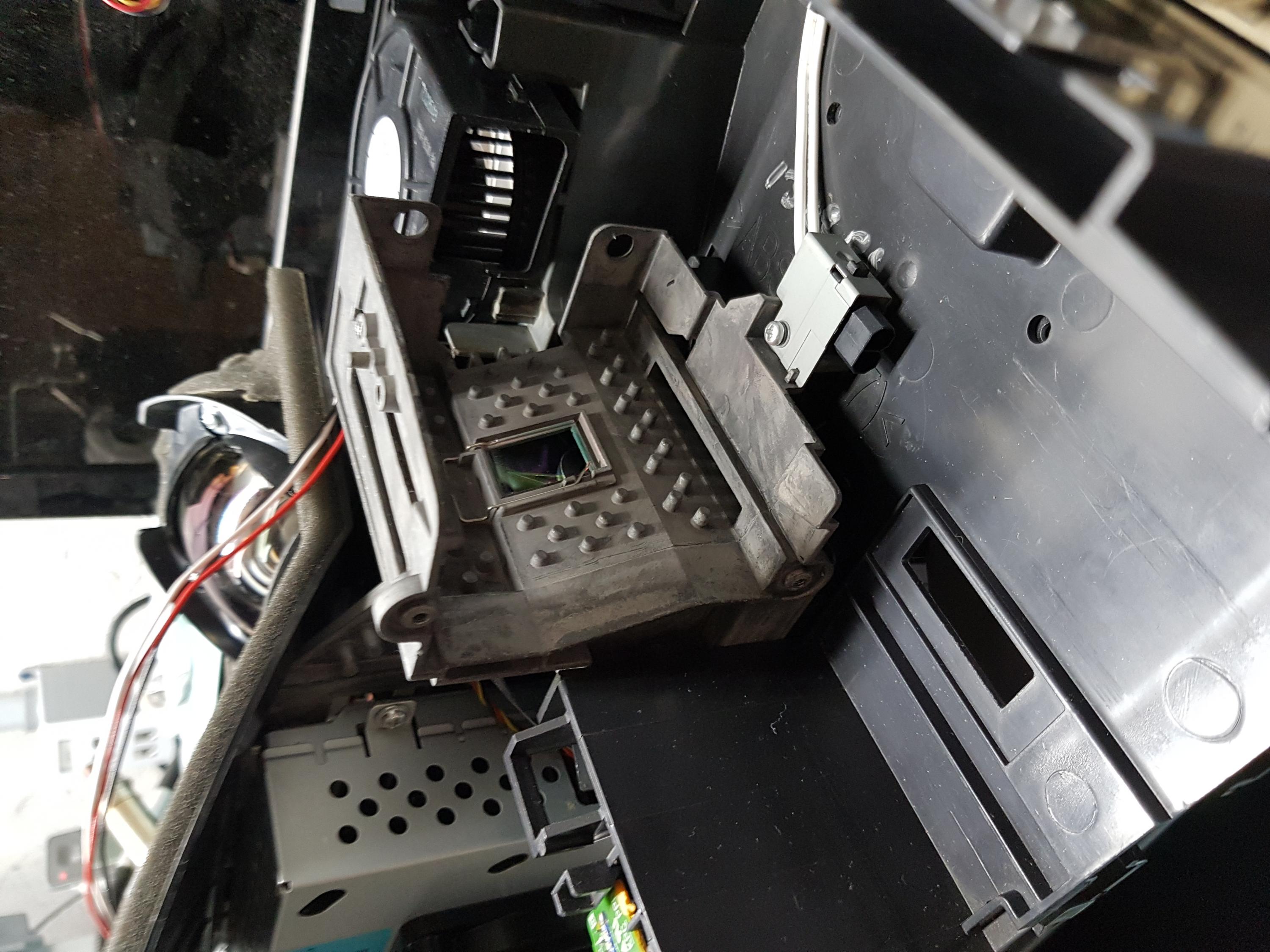

                              #34
                              Re: Dim Mitsubishi WD-73738 DLP Telivision

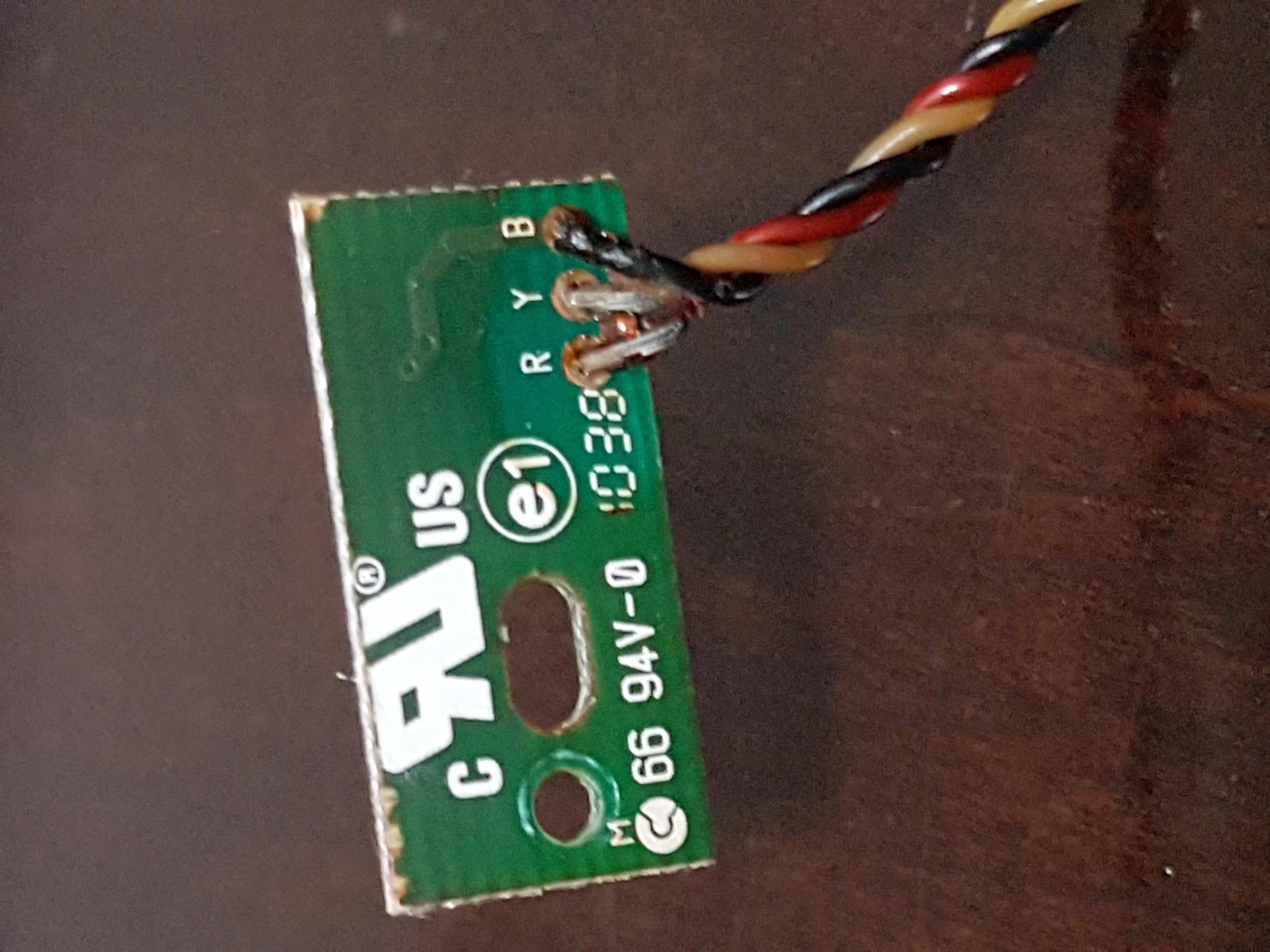

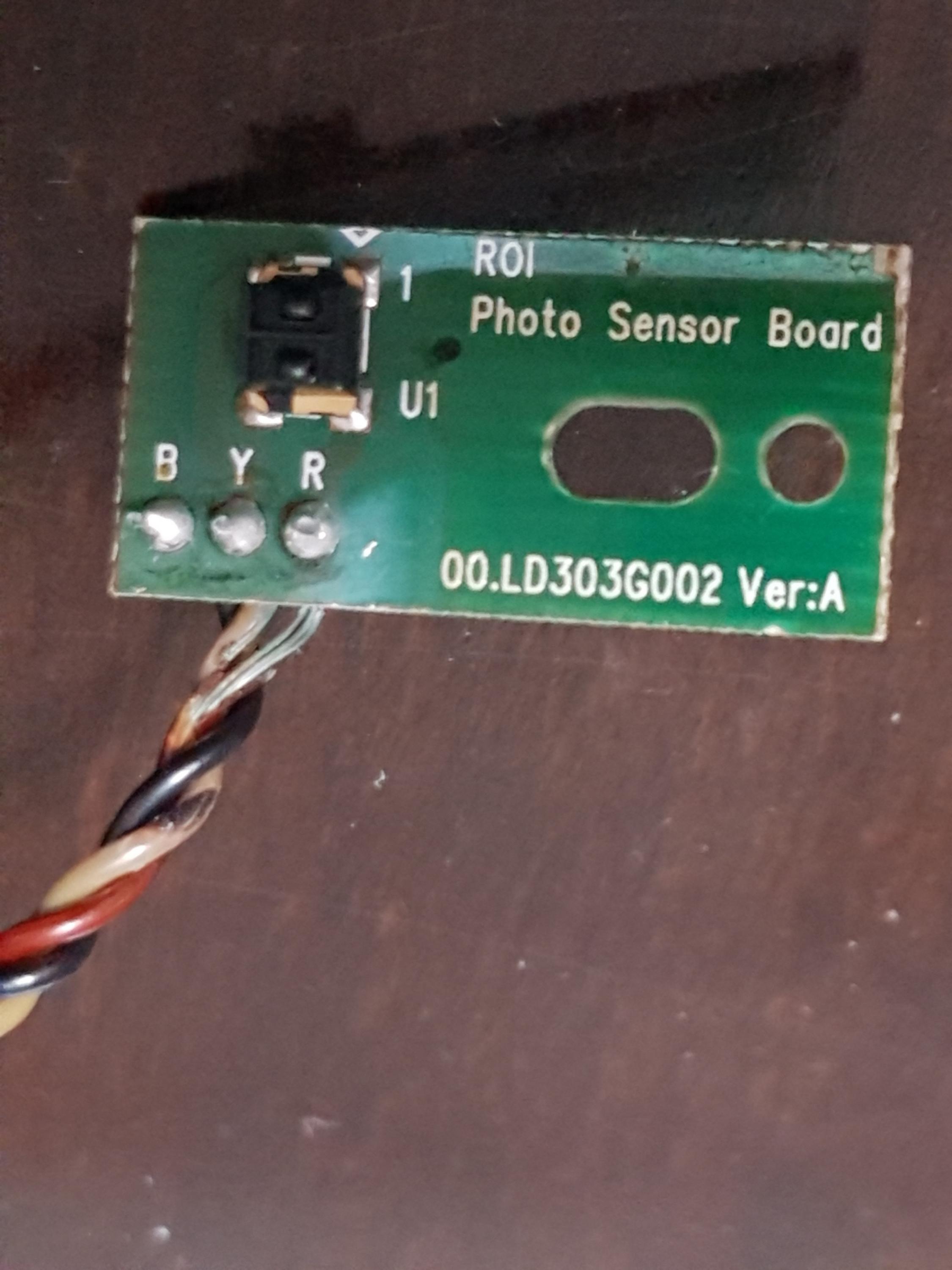

                              Holy cow! I think I _FINALLY_!!!!! figured out the problem! I was looking at colour wheels on eBay for this TV, trying to find a part, because internet says for Mitsubishi 2011 model DLPs, 0061 is Lamp Enable Not Issued and the reason is Possible bad Colour Wheel.
                              I seen on ebay they got this tape or glue or something on the middle metal spinning disc (that the colours attach to). I thought maybe that had come off. Some wheels on eBay said if the black tape wasn't at the right colour as the original wheel, to move it to the proper colour. I thought maybe this "marker" came off so I removed the colour wheel again to check. It was still in place.
                              So, I removed the sensor board, and low and behold, the wires are burnt, one missing it's insulation all together for like half an inch. Board itself looks bad and I will post pics after dinner.
                              -- Law of Expanding Memory: Applications Will Also Expand Until RAM Is Full

                                #35
                                What do you guys think? Having hard time finding a replacement PCB. Was thinking the photointerrupter is probably good, because we get a picture sometimes. Figured maybe those two wires, Y and R, being shorted out is causing the issue, and if I could not find a replacement board, perhaps I could somehow replace the wires. The connector that plugs into the DMD board (the one that comes off this photo sensor PCB) isn't really a common one. I have a bunch of different connectors that I save, just in case I need to replace one, but this has a little lock you gotta push down on to remove it. I don't have any like that.
                                What do you guys think? Try to replace the entire board or attempt a repair?

                                  #36
                                  there is nothing special about the wires other than perhaps they need to have some thermal value to prevent the insulation from melting. You can likely just splice / replace the run of wire or provide some insulation to ensure no shorts. Get your meter and check end to end continuity of each wire... that may tell you if the existing wire has an issue or not.

                                    #37
                                    In almost all dlp sets, if the color wheel has an issue, the lamp will not light at all, this to prevent the lamp from burning the color wheel disc. The lamp does not have a soft start, it is just the way these (UHP) type of lamps operate, they get slightly brighter after a few minutes of operation. It is a mercury discharge lamp, and it acts like a mercury vapor street lamp.
                                    If there was a problem with the color wheel indexing, the color would be way off, If the colors are correct the indexing is correct.
                                    I have seen some intermitint solder connections on the plugs on the dmd board in the past.

                                      #38
                                      As indicated above... if the color wheel causes an issue (ie. such as the system is unable to detect proper spin speed), then in most cases, this type of error "usually" occurs at startup, and the lamp would normally not be "striken" (started). However, if the error occurs during "normal run" then its possible that the unit would then shut down the lamp to prevent damage to a slow wheel or otherwise. You can check this with a "viewing" test" such that when the image disappears, look "carefully" at the light engine to see if the lamp is still lit. Of course, if you can eventually get a display again, you could also check the "counters / errors" to see if there was a "0061" happening again.
                                      Further, in DLP land, brightness of an image is usually achieved in two ways: one from the actual bulb rating and two from the color wheel itself. On some designs, a "blank" / white segment is used for both sync AND improved brightness levels. I am not sure about the Mits design but other projector manufacturers (eg. optoma) use this mode. On your wheel, what is the colors segments specifically going around the wheel?
                                      Further: Looking at a bit of stuff around this, it would appear that perhaps, then sensor is able to determine intensity of light in terms of range such that the main control can decide on how long to "turn on" the dlp chip segments to brighten or reduce intensity. It maybe possible that the sensor is coated with gunk such that this "work" is wrong... or there is a wiring issue. There might be some checks for this or perhaps some cleaning (carefully) of the sensor. What maybe happening is that the sensor is not detecting sufficient brightness as "requested" by the controller, so the controller is upping the "dlp activity" level to get more brightness. However, the system feedback via the sensor still does not show the expected "improvement" (or runs out of "on off" cycles for the dlp) and thus eventually the system "errors" and shuts down.

                                        #39
                                        I'm going to do that. I'd love to replace the wires, rather than splicing into them, but I cannot identify the connector on the end, nor can I find my caliper, which would greatly help.
                                        Unfortunetly, I think cutting out the bad, putting new wire in is the way I gotta go with this. I've been reading, and some people with similar DLPs (not the exact same model, but close) say there's a heating issue where the colour wheel is, and it damages the wires and the photointerrupter. They replace the photointerrupter and try various things, like adding a fan to try and cool the area. I'd rather not do that, but I'm trying to think what could have caused this damage. If it's getting so hot, it's actually melting the insulation off the wires in there, then perhaps external cooling is the way to go.
