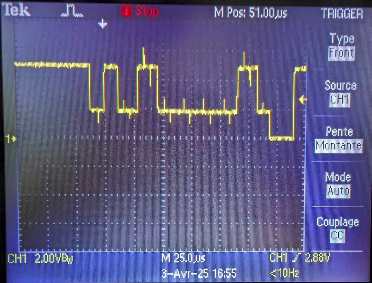

            I still find the SDA line dirty on as soon as I plug the ribbon cable that goes to the KBD/LCD.
            It looks like a capacitive (or R/C) load on the line:
            Click image for larger version  Name:	image.png Views:	0 Size:	1.56 MB ID:	3606936
            (sorry for bad quality, for some reason I can no longer make screen capture via USB..)
            Strange thing is the SCL line is not affected, only SDA.
            I tried removing the 3x ICs connected to SDA on this PCB and the issue remains, so it could as well be normal.
            I can't test with the ribbon connected on CPU side and not on the KBD side, as in this case no I&C activity happens (which would mean... the I²C devices on the KBD/LCD side are "talking" to the CPU ??? maybe ?)
            The issue could be with the cable itself. Like a 2.5m long ribbon cable sure has some parasitic capacitance... but it was designed this way, so it must be normal... I guess (????)

              ok, so it seems that the I²C waveform could be a case of reduce de value of the "pull up resistors" according to several information I found here and there.
              I tried to change the value to 5K but nothing changed.
              Then 1K, but at 1K something strange happens: the Low level is not always at the right voltage. Sometime the signal goes down to 0V, sometimes it goes down to ~2V for a low level.
              It seems to me that 2x I²C devices are trrying to "talk" at the same time, and the signal gets jammed. Might be wrong, but I find the waveform suspicious.
              Interestingly, on the CPU board, the SDA line goes from the CPU through 2 nand gates (74HC03) in // (2 gates output connected together) to the headers. Not sure if it's to increase the output current or for some other reasons they did that.... I'll start by this one I guess.

                  Why does your i2c wave form have so many spikes in it? Doesn’t look clean?

                    Ok, so I have some progress and the machine seems to work. There is still a fault, but should be an easy fix.
                    First, yes this I²C waveform has been bothering me for some times and in fact it's thanks to a "mistake" I made while I was trying to understand why the I²C signal was so dirty that I "repaired" the board.
                    So, I was poking around the board with a scope while plugin/unplugging the ribbon cables on which the I²C are going (one to the KBD/LCD, one to the main PSU board and one to the opto board) to see which board was causing this.
                    First I found that unplugging the LCD/KBD ribbon cable would make things better (and by the way if you unplug the ribbons after the cpu has started it will continue to send data on the I²C bus, while if the cables are not connected when you start the cpu board it will not even attempt to send any data past the first attempt), the signal was better but still "dirty".
                    I disconnected the opto board as well, it was slightly better, but still not clean.
                    Then I disconnected the main PSU board (the cpu board was directly powered by the bench power supply), and the signal was clean.
                    So i reconnected the Opto board, it was still "clean". then I decided to test agin by plugging back the main PSU board and then something strange happened. the signal stopped.
                    I powered off the board, reconnected everything and then I was greeted with a single beep and an error on the LCD screen:
                    Click image for larger version  Name:	image.png Views:	0 Size:	5.6 KB ID:	3607995
                    So... I corrupted the eeprom content. It was not a big deal as I always take a dump of all eeproms before working on a board.
                    After reprogramming the eeprom I was back to previous state (beeps : 3S - 3L)...
                    I then decided to repeat what I did before : unplugging an re-plugging the main PSU board ribbon cable, same thing happened, again error 145 after restart.
                    And that was finally a good thing as, in this state you have access to the service mode where you can select the model number (sort of factory reset) and it will automatically re-generate the eeprom content.
                    And since then the board seems to work perfectly fine.
                    So... as I was suspecting, there is probably nothing wrong with this board and corrupting the eeprom solved the issue, apparently. I'm still confused how dirty the I²C signal is, but it works and honestly I can't find a clear "fault" that would explain why the signal is like this.
                    Some capacitive load on the SDA line because of the ribbon cables and pcb ? maybe, but the SCL line is much more clean and goes trough the same paths... for good measure I'll replace all components I already ordered, but that will probably not change anything.

                                I did some measurements again, on X11 V.Line pin (18), I read 3.86V (slightly lower than yesterday, which is not surprising as mains will always vary from one day to another).
                                But now, when I measure on the other side of the 10K resistor pack (AN15), I find a (not perfectly) square wave signal at 25hz (tried to capture it with a portable scope, but I have again some driver issue and can't extract the waveform..)
                                And if I measure the adjacent track (AN6) I find the same signal. But on the other side of the 10K resistor for this track, on pin 19 "Analog-1", I don't have the signal but a DC voltage close to 0V.
                                I measured the resistor between AN15 and AN6 and find ~2.8ohms, so it's not a dead short. and pin header 18-19 shows around 20k, so the issue is on the cpu side of things... right... ?

                                What Is strange is that yesterday I did the same measurement I did have 3.89V on both side of the 10K resistor for V.Line (Pin 18 and AN15) and there were no sign of this weird square wave signal.
                                And that's not a signal i would expect on AN6 as Pin 19,20,21 are analog 1,2,3 inputs used for the measurements arms, it's supposed to be a dc signal.
                                So I'm definitely inclined to think there is some sort of internal short in the CPU. heating the PCB and the 10K res pack which is close to the CPU might have done something to the CPU itself.
