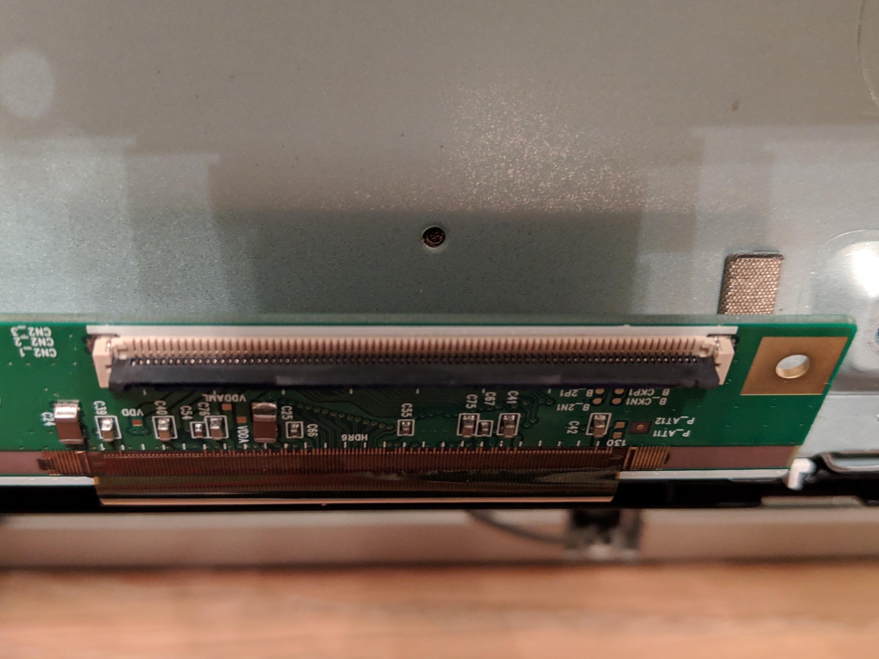

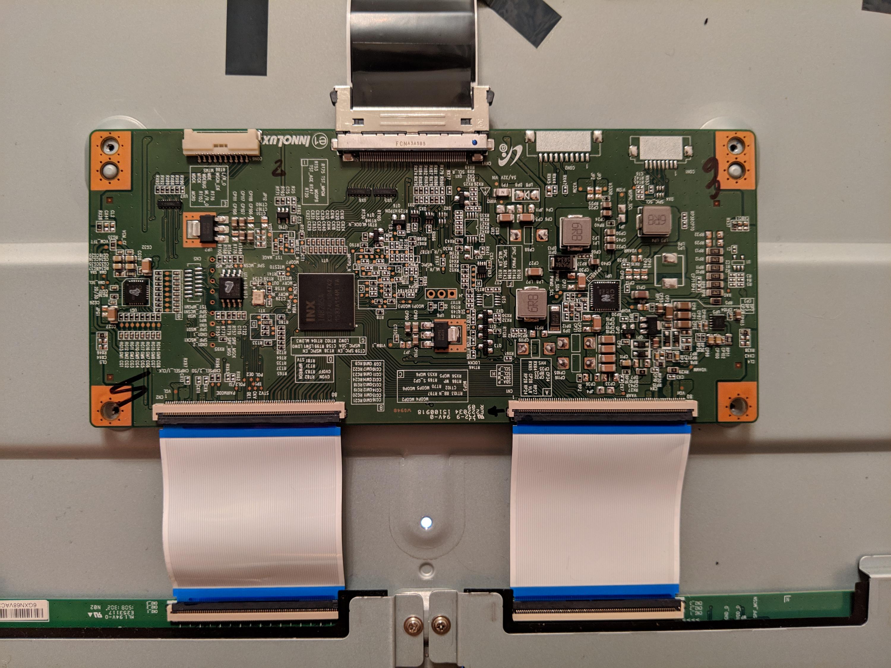

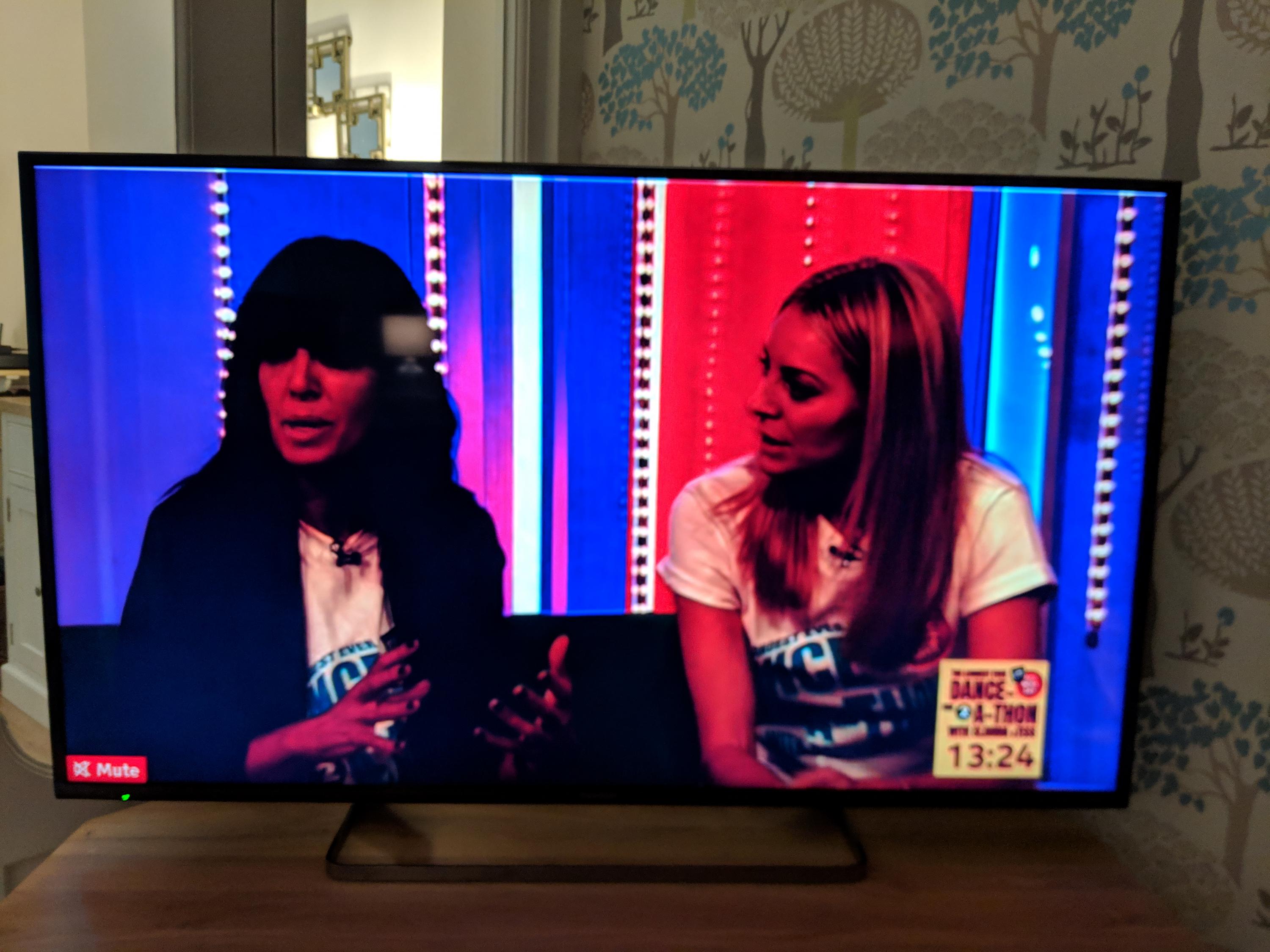

    So basically I was at work one day when the missus said the TV was on then all of a sudden went black and she still had sound.
    The TV is an LCD and so the backlight was fine. When I initially dismantled the TV I dismantled the front screen before realising it doesnt have LEDs. My fault for assuming. Anyway I suspected it was the Tcon board.
    So today a new Tcon board arrived and away I went and changed it. When it first booted up I got a picture looked fine, happy days. Then it went to some vertical lines before disappearing but then the picture came back albeit being very dull and not looking great.
    Could this just be a case of ribbons not sat perfectly now and require a bit of cleaning? I've attached some photos to give you better picture of what I mean.
    I've got a picture so that's a start. Just getting it too look right now.

    Re: Panasonic 50CX680 Tcon board fix need help
    I can't seem to edit this post on my phone. However an update it's now just gone black

        On the TCon check fuse FP1 on both sides for voltages.

              sounds like tab bonds or a bad driver. Disconnect only one side of the TCon and see what happens to the screen.

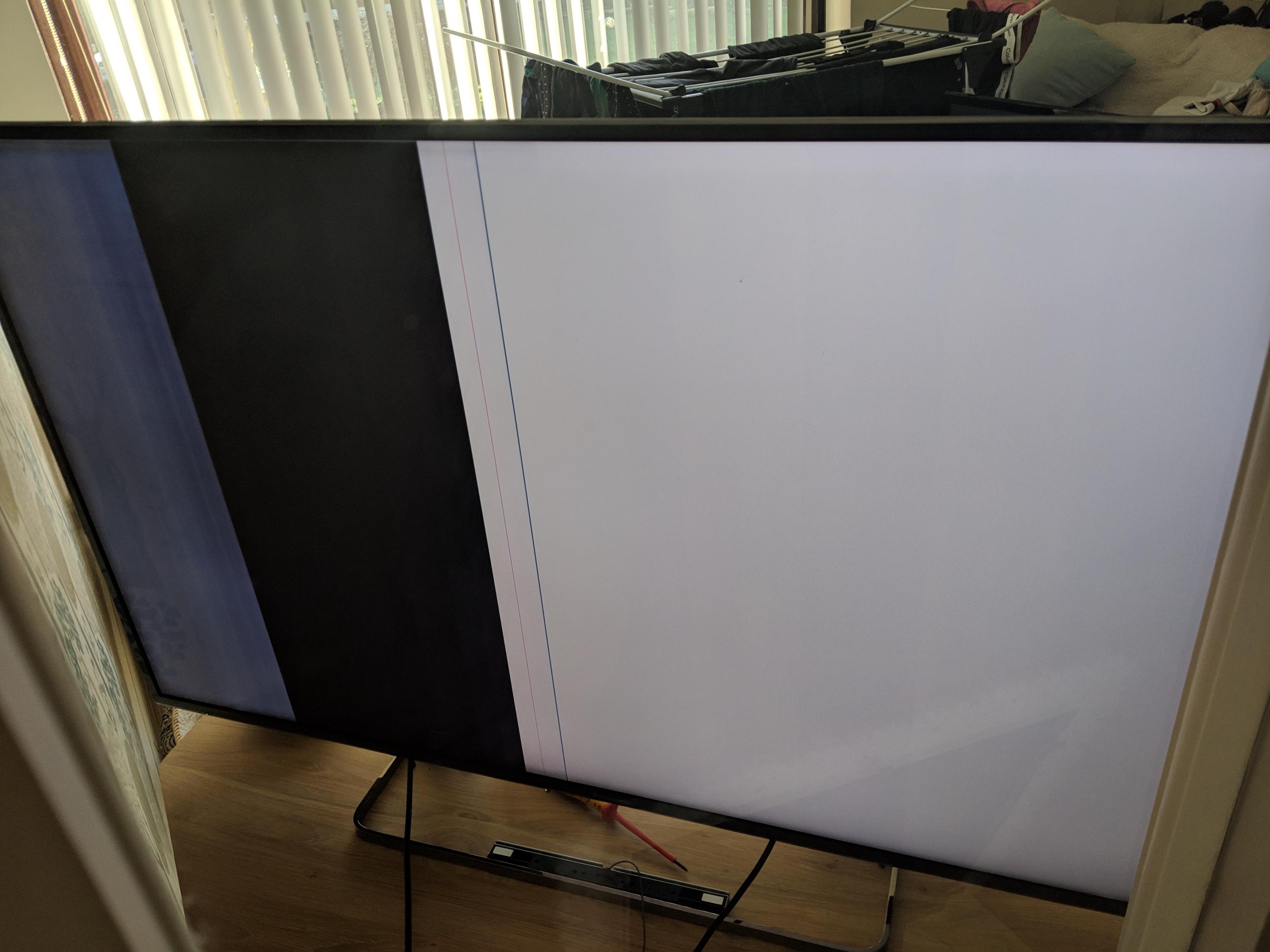

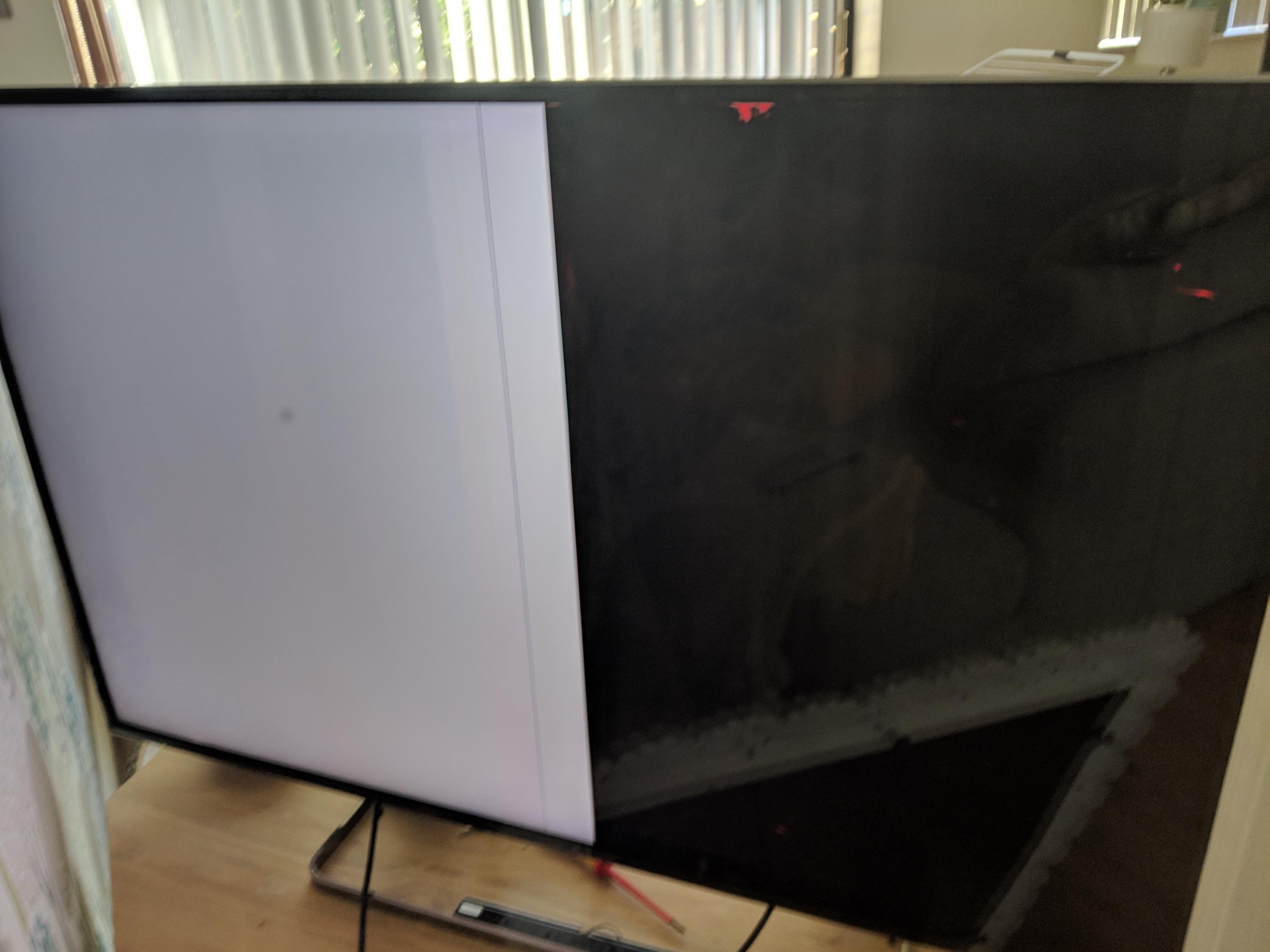

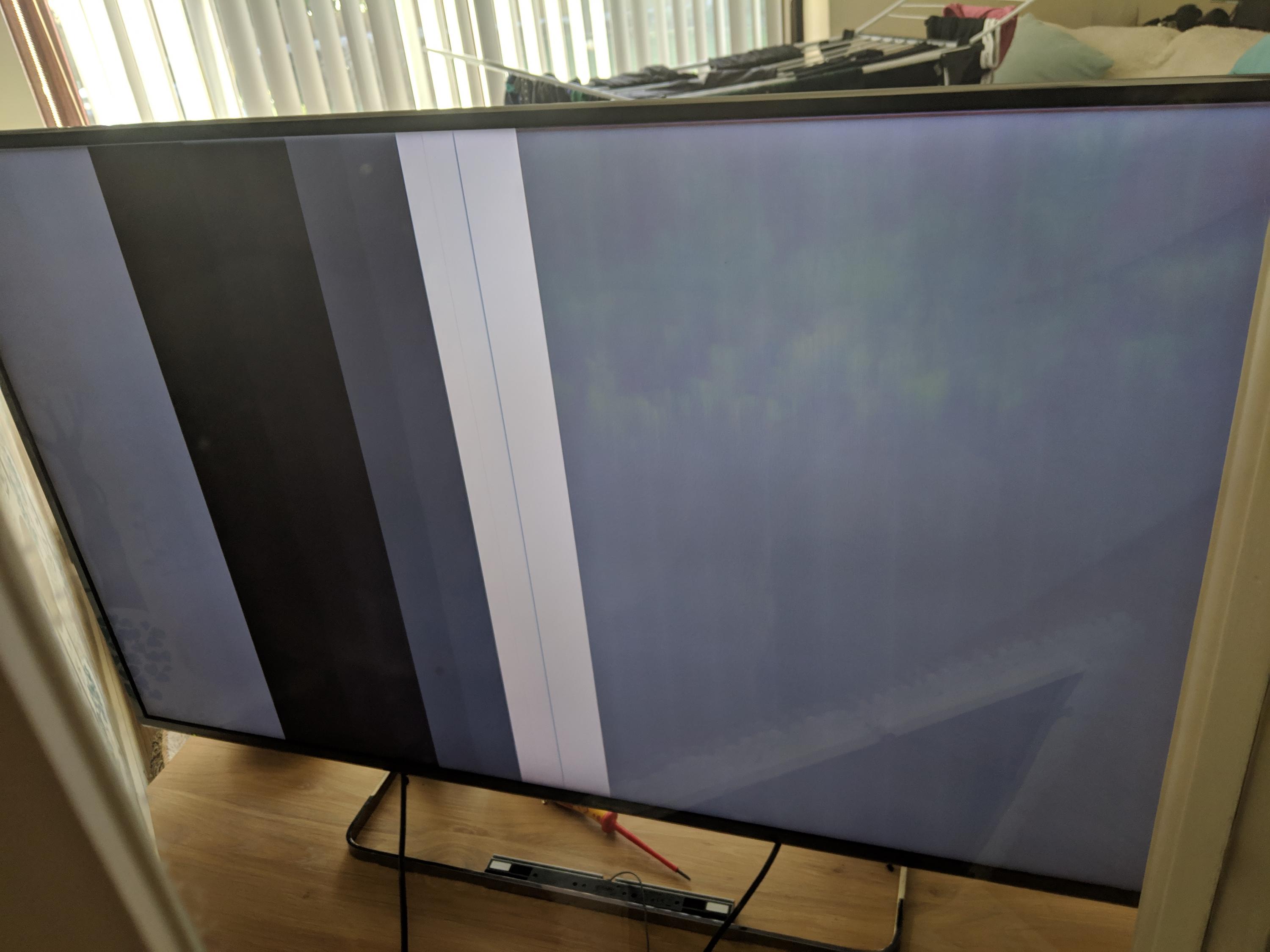

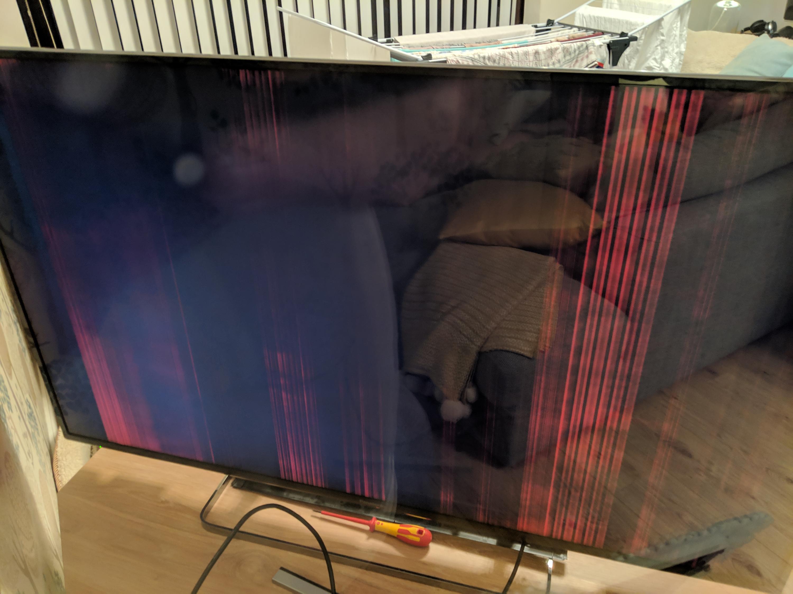

                Hi guys, just got back from work and now trying your suggestions.
                I checked both sides of this fuse and got a solid 12v DC
                It's a panasonic, sometimes you get a blink code, the question was, DOES the standby light on the front blink??
                When i plug the power in I get a red standby light which flashes one then lets say around 5secs later goes to Orange standby light.
                Should I do this when its turned on or off?

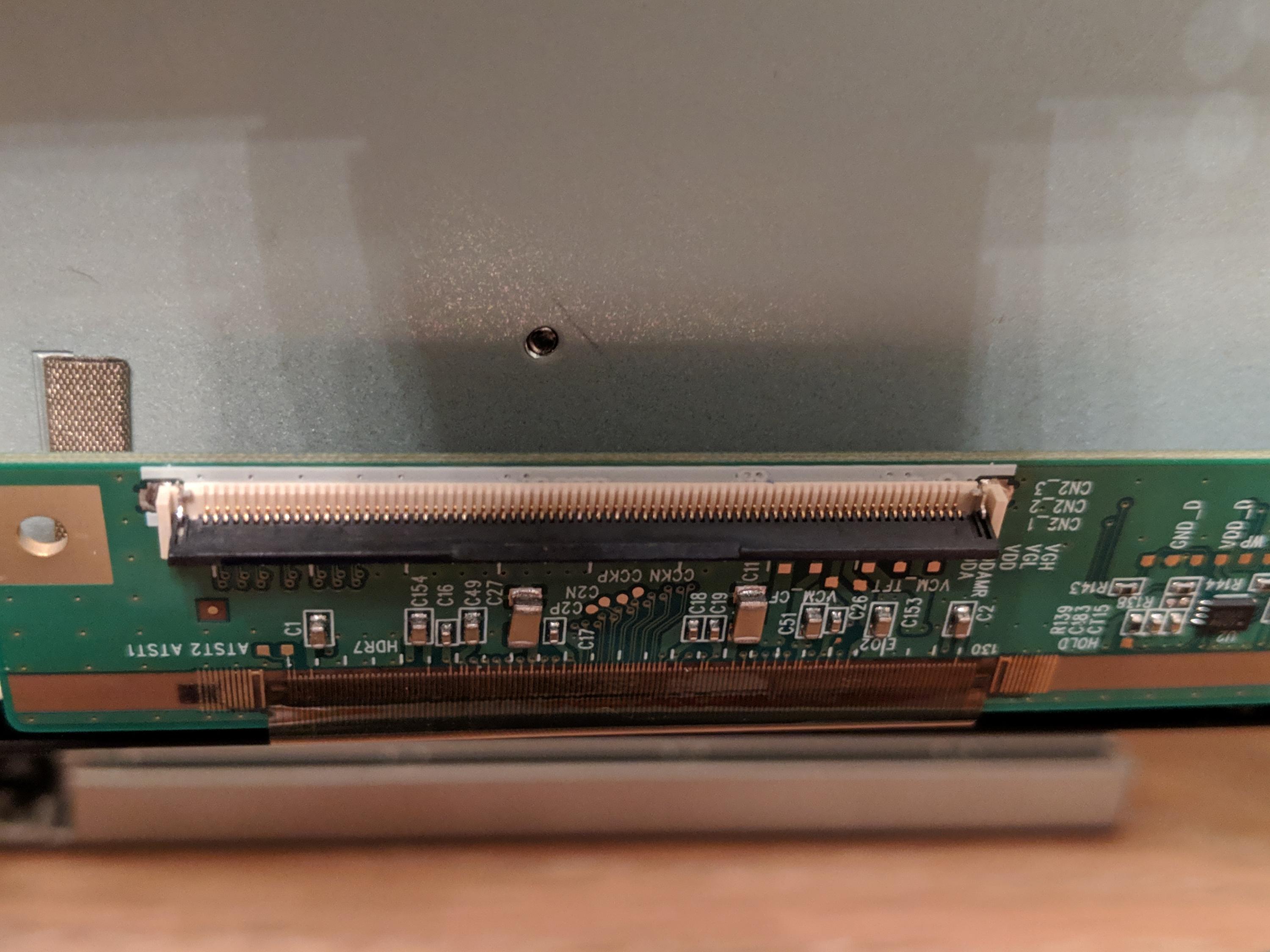

                Edit: I powered it off before disconnecting each ribbon cable. Anyway first picture is before. Second is left tcon (as looking at back) disconnected then third is right tcon.

                        your two picture of the disconnected cables appear to show an issue somewhere with the bottom edge boards... based on the "one" vertical line on the side that is disconnected. Its hard for the tcon to cause this line since the cable to the tcon has been disconnected. When you did your first "tear down", how much of the set did you "tear down"?

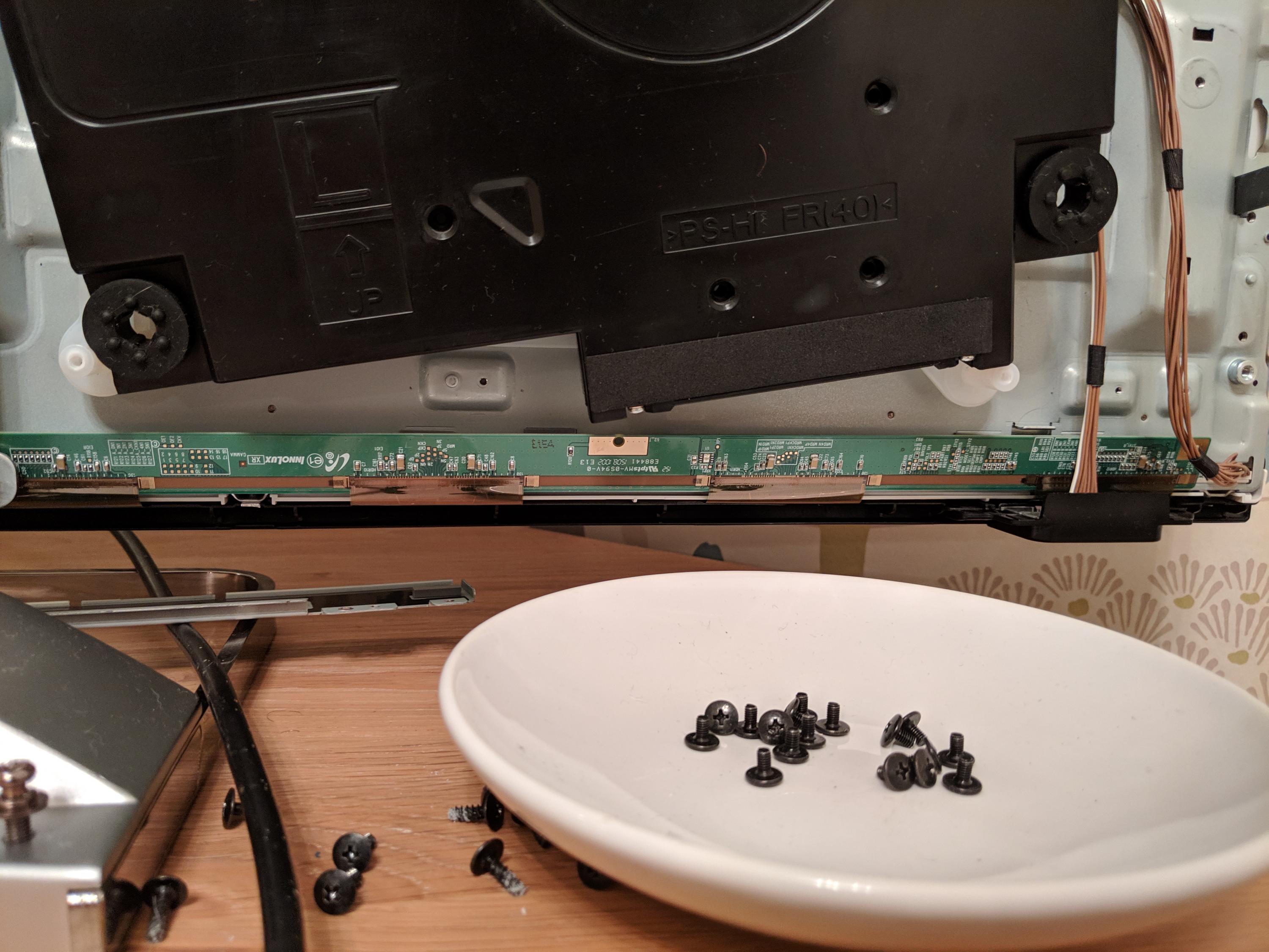

                          I never took the bottom drivers out, however I did take all the front screen filters and bezel off when I was looking for backlight that didn't exist. 🤔😵

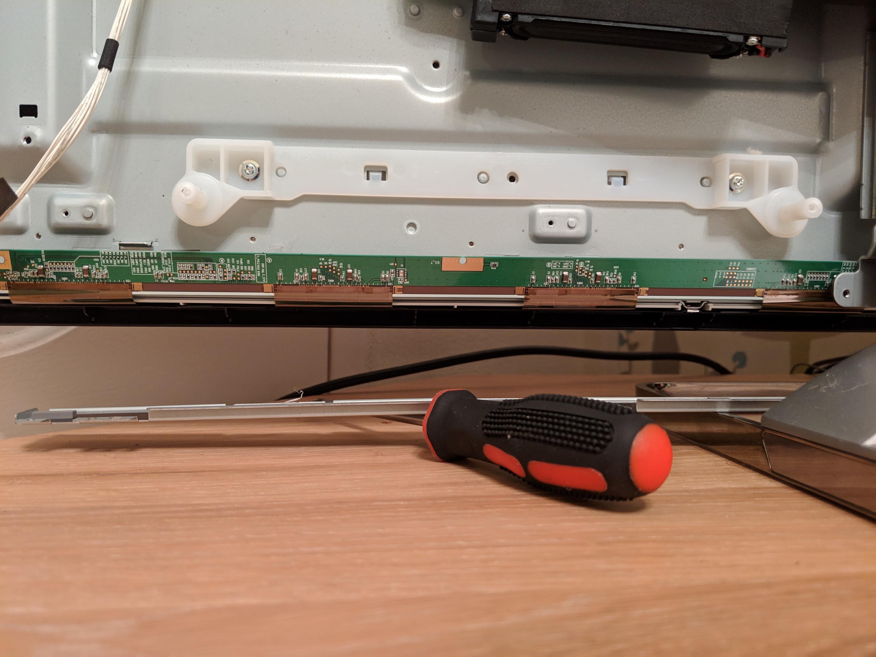

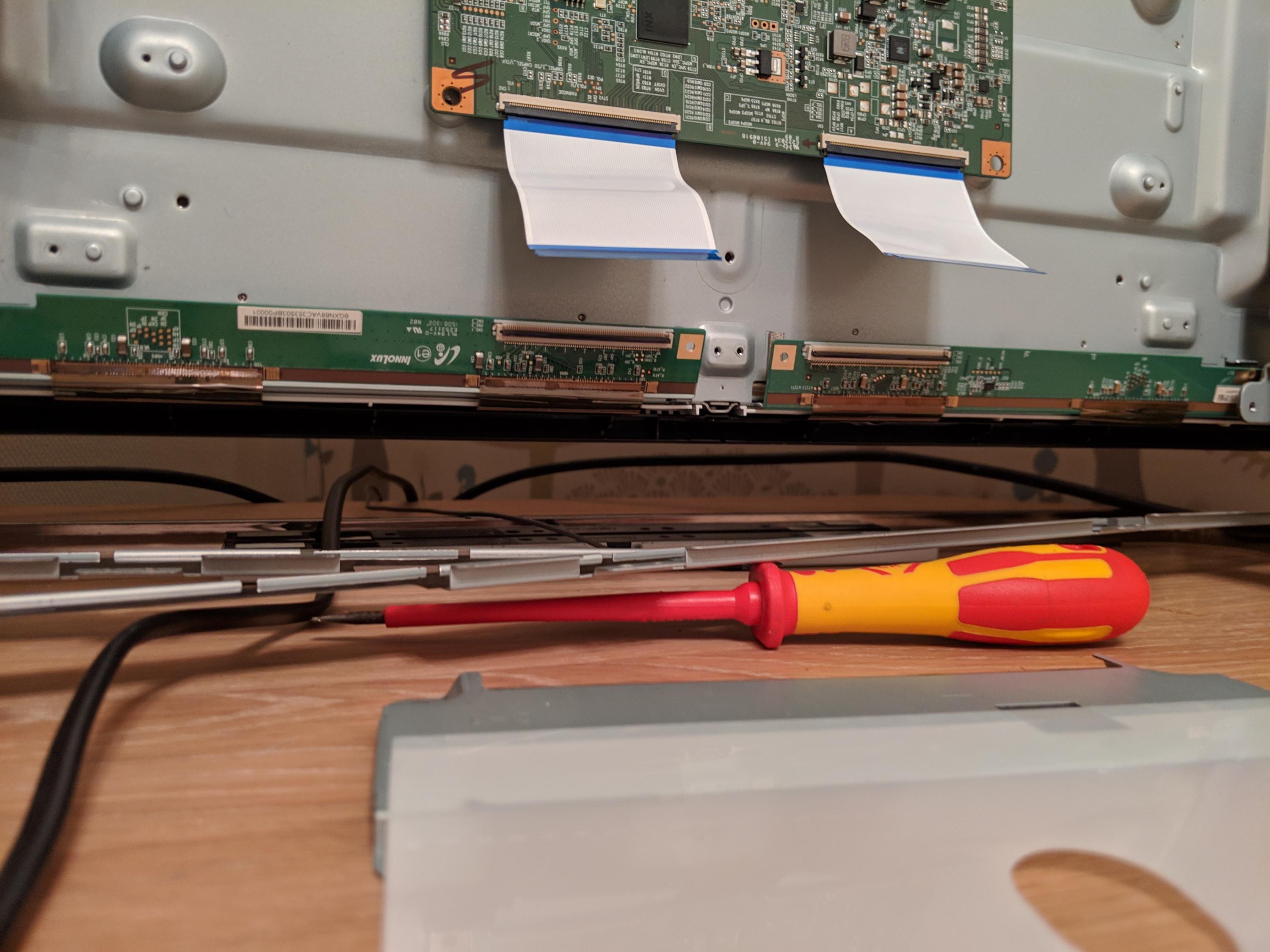

                            Ok guys. I've taken the shield off both drivers to have a good inspection of them. They don't seem to have suffered any water damage. To me it looks ok but your eyes might notice something different. The pins into drivers looked ok also. I might take the bezel off again incase I trapped some tabs when putting it back together a while ago.

                                Underneath the tab bonds, some areas of them look black on the picture. Picture 3 the middle two tabs.

                                  With TV off, plug both white ribbon cables into the TCONN board and the Panel. Check all connections to see if they are straight and tight.
                                  Turn TV on, and feel each gold flex cable GENTLY with your finger tip for excess heat from one of the COF (chip-on-flex) ICs integrated into the gold panel ribbon flex cables... I wonder if one of these ICs has burnt out.

                                      The first one on the right. Directly under the ribbon is considerably hotter than the others

                                        Yep bad COF.
