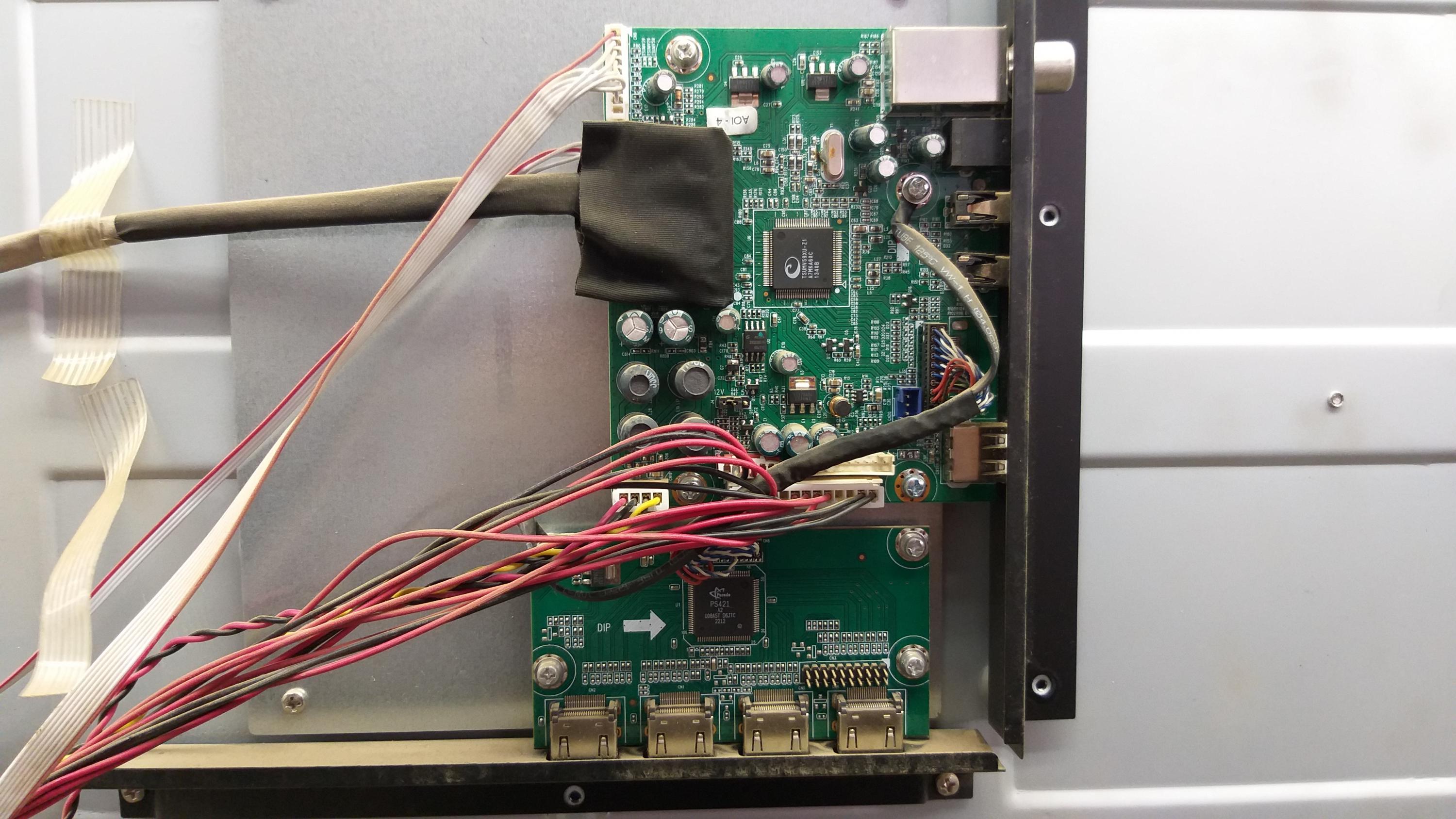

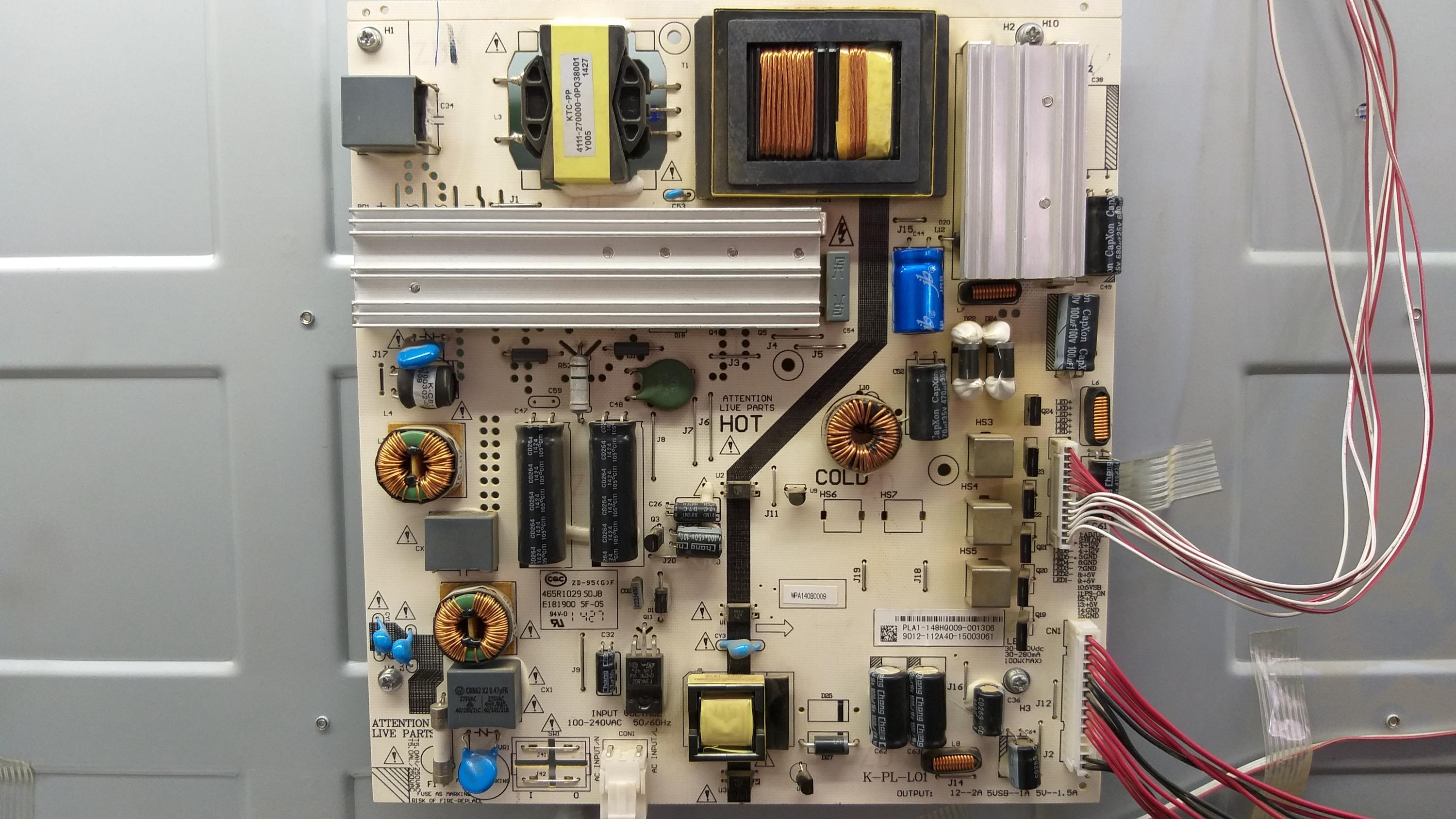

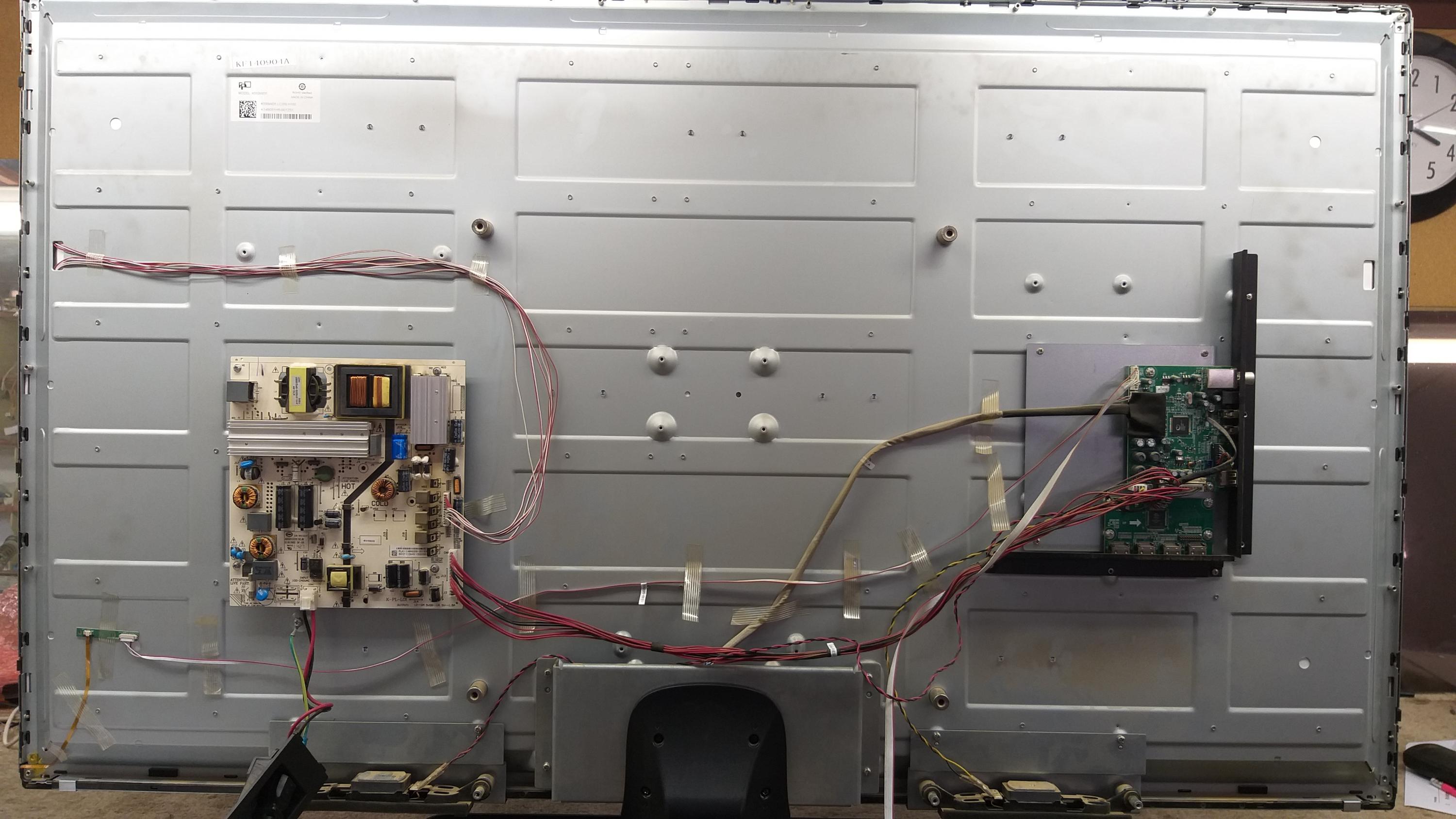

    Hi Guys, i posted this message yesterday and now i cant find it anywhere on the forum so now i am going to repost.
    I have added pictures to assist in your understanding.
    Originally this set would come up bright and back lights would switch off intermittently. I opened up the panel and saw that all the LED's do come on but then at a point thy all just fade off. I checked around the PWM controller and at some point while measuring the LED's went dim. I can still see a blueish light emanating from the rear of the TV and am measuring 38.6V on the LED+ line with respect to chassis gnd. On the 6 LED- lines i get 1.6V.
    Would this indicate a failed power supply or can it be the back lights causing this dim light issue?
    I bought myself a LED backlight tester but i dont know if its a quality unit because it only indicates the LED voltage once connected to a LED string.
    I get LED's brighting up somewhat with a voltage indication of about 41V on the tester.
    My question is is it the power supply or the back lights?

          1) TV OFF, put meter probe on the the two legs of capxon cap C13 (100uf 100V).
          2) Set meter to 200V scale then turn on the TV while watching the meter to see how high it goes up to then wait 10 seconds to see how low it goes down to.
          3) Report the reading.

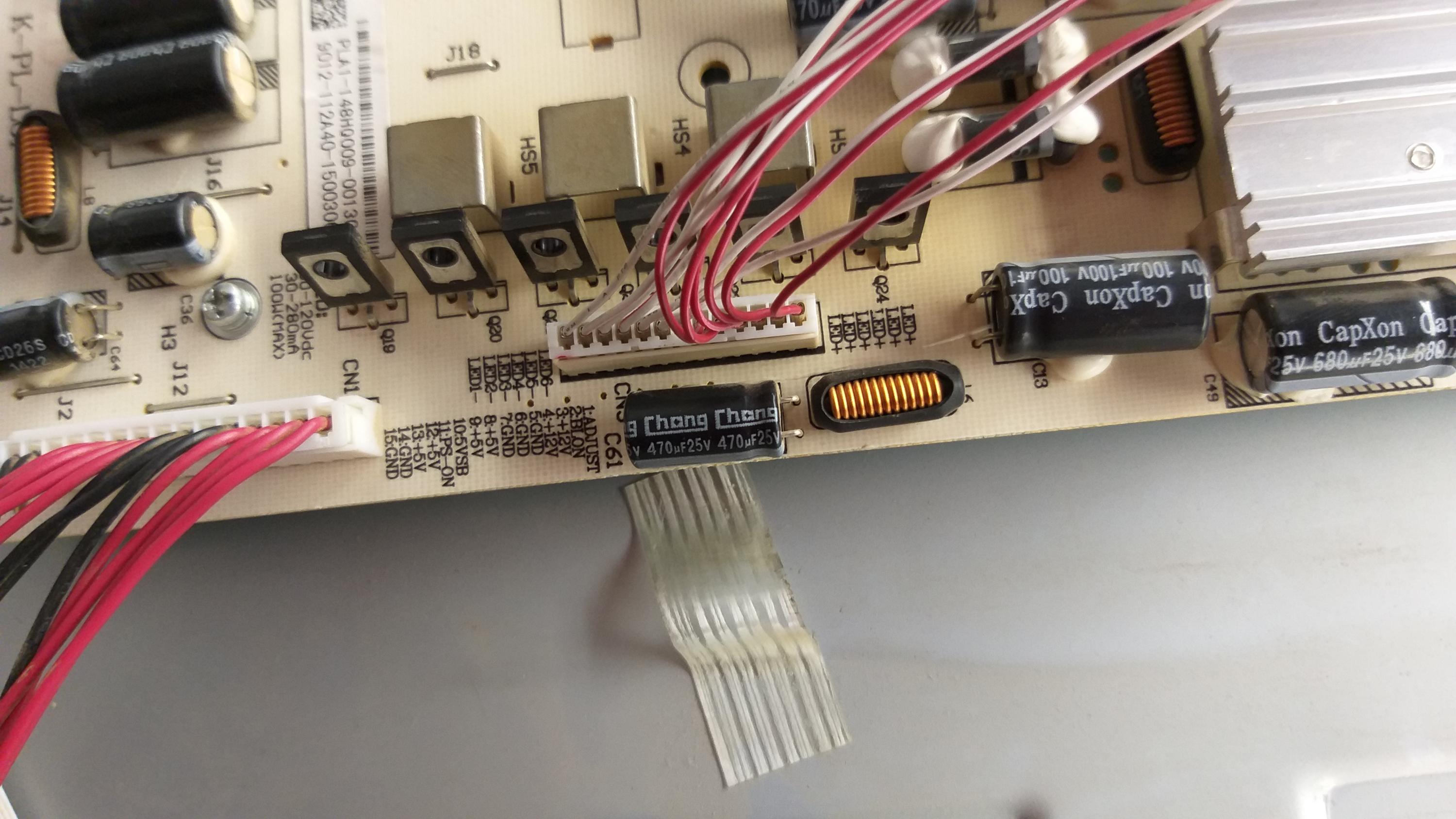

            The test is as follows.
            Set on standby and i press the standby button,
            Initially the voltage goes to 30VDC and then peaks at 38.63V after a few seconds, 10 seconds thereafter the reading remains at 38.6V
            I added additional info you asked for previously.
            The picture DSC0018 is the ADJUST pin as measured on the plug CN1 at about 5VDC
            The picture DSC0019 is the BL-ON pin as measured on CN1 measuring 200HZ at about 5VDC

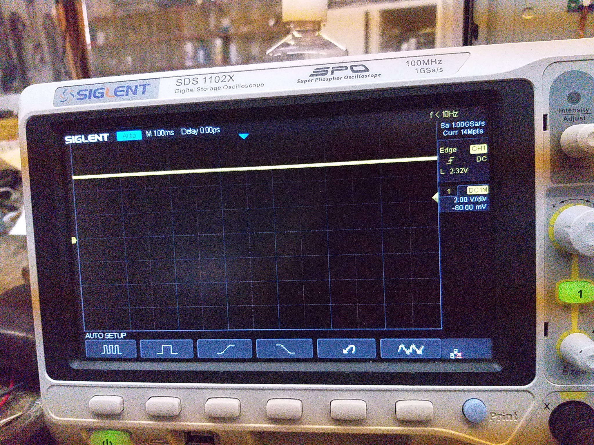

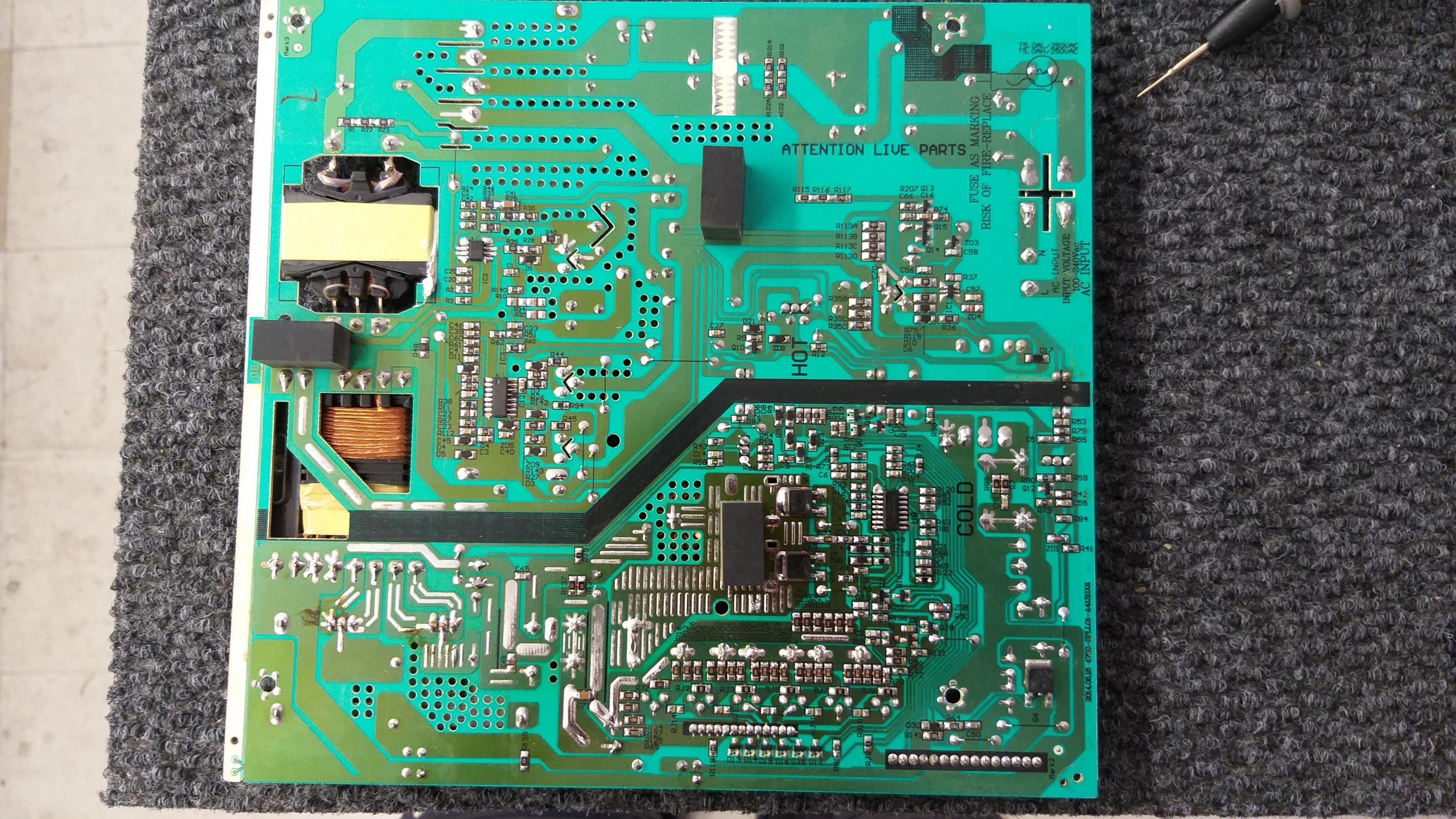

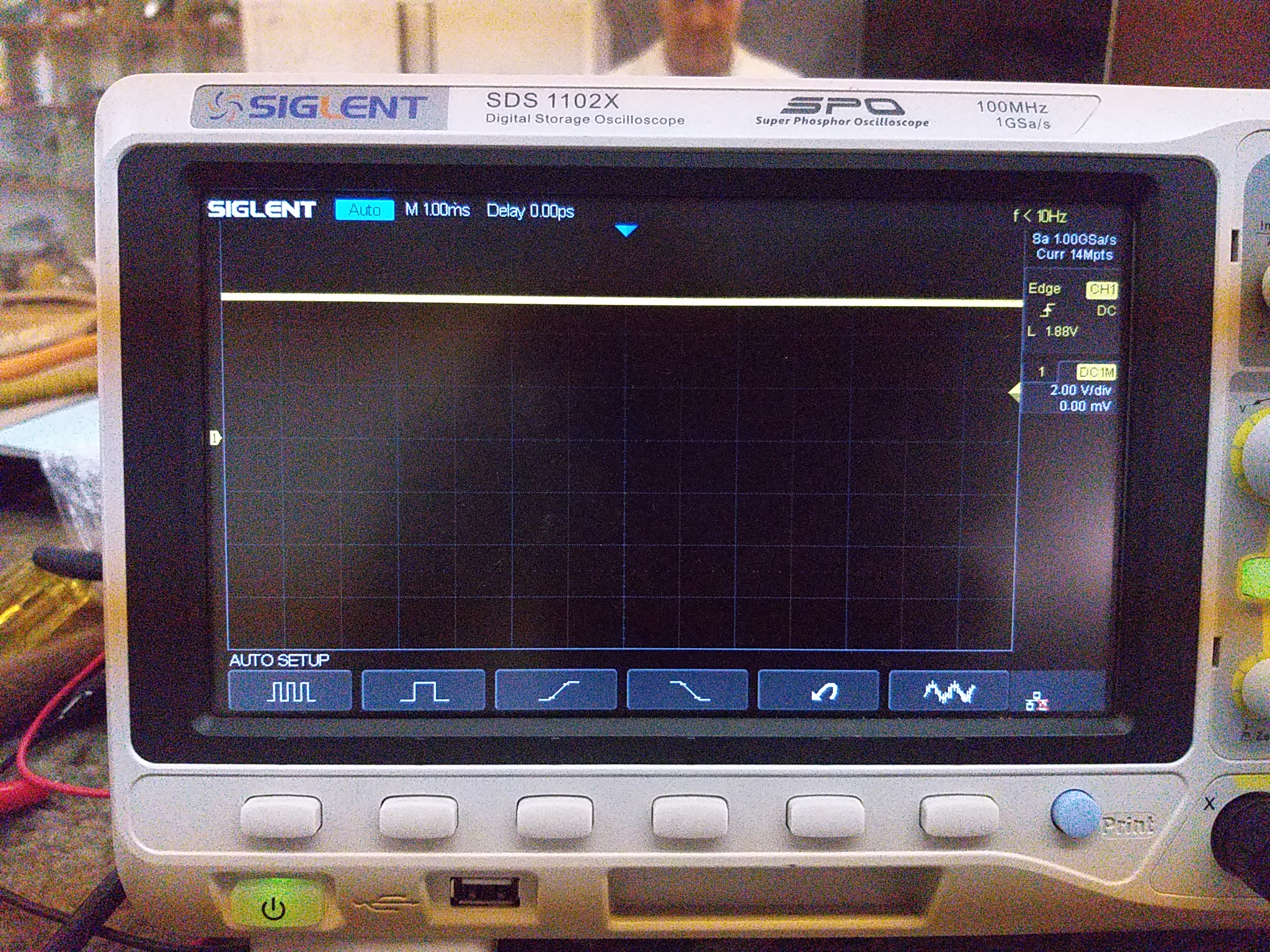

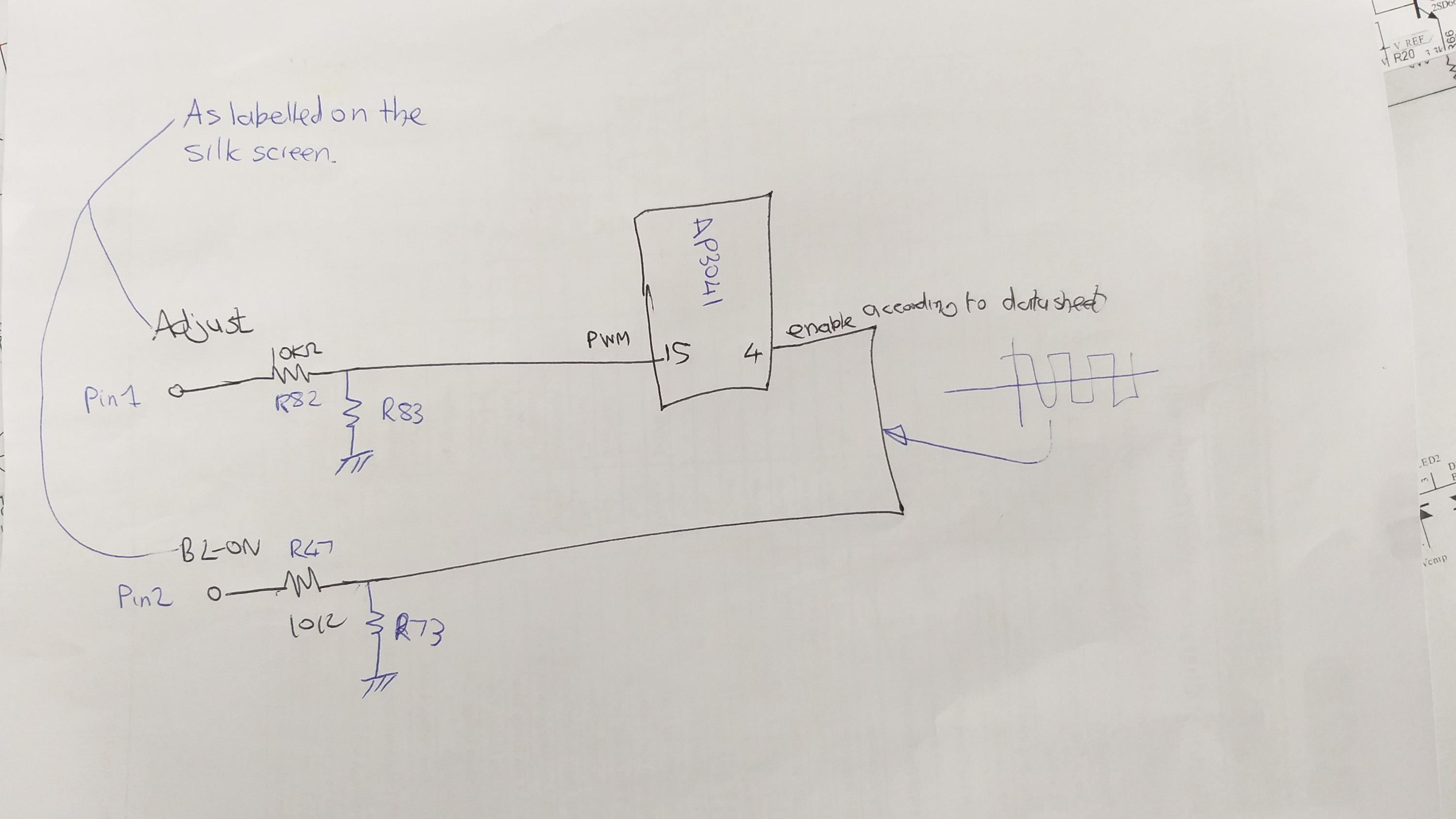

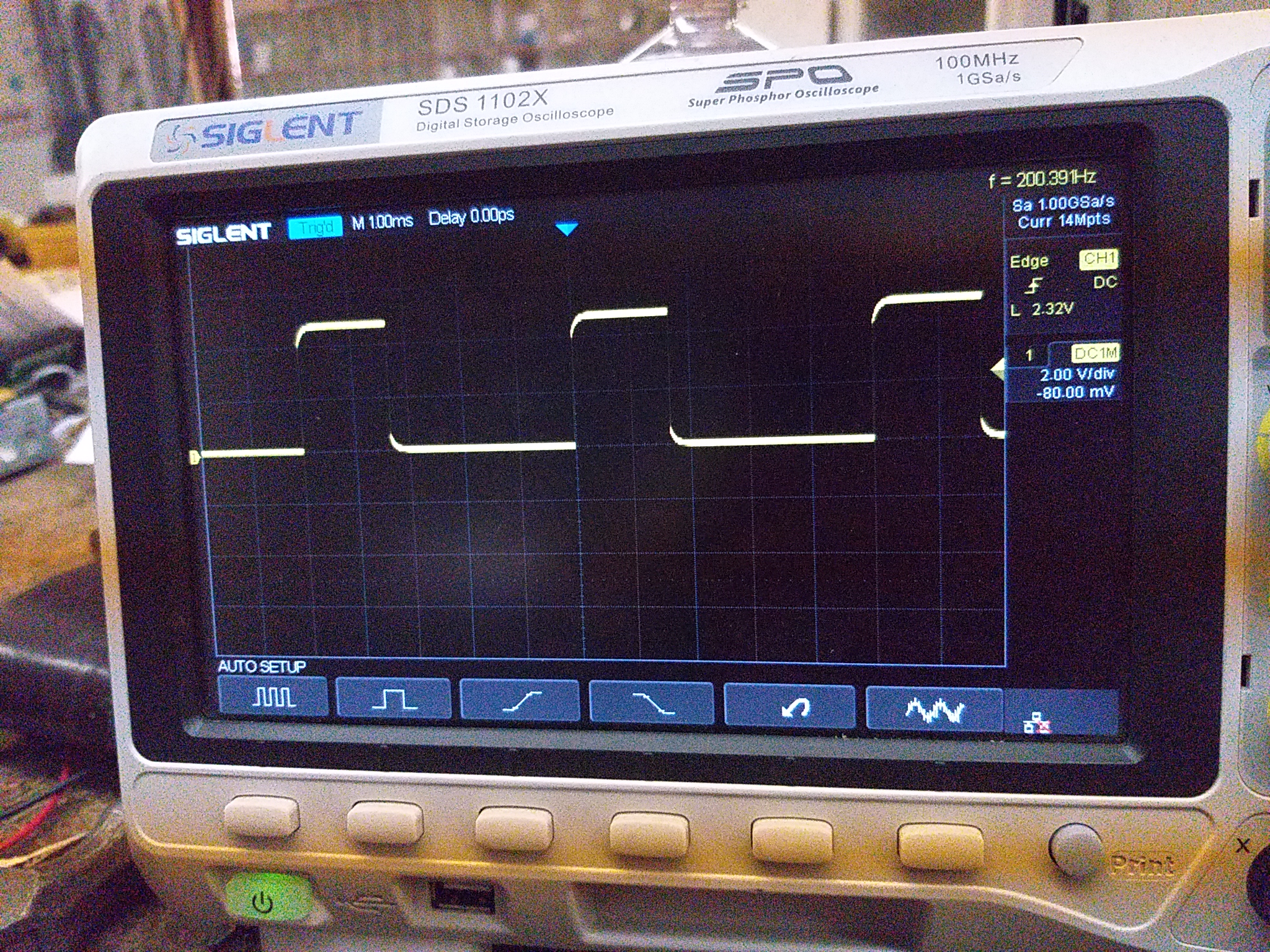

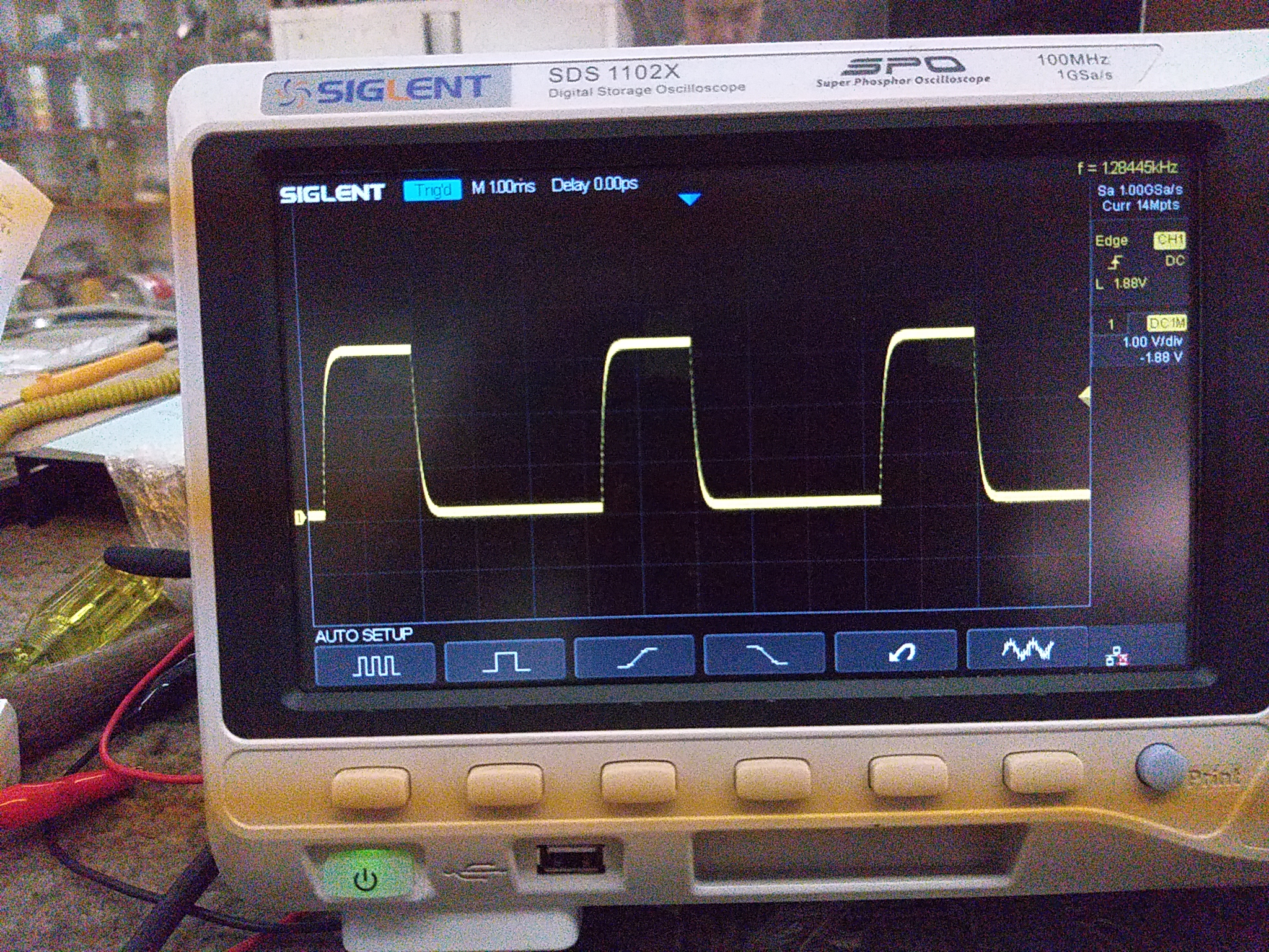

                        This really confuses me but i traced out a simplistic sketch of the two inputs to the AP3041
                        Picture DSC_0020.jpg measured directly on pin 4 of AP3041
                        Picture DSC_0021.jpg measured directly on pin 15 of AP3041
                        I added a simple sketch of how i traced out the diagram. Hope this helps. I am dumb struck.

                          Re: Sansui 55" LCD T V Model STY0955 (Backlight issue)
                          What if someone has swapped the individual conductors on CN1's pin 1 and 2 around. This makes sense to me. Could swapping them around to test cause any damage? Since both are inputs to the AP3041 and the datasheet for the PWM IC shows that it can handle a range of voltage. I means the ENABLE pin is to switch on and off the PWM IC. Should it be doing that at 200Hz?
                            The EN pin needs to see stable high or stable low, if it is switching HI/LO the the IC will be turning on and off. So did some one work on this TV before you?
                              Yes, the warranty seal was disturbed. Its night time now but in 8 hours i can work on this set. Can i swap those two wires? Have i got anything to lose?
                                Yes you can, you need to get EN control signal to be steady HI to enable the IC.
                                  Problem sorted out. TV working. Just monitoring to see for possible intermittent faults. Thanks BudM for your guidance.
                                    Thanks for the follow-up, I wonder why some decide to swap the control signal wires; it makes no sense to me and made me wonder what the original problem was.
