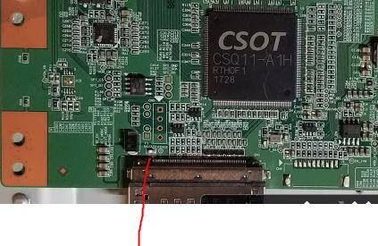

                        • celloyd
                          • Dec 2019
                          • 8
                          Re: Tcl 55S405 bad T-con?
                          Yep plug in hit power see if it's there, fuse should be close to where the cable comes in from the mainboard, on tcon, should be labeled starting with F, like F1 or sum such.
                          I'd like to post a pic and have someone point it out for me? My old eyes are not seeing it.
                          • diif
                            • Feb 2014
                            • 6978
                            • England
                            F1
                            • celloyd
                              • Dec 2019
                              • 8
                              Originally posted by diif
                              F1
                              Thanks!! So I tested it, reads 16v on one side and 0 on the other assuming I am doing it correctly. So tiny that it's hard to know if I'm hitting the right spot. Does this sound reasonable and if so, where do I go from here; what is this telling me?
                                If one end of the fuse shows 0V that means the fuse has blown.
