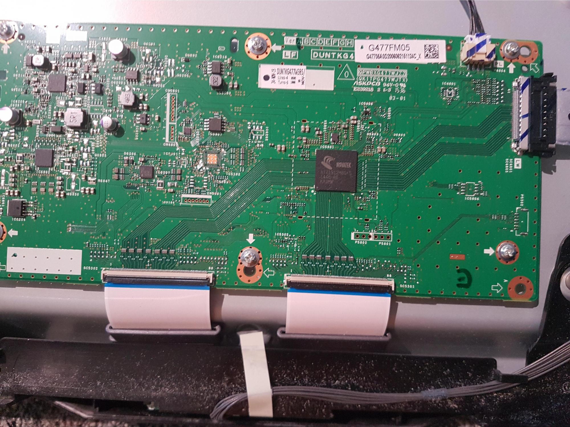

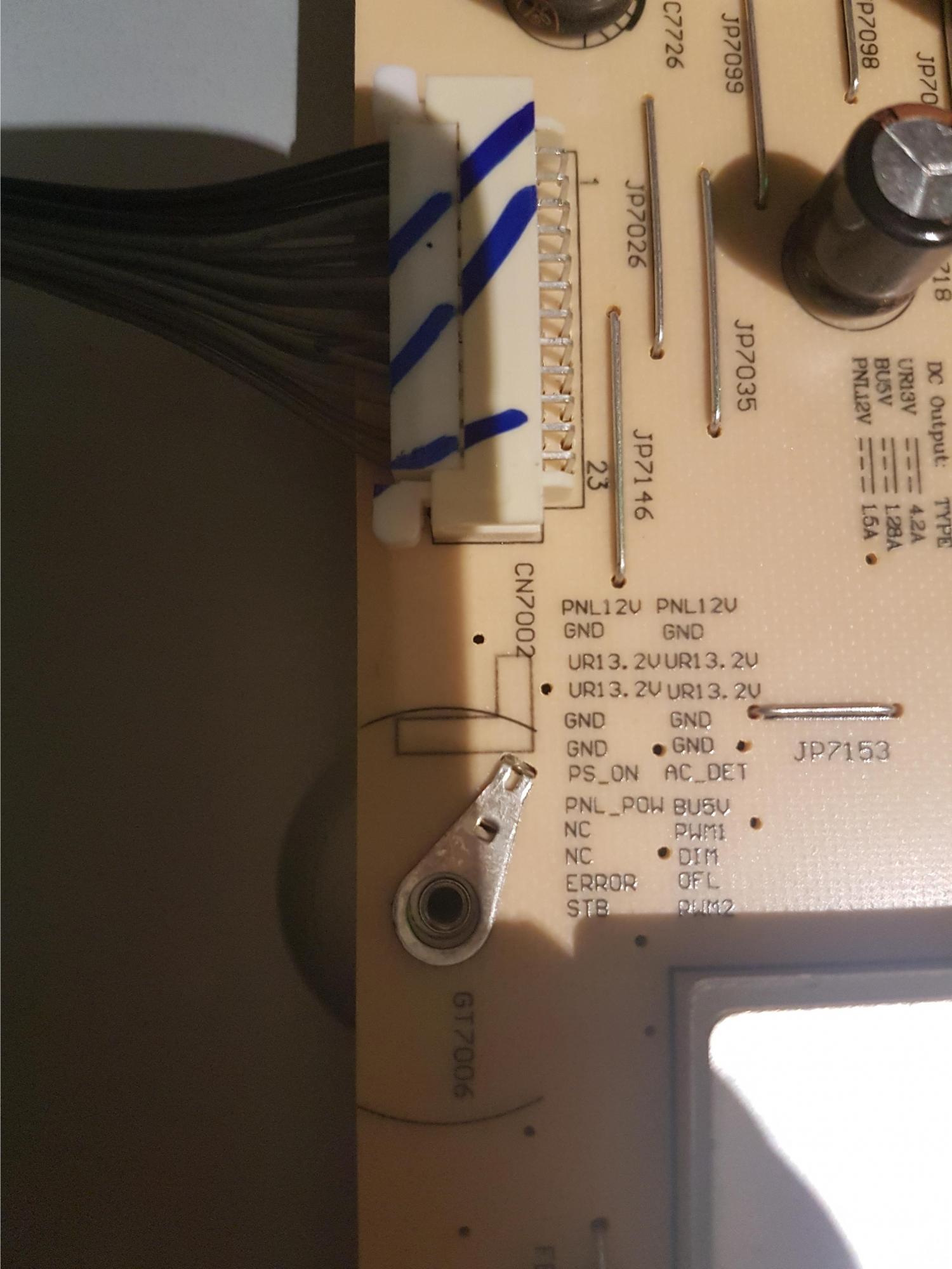

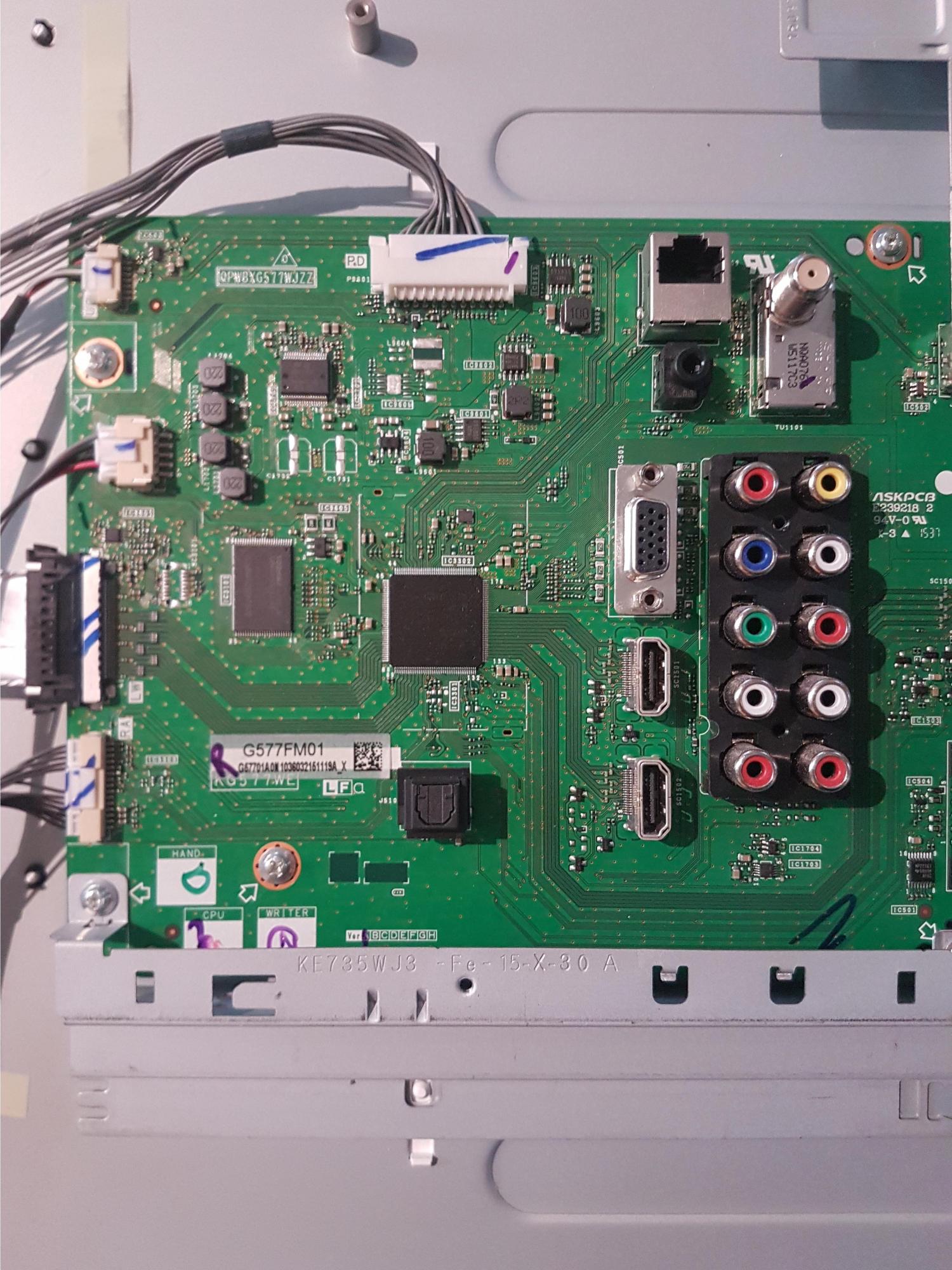

Sharp LC-80LE661U - Power's off after 4 seconds.
  • nomoresonys
    replied
    Re: Sharp LC-80LE661U - Power's off after 4 seconds.
    Make sure you are identifying your pins correctly, you should have around 0 volts on the ground pins.
    Leave a comment:
  • overlyAmbitiousSloth
    replied
    Re: Sharp LC-80LE661U - Power's off after 4 seconds.
    Yes you can usually jumper the powerboard pins they suggest using a resister in case you get the wrong combo, make sure the connector cable between mainboard and powerboard is unplugged when doing this test.
    I see the following labels on the pin label for the cable between the mainboard and the powerboard:
    PNL12V
    GND
    UR13.2V
    UR13.2V
    GND
    GND
    PS_ON
    PNL_POW
    NC
    NC
    ERROR
    STB
    Would it be the PNL_POW pin that I need to short to ground?
    When taking power readings earlier I saw 5V on that pin. What type of resister would I need to use? Or, could I short it directly to one of the GND pins above (was seeing 4.5V on the two ground pins 5th and 6th from the top)?
    Leave a comment:
  • nomoresonys
    replied
    Re: Sharp LC-80LE661U - Power's off after 4 seconds.
    Yes you can usually jumper the powerboard pins they suggest using a resister in case you get the wrong combo, make sure the connector cable between mainboard and powerboard is unplugged when doing this test.
    Leave a comment:
  • overlyAmbitiousSloth
    replied
    Re: Sharp LC-80LE661U - Power's off after 4 seconds.
    Try unplug tv from power outlet, disconnect cable from mainboard to powerboard, plug power cord back in turn it on, see if backlights come on and stay on.
    Tried but didn't turn on when I applied power. This may be a stupid question but is there a pin on the powerboard I can short to ground or something to feed it a 'power on' signal?
    Originally posted by budwich
    In addition to those tests, you can try disconnecting the tcon to panel cables, one at a time, and see if that changes the results (of course the disconnect / connect is done without power on).
    When I disconnected the large ribbon cables, one at a time, and powered on half of the screen was solid white (pictures attached).
    For shits and grins I started disconnecting different cables, one at a time, and powering back on. Wifi, IR receiver, speakers, button pad, data cable from main board to tcon, all didn't make any difference (well the last one stopped Sharp from displaying). Then I pulled the power cable to the tcon board and noticed the standby light flashing at longer intervals. Its not like a dot-dot-dash sequence or anything just longer dashes, if that makes sense. Was kind of expecting an error code when a main component is missing / not getting power. Is that normal?
    Anyway, thanks for the suggestions guys and please keep em coming.
    PS - It looks like there's an RS232 console port on the side of the mainboard. Does anyone know anything about that? I don't have a female to female serial cable or I would trying connecting to it. Being that it only powers on for a few seconds I doubt I'd be able to do much aside from maybe a receive a quick dump of a POST or something.
    Leave a comment:
  • overlyAmbitiousSloth
    replied
    Re: Sharp LC-80LE661U - Power's off after 4 seconds.
    Originally posted by ajshoe
    first guess would be main board.
    Is that a common symptom of a dead/dying main board? If so, is it even worth troubleshooting components on the board or just replace the whole thing?
    Originally posted by budwich
    In addition to those tests, you can try disconnecting the tcon to panel cables, one at a time, and see if that changes the results (of course the disconnect / connect is done without power on).
    Thanks for the suggestion budwich, I'll give this a shot as soon as I get home this evening and check back in with results.
    Try unplug tv from power outlet, disconnect cable from mainboard to powerboard, plug power cord back in turn it on, see if backlights come on and stay on.
    Thanks for the suggestion nomoresonys, I'll give this a shot as soon as I get home this evening and check back in with results.
    Leave a comment:
  • overlyAmbitiousSloth
    replied
    Re: Sharp LC-80LE661U - Power's off after 4 seconds.
    Originally posted by budm
    You need to put down the pin name for each pin and follow by the Voltage reading so we can easily see what each pin is.
    My bad, didn't even think to do that (I've attached a picture of the power board that lists pin names, not sure if I'm reading it properly but I've referenced the PIN names in the left column)-
    TV OFF/Stand-By
    PNL12V - 0.3v
    GND - 0
    UR13.2V - 1.214v
    UR13.2V - 1.213v
    GND - 0
    GND - 0
    AC_DET - 0
    BU5V - 5.04v
    PWM1 - 0
    DIM - 6.4v
    OFL - 0
    PWM2 - 0
    TV ON – power applied
    PNL12V - 11.88
    GND - 3.8
    UR13.2V - 13.12
    UR13.2V - 13.14
    GND - 4.5
    GND - 4.5
    AC_DET - 3.331
    BU5V - 5.03
    PWM1 -1.427
    DIM - 1.294
    OFL - 1.427
    PWM2 - 1.427
    Leave a comment:
  • nomoresonys
    replied
    Re: Sharp LC-80LE661U - Power's off after 4 seconds.
    Try unplug tv from power outlet, disconnect cable from mainboard to powerboard, plug power cord back in turn it on, see if backlights come on and stay on.
    Leave a comment:
  • budwich
    replied
    Re: Sharp LC-80LE661U - Power's off after 4 seconds.
    In addition to those tests, you can try disconnecting the tcon to panel cables, one at a time, and see if that changes the results (of course the disconnect / connect is done without power on).
    Leave a comment:
    replied
    Re: Sharp LC-80LE661U - Power's off after 4 seconds.
    You need to put down the pin name for each pin and follow by the Voltage reading so we can easily see what each pin is.
    Leave a comment:
  • ajshoe
    replied
    Re: Sharp LC-80LE661U - Power's off after 4 seconds.
    first guess would be main board.
    Leave a comment:
  • Sharp LC-80LE661U - Power's off after 4 seconds.
    Howdy Folks,
    This is my first time posting with an issue so I'm including as much info as I can (whether it turns out useful or not). I don't have any experience troubleshooting LCD TV's so I'm hoping someone out there can give me some tips or maybe point me in the right direction (even if its a 'RTFM nuub' if there's a link attached).
    I've got a Sharp LC-80LE661U model TV that powers on, displays the SHARP logo and then promptly turns off after about 4 seconds. There isn't anything displayed onscreen other than the logo. I've tried button combinations to perform a factory reset, I've tried opening menu's as soon as it powers on, I've tried different video inputs... but I never see anything other than the Sharp logo. And then the screen flashes for a split second and shuts down.
    Once it powers down I see the standby light illuminate on a steady interval (unfortunately, no error code is being passed).
    Popping the thing open I see what you would expect, power board, processor board and a t-con board. I know nothing about troubleshooting these guys so I took a close look at each and am not seeing what looks like failed components (at least nothing crispy, bulging or leaking). Then I busted out the volt meter and the readings I'm getting, I think, don't sound waaay off (at least based on what was printed on the power board).
    Power board is a RUNTKB380WJQZ and I'll include a shot of what the voltages should be based on whats referenced on the PCD.
    TV OFF - power applied
    1- 0.3v
    2- 0
    3- 1.214v
    4- 1.213v
    5- 0
    6- 0
    7- 0
    8- 5.04v
    9- 0
    10- 6.4v
    11- 0
    12- 0
    TV ON – power applied
    1 - 11.88
    2 - 3.8
    3 - 13.12
    4 - 13.14
    5 - 4.5
    6 - 4.5
    7 - 3.331
    8 - 5.03
    9 -1.427
    10 - 1.294
    11 - 1.427
    12 - 1.427
    Not sure where to go from here. I hate throwing parts at a problem until its fixed so any advice would be more then appreciated.
    Thanks Folks,
    Jon
  • ResoluteHawk
    Alienware 17 R3 (LA-C912P) Powers on then powers off after 4-6 seconds
    by ResoluteHawk
    I have an Alienware 17 R3 (board is a C912P) that I recently starting trying to repair. Originally the issue was the charger going into protection mode when plugged in to the laptop. I found a short on the motherboard (one of the capacitors on the back of the board under the DRMOSes for the CPU) and the charger when plugged in now doesn't go into protection mode anymore. The laptop powers on, the lights on the keyboard, alien head, and alienware logo light up, and the fans spin. The issues are:
    1) The battery doesn't charge. I've probed the charger jack and it's only receiving 0.633v...
    06-17-2022, 01:04 PM
  • survivalbloke
    ASUS TUF 506 powers off after about 10 seconds due to heat
    by survivalbloke
    This laptop come in with liquid damage. I located a couple areas on the board which honestly didn't look bad at all. I ISA them and cleaned up - can't even tell anything happened. However, when I power up the computer, it will shut off after about 10 seconds. I discovered it seemed like the fans weren't coming on because the board was getting mad hot right around the battery charging mosfets and coil. Anyhow, I checked under the thermal camera with just the power adapter connected but the machine off. I have marked what is warm at that time. Once I power it up, the coils near CPU vcore start heating...
    08-07-2023, 02:23 PM
  • survivalbloke
    Dell laptop powers up with kb backlight about 10 seconds, then shuts off
    by survivalbloke
    I've got a Dell Latitude 5580 which came in for no power. It's not exactly a no power issue though. The battery was puffy so I replaced that, but the symptom is that when the power button is depressed, the keyboard backlights will come on for about 10 seconds then go back off. Before depressing power button, I am drawing 112ma and oddly, there is no change in current draw once the button is pressed and the keyboard backlights illuminate.
    Any ideas?
    01-08-2024, 12:12 PM
  • zklgfs
    Anker SoundCore 2 Bluetooth Speaker Turns Off After a Few Seconds (Possibly Firmware Issue?)
    by zklgfs
    I have an Anker SoundCore 2 (A3105) that I saved from the trash (well, I guess there's a reason why it was supposed to go into the trash...). The problem is that it always turns off after a few seconds (sometimes it stays on a bit longer, between 30 and 60 seconds, but it still turns off). The power light turns on and the bluetooth light starts blinking, but both abruptly turn off again. The "turn off sound" is still played after the lights turn off. Sometimes, it also loops the on-off cycle several times without me pressing any buttons. If I connect an AUX cable, music...
    08-11-2025, 02:14 PM
  • twonk9098
    Lenovo Legion 5 high fan spin turns off after 34 seconds
    by twonk9098
    I have a Lenovo Legion 5 with a Ryzen 7 series CPU and RTX 3070 GPU. My issue is that it turns on and all seems fine except after a few seconds the fans spin up high and the laptop turns off after 34 seconds.
    I can get into bios and can even boot and login to Windows however after 34 seconds no matter if Im at the bios screen or booted into Windows it will just turn off.
    I have managed to run HWmonitor and the temperatures of the CPU and GPU are fine, I can also touch the heatsync which is warm but not hot.
    I have tried a few new bios but exactly...
    07-14-2024, 11:19 AM
