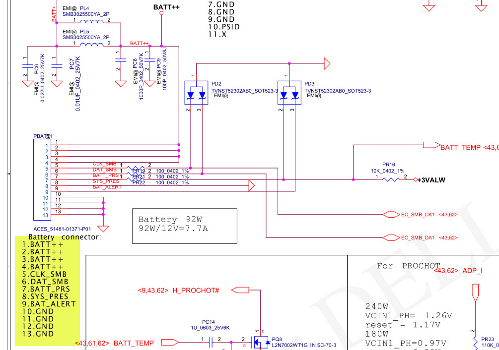

              BattInfoView shows that the battery is at 100% health and the charge/discharge rate is 0mv.
              I then probed the battery port on the motherboard and checked that it gets the battery's rated 14.8 volts. It gets 14.4 volts.
              The issue is that the battery is not charging at all but the charging light works as it should to indicate the battery is receiving charge when the laptop is turned off.
              In the BIOS the AC adapter is detected and it also shows that "The battery is performing normally."

                Re: Alienware 17 R3 (LA-C912P) Powers on then powers off after 4-6 seconds
                Measure the voltages on the battery connector with the battery REMOVED.
                Post the measurements.
                • ResoluteHawk
                  • Nov 2021
                  • 154
                  Pin 1 => 0.223v
                  Pin 2 => 0.223v
                  Pin 3 => 0.223v
                  Pin 4 => 0.223v
                  Pin 5 (CLK_SMB) => 3.364v
                  Pin 6 (DAT_SMB) => 3.364v
                  Pin 7 (BATT_PRS) => 3.364v
                  Pin 8 (SYS_PRES) => 0v
                  Pin 9 (BAT_ALERT)=> 0v
                  Pin 10 (GND) => 0v
                  Pin 11 (GND) => 0v
                  Pin 12 (GND) => 0v
                  Pin 13 (GND) => 0v

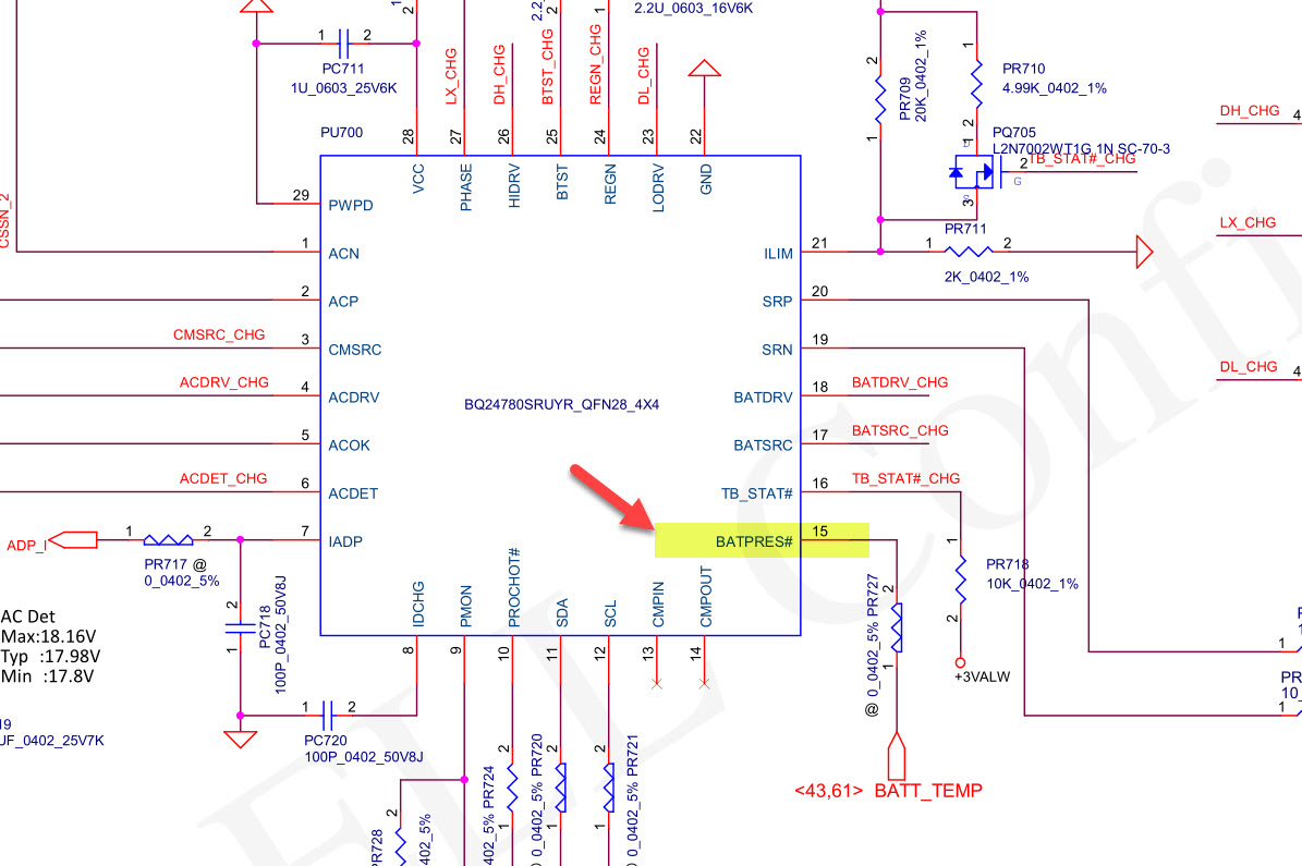

                    What is the voltage (still WITHOUT a battery) on pin # 15 of PU700 (charger) IC ?
                    Measure with care so the meter leads do not slip.
                    Meter in DC volts mode; 20v scale is ok.
                    Red meter lead on pin # 15 of PU700; black meter lead to ground.
                    See attached.
                      3.362v at pin 15 without the battery connected
                        What is the voltage of
                        ACDET (pin # 6) on PU700 ?
                        Next, configure the meter into DIODE mode.
                        Remove all power.
                        Red meter lead (yes, RED) to GROUND.
                        Black meter lead to pin # 5 (CLK) of the battery connector. Reading ?
                        Then black meter lead to pin # 6 (SDA) of the battery connector. Reading ?
                        • ResoluteHawk
                          • Nov 2021
                          • 154
                          Pin 6 (PU700) WITH or WITHOUT a battery connected => 2.6v
                          All power out
                          Red on ground, black on pin 5 (CLK), DIODE mode => 0.686 voltage drop
                          Red on ground, black on pin 6 (SDA), DIODE mode => 0.635 voltage drop
