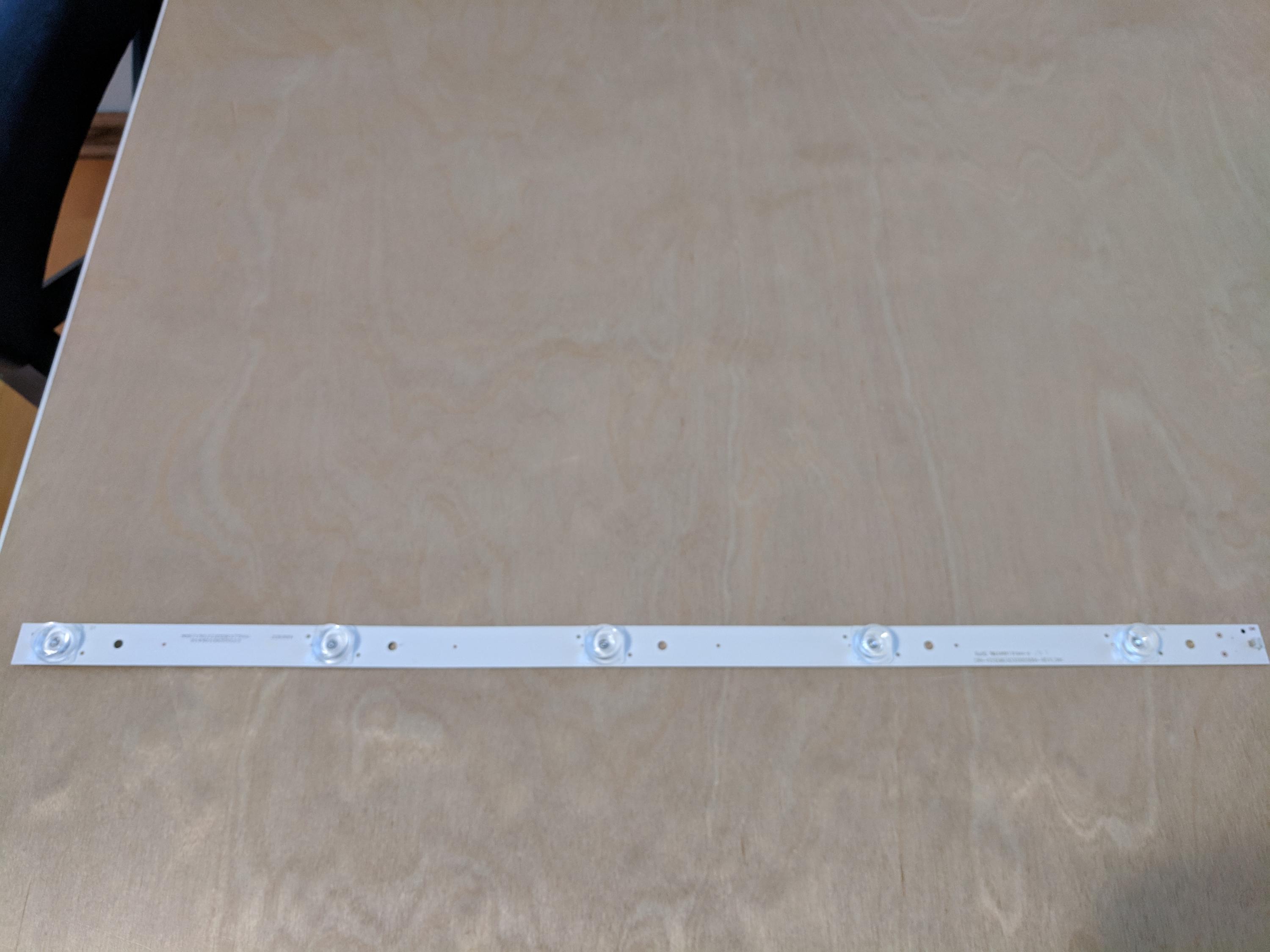

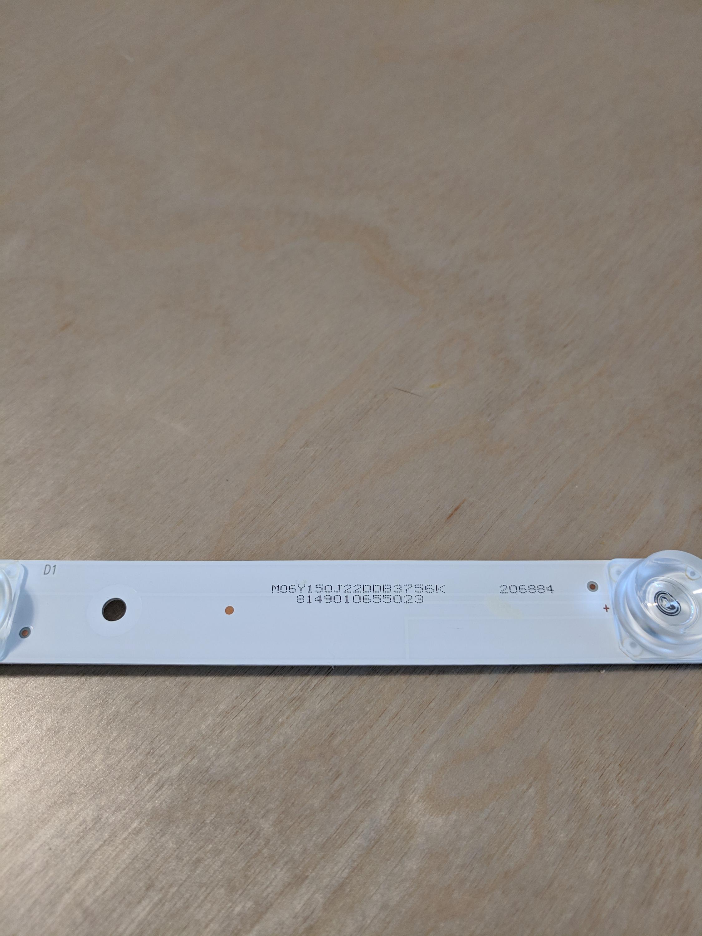

      You need to know the Forward Voltage (Vf) rating, the current rating, and the footprint I.E large solder pad is Anode or Cathode.
      You need to remove the bad one and look at the solder pad, you can also measure Vf.
      Current rating of 400mA is typical for backlights application.
      Pictures of your LED's?
      LED strip P/N?
      Dimension?

        Okay so size is 3mmx3mm, large pad is - small pad is +. As for current or voltage there is nothing printed on any of the LED strips for it and there is nothing I can see on the power board that indicates either value.

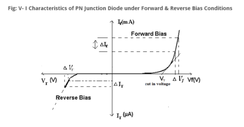

                  Set meter to diode mode, the 3V LED will dimmly lights up and look at the readout on the meter, the 6V probably will not due to meter does not have high enough potential Voltage to bias on 6V LED.

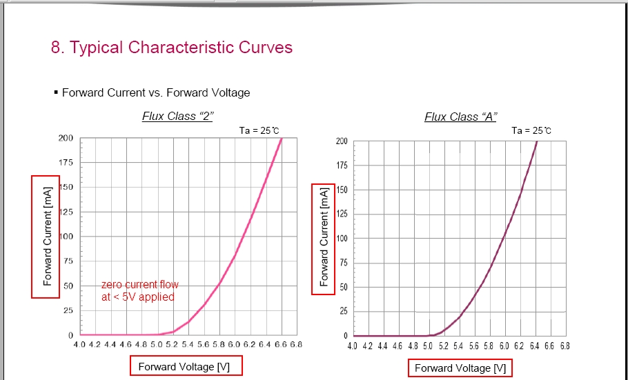

                      If meter can forward on the 6V LED (Vf will be much lower at low current which the meter is limited to, so the readout on the meter will be <6V, the meter in diode mode will show Vf of the semiconductor. So the 3V LED may show something like 2.7V on the meter. Easy enough for OP to use his meter to test his working LED to verify, no t hard to do, is it? The spec of the meter will also show what the output limit is in diode mode.
                      LG 3030 Dual-LED.

                          "VF here in TV don't play any roll" What do you mean Vf of LED does not play any roll?
                          OP just have to use his meter in diode mode and report what the Vf shows on the meter. If is is single 3V LED it should show something on his meter in diode mode.Why just not wait and find out the result from OP?
                          BTW, my FLUKE 87 uses 9V Battery, in Diode mode it has open circuit of 3.50VDC, and 1mA (shorted current).

                              Re: Ordering SMD LED for backlight
                              Sorry I am just too stupid to understand that you have to have enough Voltage potential on the semiconductor to bias it on for it to start conducting current. BTW, you use curve tracer before, correct?
                              BTW, I only from 1978 ~ 1986 at Fairchild Semiconductor Discrete Division which makes Transistor, MOSFET, Diode, and LED.
                              Please look at the VF/If chart of the LG spec I provided.

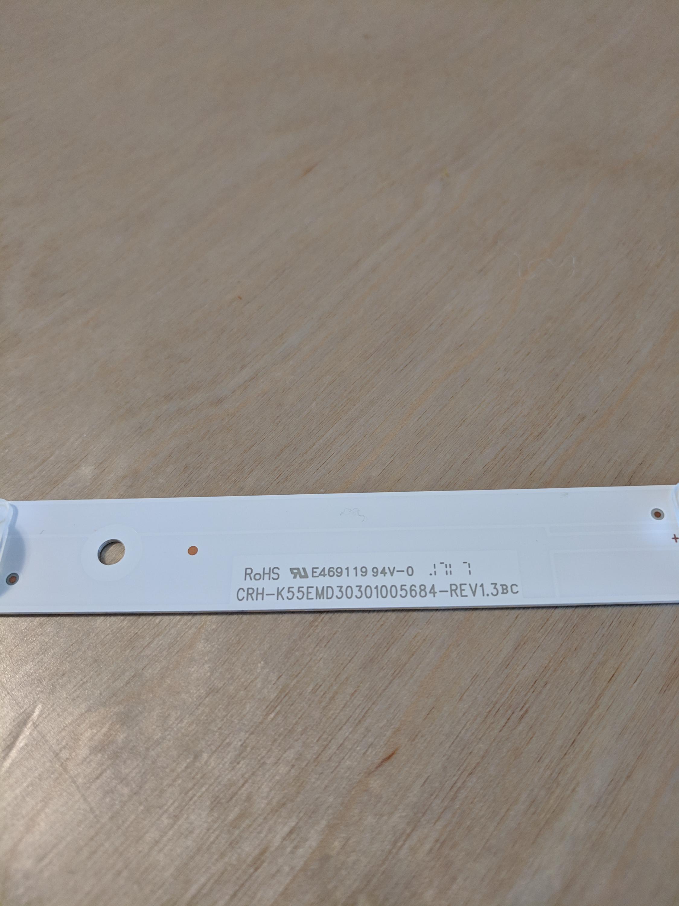

                                        That is why you are getting 252V because there is no load due to open circuit, that is how it will react when no load is present for constant current power supply source.
                                        Can we see good clear pictures of the power supply/LED driver board?
                                        How many are there on the LED connector?
                                        LCD panel number?
                                        BTW what does it show on your meter when you check 1 LED with your meter in diode mode?
                                        If you look at the LED Vf VS If I porvided for the LG LED, Vf is a 6.5V at 175mA so total Vf of the LED string (if all 50 LED's are connected in series o form one large LED string) will be 6.5V x 50 LED's = 325V + the Vdrops on the PWM Control MOSFET on the low side for maintaining constant current (25 ~ 30V is typical, it will vary with the current) and on the current sensing resistor.
                                        LED strip P/N CRH-K55EMD30301005684
                                        https://www.shopjimmy.com/haier-crh-...-strips-10.htm
