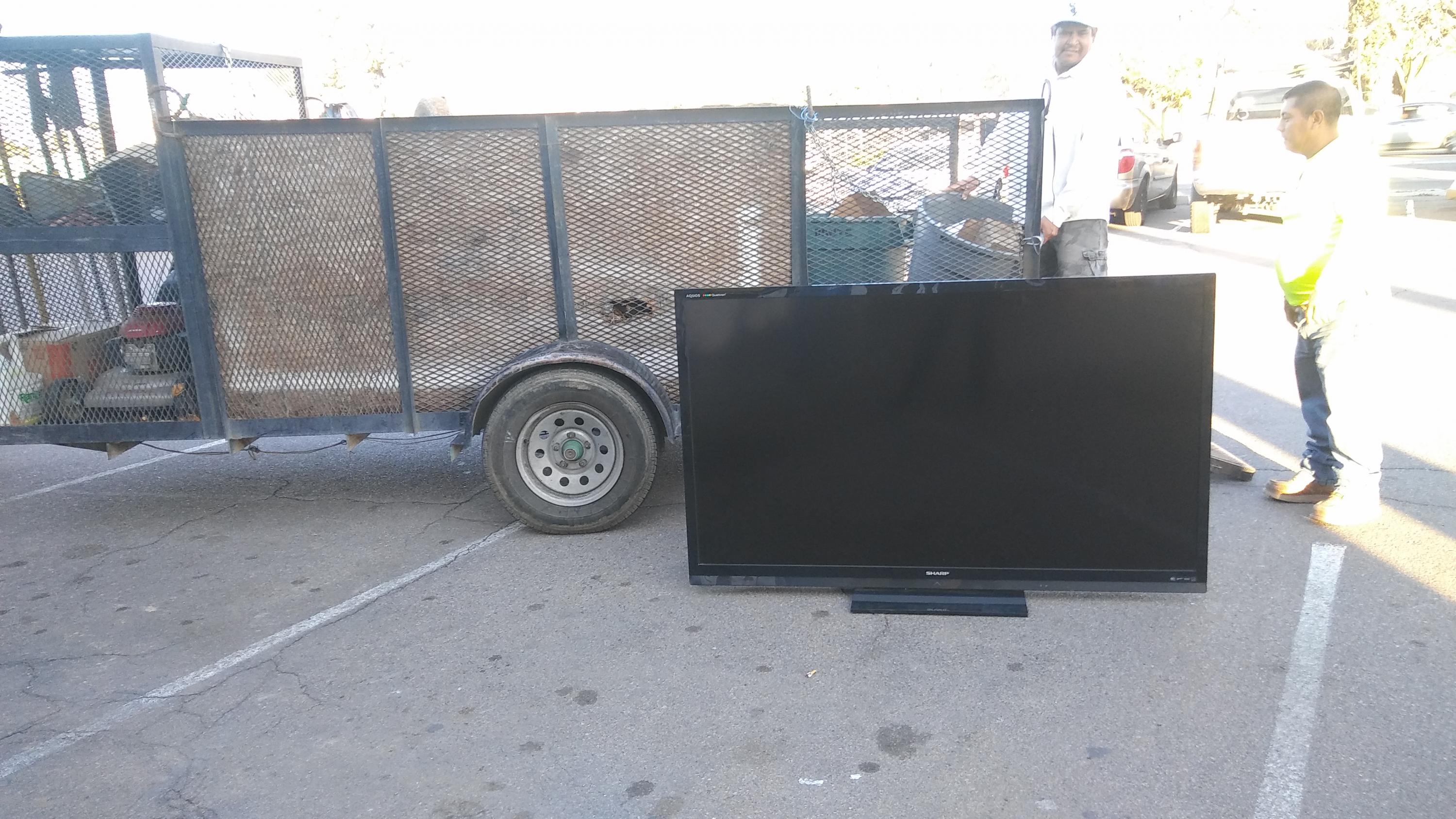

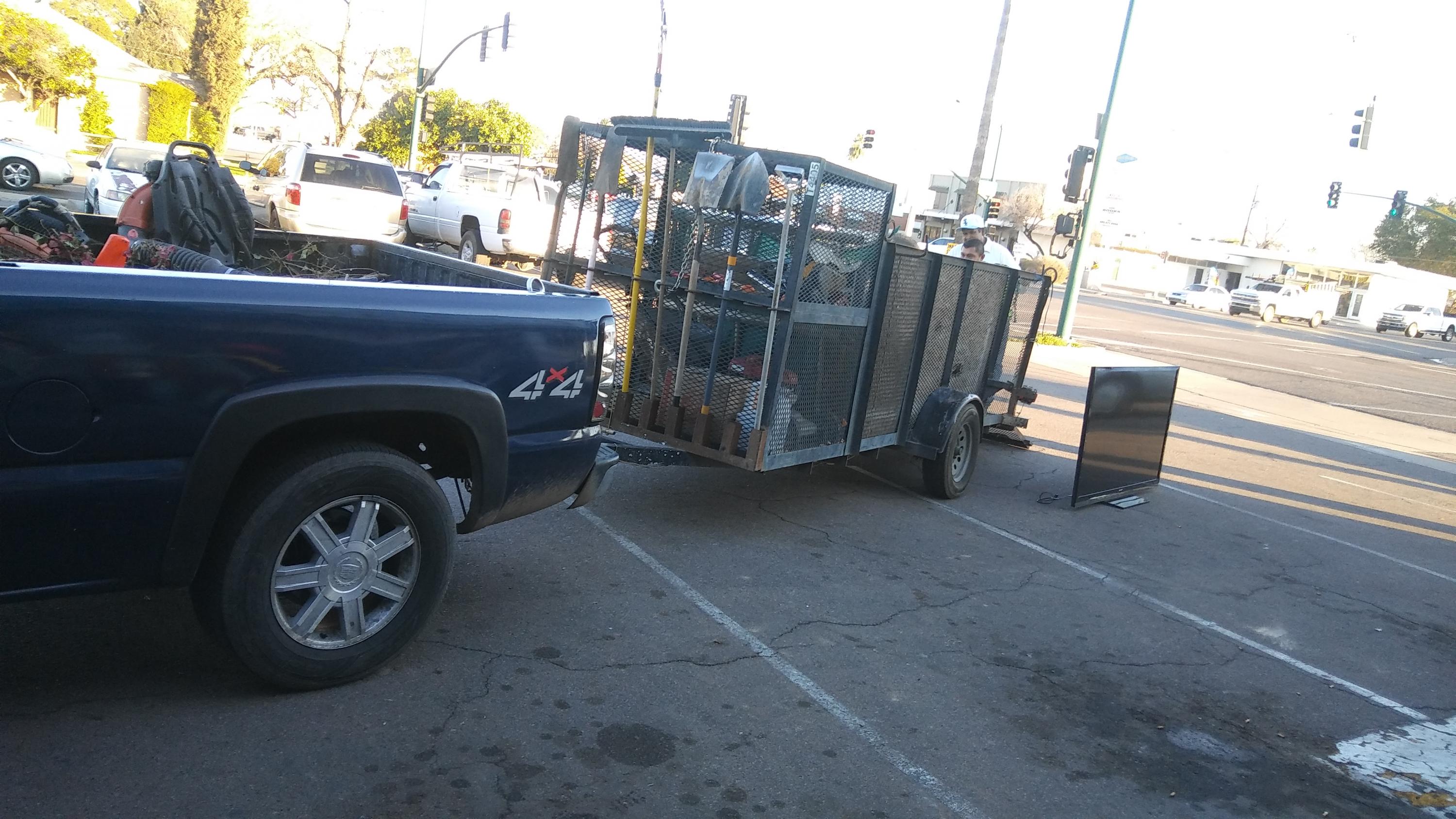

    I've had a very bad experience with this kind of Sharp TV.
    I let customer know maybe it is the screen problem or it is the backlight problem it's not worth to repair so I charge $40 to check and reset the tv. And teach the customer how to reset the TV.
    Customer is a landscaper, hard worker. Let this Shap TV last a little bit longer then you go buy a new 4K TV. I said.
    My question is am I a chicken? I need to put food on the table. l don't have time to mess around with this TV. Am I right or wrong?

      Sharp LC-70LE733U 1/1 won't turn on when i press power, volume down and channel down TV works. I don't know how long TV will last. customer needs to keep on doing this for TV to work.
      i bail out the job.....I spend a lot of time on this kind of Sharp TVs and they never work right....all end up redo then give up....I never could fix one will last one year. i give up repair sharp tv.
