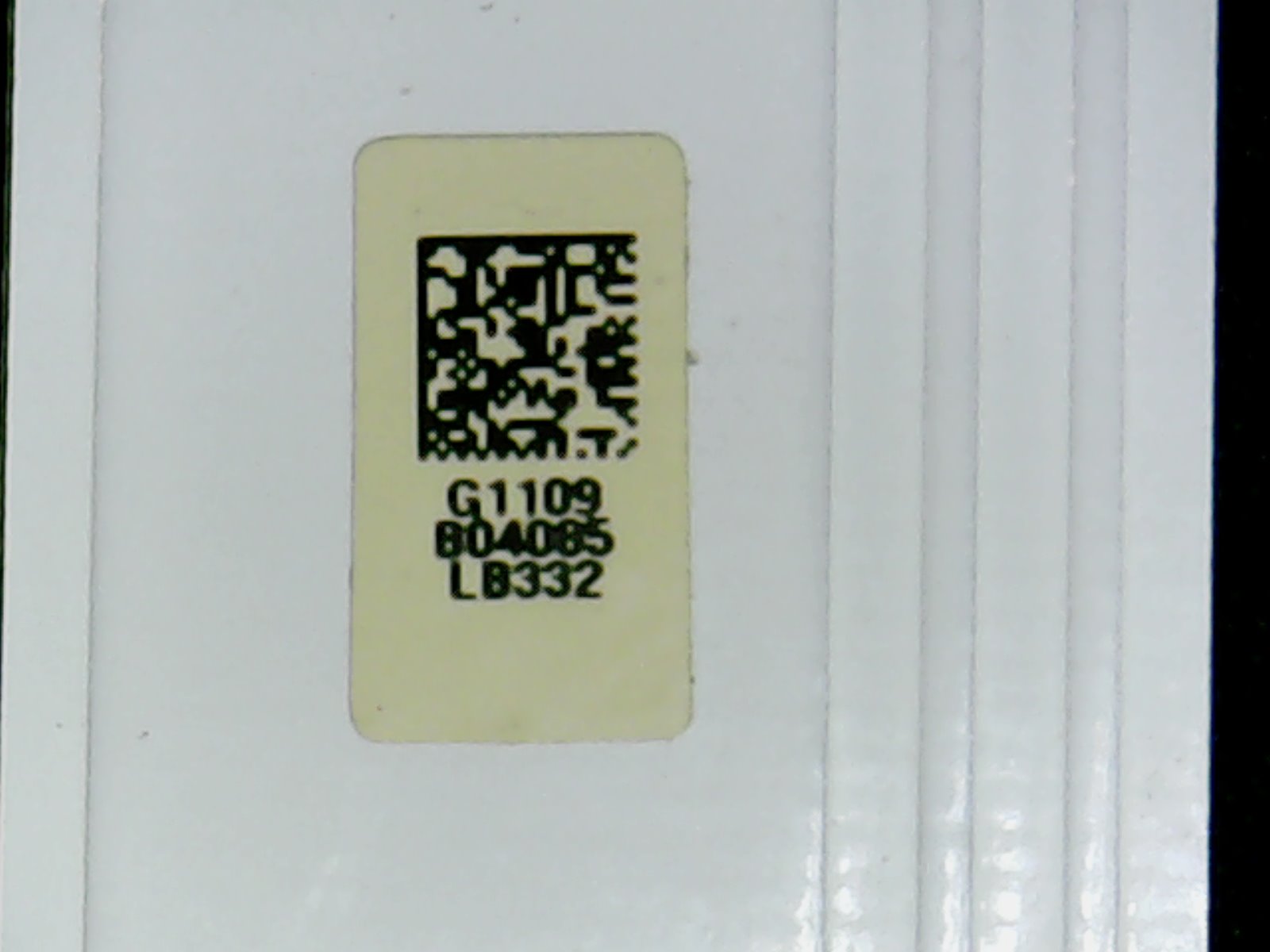

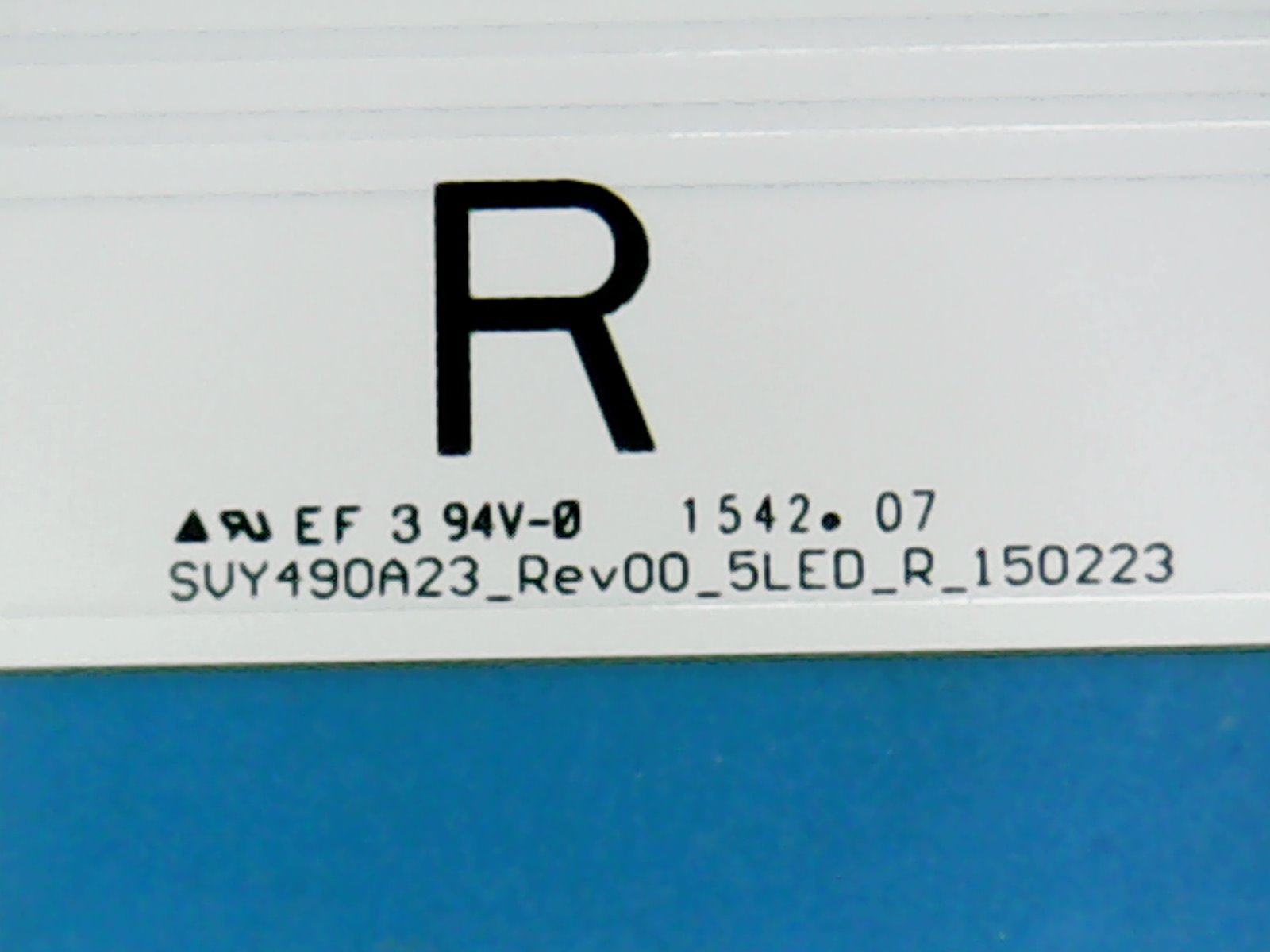

    could you show us the data printed on the led strip
    This is the only text on the strip.
    Found this small sticker with a QR code on it.

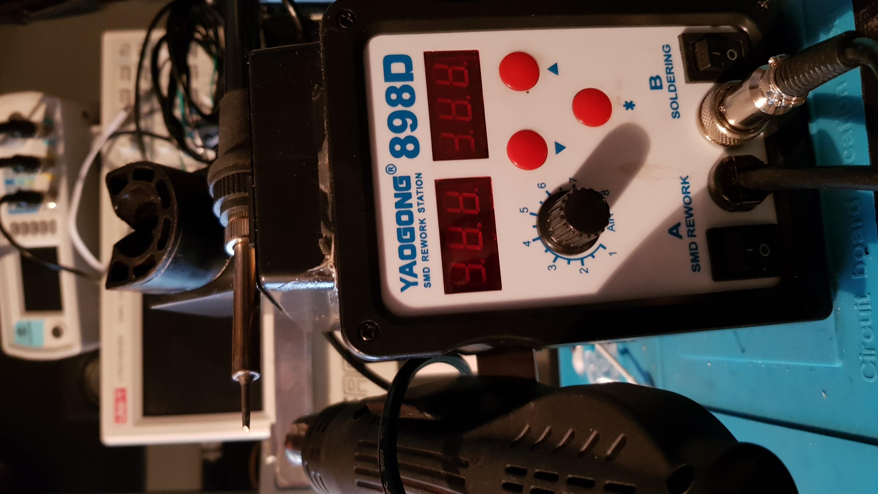

                      what kind of solder iron you use.. can you show us ?
                      • Stevie406
                        • 59
                        • United Kingdom
                        #91
                        Re: Sony KD49X8005C Assistance Required Please.
                        I had to increase my temp to 330c due to the large contacts

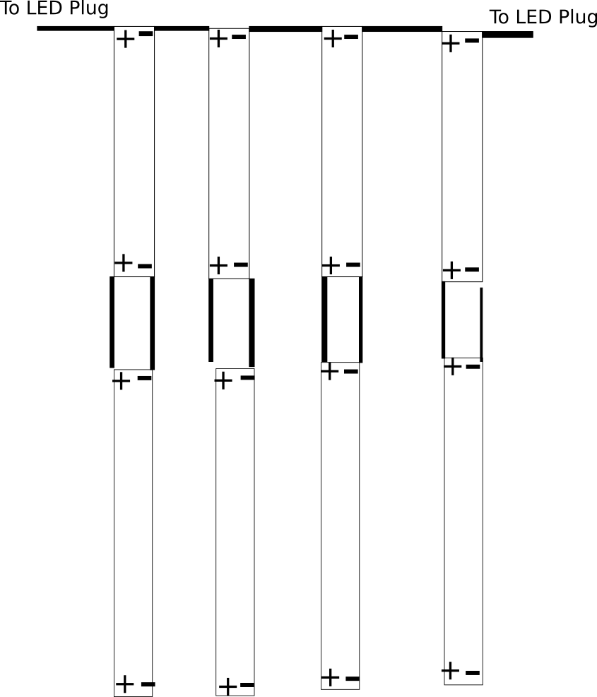

                            I have dismantled them for testing at the moment, but I will do a sketch of how I wired them up.
                            2 Minutes while I find a drawing package...

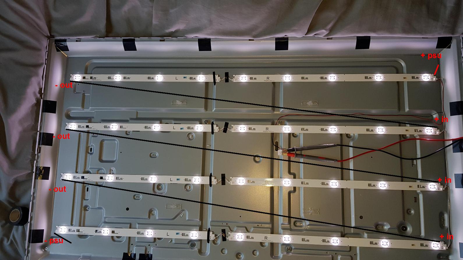

                                      hold on... they are 8 string each had in and out of +-
                                      also it should be so
                                      PSU LED Socket + ----> to first strip+ (IN ) .. first strip - (out ) go to second strig + in , 2S - out go to 3S + in ......and so one untill the 8 string - out should go to PSU socket -
                                        Yes, The 2nd string is just an extension of the 1st, same for 4th to 3rd, 6th to 5th and 8th to 4th.
                                        This leaves just 1st + IN from +PSU, 1st -OUT to 3rd +IN, 3rd -OUT to 5th +IN, 5th -OUT to 7th +IN, and 7th -OUT back to -PSU.
                                          also at end it should be so as this photo
